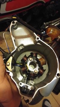

    I have a problem with Barton spark with FMB 139 engine.
    After replacing the head, the spark disappeared. Checking everything in turn, I came to the conclusion that the voltage from the pulser did not come out. So I replaced the stator with the pulser. The spark appeared. The engine was going to be hard to start, when it grabbed it worked very unevenly. I switched it off and once again did not fire, again there is no spark. So I bought another stator with a pulser and the spark is still gone. And the power supply from the pulse generator is max 0.40v Is it probably too little? I also observed that when I touch another cable with good voltage to the pulse generator cable, the spark appears at this point. What can this be a fault? I have no strength and do not want to unnecessarily exchange a half motor. Help!

    Exactly. It is not possible to check the gap between these elements. Unless I don't know something. These are pictures of how it looks. (I specially unscrewed one screw from the pulser to be able to gently zoom in and out). It doesn't do anything. You can also see through the screw holes in the pulser that it is not possible to adjust the distance from the magnet.
    FMB 139 Engine: Barton Spark Issue, Replaced Head, Stator & Pulser, Uneven Performance, 0.40V Max FMB 139 Engine: Barton Spark Issue, Replaced Head, Stator & Pulser, Uneven Performance, 0.40V Max
    I checked the installation thoroughly and everything is fine. I also tried to connect the engine for "short" or bypassing the ignition, switches, etc. I only connected the module, HV coil and ground. There was still no spark. I repeat that the spark appears when I touch a cable with a voltage to the pulse generator cable (i.e. I do the pulse "manually". The pulse generator is checked and it is good. Could the magneto be damaged somehow? I still do not know how to test such coils, where to attach a multimeter? that the charging current is about 7v from both charging cables and from the power cable the CDI module comes out over 20v Even around 30v. These voltages were measured when turning the starter.

    The photo shows that the pulser is mounted incorrectly (inversely), i.e. the pulser core is directed to the housing and should be directed to the magnet, do not adjust the pulser, there is no adjustment. Well, one more thing, I do not know what stator cover you have in these types there were 2 types of covers and basically 3. differ in the embedding-depth of the pulser depending on the height of the marker on the magnetic wheel. Measure the distance from the axis of the pulser core to the edge-face of the stator cover and compare with the distance of the marker and the face of crankcase, mainly it is that the pulse core coincides with marker on the wheel.

    cezary 603 wrote:
    The photo shows that you have the pulser installed incorrectly (inversely)
    The pulsator is positioned well.

    It is possible that you are right, but it is possible that it is mounted upside down, i.e. whether the pulse generator should not be mounted upside down, with a cable from below.

    Note that the coils are deeply embedded.

    The attached photo shows that the pulser is tightened with only one screw, which suggests that you purchased the "power plant" component as used. I am also inclined to the earlier opinion that the pulser can be installed the other way around. In my opinion, it should be turned coil (with a magnet) to the outside of the magnetic wheel, maintaining a proper gap.

    Hello again. I apologize for such a long absence. For a moment I gave up fixing Barton. After some time I came back to him but with a new ignition module and it works. However, the module was to blame so such low voltage from the pulse generator is the norm. Barton works great. Thank you all for your help. best regards
