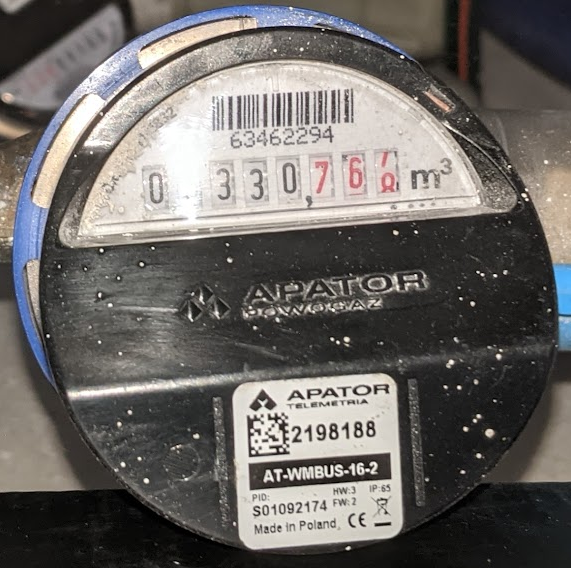

    44 01 06 10 36 80 01 05 07 7A 39 00 30 85 96 74 DB F3 F7 15 B7 9B 3E B8 25 C7 38 18 73 0E B1 21 6B B2 66 B8 6C 56 DF 84 C4 04 55 42 6B F6 46 A8 42 9E 7F C1 A7 8E 30 26 B2 A7 4B DA E6 F2
    Can anyone help about reading the value from this water meter?
    Frame type: 44
    Manufacturer: 0601
    Serial: 0180361
    Version: 05
    Medium: 07
    Header: 7A - Short: 7A
    Counter: 3A
    Status00
    Frame type: 44
    Manufacturer: 0601
    Serial: 0180361
    Version: 05
    Medium: 07
    Header: 7A - short: 7A
    Counter: 3A
    Status00
    After decoding the frame it comes out that all the data is contained in "manufacture specific data"
    Meter values:
    DIF:0Fh (SpecialFunctions)
    Manufacture specific data:
    4A5282952D02004380008051648C51648C01010000108000000071013A0000003A000000A008C9F503FFFF3A7B
    I decoded the frame online: http://www.miller-alex.de/WMbus, AES key 00000000000000000000000000000000. At the beginning of the frame you need to add its length in hex (3E).
    Look in this "manufacture specific data", write down some water meter states and the corresponding frames and you will see where things change.
    I don't have access to APATOR, I play around with B-METERS. There, in manufacture specific data, the reading history and error flags are stored. The current status is in the standard fields: DIF:0Ch (Bcd8) VIF:13h Date:34120700h Volume 71,234 m³

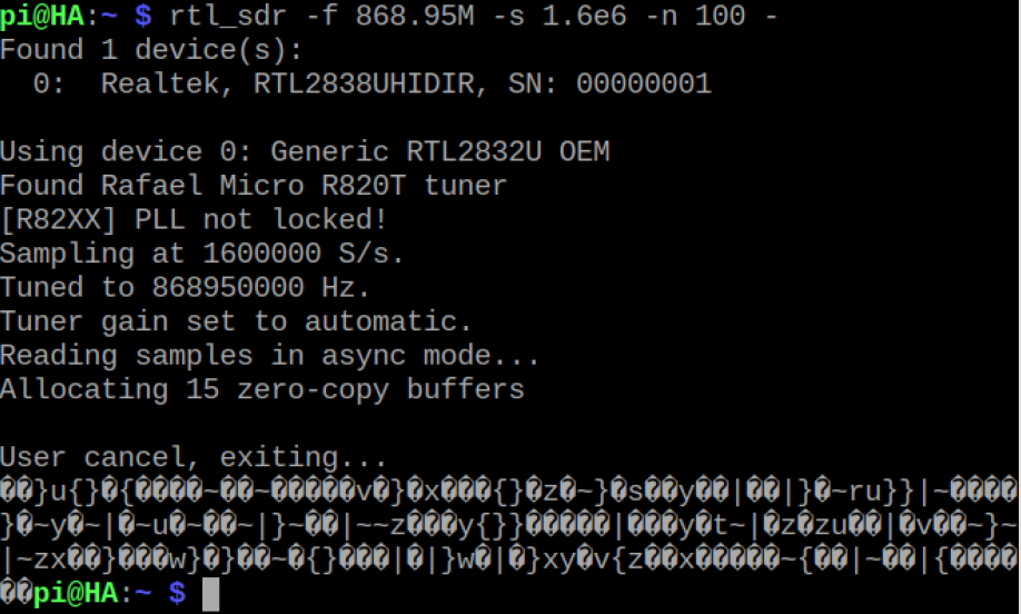

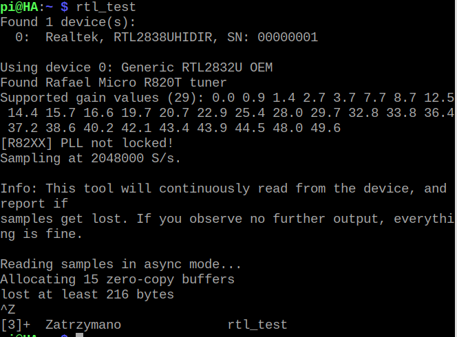

    Greetings,
    I have the simplest receiver connected to the RPi
    W-MBUS protocol reading in APATOR water meters - encryption and documentation .
    after rtl_test I get
    and after rtl_sdr -f 868.95M -s 1.6e6 -n 100 -
    Seemingly receives something, but no frame from Apator.
    Listened for several hours in the middle of the day.
    after rtl_sdr -f 868.95M -s 1.6e6 - | rtl_wmbus
    nothing selects although there are two meters with Apator overlays in the same room
    What else can I check?
    Is the receiver responding correctly and this received "rubbish" is the correct response of the receiver?
    Greetings.

    rtl_sdr I had installed from the standard package
    apt-get install rtl_sdr
    However, I compiled it from scratch as was done in the indicated post.
    unfortunately no change.
    You may have a meter in a metal box that attenuates the signal when the overlay battery is weak. This was the case for me.
  • #69 20128772
    olekdata
    Posts: 38
    Board Language: polish
    Welcome back.
    I most likely have a non-functioning rtl-sdr usb dongle.
    I also found that I can't read the weather station on the same 868Mh frequency. Although FM radio could be listened to, but it's a different range.
    So I made a receiver on esp8266 and cc1101 and it went, with the station.
    With the same set up he wants to get on with the apator162. Following the thread on reading w-mbus Remote water meter reading with IZAR overlay .
    reads w-mbus, not wanting to play with decoding I send the frames to wmbusmeters
