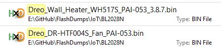

    markusdd wrote:
    Either unknown Tuya-based stuff or the Dreo fans. I really like the Dreo 517s, but I understand there has not been real cloud-cutting for these yet, which would disqualify them, although I prefer their hardware.
    of the two dumps we have for Dreo devices, neither are Tuya, so this would disqualify Dreo for cloudcutter anyway - assuming Dreo is still/all non-Tuya
    File Explorer screenshot with two highlighted BIN files named with “Dreo” and an HxD icon.

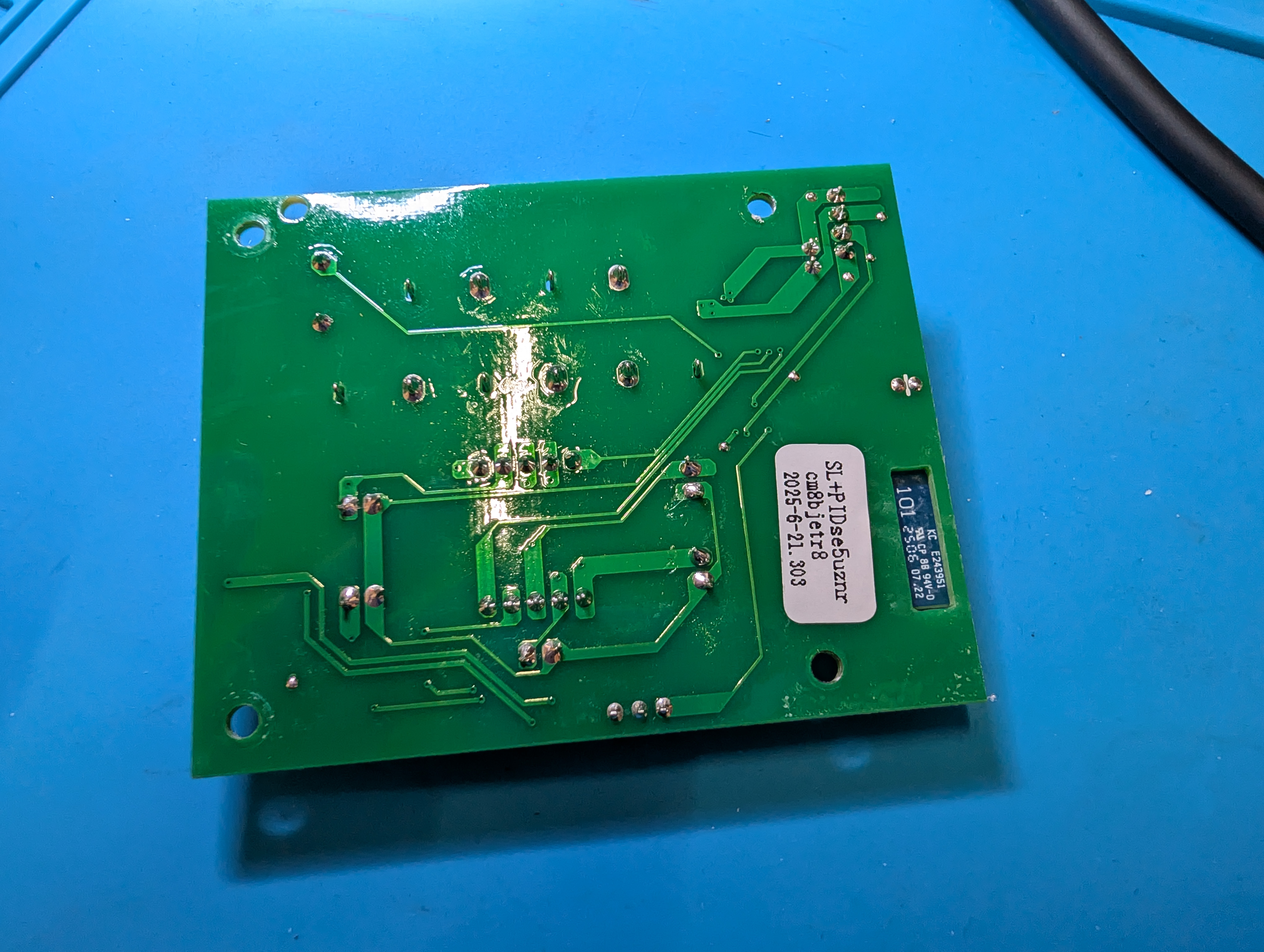

  • WBR3 module and TuyaMCU identified with UART log

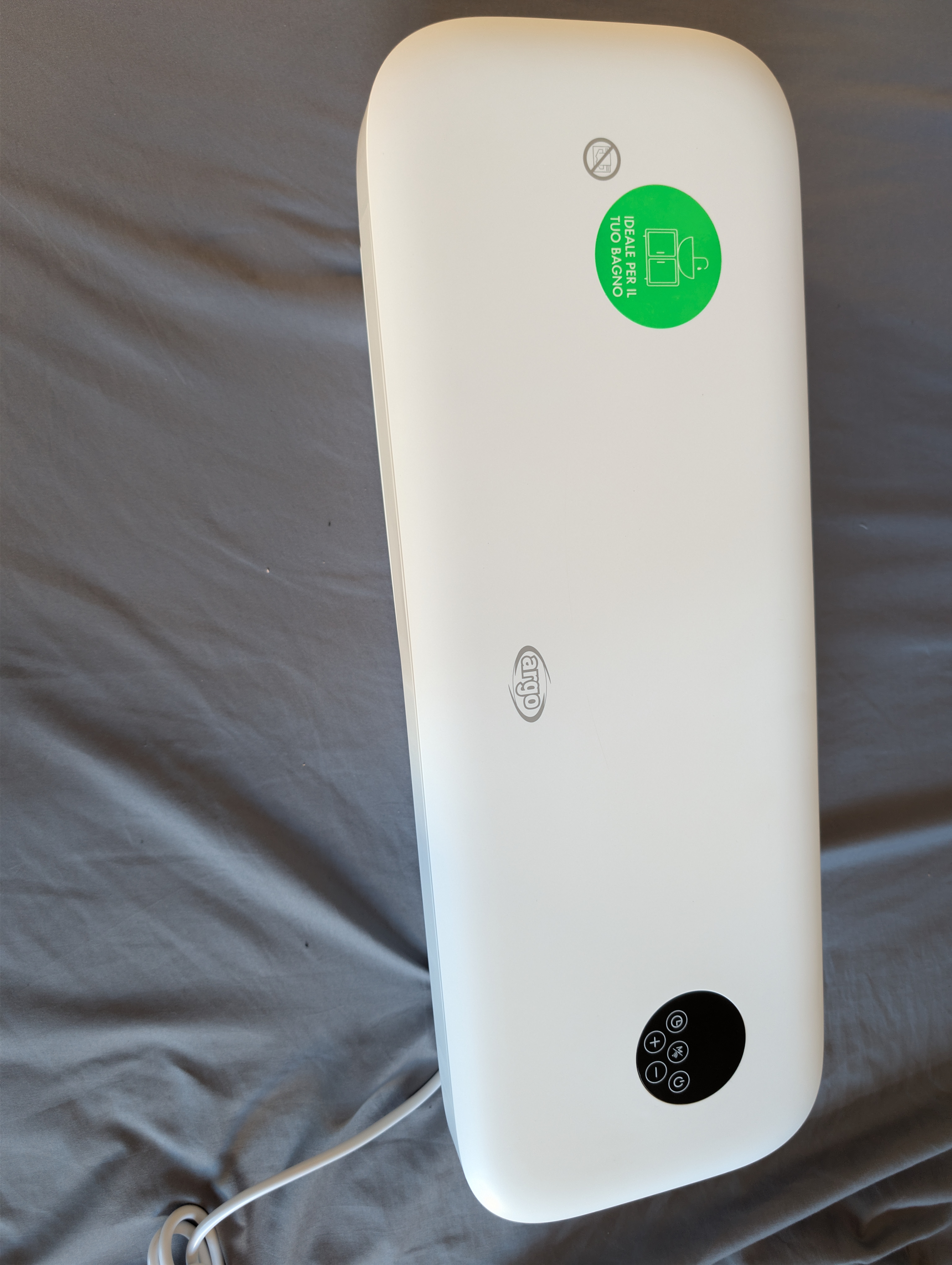

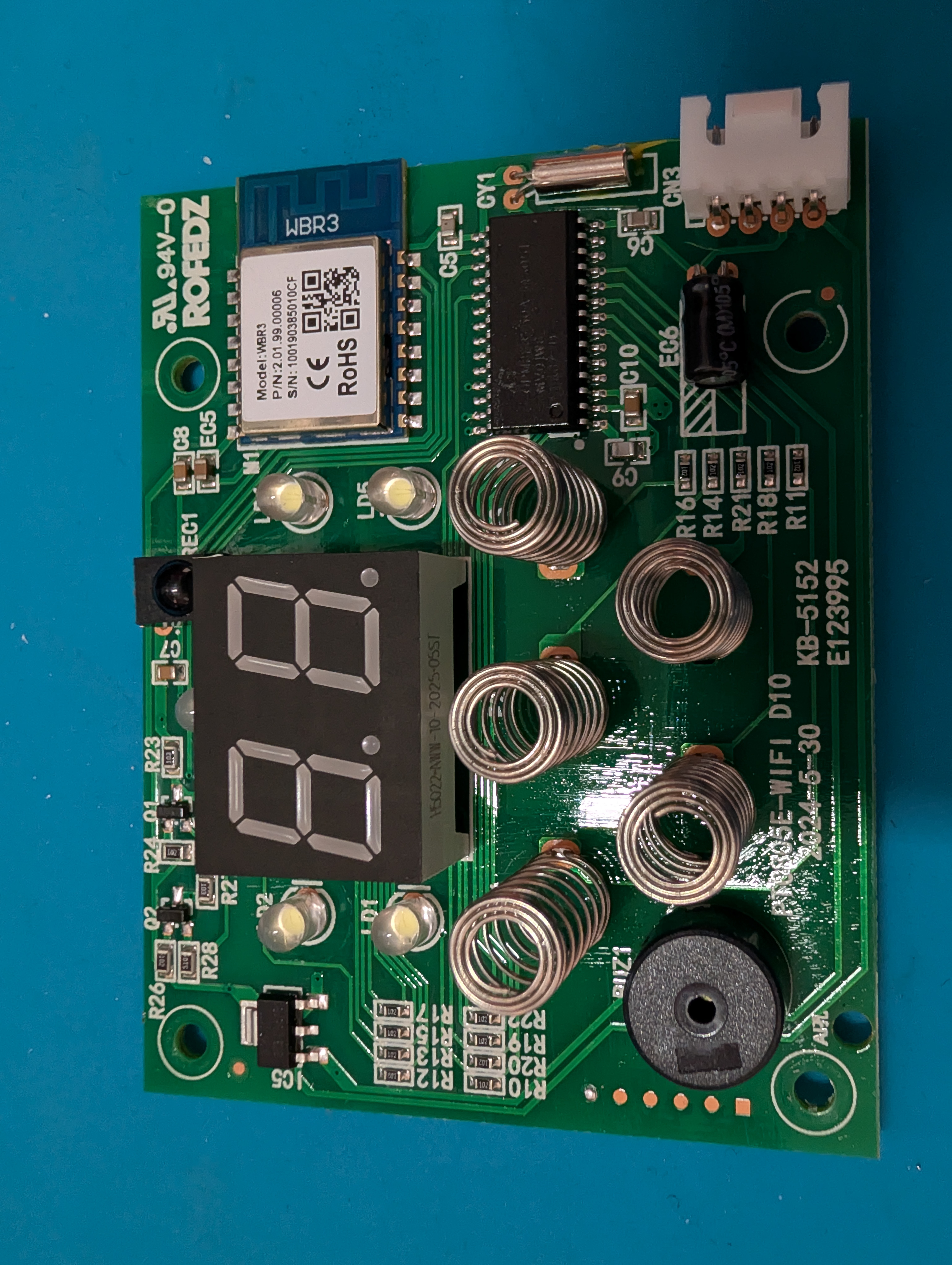

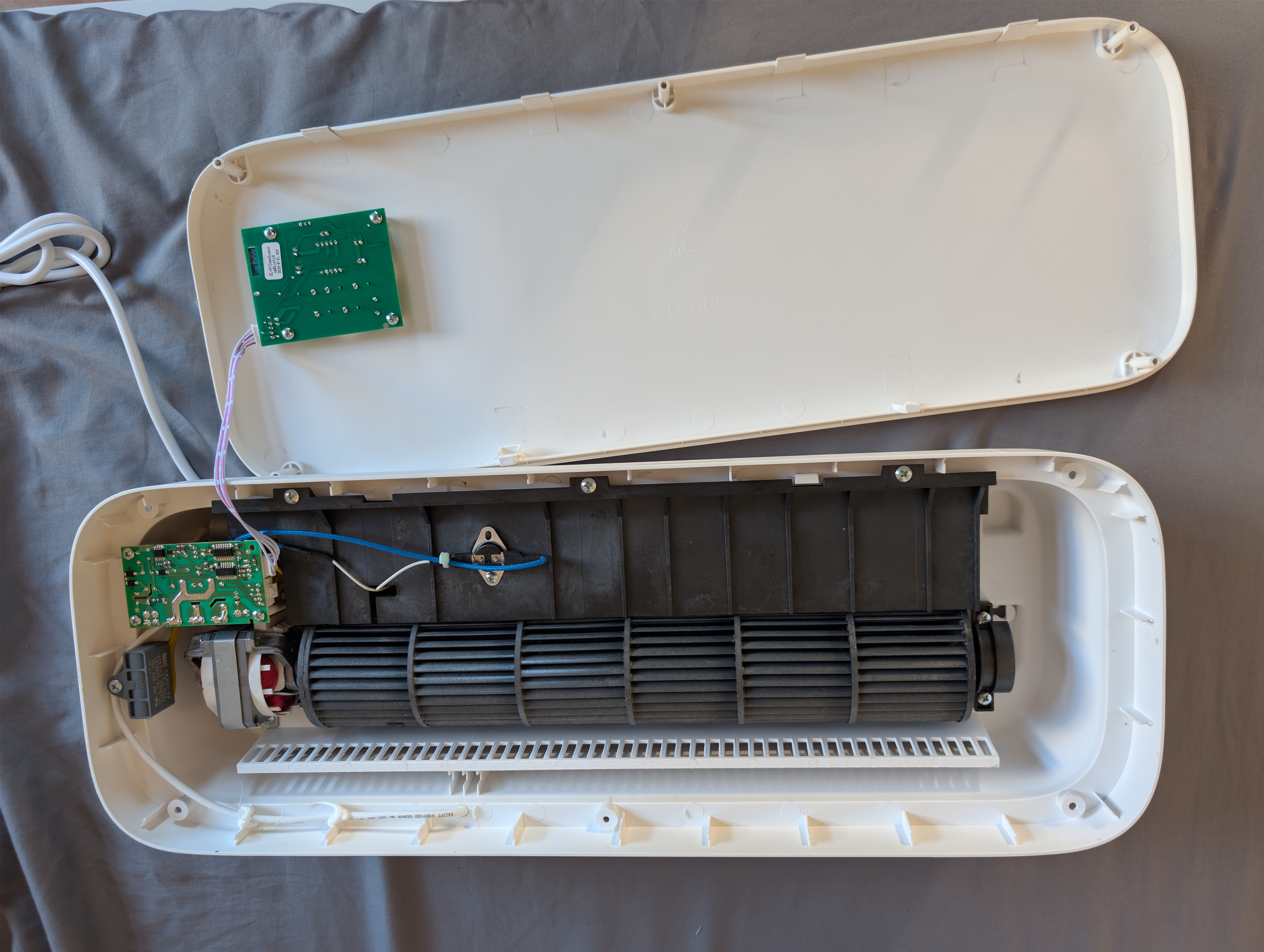

    #7 21853396
    markusdd
    Posts: 74
    OK, here we go. The device is here.
    WBR3 module inside. From looking at the PCB, I would say it's very clearly a TuyaMCU setup. There's only two data wires going to the MCU below it. Seems like a GigaDevice thing or similar.
    So how do we go about this now?
    EDIT: Also connected UART adapter to the A16 UART log pin and logged the startup. I attached the log as a txt. Keep in mind this was just with the MCU board on my desk, where I fed it 5V and GND at the input that normally comes from the motor/power supply board.
    • UART_Log_A16.txt (8.89 KB) You must be logged in to download this attachment.

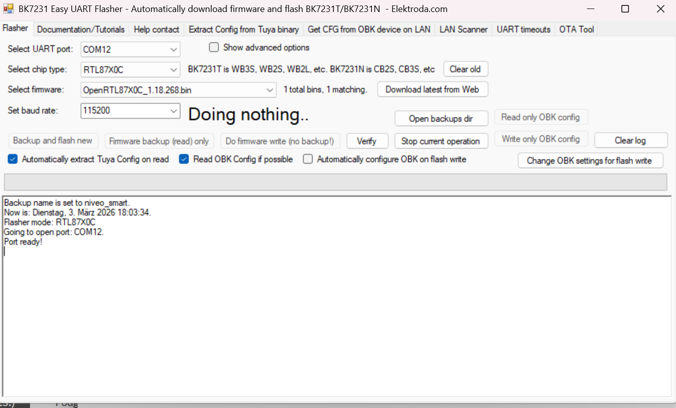

  • UART dump tool stuck after entering download mode
    #8 21853475
    markusdd
    Posts: 74
    So @divadiow and @p.kaczmarek2, I have unsoldered the module and wanted a firmware dump.
    Using a serial terminal I see this:
    So that should be fine. Using the GUI Flash tool, after I closed the serial terminal, I tried to do a dump only without writing a new firmware yet.
    But nothing happens; it is stuck in that state:
    Screenshot of BK7231 Easy UART Flasher showing “Doing nothing..” with COM12 selected
    What to do? UART adapter is a WCHLink (company that makes the CH340), so that should be more than good for the job.
    #9 21853503
    Posts: 5220
    Help: 449
    Rate: 918
    Hi. I've been working on a revised rtl2 branch of Easy Flasher that I hope will resolve issues relating to failed links, reads, writes etc. it'd be great, if you have the time and want, to get your feedback on it.
    https://github.com/divadiow/BK7231GUIFlashTool/actions/runs/22612943136
    If you do, please give backup a go at different bauds up to 3000000

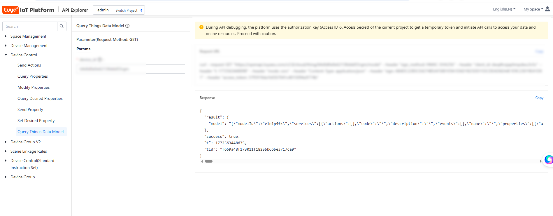

    EDIT: Based on stuff I found here I tried to use the dev platform and I got the following codes extracted:
  • #11 21853603
    Posts: 5220
    Help: 449
    Rate: 918
    thank for trying it out. I do get more retries at lower bauds, but no hard fails. Maybe your cables are long? I'll continue to fiddle.
    regarding the TuyaMCU config, you should get the Query Things Data Model json and get Ai to make it pretty. This contains the dpIDs and their values. eg:
    Screenshot of Tuya IoT Platform API Explorer showing “Query Things Data Model” and a JSON response
  • Tuya datapoints for Niveo fan heater
    #12 21853619
    markusdd
    Posts: 74
    >>21853603
    I used my SublimeText skills to make it pretty, here we go:
    EDIT: Let Grok translate the chinese stuff:
    EDIT: Also have attached the firmware dump
    EDIT:

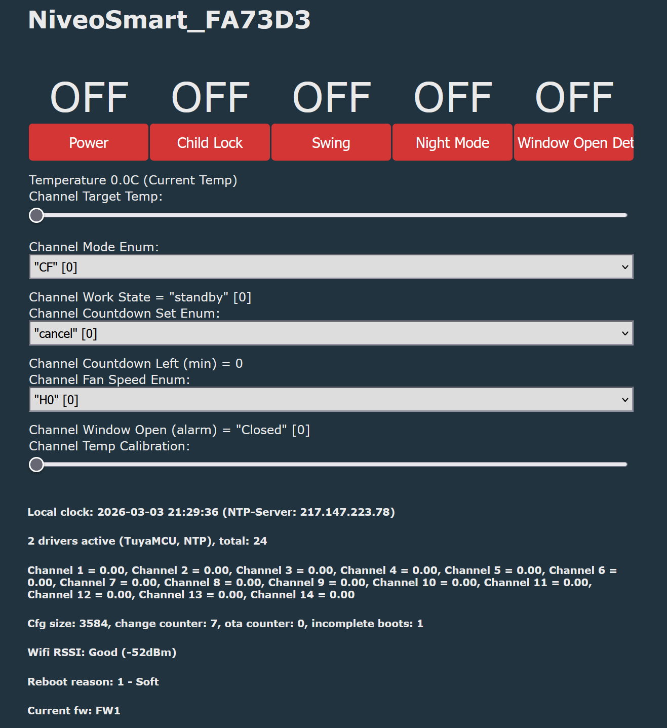

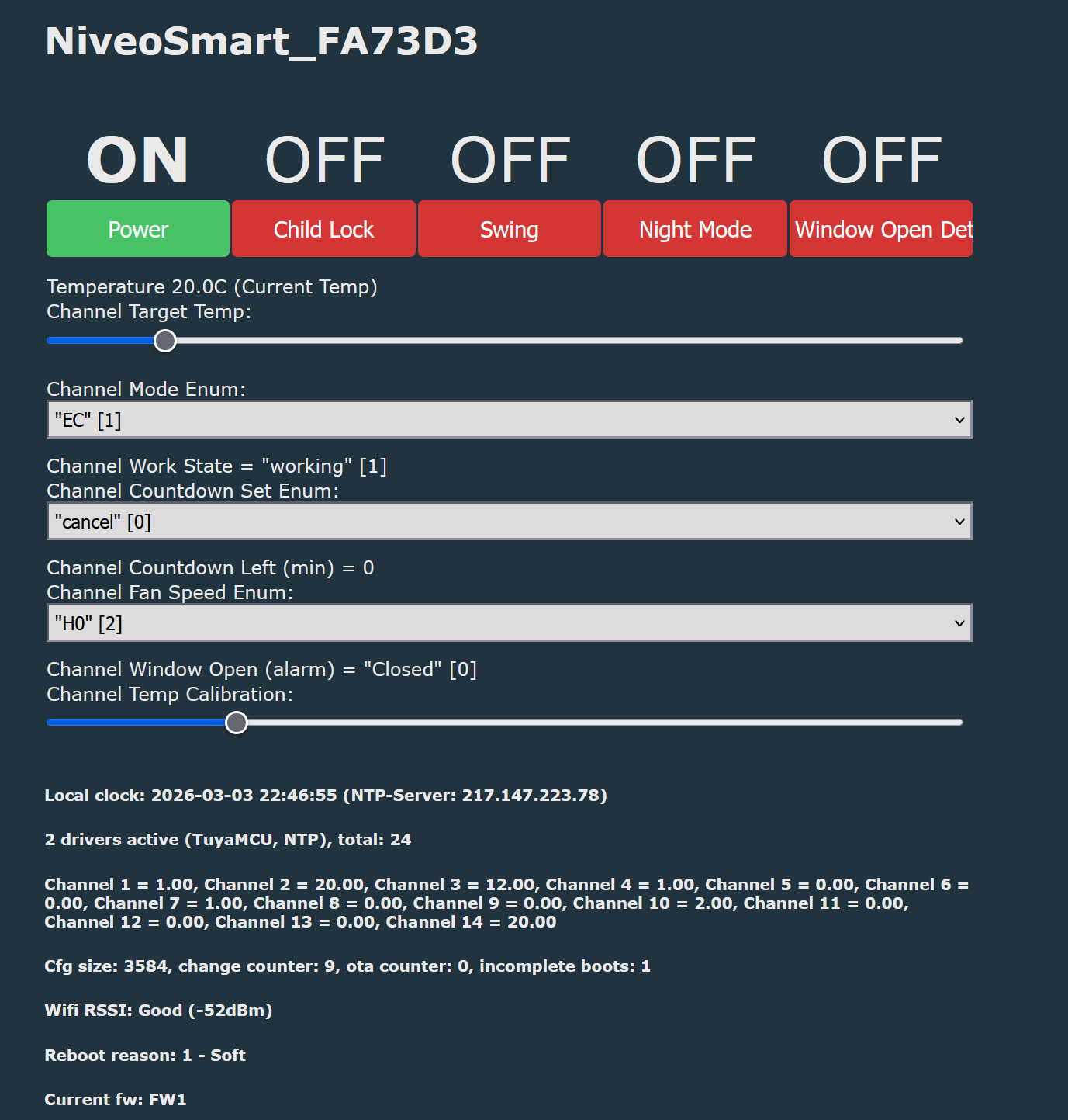

    #13 21853722
    markusdd
    Posts: 74
    I have now used Grok to write an autoexec.bat for me out of the JSON.
    Comparing this to the examples it looks somewhat sane to me but clearly it is not fully correct.
    E.g. the power toggle works, but it immidiately turns off again. Temperature is displayed as 0.
    Screenshot of the OpenBeken web UI for NiveoSmart_FA73D3 with toggles, temperature fields, and TuyaMCU config text.
    Here I need a bit of help now.
    Hash comments break OpenBeken command parsing

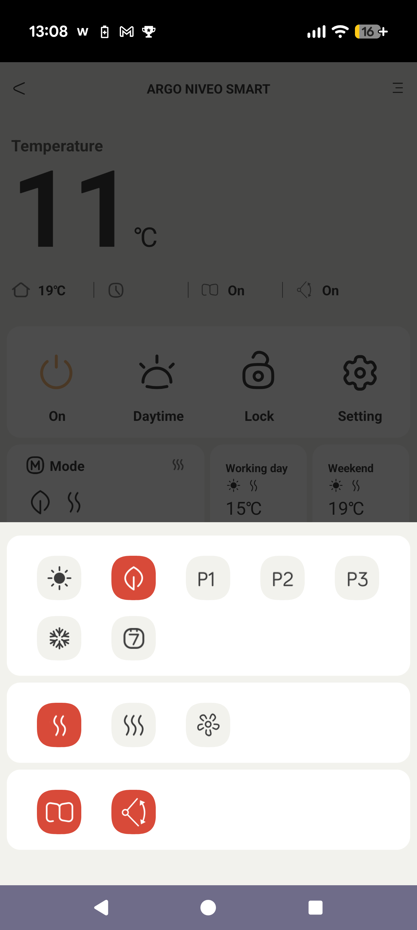

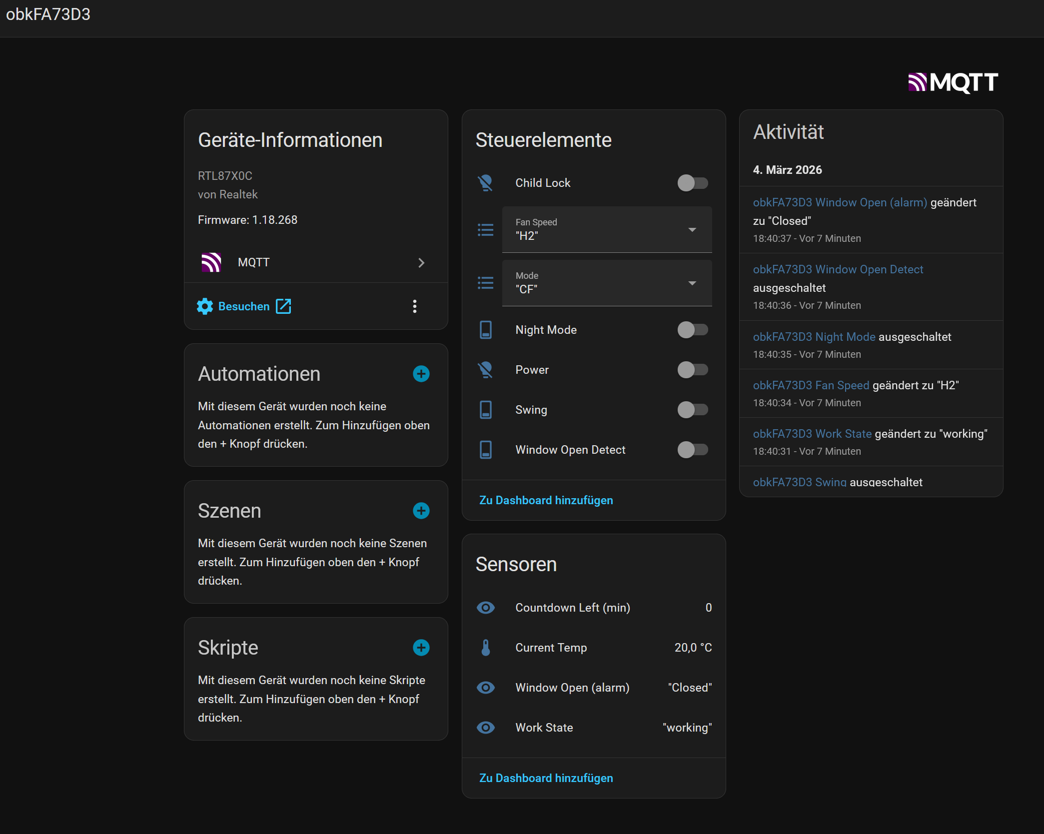

  • Wrong fan speed enum order fixed
    #15 21853805
    markusdd
    Posts: 74
    Lol. It really was just the comments. And the order for the fanspeed enum was wrong.
    “NiveoSmart_FA73D3” control panel with Power, Child Lock, Swing, Night Mode buttons and 20.0°C temperature readout
    As far as I can see, this is working:
    That being said: This would work great. My only gripe is that this thing is actually much louder than I anticipated. Which is a shame.
    So my question would be: Do you think we would have a shot at getting the Dreo working?
    We know we can flash it with OpenBeken, question is if we can figure out the UART comms.

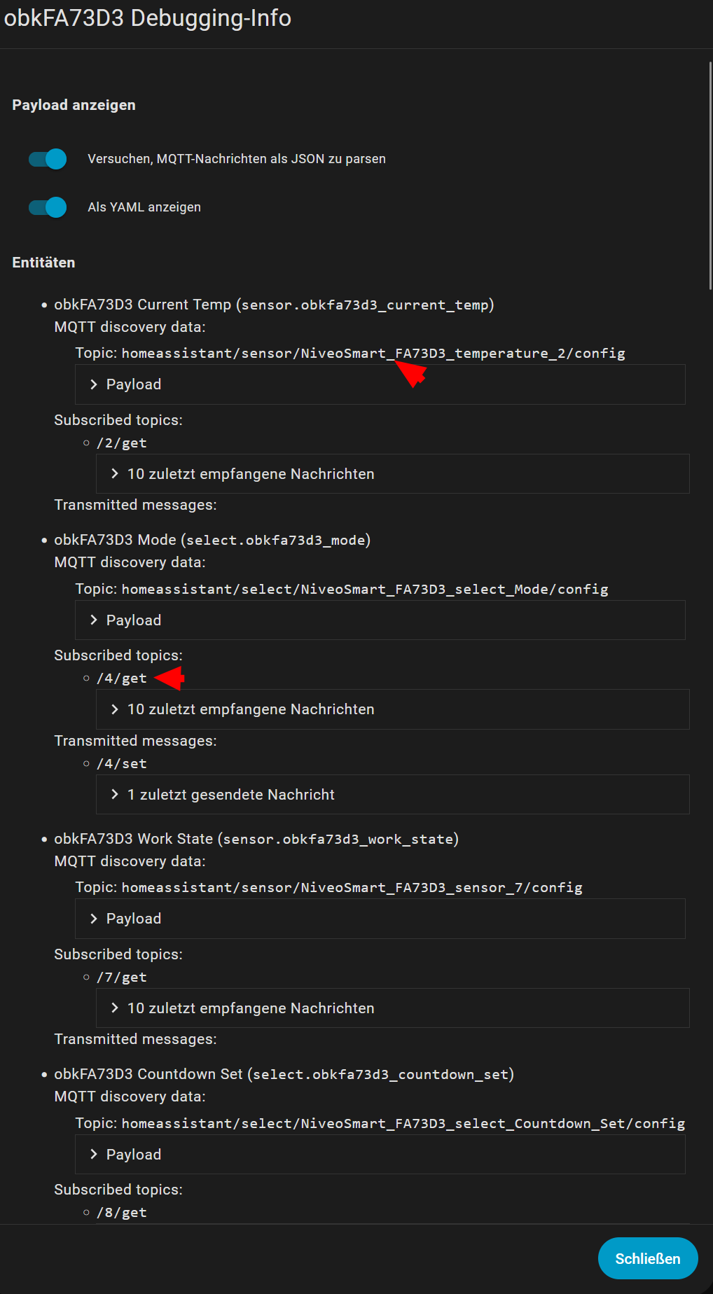

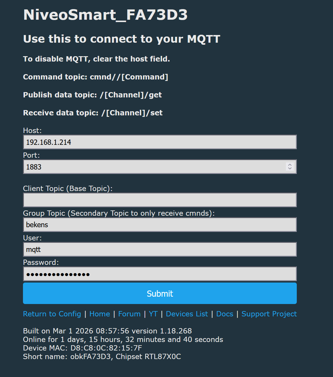

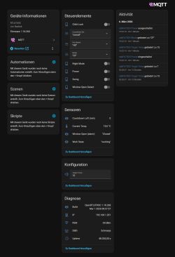

  • MQTT discovery works but HA controls do not
    #17 21854325
    markusdd
    Posts: 74
    >>21853895
    Thanks for adding it to the db so quickly! I think this will be very useful for many people as there is a lot of these 1000 W/2000 W wall heaters out there with all different cases but very similar specs. My suspicion is that they are basically the same under the hood. So whatever is here should be readily adaptable.
    And thanks so much for the help.
    As for the Dreo: I got a proper logic analyzer, and we have the previous dreo-cloudcutter work on GitHub available. I do not believe things will be massively different.
    Sure, will be a bit of work, but if we get it running, this will a) make me very happy and b) probably hundreds to thousands of others as well.
    So if you are willing to assist as well, I'd start another thread.
    I keep the Argo anyway because I can use it elsewhere if need be (and it was cheap). I was able to order the Dreo 517s with a coupon and on discount, so I got one coming on Friday.
    Seems we got a fun weekend ahead. Meanwhile I will look into integrating the Argo in Home Assistant to see how well it plays there.
    Added after 1 [hours] 29 [minutes]:
    Screenshot of Home Assistant MQTT device page with controls, sensors, and activity log
    Ok, I still might require some more info on HA integration.
    I followed the standard mqtt discovery step and things do show up.
    When I do change something on the openbeken page, it also updates in HA. But all controls I try do not work via MQTT. And most importantly: The set temperature control is completely missing. So I cannot even set the temp form HA right now.
    Also, it of course would be nice to have the most iimportant controls as a Thermostat. Any hints?

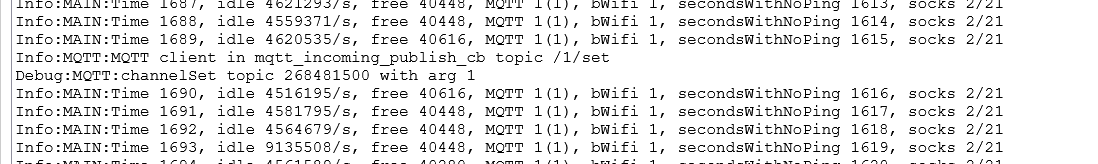

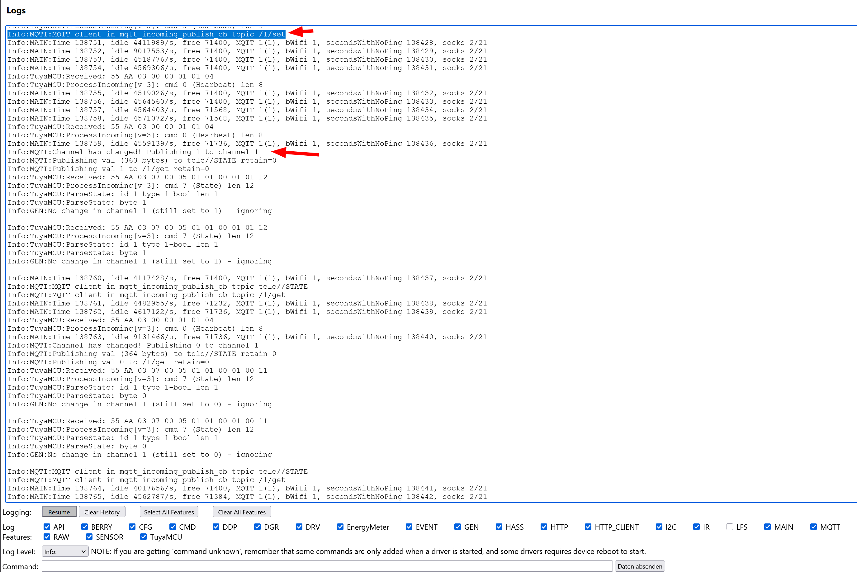

  • MQTT control commands received but not applied
    #18 21855527
    markusdd
    Posts: 74
    So @divadiow or @p.kaczmarek2, I need some assistance here. I have set flags now so that the status shows up in Home Assistant and is retained, but all controls do not work.
    The temperature control is completely missing when I use dimmer, I have to use TextField (which is not as nice when using the device web UI).
    Is there any way to configure it so MQTT works as easily as Tasmota does? Or is there now another config that needs to be written so MQTT controls actually work from HA?
    In the logs I see this when I press the power button:
    Screenshot of MQTT and Wi‑Fi logs, including “MQTT client in mqtt_incoming_publish_cb”.
    So there is a set on channel 1 with payload 1 received. So what is the issue? Why is it not applied?

  • #21 21855863
    markusdd
    Posts: 74
    >>21855859
    My guess is it's just a relatively basic config issue.
    I have flags 2, 10, 19, 21, 30, 35, and 45 set.
    I used Home Assistant discovery.
    I see all elements in HA now, and status is reported properly. I just need to find out why MQTT commands do not get executed; everything else is working nicely.
    Home Assistant device page showing MQTT info, controls, activity log, and temperature sensor reading

  • Missing parameter on HA set command
    #28 21857199
    markusdd
    Posts: 74
    >>21857189
    Haha indeed, yeah the Dreo needs its own driver flavor; this is a bigger construction site if OBK wants to support it.
    At least here I gave a log with the power button with the Argo from this thread here. https://www.elektroda.com/rtvforum/topic4166319.html#21855527
    So there is a set command on channel 1 received.
    Here is another try. First red arrow is what pops up when I do it in HA. There is clearly a set command being received, but nothing happens.
    The second arrow pops up when I press the web UI power button. It recognizes it is now on and pushes that state to MQTT as well. I can then see in HA that the toggle moves to on.
    So is there a parameter missing on the set command or something? This must be something stupid simple.
    Screenshot of MQTT logs; red arrows highlight entries about publishing to channel 1
  • #29 21857239
    Posts: 14770
    Rate: 12913

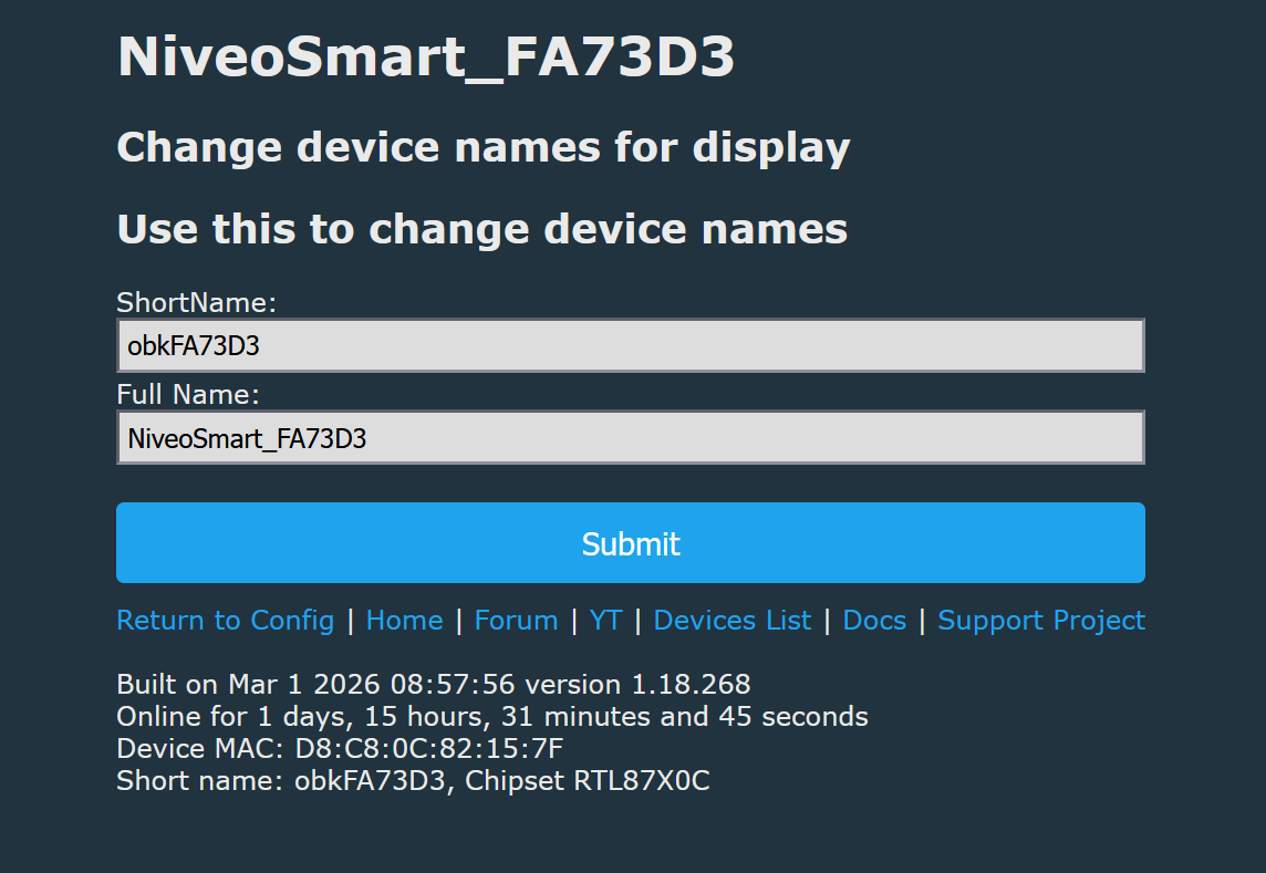

    It looks like you have empty device name, how is this possible? What do you have in Configure Names?
  • #30 21857242
    markusdd
    Posts: 74
    >>21857239
    I have this.
    Device name change settings page for NiveoSmart_FA73D3 with fields and a Submit button
    But I guess this could be a problem? I thought it just takes the short name when left empty?
    MQTT configuration page for “NiveoSmart_FA73D3” with host, port, user and password fields
    This is the MQTT info from HA. This indeed looks a bit weird.
    Screenshot of “obkFA73D3 Debugging-Info” showing Home Assistant entities and MQTT discovery topics
A cloud-free smart control solution was developed for a Niveo/Tuya wall fan heater intended for frost protection and room heating in Home Assistant. The device was opened, identified as a TuyaMCU design with a WBR3 module based on RTL8720CF, and flashed/dumped using OpenBeken tooling. The TuyaMCU datapoints were extracted from the device’s data model, mapped to OBK channels, and an autoexec configuration was iteratively corrected until MQTT control and status reporting worked. The main issue was MQTT/Home Assistant discovery behavior, including an empty client topic and mismatched payload handling, which was resolved by setting a proper topic and rediscovering the device. The result was a working local thermostat-style setup in Home Assistant, with plans to adapt the configuration for similar Tuya heaters and possibly extend support for Dreo devices separately.
TL;DR: This wall-mounted Niveo Smart heater runs TuyaMCU at 9600 baud on a Tuya WBR3 (RTL8720CF); “115200 is failing but 230400 seems to succeed already.” Flashing OpenBeken and mapping the dpIDs enables full local (cloud-free) control with Home Assistant. [Elektroda, markusdd, post #21853518]
Why it matters: If you want frost protection and 18–20 °C without any cloud, this walkthrough shows a validated, working path using OpenBeken and MQTT discovery.
What exactly was achieved—does OpenBeken give full local control on this heater?
Yes. After flashing OpenBeken and correctly mapping dpIDs, users controlled power, target temperature, modes, swing, night mode, window detection, countdown, and calibration—all locally; HA entities appeared via MQTT discovery. “As far as I can see, this is working.” [Elektroda, markusdd, post #21853805]
Which Wi‑Fi module and bus does the Niveo Smart heater use?
It uses a Tuya WBR3 (Realtek RTL8720CF) module. The main board talks TuyaMCU over two data lines to the heater’s MCU, indicating a standard Tuya serial bridge design. [Elektroda, markusdd, post #21853396]

Which dpIDs map to key heater functions and ranges?
Confirmed mappings include: dp1 power (bool), dp2 temp_set 1–35 °C, dp3 temp_current –20…50 °C, dp4 mode (CF/EC/P1/P2/P3/AF/ST), dp19 countdown_set, dp20 countdown_left 0–1440 min, dp101 fan_mode (H1/H2/H0), dp103 night_mode, dp104 window_check, dp105 window_reminder, dp106 temp_calibration 0–40 °C. [Elektroda, markusdd, post #21853619]
How do I build a working OpenBeken autoexec for TuyaMCU (3 steps)?
  1. Set channel types/labels (e.g., temp_current as temperature; temp_set as dimmer 1–35 °C). 2. Link dpIDs with linkTuyaMCUOutputToChannel (no inline comments). 3. Send tuyaMcu_sendQueryState to sync on boot. [Elektroda, markusdd, post #21853805]
Home Assistant shows entities but no temperature setpoint—how do I fix it?
Map channel 3 as a dimmer with min 1 and max 35, and link dp2 (temp_set) to that channel. Remove “#” comments and correct enum orders, then rediscover via MQTT. [Elektroda, markusdd, post #21853805]
Can this setup deliver frost protection and 18–20 °C targets?
Yes. The device exposes temp_set from 1 to 35 °C and temp_current feedback. With HA scheduling, you can hold frost protection unattended and heat on demand to 18–20 °C. [Elektroda, markusdd, post #21853619]
Is the Dreo 517s compatible with cloudcutter or Tuya profiles?
No. Dreo devices discussed are non‑Tuya, so Tuya cloudcutter does not apply to them for local control. [Elektroda, divadiow, post #21849575]
Can the Dreo 517s run OpenBeken/OpenBK firmware?
Two Dreo dumps showed Belon BL2028N MCUs, which are Beken BK7231N and supported by OpenBK. Firmware is feasible; you still must reverse the device’s UART protocol. [Elektroda, divadiow, post #21849621]
What remains unknown for a Dreo local-control port?
The UART protocol between the Wi‑Fi SoC and the heater’s controller remains the key unknown. Quote: “yes. I’d say this is the unknown.” [Elektroda, divadiow, post #21853895]

How do I get countdowns and window detection into HA?
Expose dp19 (countdown_set) as enum, dp20 (countdown_left) as value minutes, dp104 (window_check) as bool, and dp105 (window_reminder) as read‑only bool. Home Assistant will discover them via MQTT. [Elektroda, markusdd, post #21853619]
