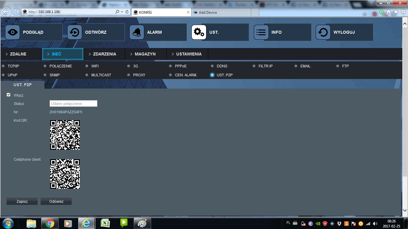

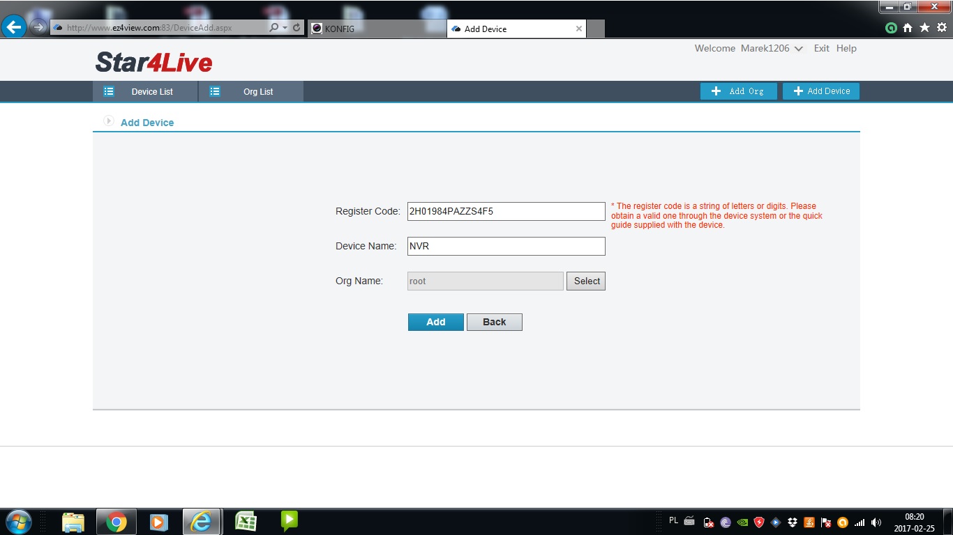

    I would like to have a recorder online view. I would like to set it in the cloud. I have a problem with the recorder code. By typing it on the page: http://www.ez4view.com:83/DeviceAdd.aspx I get the error in the picture
    I also include a picture of the code from the P2P service.
    What could be the solution to this problem?

    By. recorder, the recorder has established a connection with the P2P cloud (easy4ip.com).
    Install Smart PSS on the computer, and gDMSS on the Tablets and Smartphones.

    But I did nothing, I checked the options in the recorder and that's it. I just wanted to put it on easy4ip.com and I got this error.

    At www.ez4view.com as I want to add the device crashes the same error as in the first post.

    If this is a Line series recorder you do not need to add the device on the site, the QR code scans after establishing an online connection must work. Only point series devices use ez4view.com
