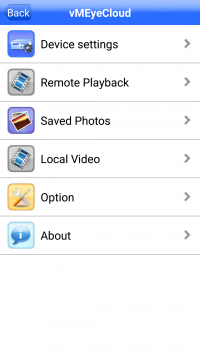

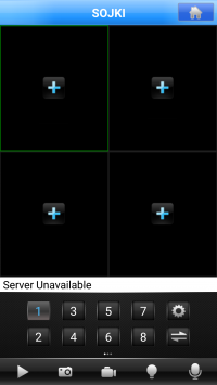

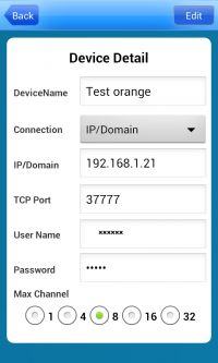

    Hello. I purchased the LV-AHD840 recorder. I wanted to configure the preview on the cell. A preview program like in the subject - vMEyeClouds. Quite intuitive. We have to set up:
    - address (192.168.1.XX)
    -port: 37777
    -User ID: np admin
    - password: np admin (ie the password for the BCS program). (of course, when I'm in the home network. From the outside, the classic setting with NO-IP and instead of 192.168.1.xx gives XXXX.ddns.net)

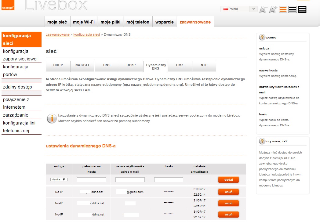

    The problem, however, appears with LIVEBOX . In the "Network configuration" tabs, I set the following:
    - DHCP: static IP address for the recorder (192.168.1.XX)
    - NAT / PAT: here I think I should set the port (37777), but I have a blocked access - photo posted.
    Configuring LV-AHD840 Recorder for Mobile Preview via LIVEBOX 2.0 / Funbox 2.0 and vMEyeClouds
    - DNS: the recorder appears with a static address (192.168.1.XX)
    - UPNP - I did not add anything
    - Dynamic DNS - I set NO-IP - according to BCS configuration instructions (but I can not use it, because it should first work with the network inside and not from the outside).
    - DMZ - I have not changed anything (no access)
    - NTP - no changes.
    In spite of such settings - on the cell you can not see the image from the cameras at all. The question is why. In my opinion, because PORT should be set in NAT / PAT (37777). But I do not have access there as you can see in the picture. Does anyone have any idea why? Possibly what I did wrong that I do not have cameras on my mobile phone? The settings in the recorder are identical to the bcs_konfigur__sieci__1_.pdf file, available on Electroda and in my other post.
    I will say immediately that I log in to IPv4 and not to IPv6.

    Question 1. Where should I choose this service? I put photos - the fields marked in red there are grayed out and I cannot enter anything there. I attach photos below so that you can see the settings.
    Before I try to connect from the outside (using DDNS, which, by the way, is already registered and in livebox, as can be seen in the picture below, the date is currently refreshed), I have to connect from the inside using 192.168.1.xx. It is impossible.

    Unfortunately, up to now I have no preview - neither being at home (using 192.168.1.XX) or outside the home (using NO IP). It is interesting because I had the same liveboX but with the software from 2014 - everything smigalo extra. I exchanged for a new one (with new software) - and as you can see, you can not connect at all. I have the impression that this is related to IPV4 / 6.

    But right away ... Why are you setting up anything on the router ???

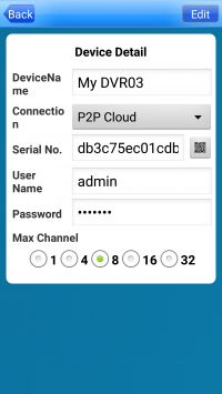

    After all, you want to use the cloud / p2p to connect to the recorder. So your job is only:
    1 - network configuration of the recorder (IP, correct default gateway, DNS)
    2 - finding the cloud code / p2p recorder (usually in the menu somewhere is)
    3 - entering this code, the correct port, login and password into the vmeyecloud program
    4 - if you want to do it in the same network as the recorder (eg wifi), switch to LTE or 3G data transmission.
    And all should be flying.

    I did the above activities. I tried to connect via p2p, but I come across the same problem - i.e. the phone (emyesuper program or clouds) do not see these cameras at all.
    For order, I am attaching the current settings and I have doubts right away Configuring LV-AHD840 Recorder for Mobile Preview via LIVEBOX 2.0 / Funbox 2.0 and vMEyeClouds : Configuring LV-AHD840 Recorder for Mobile Preview via LIVEBOX 2.0 / Funbox 2.0 and vMEyeClouds Configuring LV-AHD840 Recorder for Mobile Preview via LIVEBOX 2.0 / Funbox 2.0 and vMEyeClouds Configuring LV-AHD840 Recorder for Mobile Preview via LIVEBOX 2.0 / Funbox 2.0 and vMEyeClouds Configuring LV-AHD840 Recorder for Mobile Preview via LIVEBOX 2.0 / Funbox 2.0 and vMEyeClouds Configuring LV-AHD840 Recorder for Mobile Preview via LIVEBOX 2.0 / Funbox 2.0 and vMEyeClouds Configuring LV-AHD840 Recorder for Mobile Preview via LIVEBOX 2.0 / Funbox 2.0 and vMEyeClouds Configuring LV-AHD840 Recorder for Mobile Preview via LIVEBOX 2.0 / Funbox 2.0 and vMEyeClouds Configuring LV-AHD840 Recorder for Mobile Preview via LIVEBOX 2.0 / Funbox 2.0 and vMEyeClouds Configuring LV-AHD840 Recorder for Mobile Preview via LIVEBOX 2.0 / Funbox 2.0 and vMEyeClouds

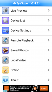

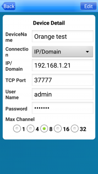

    The program setting itself can be seen below (in 2 variants IP and p2p): Configuring LV-AHD840 Recorder for Mobile Preview via LIVEBOX 2.0 / Funbox 2.0 and vMEyeClouds Configuring LV-AHD840 Recorder for Mobile Preview via LIVEBOX 2.0 / Funbox 2.0 and vMEyeClouds
    The program I use:
    Configuring LV-AHD840 Recorder for Mobile Preview via LIVEBOX 2.0 / Funbox 2.0 and vMEyeClouds and Configuring LV-AHD840 Recorder for Mobile Preview via LIVEBOX 2.0 / Funbox 2.0 and vMEyeClouds
    Admin login, password the same as for the registrar.

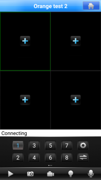

    It's time to see:
    Configuring LV-AHD840 Recorder for Mobile Preview via LIVEBOX 2.0 / Funbox 2.0 and vMEyeClouds and Configuring LV-AHD840 Recorder for Mobile Preview via LIVEBOX 2.0 / Funbox 2.0 and vMEyeClouds - shows at the beginning of Conecting and Server is unavailable.

    I DDNS / IP:
    The above configuration worked in the old LIVEBOX (from 2014). I have now changed for a new one - IPV6 is there and as you can see something is not working. It looks like a port was poorly constructed.

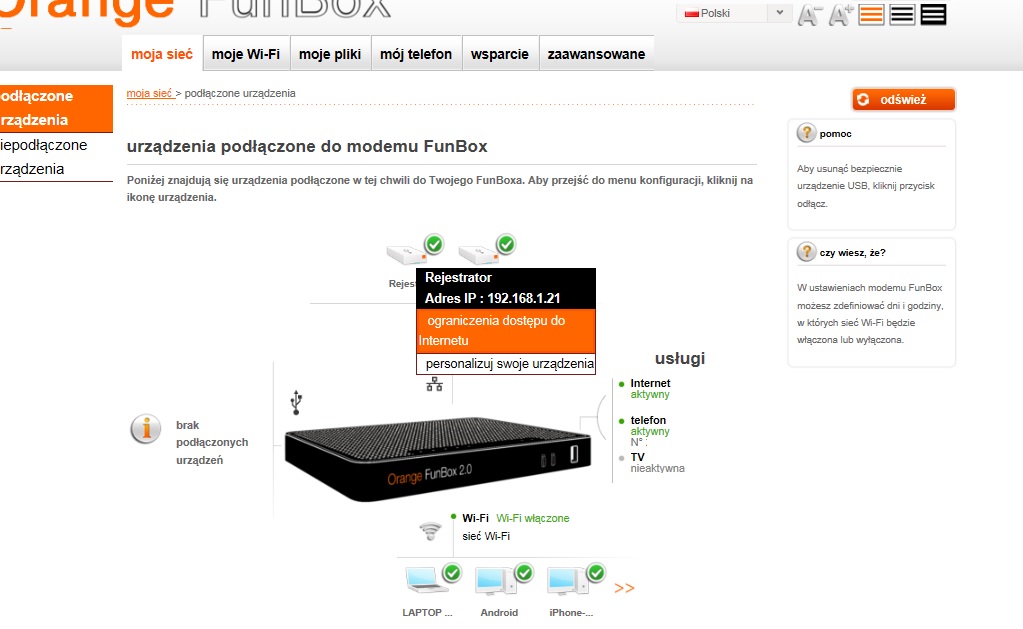

    Orange exchanged my Livebox router for FUNBOX. Here, in fact, in IPV4 I have access to everything.
    I set Configuring LV-AHD840 Recorder for Mobile Preview via LIVEBOX 2.0 / Funbox 2.0 and vMEyeClouds NAT / PAT:
    Other settings - as above in the pictures. Plus in the recorder I added a new type access account (example) admin1 with the same password.
    This account and password by typing in a phone application - it still does not give anything.
    I started to check the settings and cables again (even with the cable from the recorder another device (router) and works fine. CONCLUSION - The cable is ok). But two questions came up to me:
    - in the BCS configuration instructions, besides setting the IP address, gateway, subnet mask and TCP port (I have 37777) I see that the UDP port appears. There is no such menu in the recorder menu. As it can be seen above, it redirects it to 37778 in Funbox. Is this not a default from the other UDP can in the recorder and after the protu bad redirects?
    - after removing the RJ45 cable from the recorder I noticed a disturbing signal: although there is no cable in the recorder - diodes (yellow and green) with an empty RJ45 socket all the time they glow with constant light. Is this correct? In each router, another RJ45 socket, as long as there is no cable - there is no blinking / illumination of the LEDs. Why do they shine? Maybe something damaged in the recorder?
    I will be grateful to any suggestion.

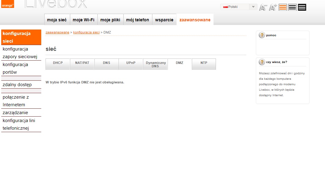

  • Suggesting DMZ access without DDNS or IPv6
    #14 16628521
    Heinzek
    Posts: 3732
    Help: 554
    Rate: 494
    Flashing LEDs are quite disturbing, but if you get to the recorder locally from your computer, it means that the connection works.
    From the screen shows that the ports are properly redirected, (firewall on the funbox disabled?)
    even without a ddns domain, you should be able to access it from an external IP.
    You can still delete port forwarding and enter the IP address of the recorder into DMZ. Now you have a login without ipv6?

    I do not know what we mean by getting into the recorder - only in the Funbox menu I see that the object is connected to IP 192.168.1.21 (I assigned this address permanently). I will not go there in any other way.
    Login I have without ipv6 and it certainly works on IPV4 because I do not have in the address: lower screen: Configuring LV-AHD840 Recorder for Mobile Preview via LIVEBOX 2.0 / Funbox 2.0 and vMEyeClouds
    I have zapore at low level. (picture). If I were to move to the user level (below) there is nothing set up:
    Staying at home, in the same network, say login on the phone by 192.168.1.21. It does not log. After entering 192.168.1.21 - the site is not reachable.

    Perhaps it can actually be a storm (as you wrote it - I associated it), because about a week ago (then it stopped working) all neighbors and I also got traffic jams in the houses. Some people burned televisions. Nothing at all. , but as you can see, it is possible that something fell ... The only thing left is the dedication to the service. Because LAN is (you can see it in FUNBOX) but it definitely does not work. Thank you for your help.
    Still for all LIVEBOX users: if after switching to IPV4 mode you do not have access to NAT / PAT and network security (as I did above) - this equipment is to be replaced. This was confirmed by the ORANGE assemblers.
  • Ping test to verify recorder network reachability
    #18 16628667
    dawidedziu
    Industrial cameras specialist
    Posts: 3009
    Help: 500
    Rate: 642
    The easiest way to check this is with ping. Hold Windows Logo + R, enter "cmd" in the command. Then enter "ping 192.168.1.21 -t" or "ping 192.168.1.21:37777 -t" in the open console.
    You should get something like:
    Response from 192.168.1.21: bytes = 32 time = 5ms TTL = 64
    Response from 192.168.1.21: bytes = 32 time = 4ms TTL = 64
    Response from 192.168.1.21: bytes = 32 time = 7ms TTL = 64
    If you have something like this:
    Response from 192.168.1.15: The target host is not reachable.
    Well, something wrong with the recorder.
    Alternatively, try to restore it to the factory settings, although I doubt it will help.
