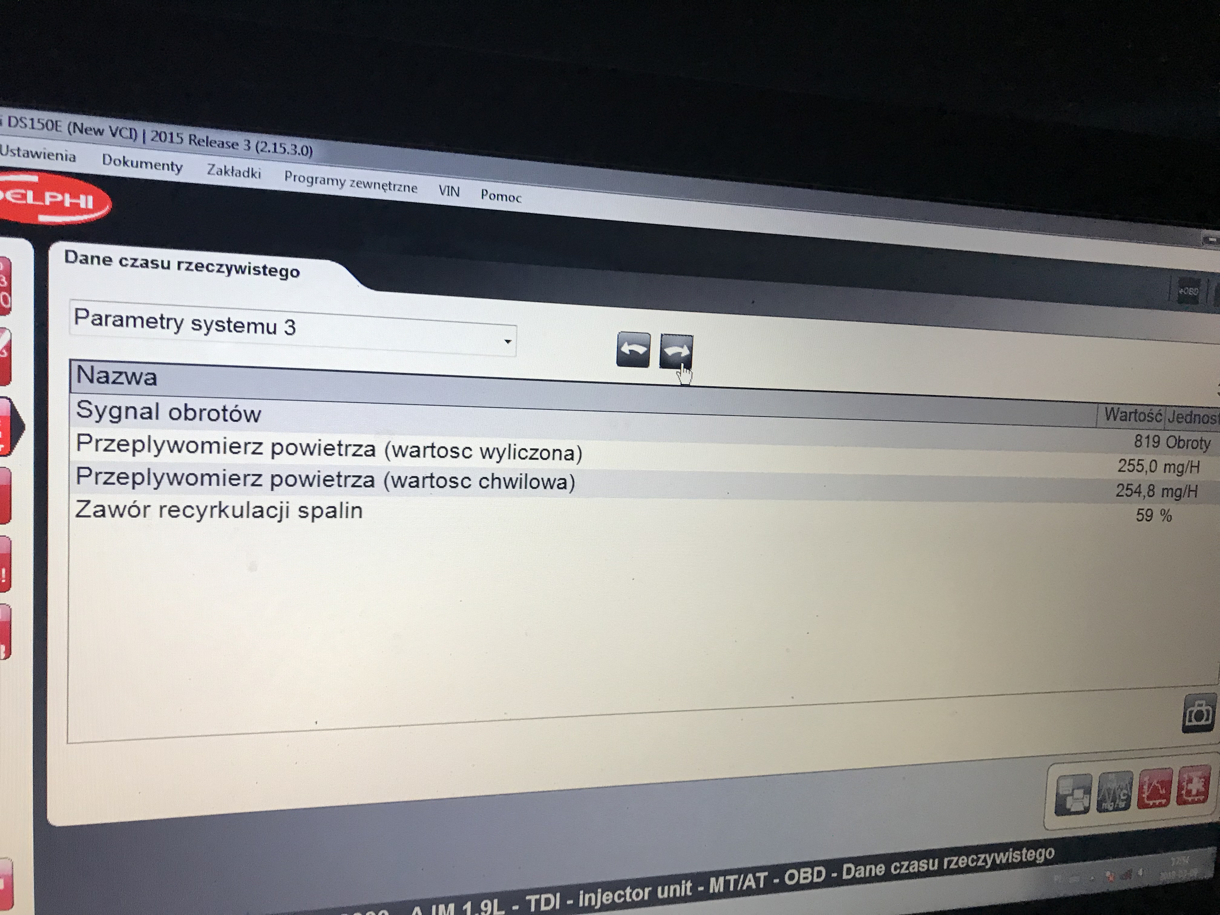

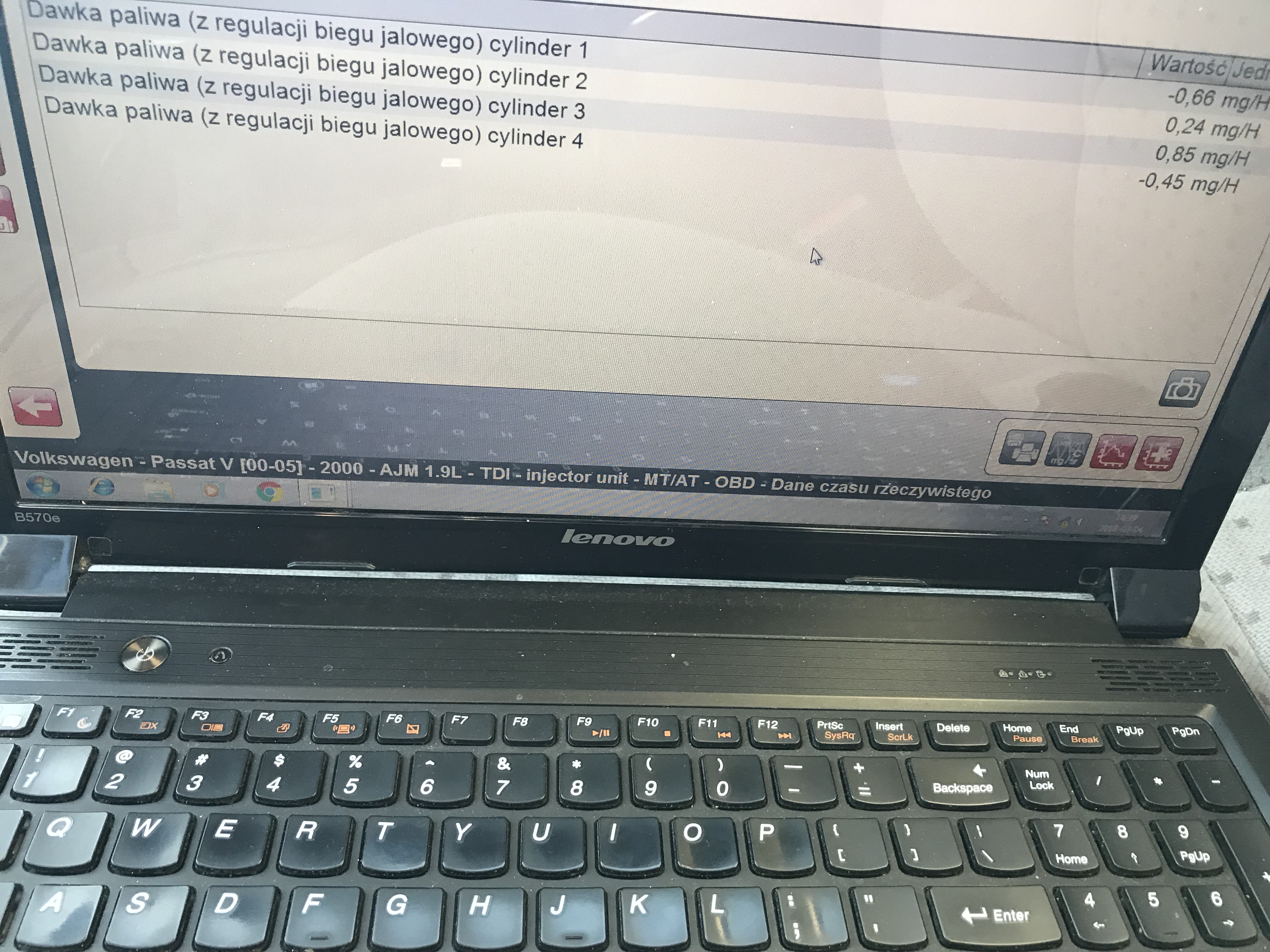

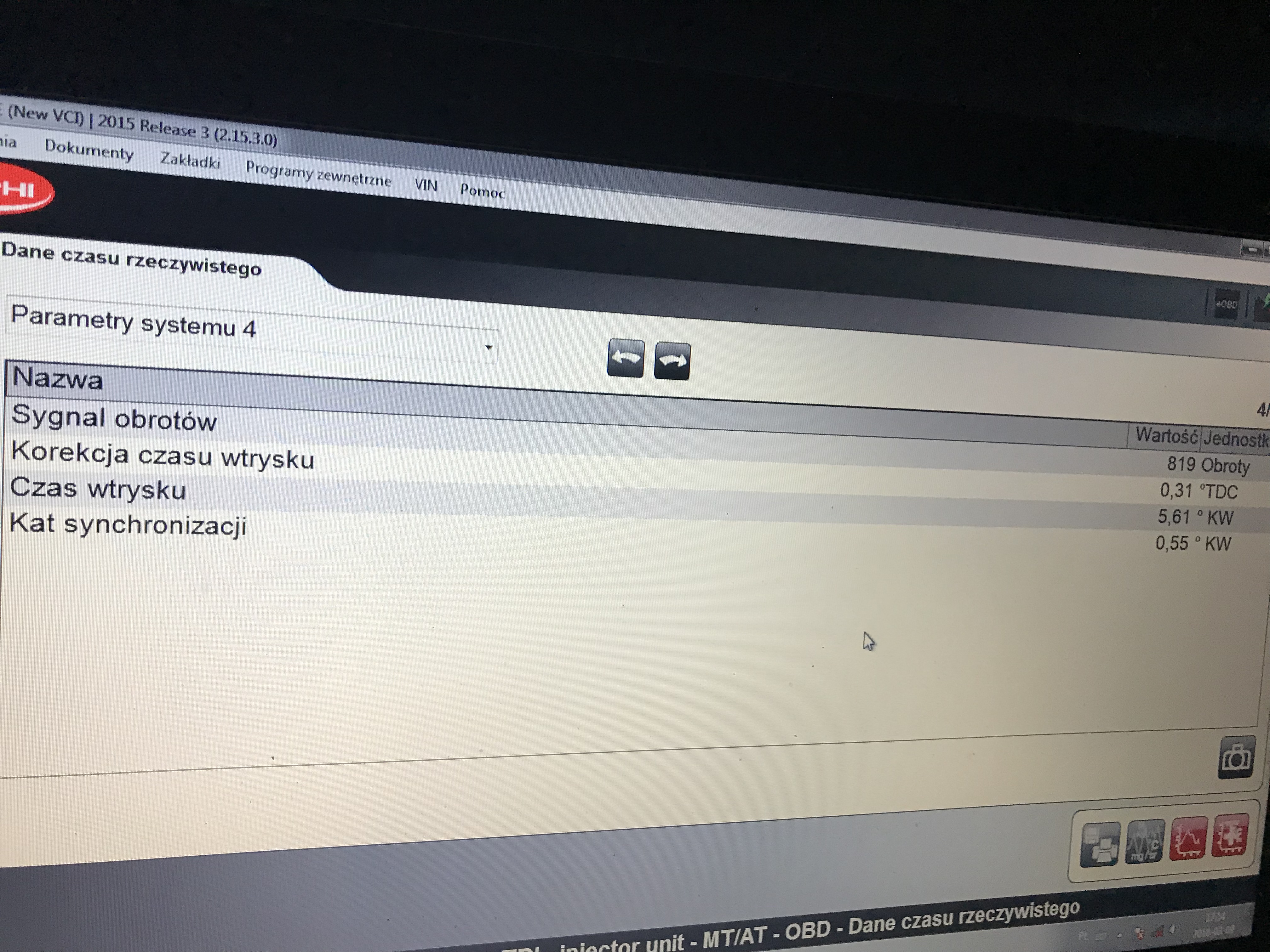

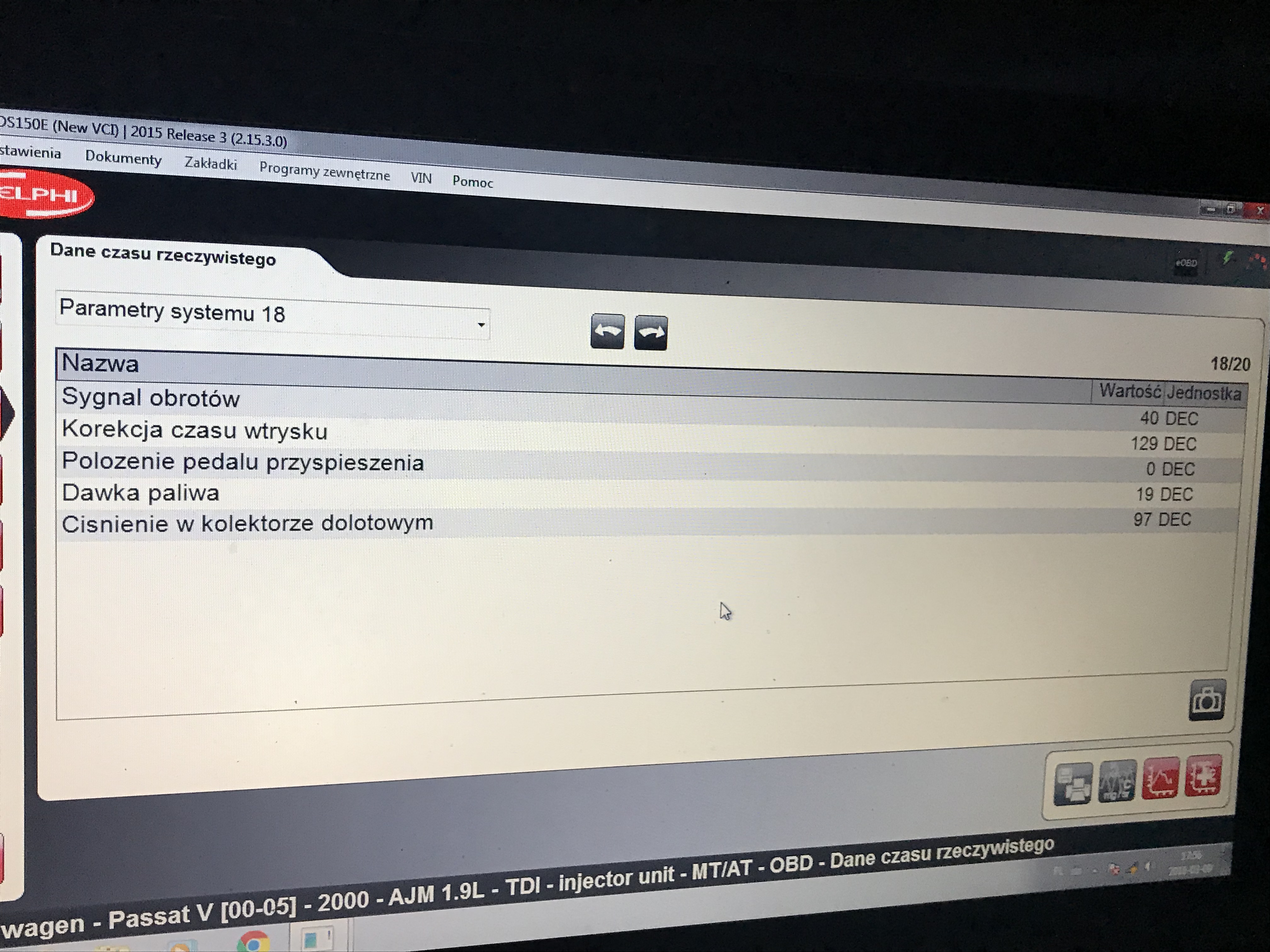

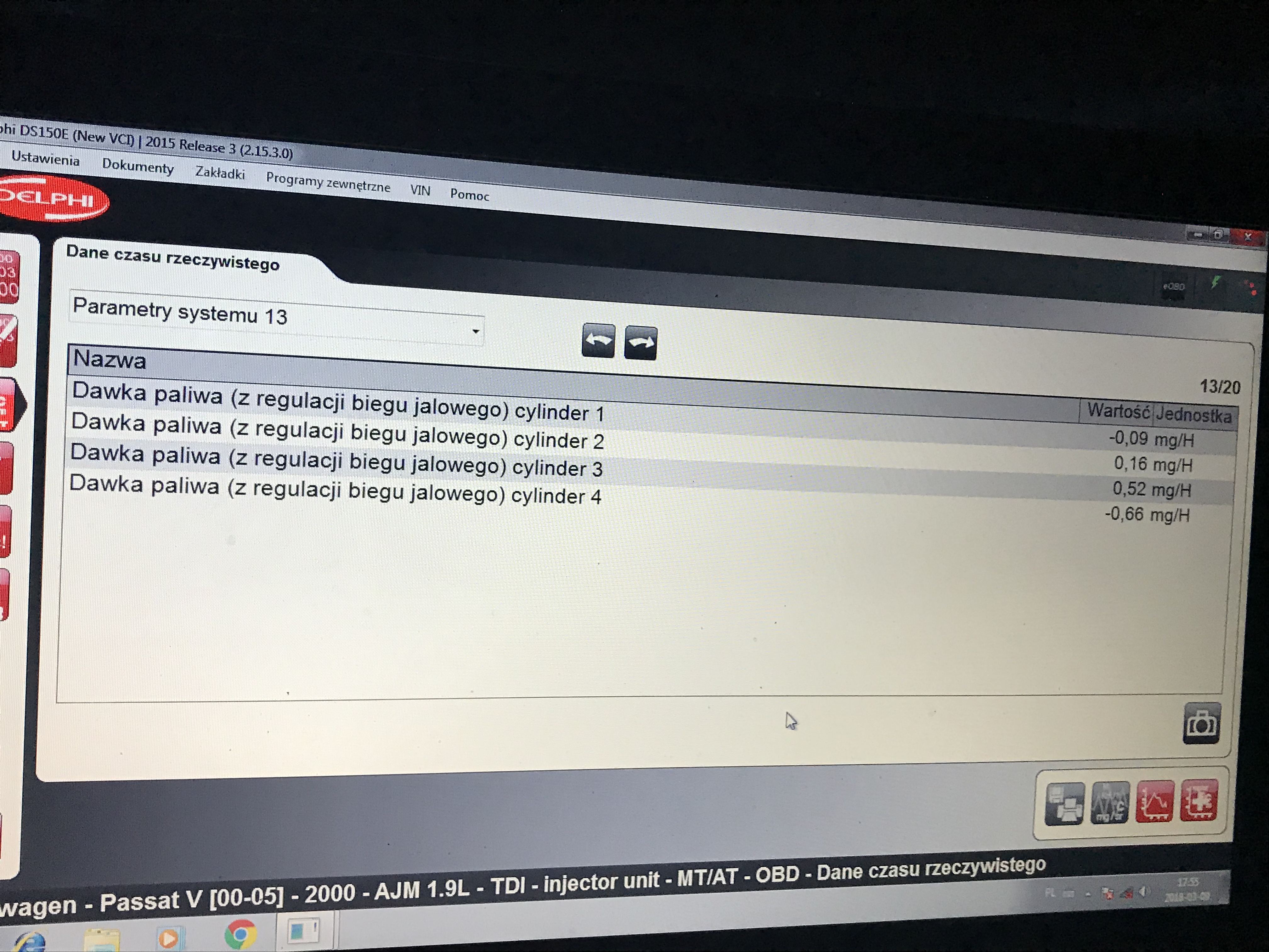

    Gentlemen, the problem is as follows. The car is freshly bought, it starts to tug when accelerating, it happens especially in the lower rev range. The computer did not show any errors. Correction of injection ok, however, it was found a poor dose on the 3-stroke pump. Changed for a used but tested, new fuel filter and zero improvement. The previous owner said it was the fault of the inner joint, but my mechanic, after checking the play, ruled out. Due to the fact that the mechanic at this moment breaks down his hands or proposes to exchange the rest of the injection here, I am asking for some suggestions on what to do next. I'm throwing photos from my computer. The last photo is the correction before the injection replacement.

    Possible leaks in computer and turbine pneumatics. Leakage of the fuel supply system on the suction side.
