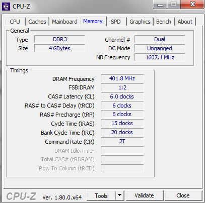

    First of all, specifications:
    *. Picture attached for information.
    0. I don't know the brand or model.
    1. * The motherboard is ASRock N68-S3 UCC, and the BIOS version is American Megatrends Inc. P1.40, 12/12/2010.
    2. * Processor is AMD Athlon II X2 245.
    3. * Graphic card NVIDIA GeForce GTX 750 Ti.
    4. The power supply is Corsair VS450.
    5. * Temp. is currently 43 degrees. Generally, it shows the program from 41-43 degrees when only the browser is enabled.
    6. * System is WIN 7 Ultimate 64bit.
    7. Antivirus is Avast Free.
    8. * (SMART) At ID C6 - The number of unresolved errors pops up ATTENTION (yellow icon)
    I don't know if it's needed but gives everything; Current: 200, Worst: 200, Threshold: 0, RAW value: 000000000001.
    9. * RAM memory has 4GB.
    * More detailed information.

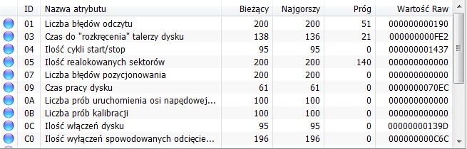

    Here are SMART screenshots
    PC Freezing Every 30 Minutes: Causes & Solutions for New Power Supply & Graphics Card Issues

    Temperature definitely too high, cooling for cleaning, thermal grease for replacement, cooling for re-installation.
    The procedure with the MHDD program is still to be carried out, as I wrote earlier (excluding zeroing the whole to the beginning).
