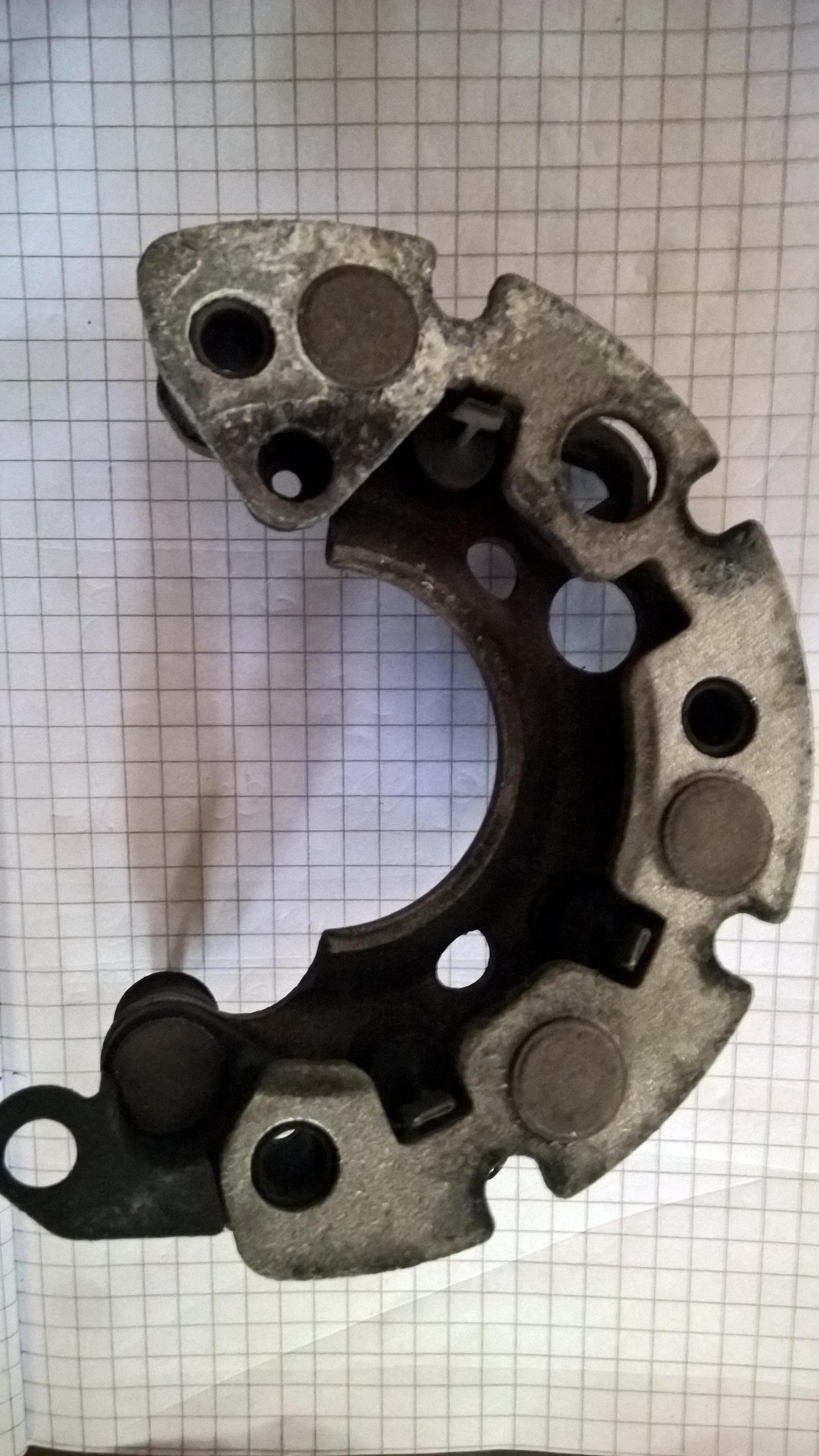

    I have a bridge from the 12V alternator from the Ford Fiesta MK4 (Magneti-Marelli) to check - it is a simple 3f bridge composed only of 6 main typical, push-in diodes, there are no small excitation LEDs in the bridge. Checking 12V Ford Fiesta MK4 Alternator Bridge: Magneti-Marelli, 3f Bridge, 6 Push-in Diodes
    I have the bridge pulled out, I check the power supply from a small 3-phase transformer (phase-to-phase voltage approx. 35V), but after connecting any two phases
    5.5A current flows, of course the bridge output is not connected. Is this definitely a fault, more specifically a short circuit in the bridge?
    regards! Tida

    At 99% yes, check with the meter on the diode test then you will know if 1 of the diodes is damaged or more.
    Buddy, you made 2 mistakes, 1 is too much voltage, the other is alternating voltage.
    Test with a constant 12v and a bulb.

    Ok, then I will modify the test circuit, put in series with each phase, it hits the diode in the forward direction.
    This will slightly lower the voltage and give a constant ripple, not alternating voltage ... can it be?
    Nevertheless, when I check such a typical "cube" - the 3f bridge does not flow, and these bridges are the same.

    As they say to you "test with constant and light bulb" you are up to it. These "car" diodes can conduct in the reverse direction from about 26V for 12V bridges. Take a 21-50W light bulb, a battery or a 12 V power supply, each diode is conductive on both sides and the matter is done.

    Hmmm, I can check each diode separately, but this is about checking the entire complex 3f bridge (without desoldering the diodes).

    If there is no stator, what's the problem? . You can check each of them separately, even though they are bridged 3.

    Ok, so in the existing 3f bridge system I check each of the 6 diodes with 12V DC with a bulb load.
    The remaining bridge diodes, although physically connected to the diode under test, will not affect the measurement?
    It will be such a scheme, we change - we only reverse the current source?

    You take 12 measurements and you already know a little about the bridge.

    Because you have to find out if a given diode is conducting '' I '' in the second measurement or if there is no short circuit.

    Measure with battery and 55w bulb. Each one separately

    Ok then problem solved, thanks everyone!
