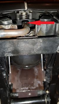

    #13 16324510
    rosos
    Posts: 25
    Rate: 31
    I undressed the espresso machine and identified the leak. As you suspected there is a leak from the multivibration valve. Below the photo and the place of leakage marked.
    Nivon 757 Coffee Maker Issue: Water Accumulating in Coffee Grounds Tray
    What can you do about it ??
    As for the lack of coffee in a mug is another fairy tale. I found the problem. The water flies through the brewing unit.
    Below is the movie.
    link
    What could be wrong?
  • #14 16325402
    nioop
    Home appliances specialist
    Posts: 3359
    Help: 503
    Rate: 3339
    The multisaw can only be replaced.
    I got tired of downloading this movie :) And I did not see anything there ...
    Is it not a drain / drainage valve that leaks? Please, light the flashlight and locate the leak point and replace the damaged element.

  • #15 16325544
    rosos
    Posts: 25
    Rate: 31
    Where is the drainage profession ?? I have downloaded the film without any problem, the film shows how the water is coming from the places marked on the photo.
    Nivon 757 Coffee Maker Issue: Water Accumulating in Coffee Grounds Tray [/ Img]
  • #16 16326014
    nioop
    Posts: 3359
    Help: 503
    Rate: 3339
    You can see the water, you can not deny .. you can not see the place where it flows. It will be difficult to grasp, therefore, it suggests that visually the Lord himself will check which element is leaking.

  • #17 16333670
    rosos
    Posts: 25
    Rate: 31
    The water flies from the brewing machine, in the picture I marked the place of the leak.
    Can anyone know what the reason is?
    Maybe someone has already encountered such a problem.
