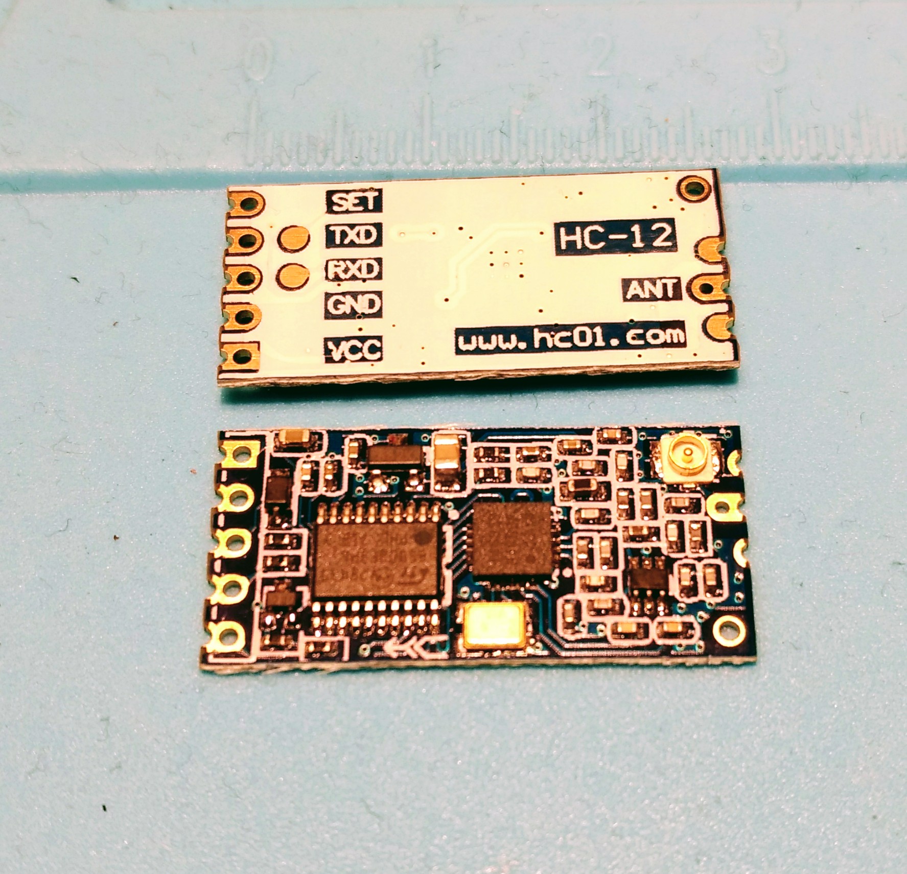

  • #10 16844196
    Lech450
    Posts: 23
    Welcome,
    Both Lora bands, 433 and 866 allow 100mW or +20dBm operation.
    The second restriction, is 1% TX operation time, and 99% RX.
    This is the requirement, operating in this band, from Listen, before transmit , freely translated: "Listen, before you broadcast" .
    It's not so bad in the UK parliament there is a rule that only one speaks and the rest listen.
    So far, the LoRa bands are not so crowded :) .
    For your project you may still want to consider the HC-12 modules.
    Admittedly they operate in the lower band, i.e. 433MHz, but they guarantee a range of about 1km in standard configuration, but if you look through the documentation you will discover a slow transmission mode allowing you to double this distance!
    Price on AliE, about 2.3 EUR + 4-5 weeks waiting time at ;) .
    In the AVTSkshop more than 30PLN, but I have also found places at 29 PLN.
    A lot depends on the antenna and, of course, the antenna cable, because transmitting at such low power you need to take care to minimise losses and use all your strengths.
    The "springs" included in the set, use them at the launch stage at home (a few meters or maybe even communication through the wall).
    Another thing is to improve the shielding, as the module is obviously bare.
    Here's a link to the video page and a description of some code examples for the Arduino
    http://www.instructables.com/id/Long-Range-18km-Arduino-to-Arduino-Wireless-Commun/
    Good luck :)

  • #11 16858211
    vstm
    Posts: 149
    Help: 8
    Rate: 82
    A few months have passed and ...KUBA.... probably solved his problem but I want to add my opinion about the HC-12, it might be useful for someone. Lech450 mentioned this module in a previous post. I was looking for transceiver modules for my devices. I recently came across the HC-12, got it up and running and am delighted. At my place three of these work together. Clear, reliable reception, no rubbish when no coverage. I checked the range. A bare module without any screens. On „spring” at 9600 and 100mW it pierced several walls and still about 100m in the city. On the subject of range, a colleague from Brazil made a nice video: https://www.youtube.com/watch?v=nQ4qYwILRjA&t=419s On a piece of wire (16cm) he reached 1.3km in free space. Seamless launch, I'm really impressed. And the price in the range of 15zł. I bought here: https://www.fasttech.com/products/1099/100434...2-433mhz-100mw-si4463-wireless-remote-control And that's as much as I euphorically wanted to pass on to you. Regards.

    Sure it is. But e.g. such a Lora is 4-5 times more expensive than an Hc12 which is not insignificant when you buy by the dozens. We are still talking about ~500m communication. One more thing. I attached (on contact) a car remote control(433) to the HC12 module receiving the signal from the other Hc transmitting from behind the wall. The receiving Hc ignored the interfering remote control and cleanly received what was transmitted to it. A shock to me.

    Lech450
    Posts: 23
    Just a small point, the HC-12, is probably one of the cheapest modules with the Lora protocol and it works. The protocol itself is supposed to work so as to be immune to most common interference - including interference.
    You can also look for early versions of Hope RF modules, e.g. RFM22 or similar, but the price may be less attractive and the mask will not be 2.5mm, but denser.
    There are also other options, such as the 2.4GHz band - but not yet WiFi / BT, but here achieving a range of 500m may already be a challenge in the city.
