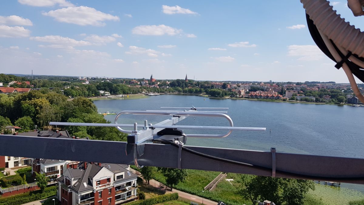

    The receiving part consists of an SX1276 chip connected to an ESP32 on a WT32-ETH01 module and a DC/DC converter powering the whole thing from a 24V passive PoE adapter. The software receives and decodes the signal and then transmits it to the server, creating something like a 'LoRa gateway'. I have built two such gateways: one is connected to a Diamond X30 vertical antenna and the other to an ATK-5 dipole antenna in horizontal polarisation. Both antennas are mounted on a 55-metre stadium light pole, although the location is not ideal as it is at the lowest part of town, right next to the lake. I used about 2 metres of H155 cable at the antennas. In addition to receiving data from the ether, the software on the 'gateway' also allows transmitting and changing the radio configuration. In addition, it has a simple web interface for monitoring the status of the device.
    Screenshot of the ESP_LoRa GateWay interface displaying module parameters and information. .
    View of a lake with a radio antenna in the foreground.
    View of radio antennas mounted on a pole above a lake. .

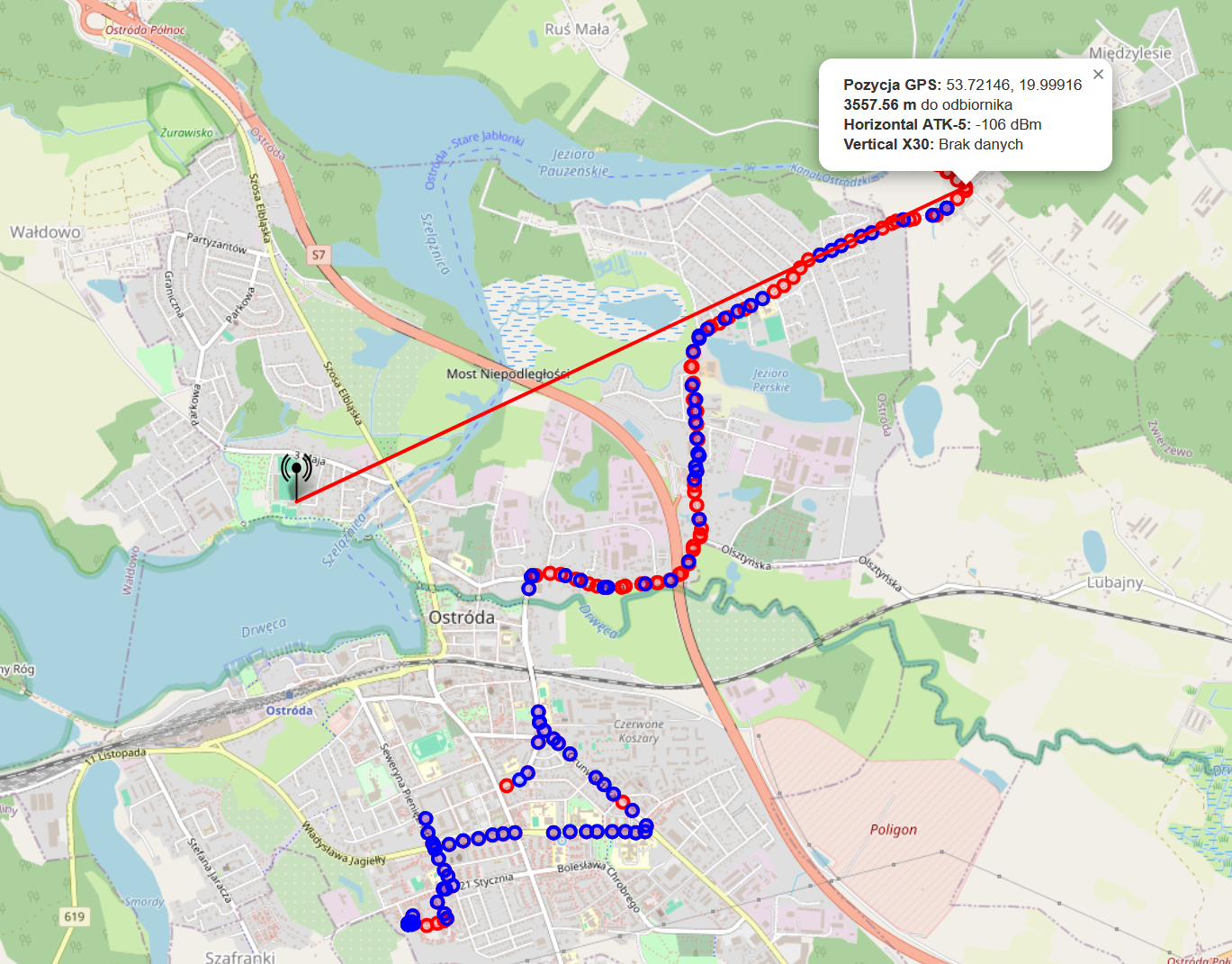

    The first transceiver created to estimate the potential was a locator built with ESP8266, SX1276 and NEO6P GPS module. The software in this device first waits for a GPS signal and then formats it into a string such as: "51.16960*69.95865*0" (position and speed). The entire string is encoded with the XOR function, a checksum calculated from the ASCII codes of the entire string is added, and then the whole thing is sent over the radio. Depending on the speed read from the GPS, the device goes to sleep for a certain amount of time. If the speed exceeds 30 km/h, the device does not go to sleep, but sends a position every 5 seconds. The time it takes to send such a string depends on the radio's configuration. I placed the whole thing in an electrical box, which, although it does not look aesthetically pleasing, works properly. The device powered by three 18650 cells works for 4 days. The first tests showed the great potential of this solution, as illustrated by the attached range map.
    Coverage map of radio devices around Ostróda. Map showing radio signal paths around Lake Drwęckie.

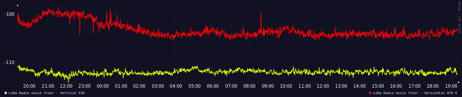

    In addition, I am measuring the radio background on the frequency 434.250 MHz, on which I am currently experimenting. I am attaching the temperature transmitter code, maybe someone will have interesting suggestions.
    Noise level graph for X30 and ATK-5 antennas. .

    @dktr what do the red and blue circles on the map mean?
    What kind of map are you using? I used to train geoportal for a similar game.

    >>21171035 The colour of the dots indicates which receiver received the signal, blue dot both receivers, red dot one receiver. I always use openstreetmap because it has a nice api and you can se locally host everything including map files.

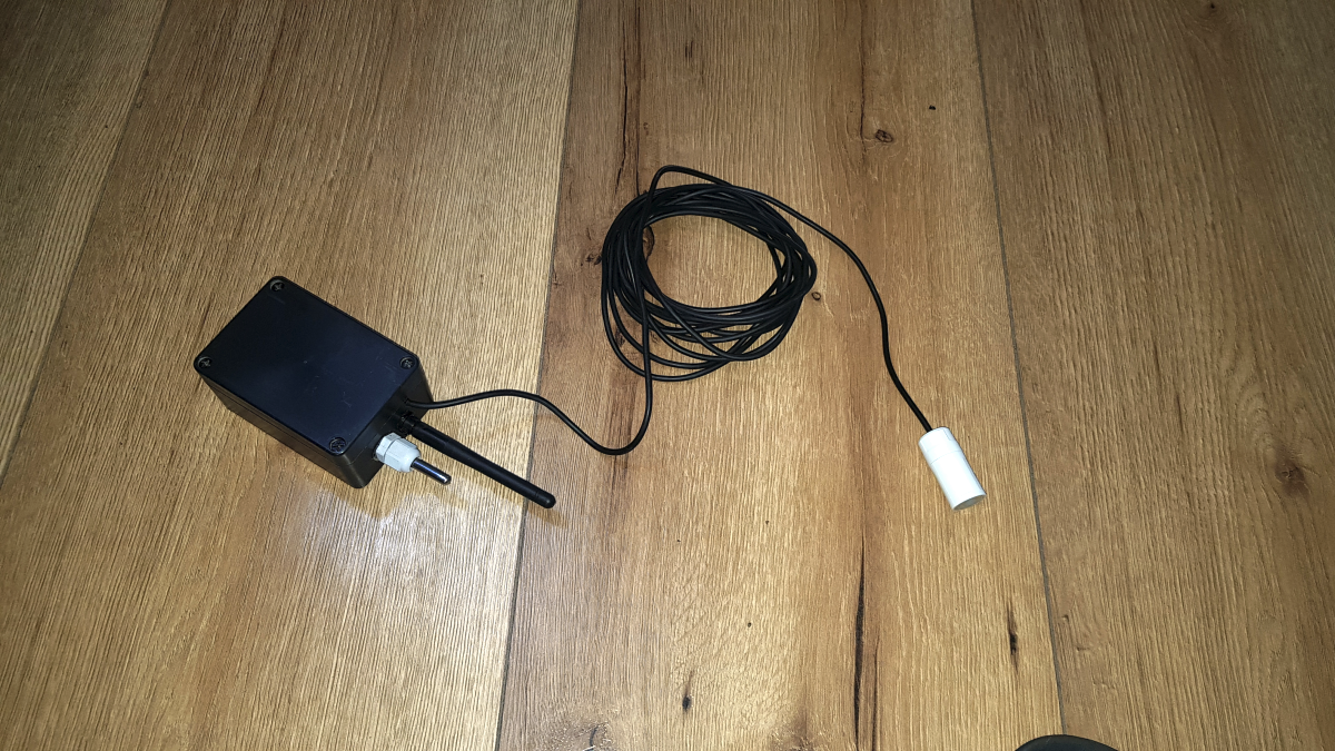

    The device that sends the measurements is STM32G030F6P6 + SX1278 and two DS18b20 pieces, all powered directly from a 3.6 V 17 Ah lithium battery without any stabilisers along the way. I have previously used an ESP8266 in such a configuration and was not able to go below 25 μA in sleep mode, then I tested an RP2040 and it was a total failure as it was something around 100 μA, an ESP32C3 9 μA, and this STM 3.9 μA, I still have the WCH and nRF microcontrollers to experiment with, but that will be in my own time. The sensor sends a measurement every 300 seconds or so, the STM has an internal stabiliser which it uses to measure the voltage the microcontroller is powered by, it works surprisingly accurately in the 3.6-3.0V range I'm interested in.
    Black module with antenna and sensor on long cable placed on a wooden floor

    Interesting results, how did you measure the current draw of the new design?

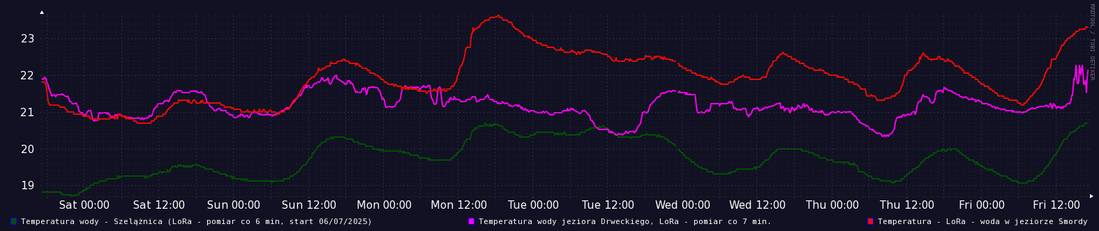

    >>21616840 I doubt it. I did this to satisfy my curiosity and see the annual temperature graph ;) .
    Water temperature graph from three lakes measured via LoRa over one week
    >>21616839 Theoretically, it should last about nine years. The unit itself is in an airtight box and any holes are only on the underside - the antenna, the cable to the sensor and the sensor itself. On the map is what is intentionally not exact - strongly approximated, although a little patience - a measurement every 300 seconds a few seconds, a trip with the radio and you can locate, the only ones who move there are fishermen, I hope no one notices, it hangs quite high on a tree and the cable is hidden. The sensor is a DS18B20 I use dozens of them, I even calibrated some in an accredited lab, from what I remember they had an error of about +0.3°C at 20°C and -0.1°C at 0°C. In Lake Sajmino I think someone fished the sensor out and it's floating by the reeds, I need to go there and see what happened.
    >>21616369 With a UNIT UT-70B meter

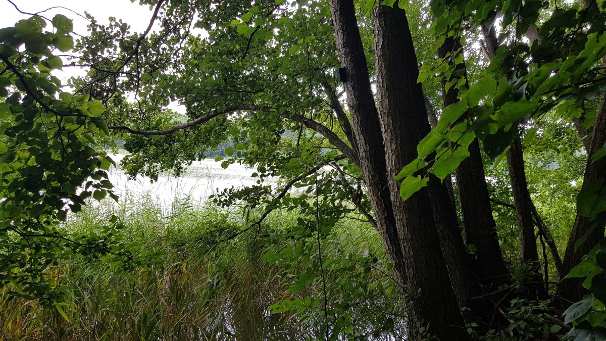

    >>21618277 Only that this would already have to be standardised somehow - measurement at a specific depth etc. Currently I am trying to place the sensor so that it is near the bottom at a depth of 1m. Today I added Lake Pausenka, where there are a lot of reeds near the shore and it is generally shallow, so the sensor is on as much as 30m of cable in a small glass jar flooded "under the cork" with hot glue. There are still Morliny and Szeląg lakes left, I think there will be no problem with the range even though it is over 8km, currently the furthest sensor is in Górka - 6.5km and the reception efficiency is 100%. I am still planning to make a "measuring tube", i.e. a few dallas one under the other at a fixed distance so as to have a temperature measurement at a specific depth, the whole thing encased in resin to make it airtight. In the photo, the device is attached to a tree near Lake Pause.
    Device attached to a tree by a reed-covered lake shore, Pauzeńskie Lake .
