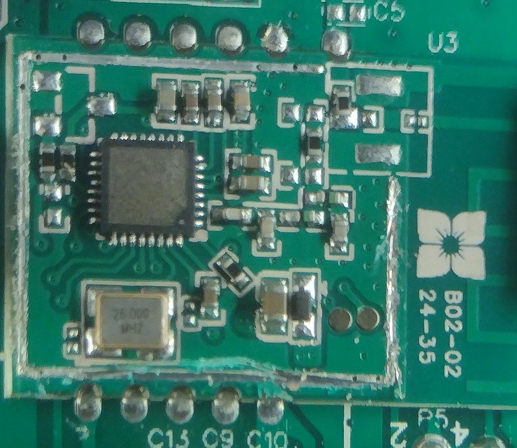

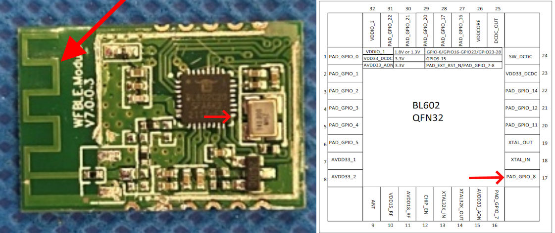

    Hi, I was wondering if anybody here knows which MCU is used on this board.
    It is a Wi-Fi/BLE chipset, but the markings have been erased on the chip.
    Here are some pics.
    Close-up of green PCB with integrated circuit, capacitors, and 26 MHz crystal oscillator
    Green PCB with labeled pins and large antenna pad on right side.
    Any help would be greatly appreciated

    don't think I'm matching it to anything in their FCC submission pics.
    Have you tried powering it to see if there are any debug logs from RX or TX?

    Hello, and thanks for your reply. Yes, I have done that, but nothing shows up. I've tried everything from 9,600 to 115,200. I can't believe nobody has flashed this device; it comes with a whole lot solar inverters.

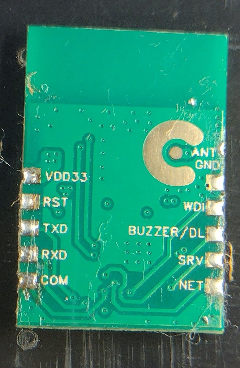

    what about the other pads? COM, or DL = debug log?
    what's the exact solar inverter make/model?
  • #5 21777318
    bigote
    Posts: 7
    Those other pads are status LEDs for the rest of the module; I wouldn't know what to do with them since I lack scope or any other equipment.

    Ok I thing I made some progress, I found this on device report.
    It's a pdf file with pics of the internals where you can clearly see the buffalo labs logo on the chip, but the pic is not hi res to tell the actual number.
    I went on to download BLdevCube tried different chip options but always get "fail handshake" I believe it might be because the boot pin is not being activated as I don't know which pin it might be.
    Any ideas are welcome.
    thanks
    • int-pic.pdf (1.89 MB) You must be logged in to download this attachment.
  • #8 21780595
    Posts: 5220
    Help: 449
    Rate: 918
    nice find.
    trace where IO8 goes to with multimeter?
    Wi-Fi module labeled WFBLE and pinout diagram of the BL602 QFN32 chip
  • GPIO8 pull-up still leaves BLDevCube reading none

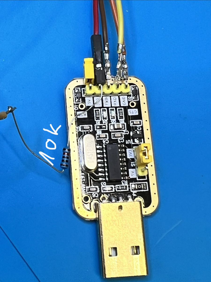

    #9 21780939
    bigote
    Posts: 7
    Hello again, and sorry for the late reply, but I guess we're on different continents.
    Thanks for the help so far, I did that, and GPIO8 pin 17 goes to pad labeled DL or download I guess.
    I have it wired through 10 kΩ to 3.3 V, but sadly same result, I still get "NONE" found when I do "Read ID" on BLDevCube software.
    My board is a little bit different from the one in the PDF if you look closely, but I would still believe it IDs the same MCU.
    Don't know what else to try anymore...
  • #11 21780986
    Posts: 5220
    Help: 449
    Rate: 918
    >>21780939
    tried swapping RX/TX round so RX->RX, TX->TX? Sometimes pads are labelled as to what they should be connected to, not what they are.

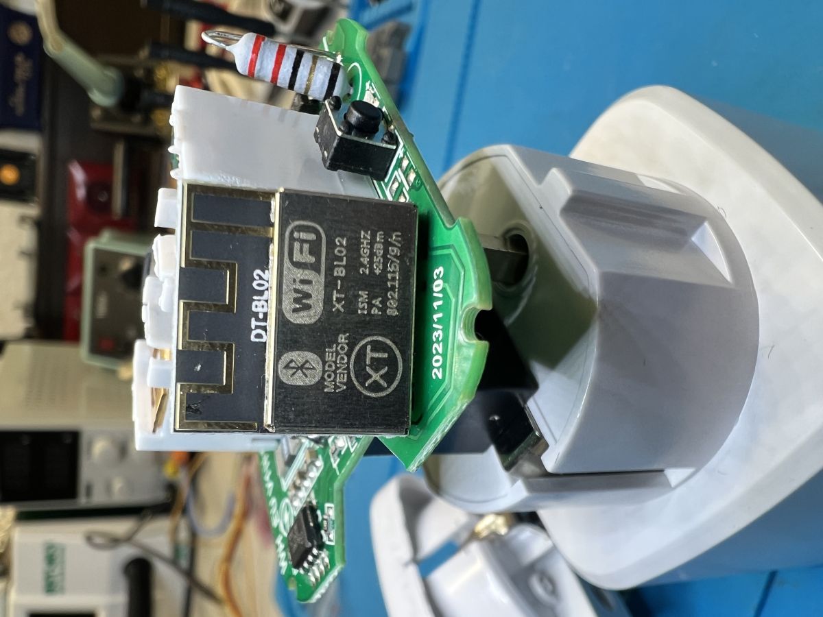

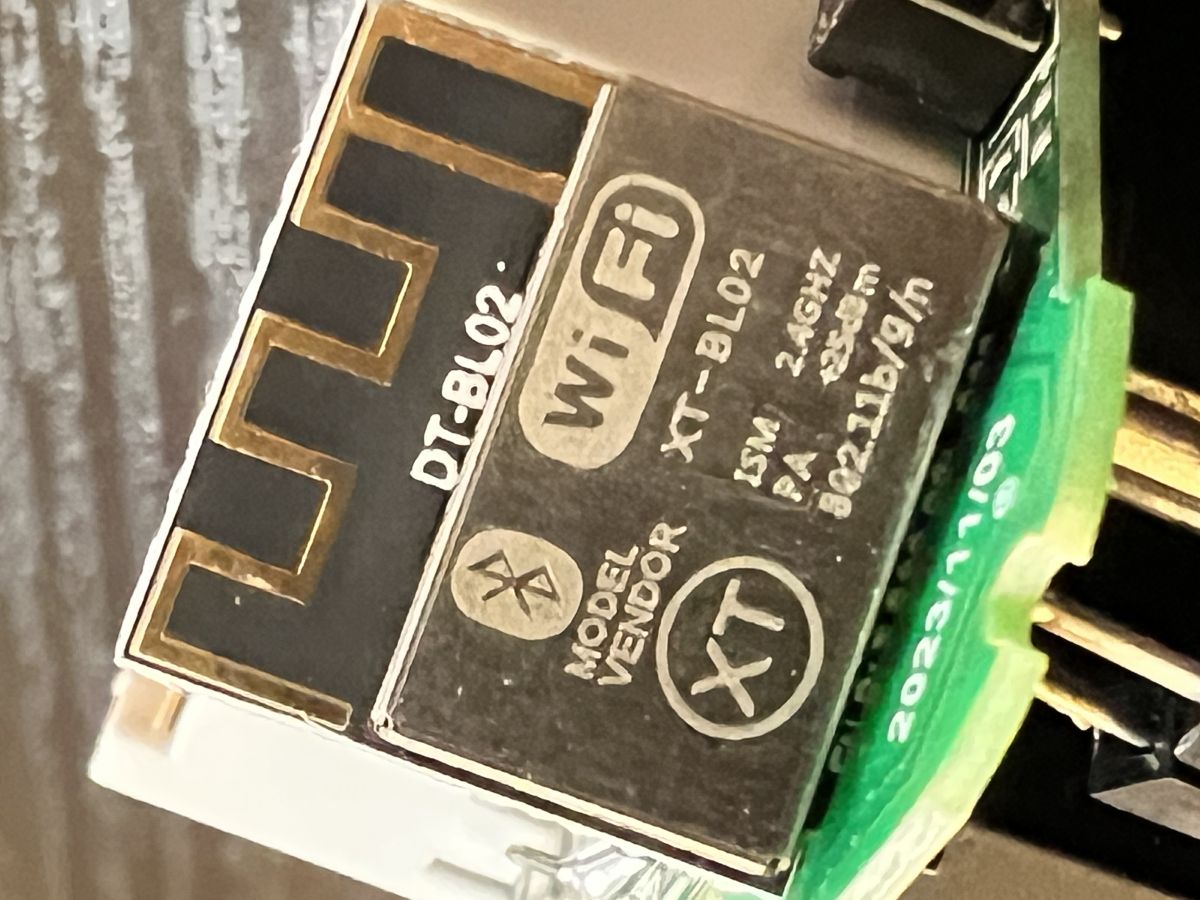

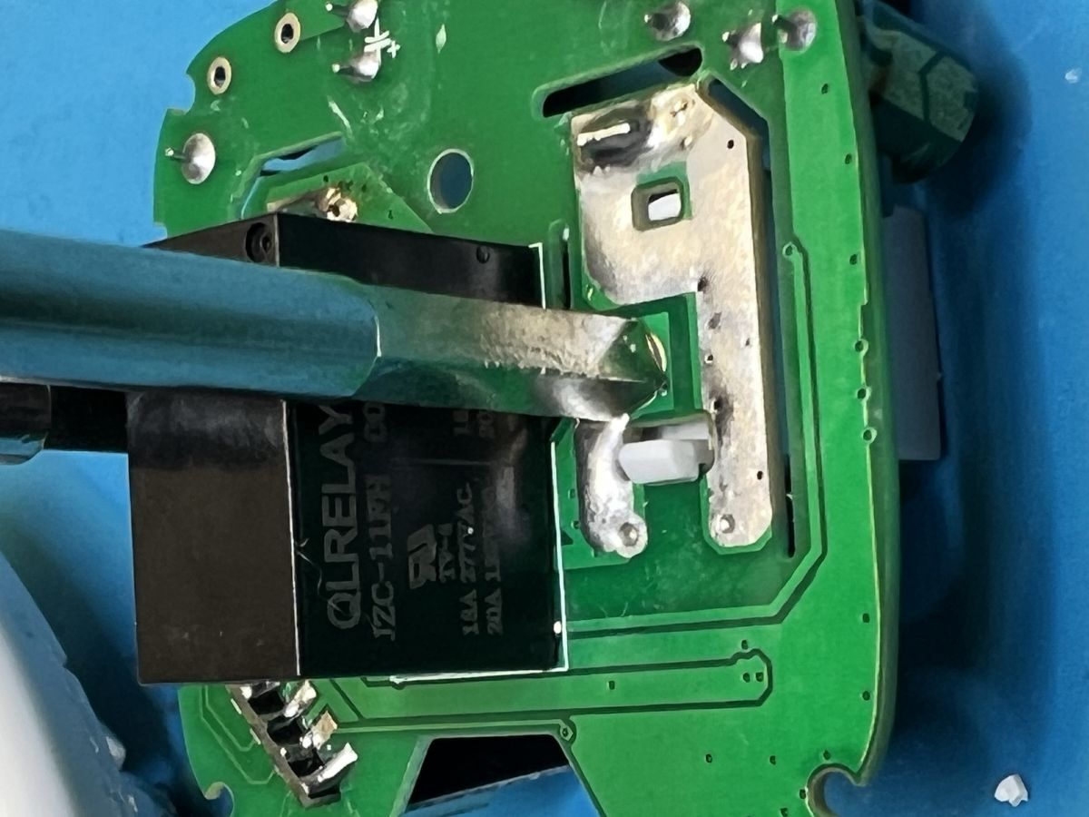

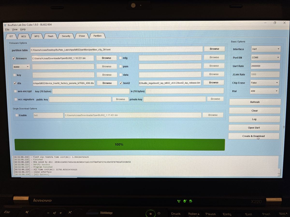

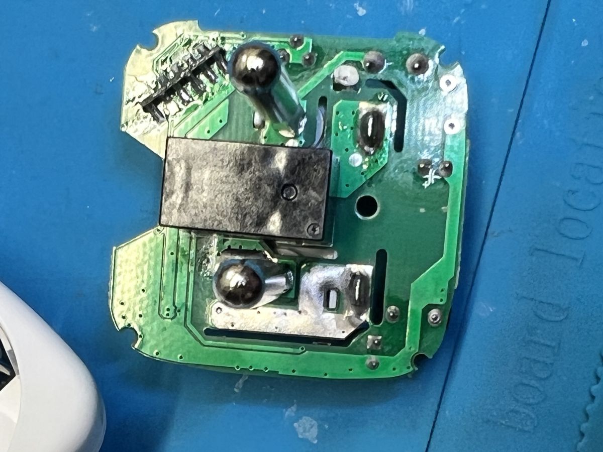

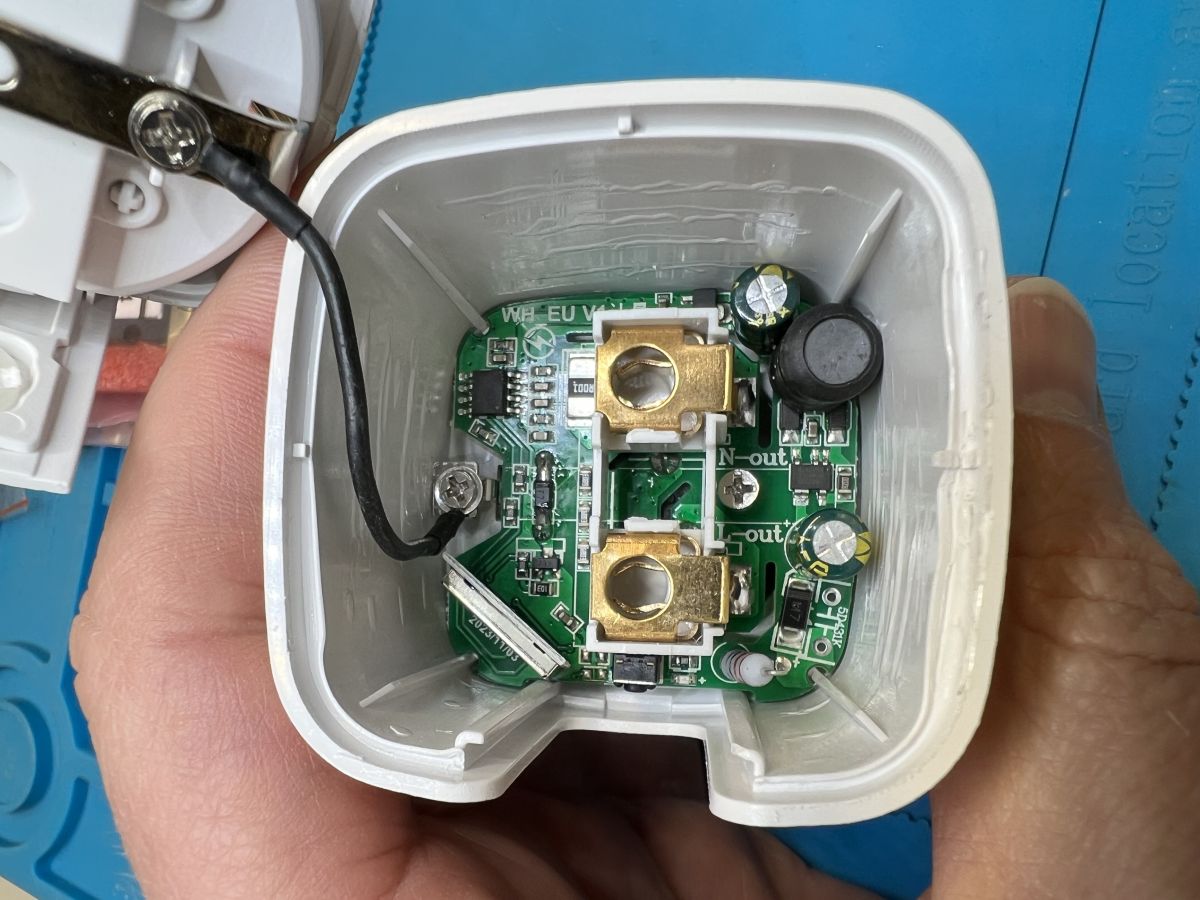

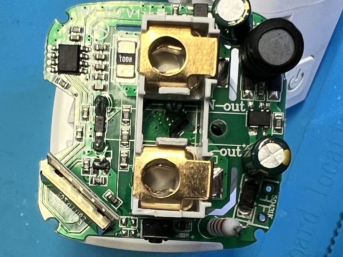

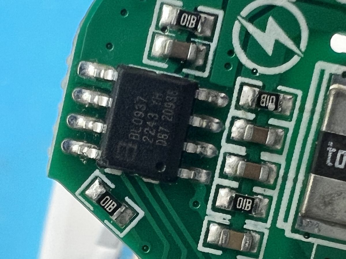

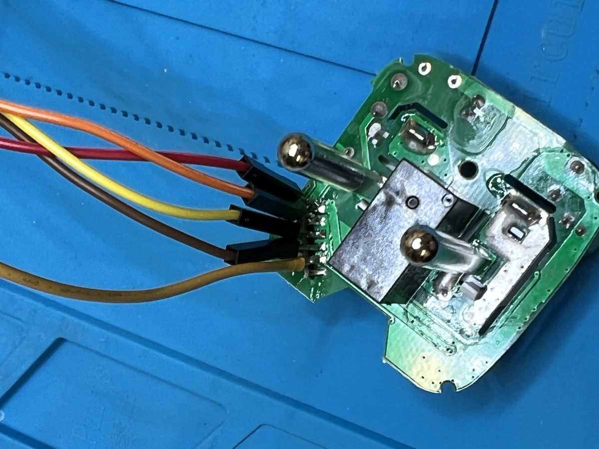

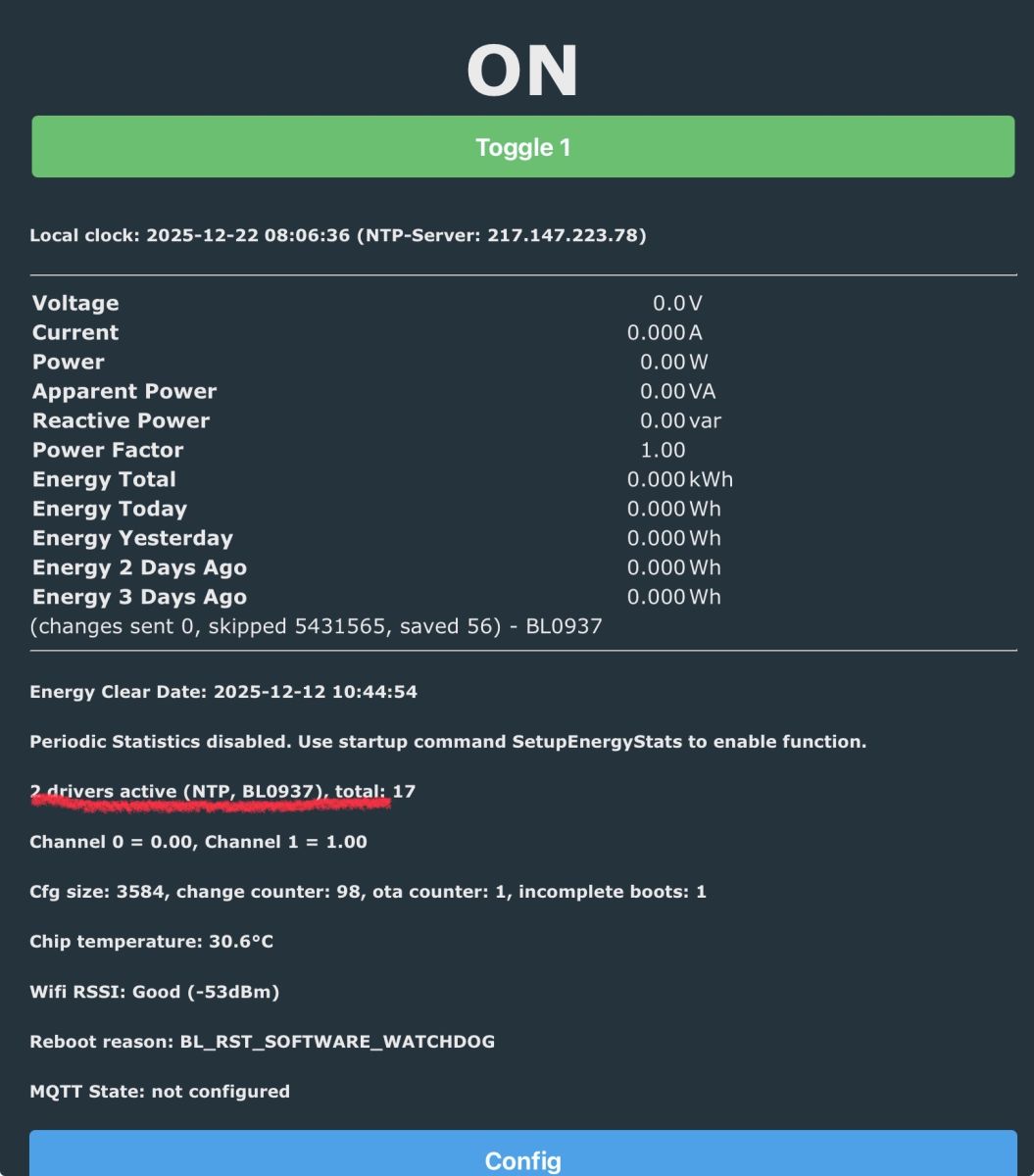

    I have 2 power plugs from Ali with XT-BL02 (BL602L20) BL0937 power meter. I flashed OpenBL602-Fw successfully but didn’t find a matching GPIO template, so I have to measure out by myself. Everything works fine so far except the power meter. I’m pretty sure my measuring the traces is correct, but I’ve no idea why the power meter doesn’t work. Driver is started.
    PCB board with power components and relay on a blue service mat
    Close-up of PCB with QRELAY component and uneven solder joints
    Inside of XT-BL02 plug showing PCB with electronic components and power terminals
    Close-up of BL0937 chip on green PCB with SMD components
    XT-BL02 module with resistor on power plug PCB with energy meter

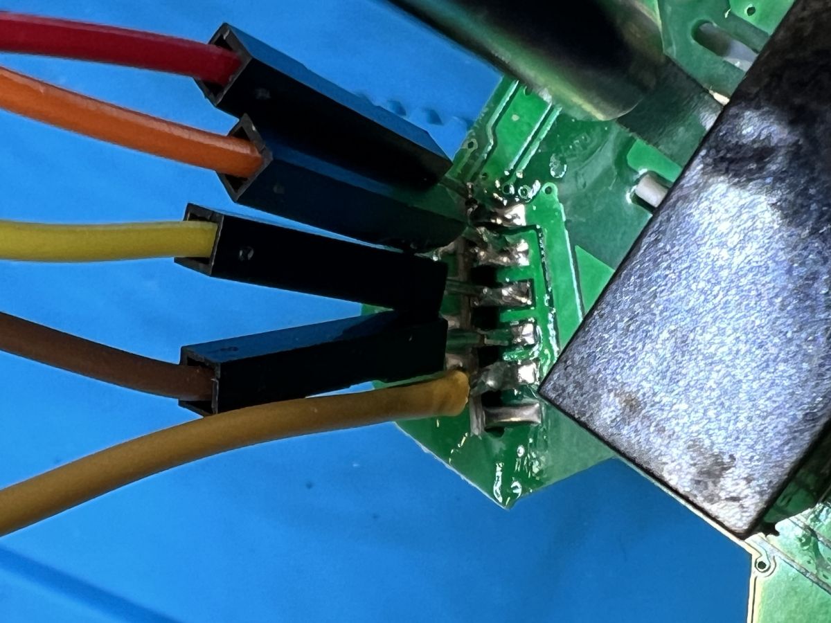

    Close-up of USB board with IC, resistor, and connected signal wires
    Close-up of wires connected to PCB via header pins with visible solder joints
    Close-up of circuit board with connected wires and power plug contacts
    Inside of XT-BL02 smart power plug with visible PCB and power measurement components

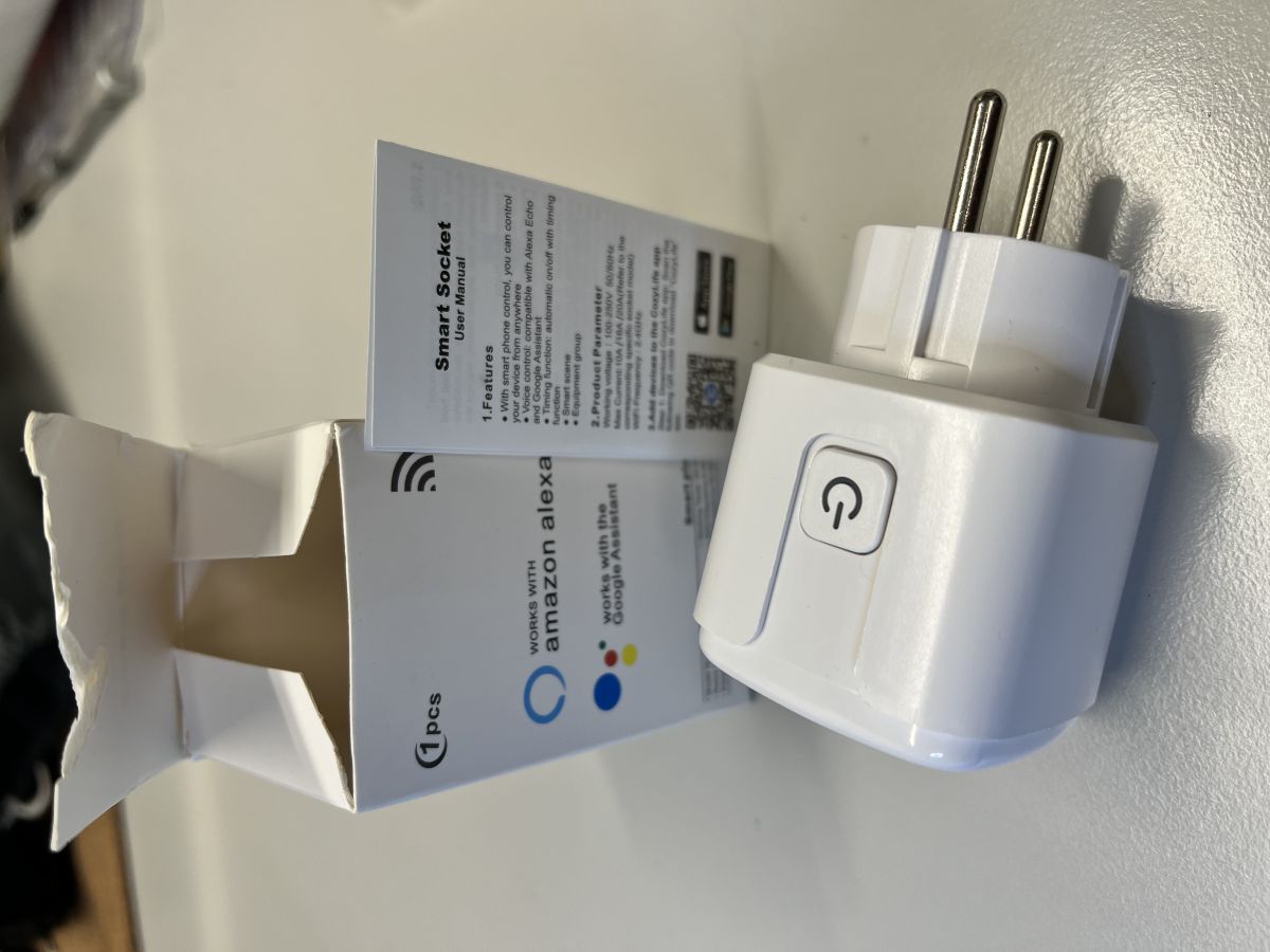

    Close-up of label on WHZ01-WC-20A-P smart socket packaging
    Technical label on power plug device with manufacturer and certification data
    White smart plug with power button and user manual next to opened packaging

    #15 21787175
    Posts: 14771
    Rate: 12914
    BL0937 should work on BL602. Are you sure you have correct pins? What do you mean by "doesn't work", does it show nothing at all, or is there a random output? Is the driver running?
    Here's idea - change the pin role from BL0937_CF to Counter, assign a free channel and observe, are the pulses seen by OBK? Is the target channel value increasing? Btw @divadiow if you have BL0937 you can also verify if it works, but I think it should. CF and CF1 pins of BL0937 are sending pulses and firmware counts them with interrupts, so Counter role should see them as well, as it is interrupt-driven.
  • Asking how to verify BL0937 pulses in OBK logs

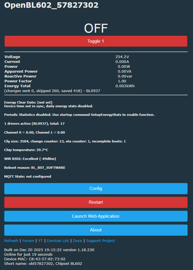

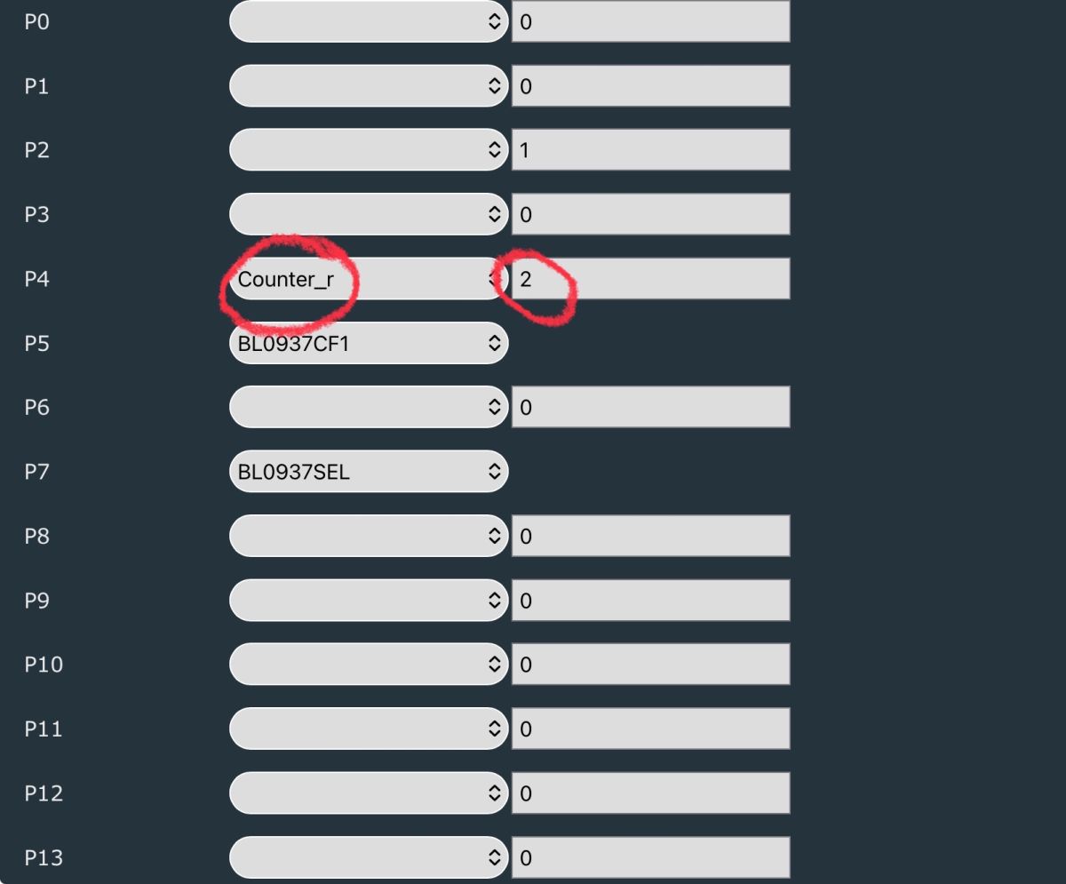

    #16 21787278
    ajoas
    I have 2 drivers running, NTP and the BL0937. I can see all the values but there are zeros everywhere, even the voltage. I followed the traces of CF, CF1, and SEL from BL0937 to the TX-BL02 module with the multimeter and compared it with the datasheet three times. Should be OK.
    As you mentioned, I changed the CF pin role to counter, but I don’t understand how to do that:
    “… assign a free channel and observe: are the pulses seen by OBK? Is the target channel value increasing?”
    Do you mean to check the log file on the web?
    Screenshot of interface with dropdowns and highlighted P4 field
    Power device status screen with active switch and zero energy readings
  • #17 21787499

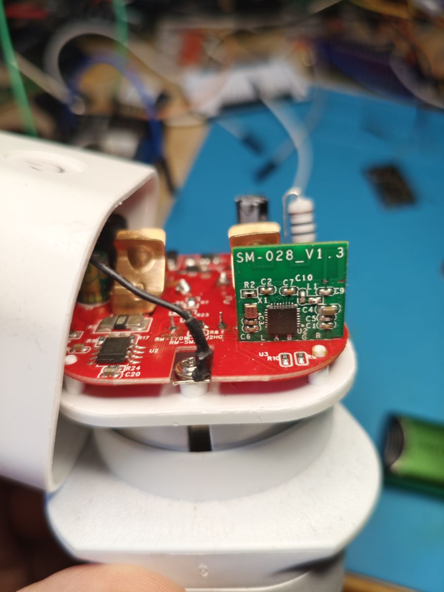

    OpenBL602 interface with SM-028_V1.3 EU plug PCB showing OFF state
    red PCB EU plug with SM-028_V1.3
    Close-up of red PCB with green SM-028_V1.3 board and various mounted components.

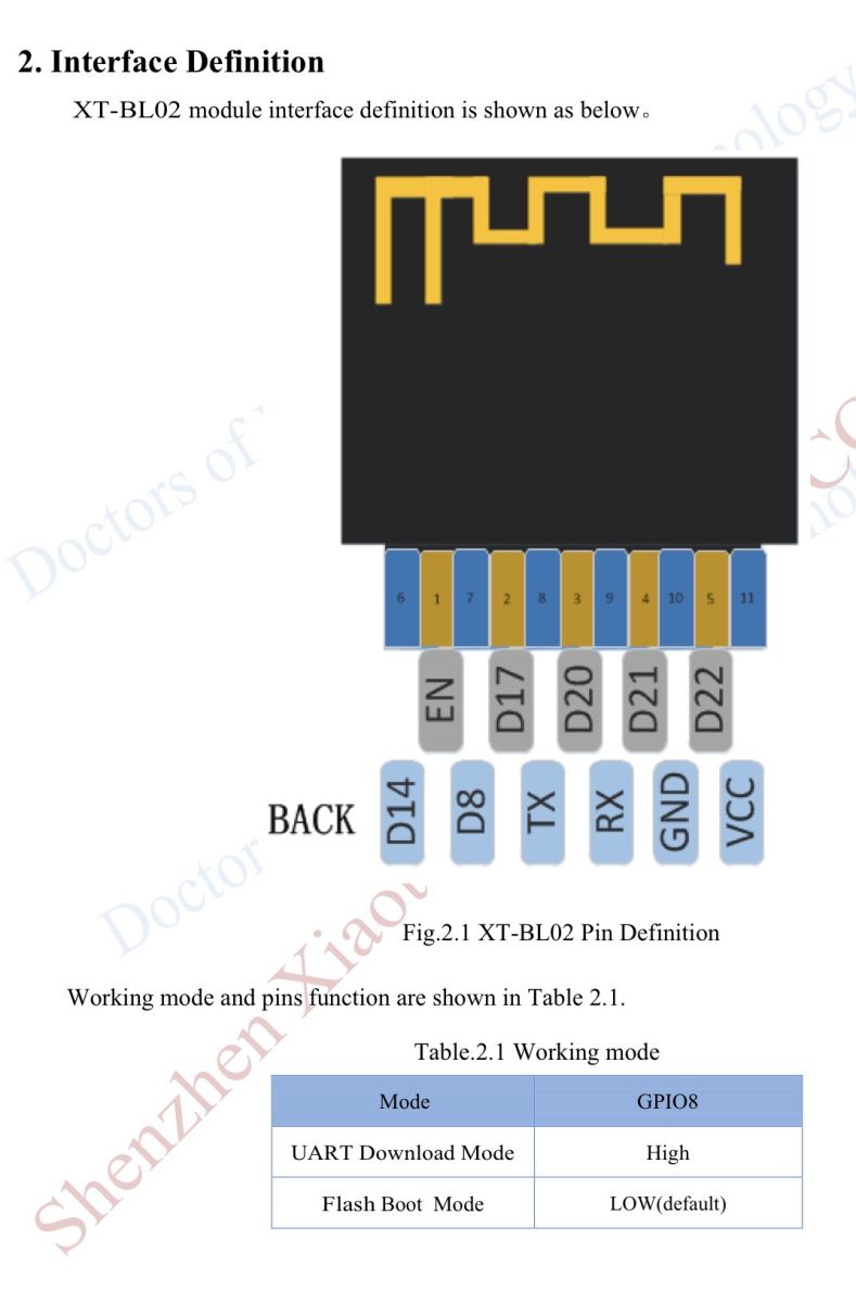

  • Rare BL602L20 and BL0937 board identified
    #18 21787668
    ajoas
    Your PCB looks different from mine.
    It seems I have a very rare combination with BL602L20 BL0937.
    I didn’t find somebody else who flashed it already fully working, but I’m sure it’s possible.

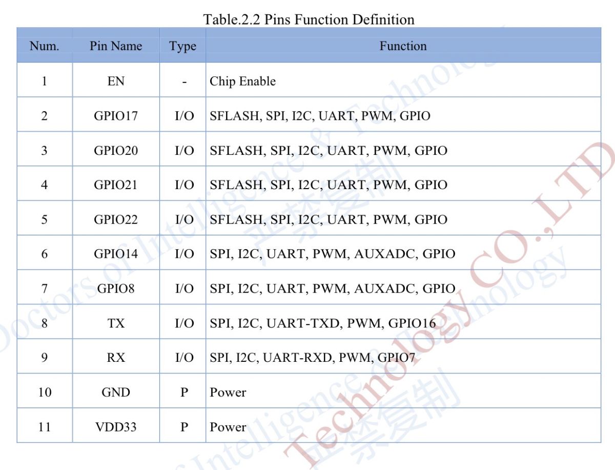

    XT-BL02 Wi-Fi module on PCB with antenna trace and visible markings
    Wi-Fi module BL602L20 on a PCB with exposed chip and resistor
    Pin function table with names, types, and functions for 11 signal entries
    XT-BL02 module pin layout and GPIO8 working modes table
    I removed the shield with hot air to find out what controller it is.
    "4": "BL0937CF;0",
    "5": "BL0937CF1;0",
    "7": "BL0937SEL;0",
    "14": "Rel;1",
    "16": "Btn;1",
    "20": "LED_n;1"
