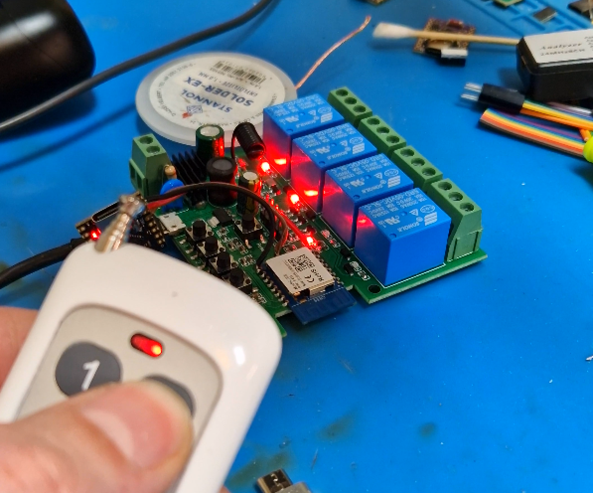

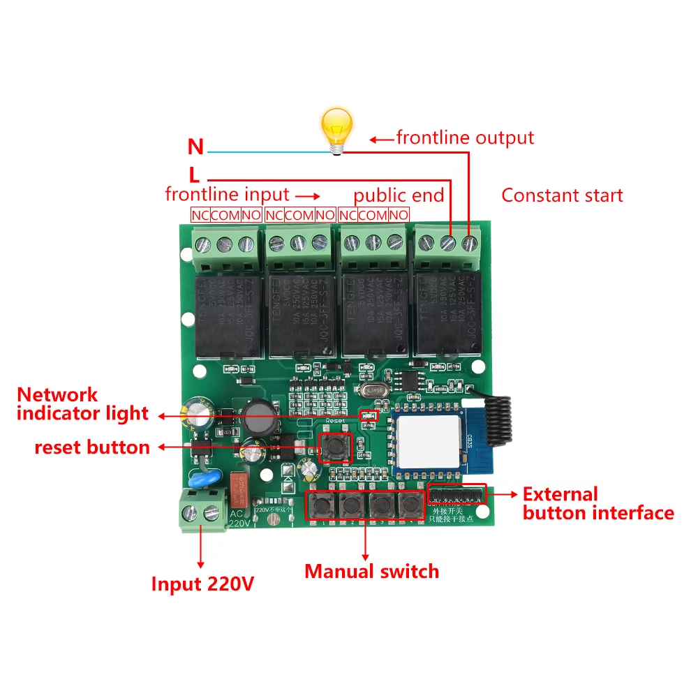

  • Wi-Fi relay board with 4 RF 433 MHz relays controlled by a handheld remote
    How to flash and configure RF remote receiver with open source firmware? How to use it to control relays and external devices, with and without Home Assistant? How to add custom remotes? Here's a short guide to RC (Radio Control) driver in OpenBeken, all basics covered. With this tutorial you'll be able to transform your simple RF relays controller into all-in-one RF control hub for many other Wi-Fi appliances, such as smart bulbs, LED strip controllers, external relay modules and much more.
    Device used for presentation
    The driver presented here can work with many devices and receivers, for presentation we used a popular Tuya 4-channel 220V AC Wi-Fi Remote Control Relay Switch Module 433 MHz RF from Aliexpress:

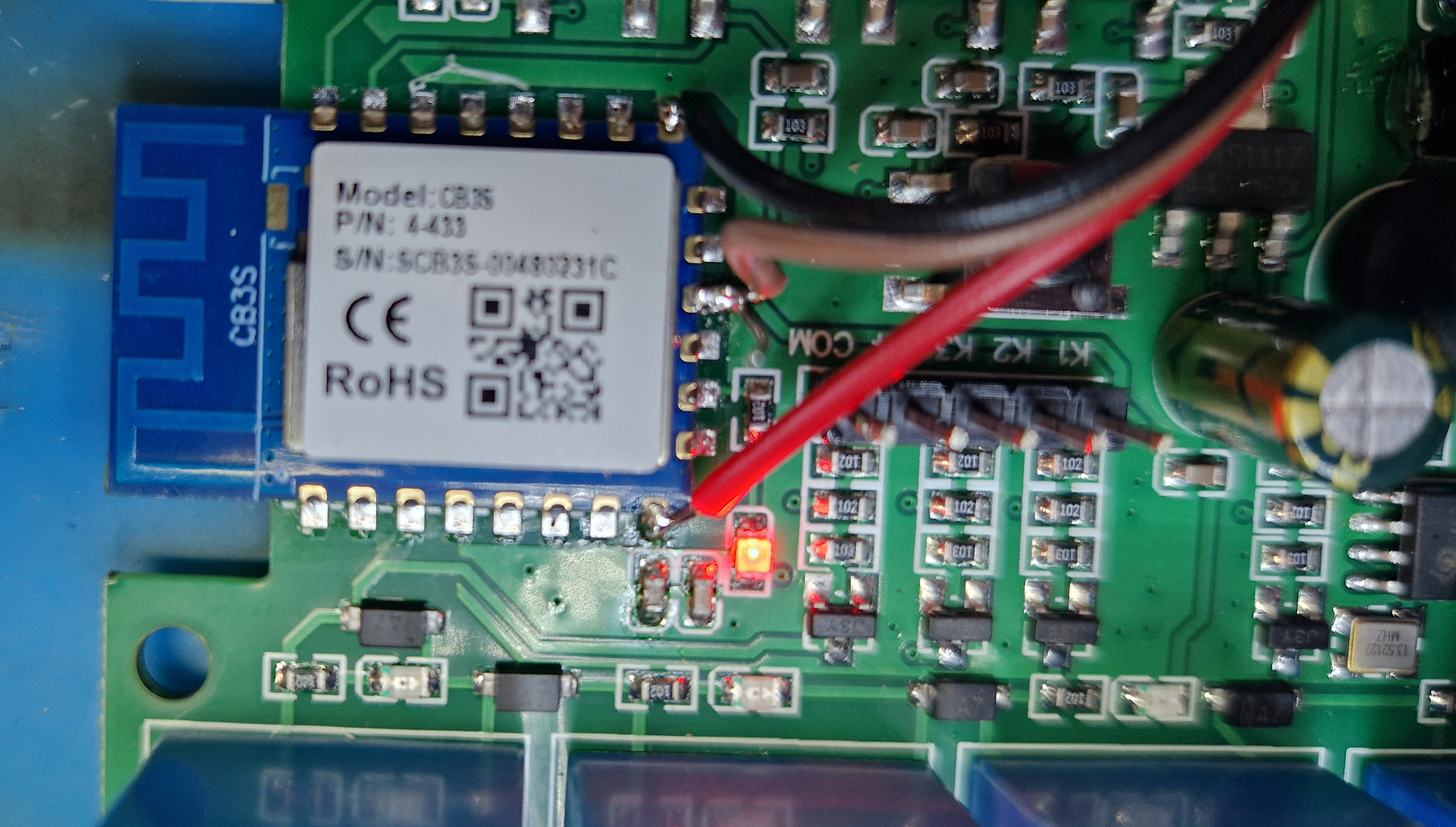

    Wi-Fi relay module with 4 220V AC channels and labeled control components

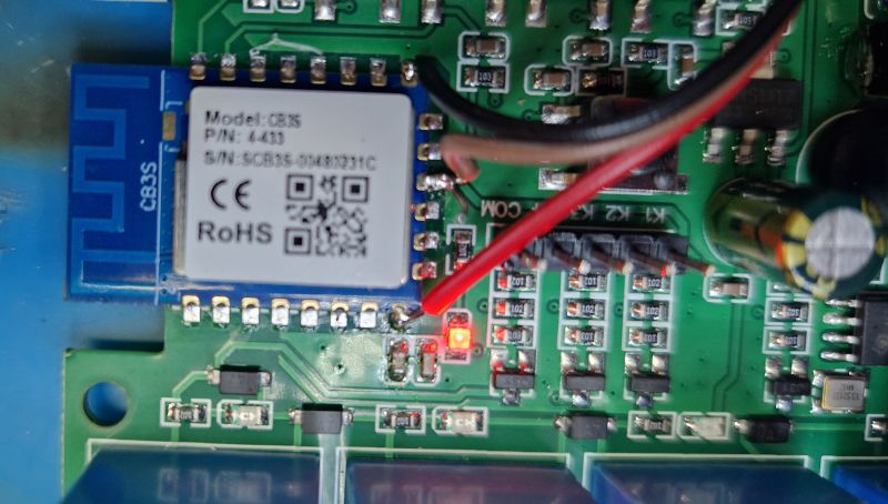

    This board features CB3S (BK7231) Wi-Fi module, which can be flashed with OpenBeken.
    CB3S module on relay board with a red debugging wire connected

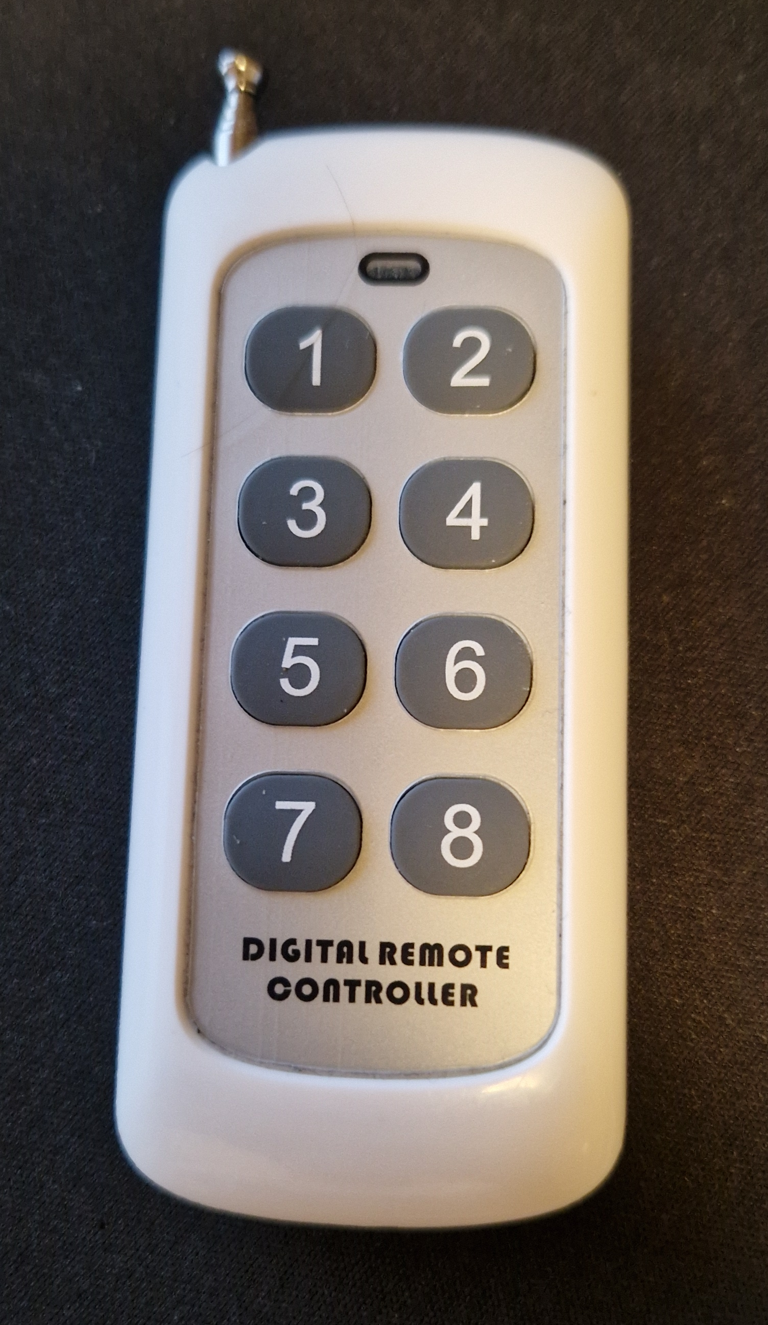

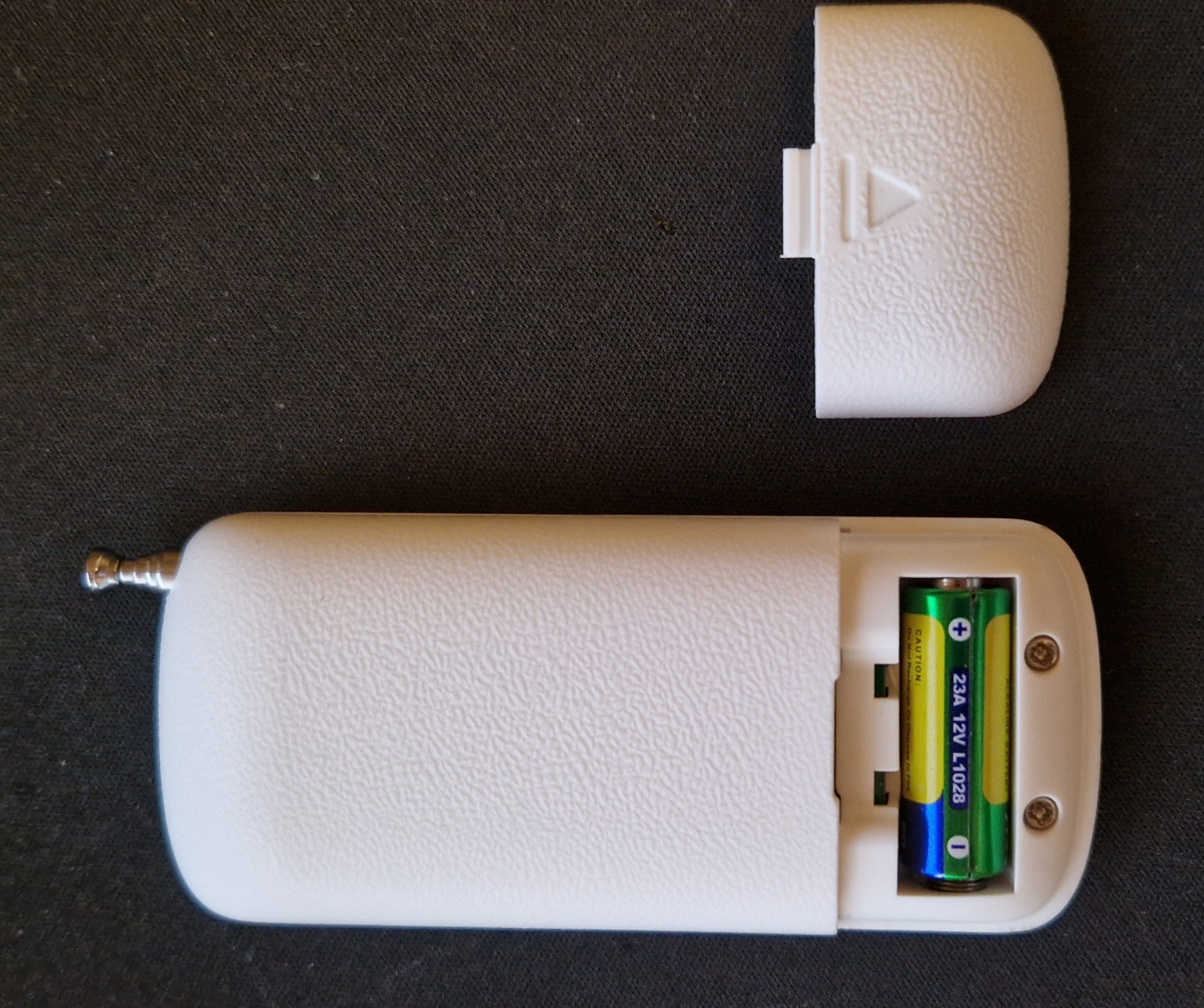

    The device comes with a single remote, more remotes can be bought separately:
    RF remote with 8 numbered buttons and antenna, text reads DIGITAL REMOTE CONTROLLERBack of RF remote with battery cover removed and 23A 12V battery visible

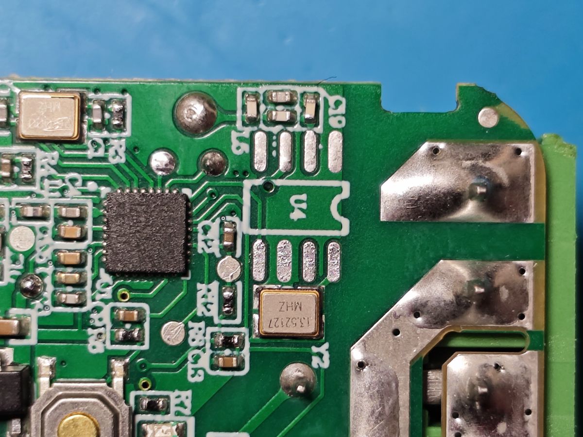

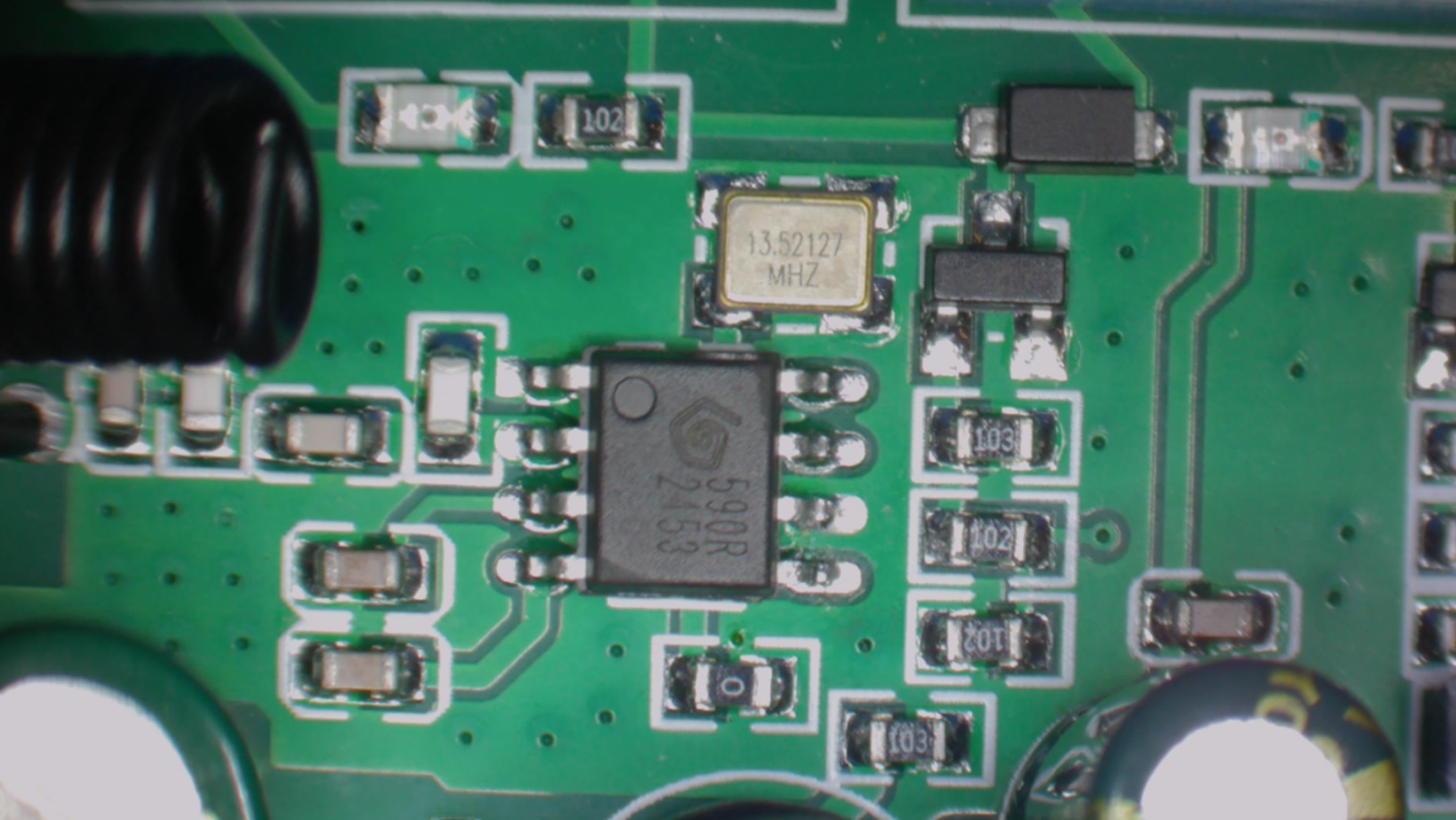

    This device features SYN590R (590R), which is connected directly to one of Wi-Fi module pads. It's not connected via external MCU, like on some devices, so in order to utilize it, Wi-Fi chip firmware must have a special driver for it. Luckily, there is such a driver in OBK!
    Close-up of PCB with SYN590R RF module and 13.52127 MHz crystal oscillator

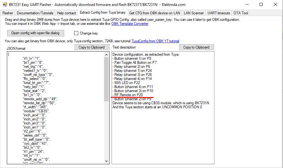

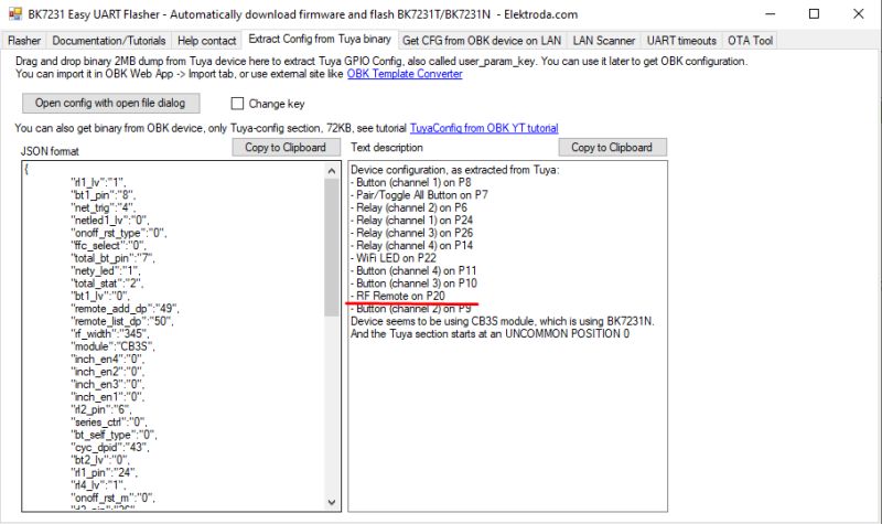

    For the flashing part, see our BK7231 flasher page. Our flasher, which is a recommended solution for Beken and other OBK-supported chips, can also detect device configuration:
    Screenshot of BK7231 Easy UART Flasher showing RF pin P20 configuration

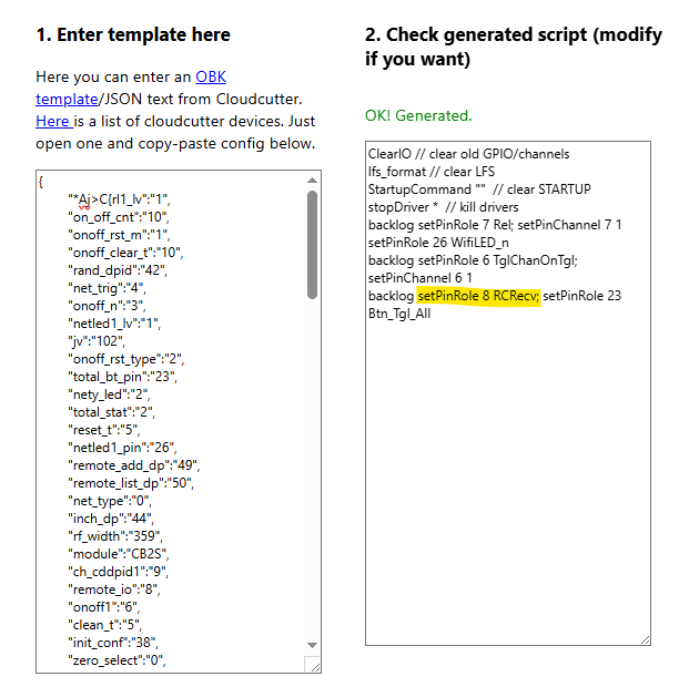

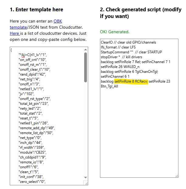

    Import the template and proceed to RF setup:
    Basic guide for OBK RC driver

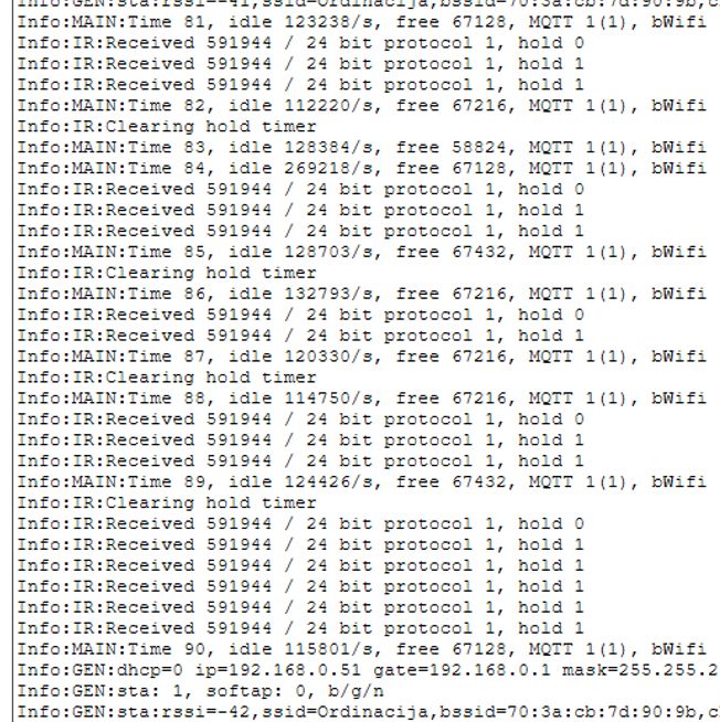

    So, in order to run RC (Radio Control) driver in OBK, you need to set the RCRecv pin (check PCB trace or extract Tuya config if possible) and start the driver with startDriver RC command. Then you will get events and codes in OBK console:

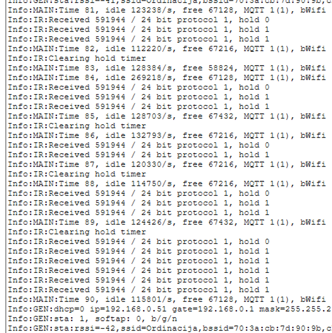

    OBK console log showing received RF codes and MQTT connection details
    We may add more information or hex format for codes in the future, but the core functionality will remain the same.
    Then, to handle events, use the event handler in autoexec.bat:
    addEventHandler2 RC 591946 0 POWER TOGGLE
    First argument is always RC, second is remote control code, third is held state - first press has 0 value, further repeats (when the button is held) have a value of 1 there.

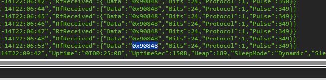

    Comparison with Tasmota

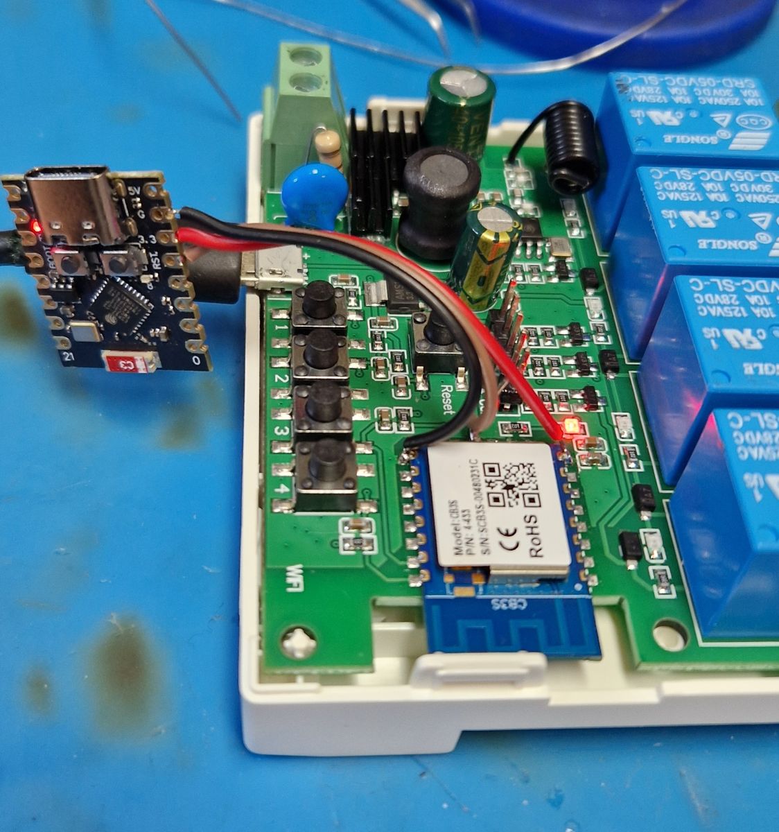

    For the comparison purposes, we've hooked ESP32 flashed with Tasmota to the same receiver:
    Wi-Fi relay module with USB flasher connected, on a blue work surface

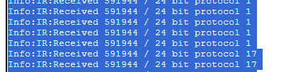

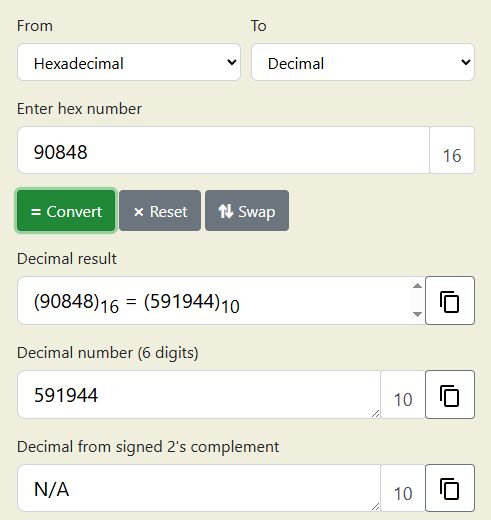

    This way, both Tasmota and OBK can see the same signal:
    OBK console screenshot showing RF code 0x90848 received in hexadecimal format

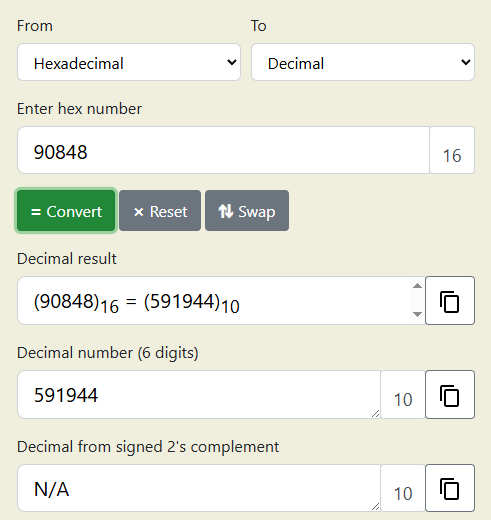

    Screenshot from OBK console showing received RF codes 591944 using protocols 1 and 17
    OBK currently uses decimal format for RF code, but a little conversion can clearly show us that the codes are matching, so both solutions are interchangeable.
    Conversion of 90848 from hexadecimal to decimal: result is 591944

    And here is short presentation - first control of the relays device itself:
    Then usage of RF device as a gateway to control another device via HTTP GET - the LED strip controller is under the table, it's the device with 192.168.0.58 IP, as you can see in autoexec.bat:

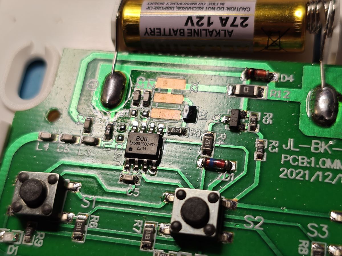

    One thing to note is that the remotes that come with these type of devices are Princeton protocol RF remotes. OBK driver recognizes Roger protocol as well and we didn't test beyond that right now but it will be done and tested.
  • P8 remote_io logs show 24-bit RF codes

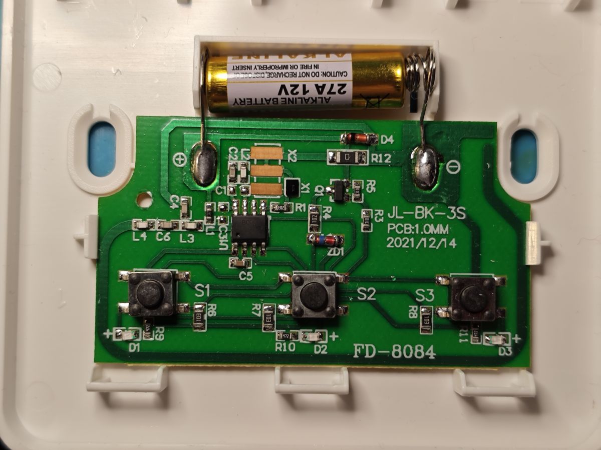

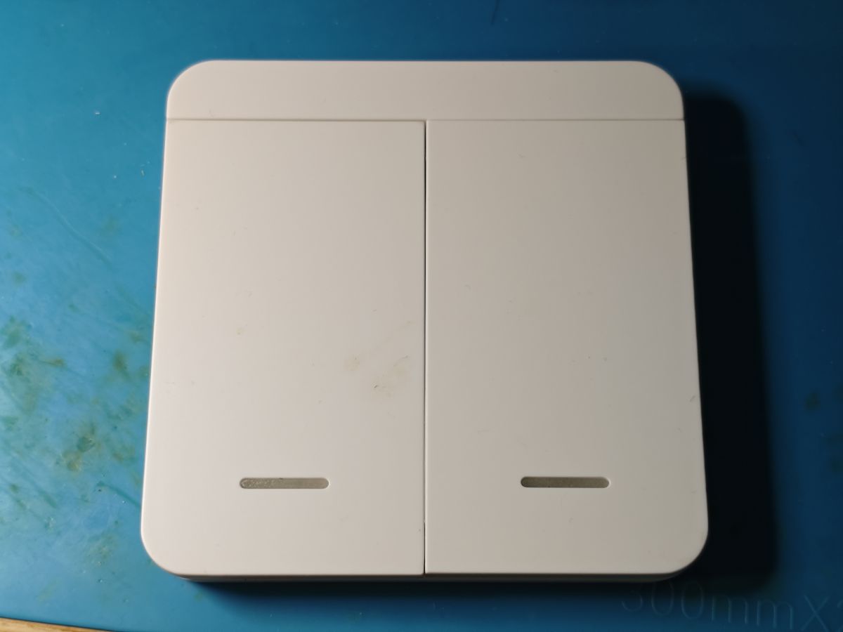

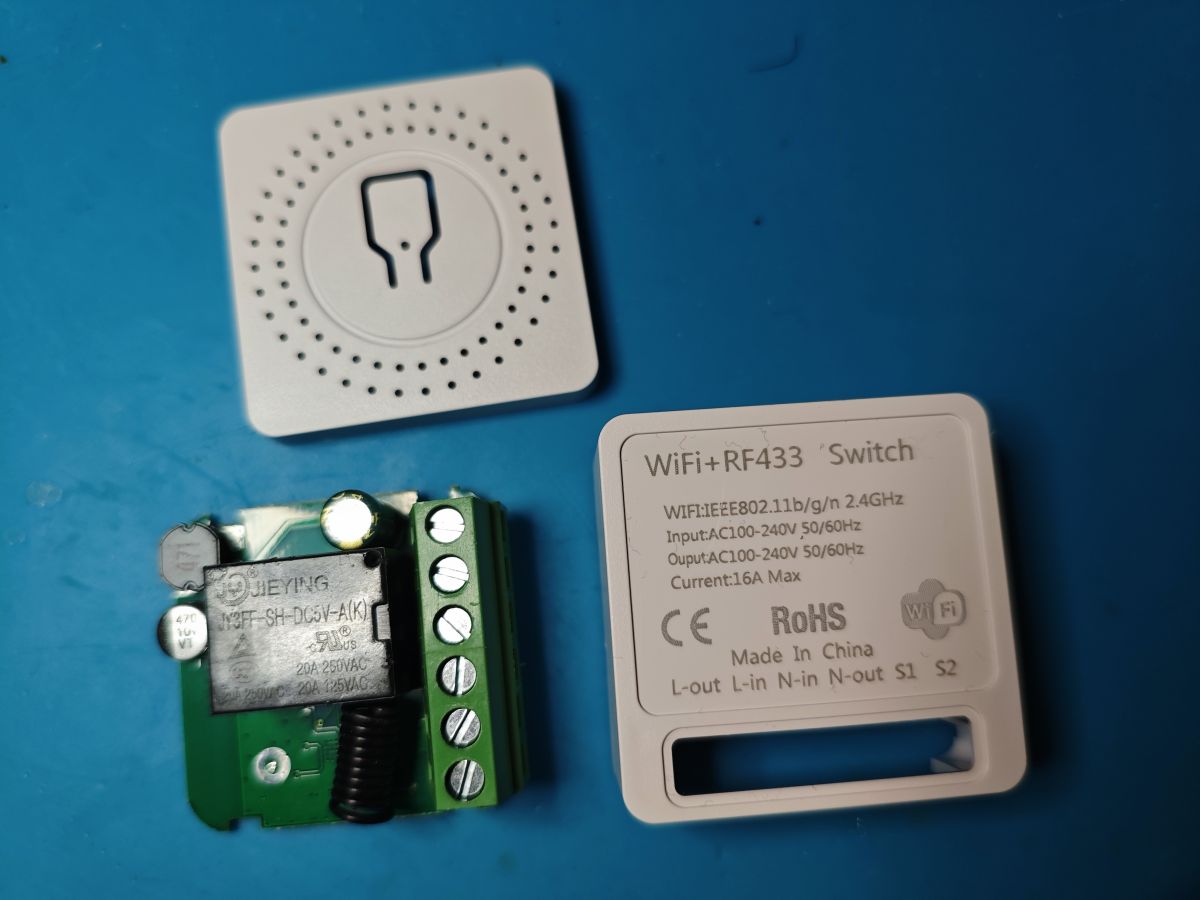

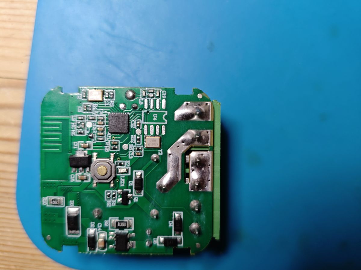

    regarding this standard mini breaker/switch with RF on P8
    Disassembled WiFi+RF433 switch with circuit board and casing on a blue surfaceClose-up of a green printed circuit board with electronic components and solder joints.Close-up of surface-mounted integrated circuit labeled H3308 H0744. Close-up of green PCB with microchip, SMD components, and solder joints HEYING SH-DC5V-A(K) relay module with screw terminal block

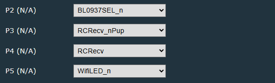

    I see Easy Flasher sees remote_io pin on P8 and the json import configuring the device in the web app is successful
    Editor view with JSON OBK template and generated configuration script

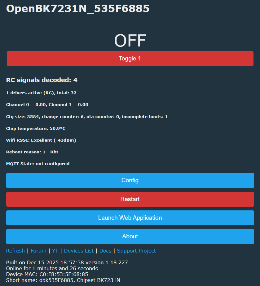

    OpenBK7231N control panel with OFF button and system status details
    these logs are generated when I push buttons on RF control
    White double light switch with rounded edges on blue surface Printed circuit board with three buttons, 12V battery, and electronic components Close-up of a green circuit board with buttons, battery, and BOiL chip
    Just noticed chassis is for 2 buttons but PCB has 3. They each have unique frequencies
    with basic autoexec (4 because one or more of the buttons seems to vary)

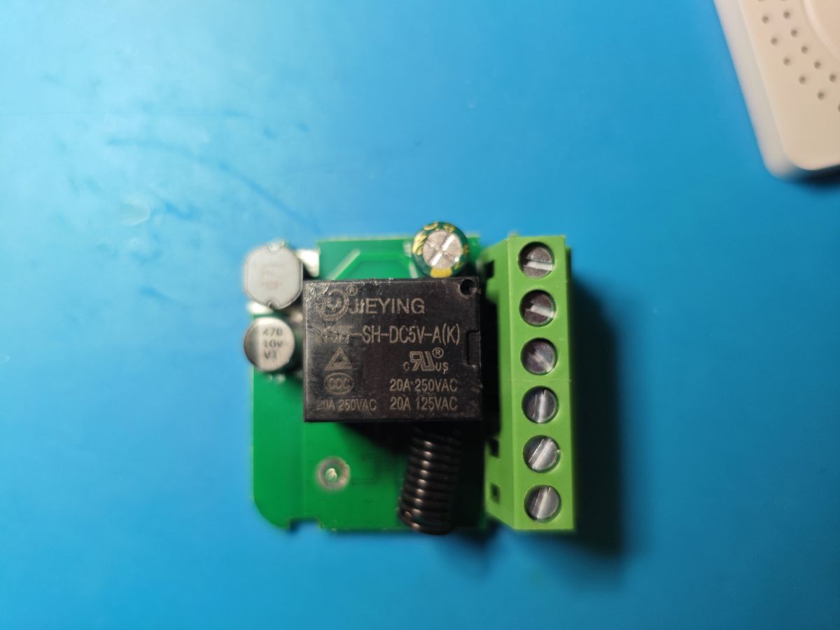

    well, yes, though it seems I do have one of those switch types but it does contain remote_io in the config - Bingoelec W601 T34.
    On the other hand, the two other devices I posted about here do not seem to be have GPIO connected to the RF.
    I note your 4CH relay board in the demonstration is the 230v version but mine is the 5V & 7-32V one and has additional chips.

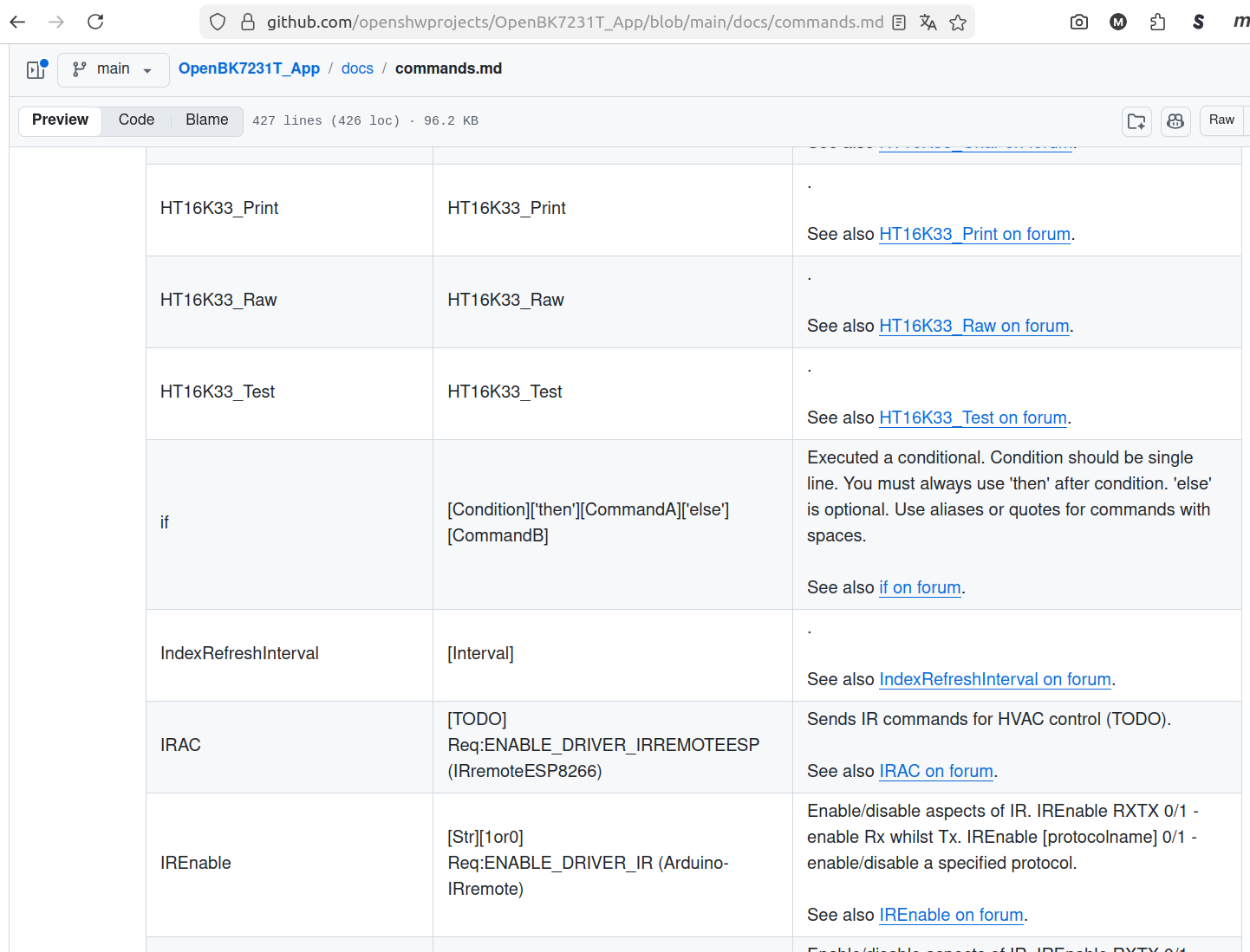

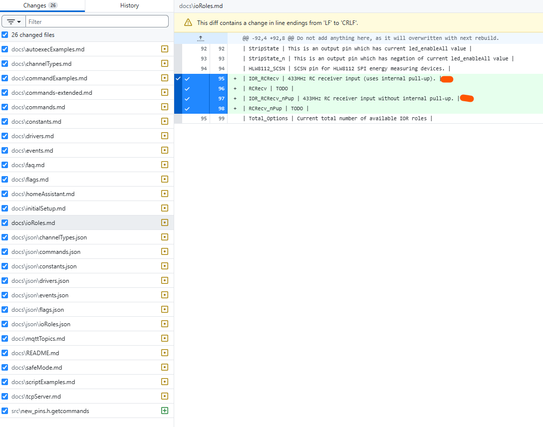

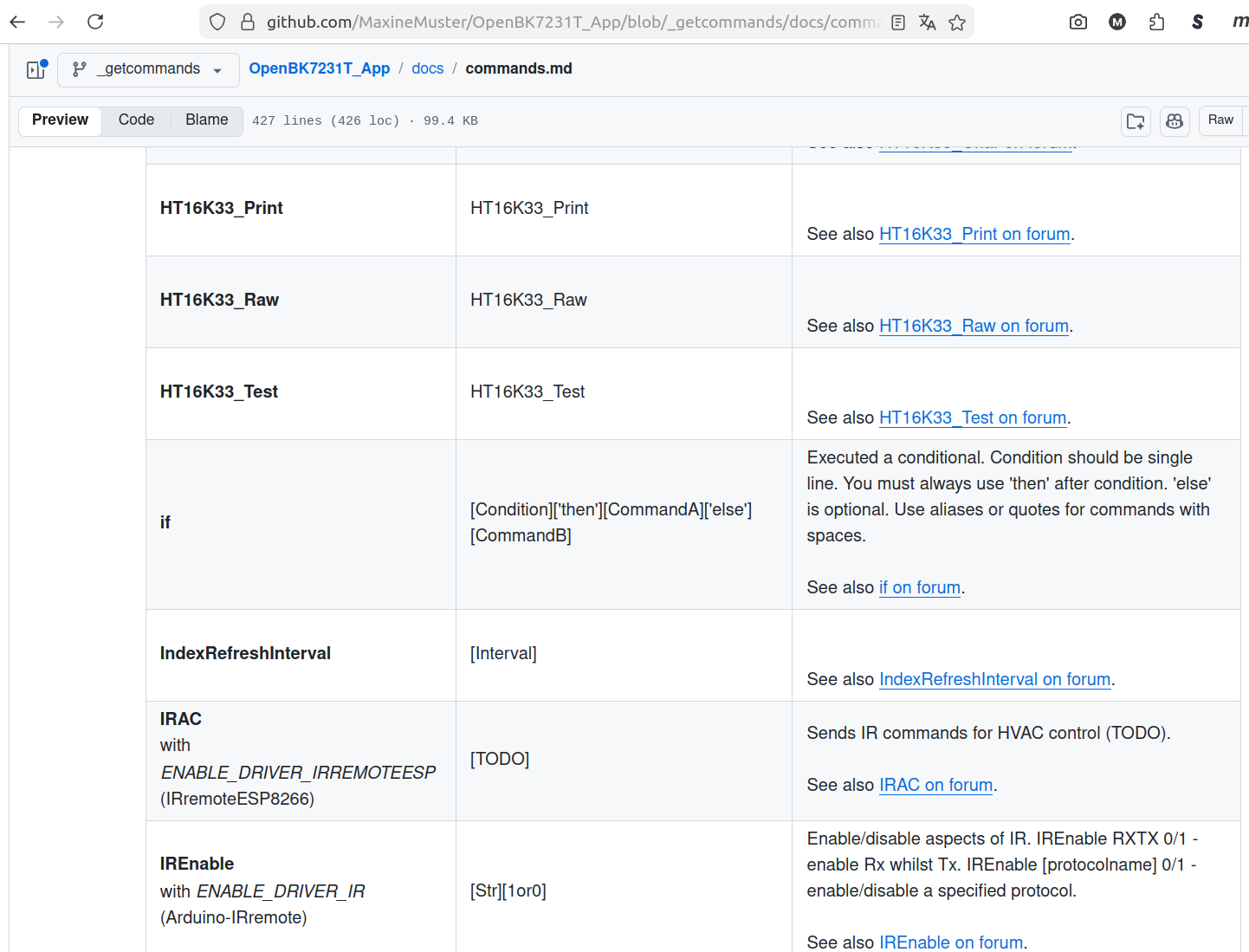

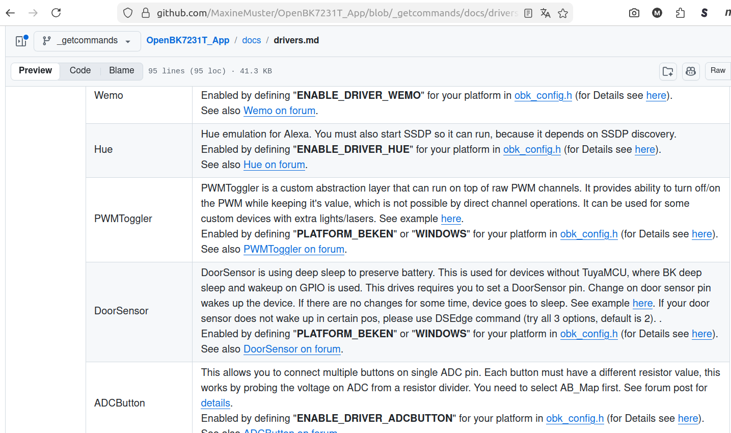

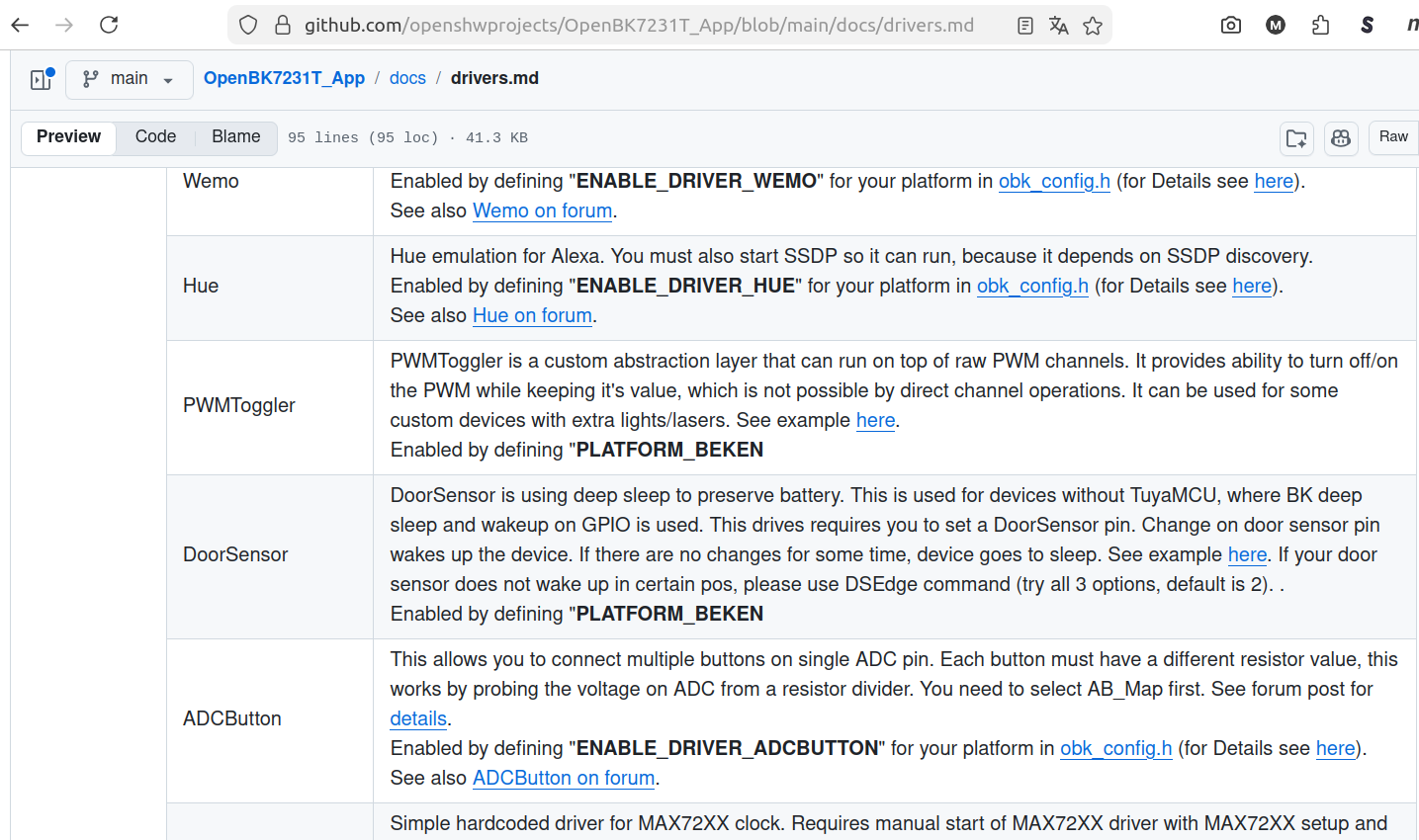

    just trying to work out why these are getting generated
    Edit to docs/ioRoles.md file showing added I/O roles for 433MHz RF receiver.
  • #12 21783463
    Posts: 14770
    Rate: 12913
    Probably the xml has name with prefix IOR_ and it doesn't like it and tries to create it without this prefix.
    Solution: remove manually IOR_ prefix from xml before running getcommands.js

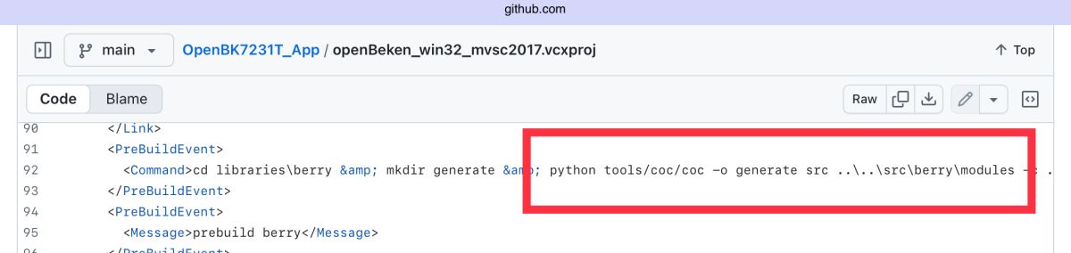

  • Propose one-stop scripting for IORoles and channels
    #17 21788127
    max4elektroda
    Posts: 758
    Help: 49
    Rate: 189
    The "problem" I saw is, that you need to change code in different locations, and every change has the (small) chance you break of forget something.
    Especially for the forgetting part a one-stop-change will be better. And you might feel forced to give all information and avoid "Todo" entries or even rely on getcommand.js fixing the code.
    As long as the script code is correct, you will also not break other code, if your entries in the file are correct.
    So in the end there are two questions:
    are you willing to change the way of coding for the IORoles, channels, ...?
    If, which scripting language is fine?
    You might remember that I started with an awk script and you disagreed for awk is not present on windows.
    So I switched to python, which is already used (even on windows) for berry code, if I'm not mistaken.
    Project file code snippet with prebuild command in XML from GitHub repository.

  • Fixing getcommands.js to preserve duplicate command variants
    #19 21830455
    Posts: 5220
    Help: 449
    Rate: 918
    Wouldn't it be better to just .... fix getcommands.js to handle missing/extra IOR_ prefix correctly?
    I didn't have any of this chat in mind, but I did fiddle with getcommands.js so the autogenerated docs like commands-extended.md are now accurate when the same command exists in more than one implementation. The main problem before was that duplicate cmddetail entries could overwrite each other internally, which led to misleading output: for example IRSend and IREnable could show up twice but both rows would incorrectly claim the same File/Function (both attributed to drv_ir_new.cpp), so you couldn’t tell which IR stack you were looking at.
    Before, you’d see duplicates like:
    - IREnable listed twice but both pointing at the same driver file/function (no way to tell variants apart)
    - IRSend variants not reliably attributed (eg the “...-BITS” form appearing as if it came from the IRremoteESP8266 driver)
    After, both variants are preserved deliberately and correctly attributed:
    - IREnable now appears once for Arduino-IRremote and once for IRremoteESP8266, each with the correct File/Function
    - IRSend likewise shows the correct split (eg the PROT-ADDR-CMD-REP-BITS form comes from the legacy driver, while the other form comes from the IRremoteESP8266 driver)
    - I also added a clear Req: discriminator via cmddetail.requires, so the table explicitly shows which build flag applies (e.g. ENABLE_DRIVER_IR vs ENABLE_DRIVER_IRREMOTEESP)
    to illustrate:
    plus a couple of other fixes like invalid character, events blurb + actual updated docs run https://github.com/openshwprojects/OpenBK7231T_App/pull/1973

    I updated RC and old IR drivers to use HAL.
    In need of some testing of course.
    IR is BK only (since it's still using BK PWM funcs), RC can be enabled on any platform that supports cpp.
    Potential IR and RC coexistence?

    @insmod very nice HAL, merged, however currently it's a single callback - so a plan is to allow "shared" timers?

    #28 21832834
    max4elektroda
    Posts: 758
    Help: 49
    Rate: 189
    Thanks a lot @divadiow, especially for identifying and fixing the error that my test for "are the commands/drivers equal despite their location" did change original object!
    Though I still find it would be better to have unique commands/drivers, it's a very good idea to include the defining "ENABLE_DRIVER_..." in the documentation for the time being.
    Maybe I can propose some changes/enhancements ? - as usual it's relative what is seen as a "better" way ;-)
    The actual driver.md is "broken" for the rare cases of "#if defined(PLATFORM_BEKEN) || defined(WINDOWS)"
    Screenshot of GitHub showing drivers.md with a driver table (Wemo, Hue, PWMToggler, DoorSensor, ADCButton)
    I added some code to "parse" the #if lines, so now it looks like
    Screenshot of GitHub preview of drivers.md showing a drivers table with entries like Wemo, Hue, PWMToggler
    My proposal would be to move the information about the define for "multiple" commands away from the "Arguments" column to the first "Command" column:
    So from:
    GitHub screenshot: commands.md showing a table of commands, including HT16K33 entries and “if”.
    To (on github):
    GitHub screenshot showing commands.md preview with a table of commands like HT16K33_Print, if, and IREnable
    With a "decent" rendering (md not rendered by github "preview") you can see, I made the additional information slightly smaller:
    Screenshot of a commands documentation table with HT16K33 and IR entries and an “if” syntax note.
    Can be found in PR#1982
  • #29 21832841
    Posts: 5220
    Help: 449
    Rate: 918
    hey, that looks nicer, clearer!
  • #30 21834083
    Posts: 14770
    Rate: 12913
    Hey aren't defines fixed by @DeDaMrAz in Docker PR?
