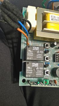

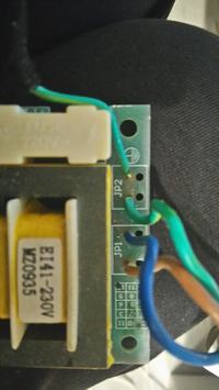

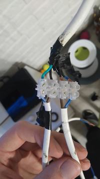

    Thanks for your interest. Unfortunately the plate is missing, and I can't take a picture of the drive because the screen is fixed in the ceiling in a re-wall. I was able to dismantle the remote control, which is wired. Photo 1 shows the connection of the 4-wire cable that goes from the screen to the two 2-wire cables of the remote control. Photo no. 2 shows the 3 wires from the remote control to the screen, photo no. 3 shows the 3 wires from the plug to the board plus one from the board to the screen (yellow and green, there is a protective conductor sign but I am not sure if this is its role). Maybe you can determine something on this basis?

    mat008 wrote:
    in photo #3 you can see three wires from the plug to the board plus one from the board to the shield (yellow-green, there is a protective conductor mark but I am not sure if that is the role).
    Then take an ohmmeter and measure the mains lead - the protective contact in the plug has a connection to that yellow/green lead?
    mat008 wrote:
    Depending on how you plug the plug into the socket, the yellow-green can also go behind the yellow-green (at least for the test tube)
    Put down that test tube, instead check the continuity of the yellow-green wire between the plug and the circuit, and that the pin in the socket is earthed.
    mat008 wrote:
    Photo #2 shows the 3 wires from the remote control to the screen,
    Presumably feeding power between black and blue gives movement one way, and between black and brown the other way. Presumably there is a motor with two symmetrical windings + capacitor:
    Connecting the electric projector screen under the fibaro module .
    Measure the resistances between the motor leads (after disconnecting the driver) and zap.
