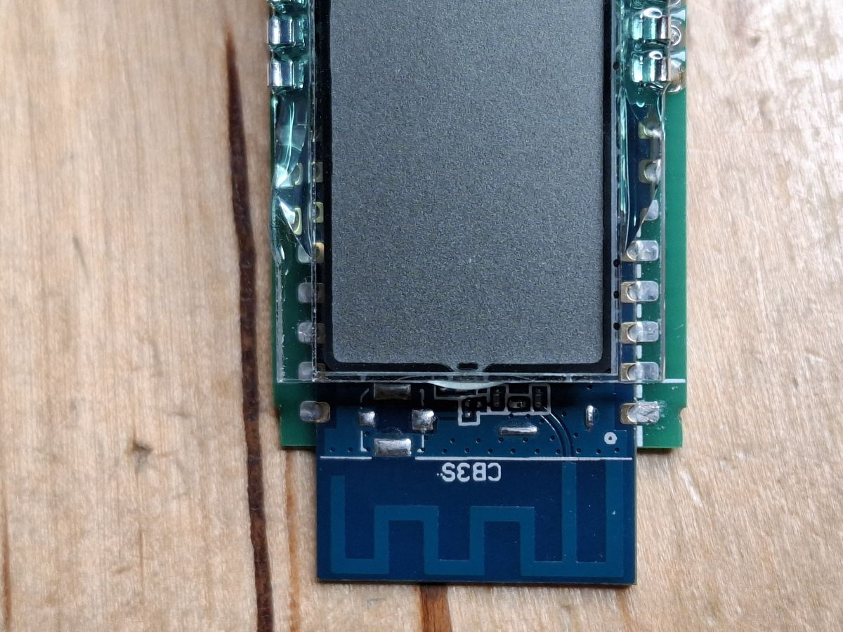

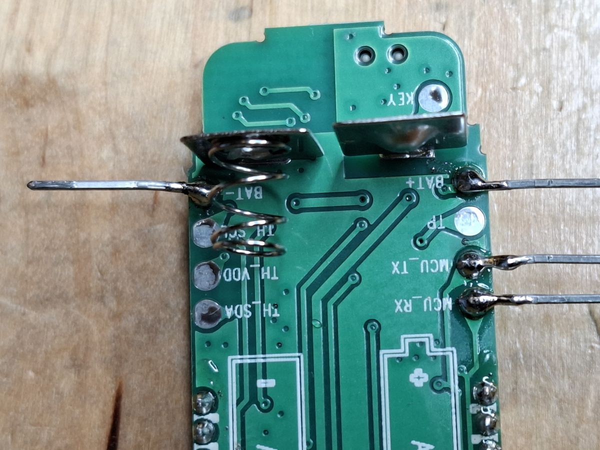

    I have a couple of Tuya ZY-TH01ProCB3S_v1.4 temp & humidity sensors with LCD display; see the attached pictures.
    I tried to use CloudCutter on the first one and that seemed to go well and I managed to reflash it OTA with what I now assume is rubbish.

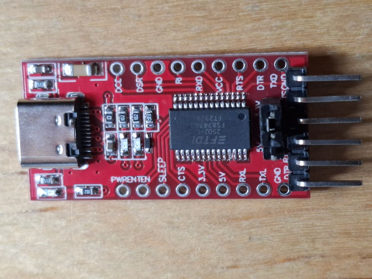

    So, I have been trying to reflash it using a serial TTL adapter...
    USB to UART converter module with FTDI chip on red PCB

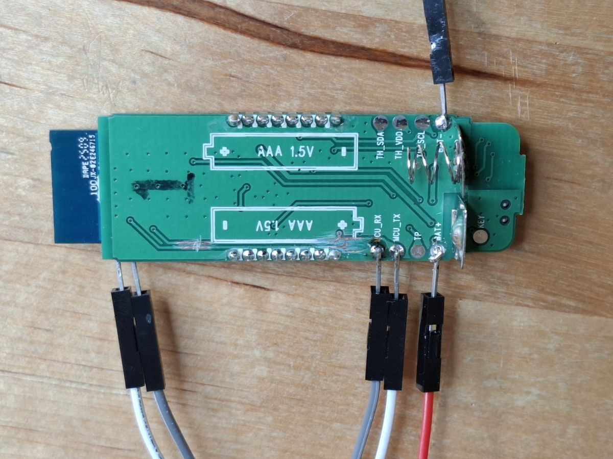

    The problem seems to occur when I try to get it to reset the card using the Reset pin on the CB3S card; nothing happens.
    I have tried connecting directly to the CB3S card, but even if I put the power and TX/RX connections directly on the pins there, it still powers up the LCD display and will not reset.
    Anybody have any ideas on where I am going wrong with this board, please?
    AI: Can you provide more details or a diagram of how you’ve connected the serial TTL adapter to the CB3S card, including which pins you’re using and what voltage your adapter supplies?
    I have tried both to the pins as shown in the picture and to the CB3S card directly.
    The TTL adapter is sending out 3.3 V.

    I have a feeling the RX/TX pads on the back of these are for the TuyaMCU and not the CB3S. I recall as much from this version https://www.elektroda.com/rtvforum/topic4095818.html
    You probably won't want to remove the LCD so you'd need to angle something in to get to the pads on CB3S

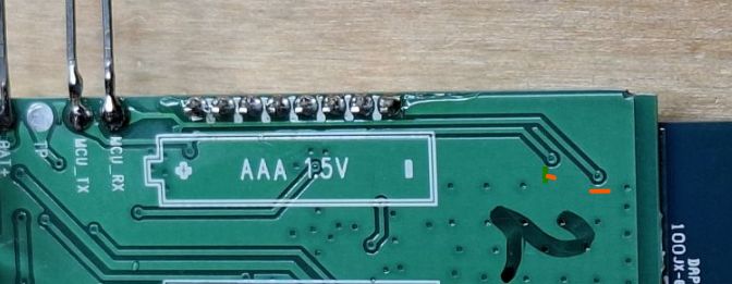

    I was thinking hot air gun removal after desoldering the LCD, but that's probably not an option.

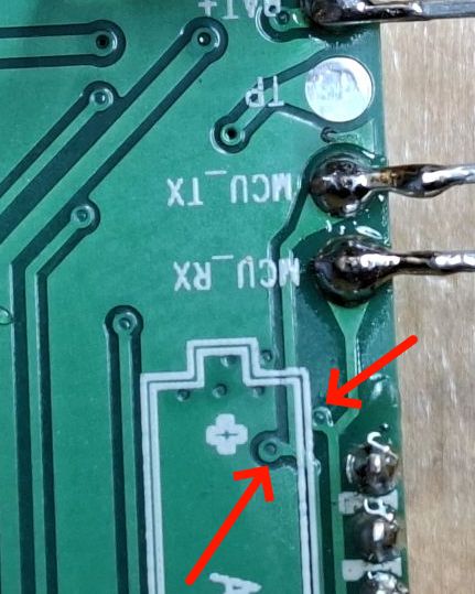

    But actually, look, the RX/TX on CB3S do look to go those headers on the back. I hadn't spotted that. Looks like they each have a little trace breaking out to the TuyaMCU? maybe?
    Section of green PCB labeled MCU_TX, MCU_RX with solder joints and red arrows
    Maybe it'll just be a case of severing the CB3S's RX at that little junction so TuyaMCU can't transmit stuff and get in the way.
    How are you powering your device btw? external 3.3v power supply with common grounds to USB-TTL or powering whole thing from USB-TTL 3.3v or 5v with LDO?
    that assumes these two come off CB3S RX/TX

    I have tried powering it via just the TTL converter, via batteries and via one of those USB-to-3 V battery eliminators. The circuit board looks multi-layered so not easy to trace where those two go, I'll have another look in the morning. I don't have a hot air gun suitable for SMD removal so that option is out. And I really didn't want to remove the LCD unless I have to.

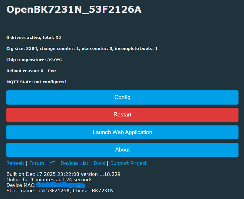

    OK, now we are getting somewhere!
    I pondered the option of trying to cut the 2 small traces by those pads, but opted to cut them further up the trace (don't ask me why I staggered them)
    Green PCB with marked AAA 1.5V slots and connected jumper wires.
    I then was able to get it to connect via the CB3S TX/RX

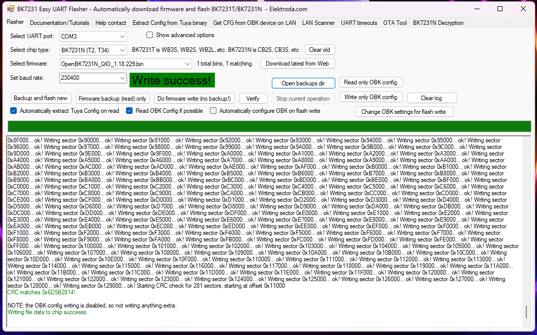

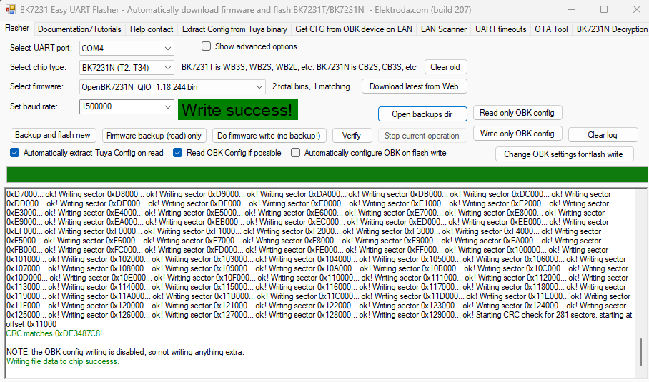

    It would not read the firmware successfully and kept failing at the same place; I assume this was where the previous OTA flash failed.
    So I bit the bullet and tried to flash the latest firmware with success!!
    BK7231 Easy UART Flasher interface showing “Write success!” message
    I can now talk to it!
    Control panel of OpenBK7231N device with setup and restart buttons
    I have changed the WiFi details and can now talk to it via my network!
    Now all I need to do is work out how to stop it from turning itself off after 30 seconds or so so I can talk to it long enough to figure out how to configure it. I have never played with OpenBK before, so this is a massive learning curve for me!

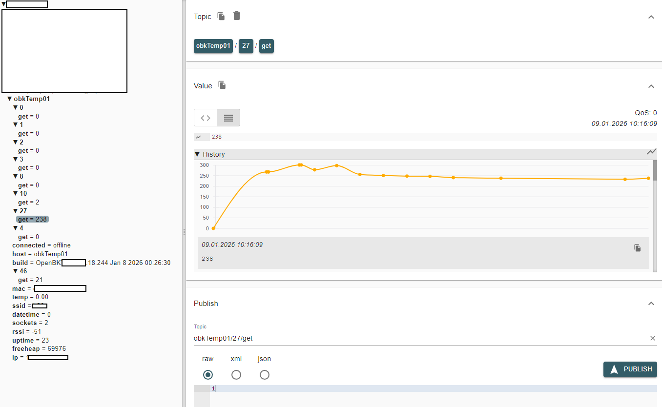

    I got to the same place!
    I have my startup command set to this...
    startDriver TuyaMCU
    startDriver tmSensor
    // Temperature
    setChannelType 1 temperature_div10
    linkTuyaMCUOutputToChannel 27 val 1
    // Humidity
    setChannelType 2 Humidity
    linkTuyaMCUOutputToChannel 46 val 2
    // Unknown Sensor/Mode from logs (dpID 101)
    setChannelType 3 ReadOnly
    linkTuyaMCUOutputToChannel 101 val 3
    And it works! I can now report the temp and humidity (and the odd one) via MQTT into HA
    With tmSensor not running, the Wi‑Fi board stays alive for 88 seconds but does not report any values before its power is cut.
    As soon as I enable tmSensor, it reports the values and shuts down the Wi‑Fi board at 12 seconds.
    Presumably for power-saving measures.

    By far the hardest thing about this sensor is keeping the thing alive long enough to do anything with it. It automatically goes to sleep very quickly. If you keep pressing the button, then it will keep it alive longer, but I found it difficult to concentrate on typing or pressing buttons on the computer at the same time as pressing the button on the sensor every few seconds; it was a bit like trying to rub your tummy and pat your head at the same time!
    As for configuration, I used the 229 version of the OpenBeken firmware and used the code listed above in the startup command box of the home page of the sensor.

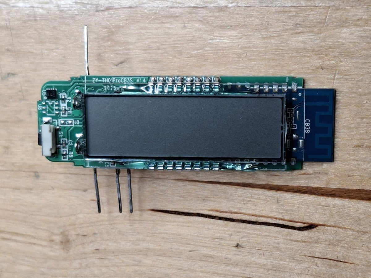

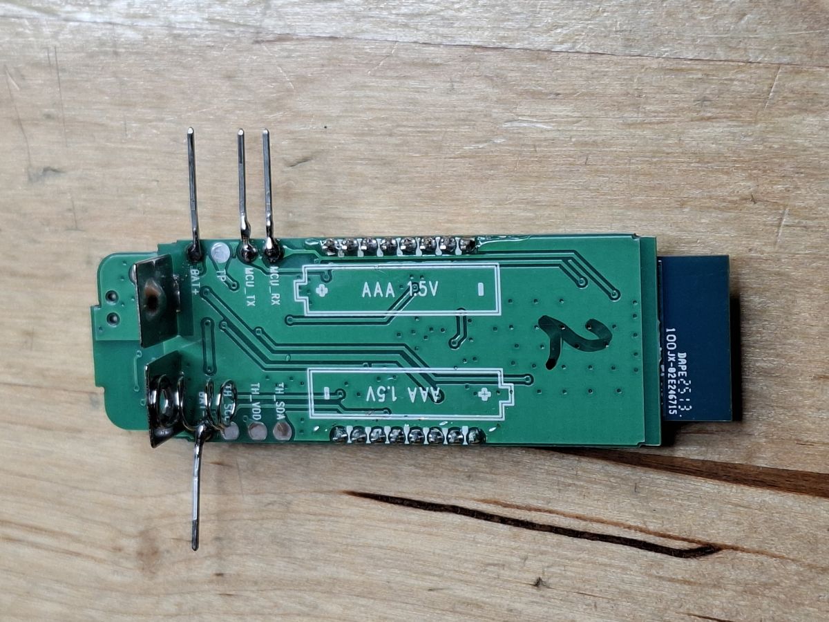

    I have done a second one since and did not need to break the tracks anywhere. I used the MCU_TX & MCU_RX, BAT and BAT- on the circuit board and disconnected the BAT or BAT- from the board to reboot and get the flasher to catch.
    I also found I had to use 230400 baud rate, otherwise the thing fell asleep before it finished getting or writing the data.
    With hindsight I wish I had started with a Wi-Fi switch or something that didn't go to sleep so quickly as they have been a walk in the park to flash since cutting my teeth on this Temp Sensor!

    siggiullrich
    After some more reading in different topics I decided not to cut RX/TX, but connect Pin9 (GND) of the CB3S to BAT-.
    That way, powered by USB-Serial 3,3V on BAT+,BAT- and connected RX/TX, the CB3S permanently stays on.
    Then I was able to flash the firmware (1.18.244) with the BK7231 Easy UART Flasher (Baud 1500000)
    and could do the config (Wifi/MQTT) via WebInterface.
    BK7231 Easy UART Flasher window with Write success! message visible

    After finishing the config, the Pin9 (GND) CB3S to BAT- connection must be removed to get any data.
    Channel 27 value graph for obkTemp01 device in OpenBK web interface
    Added after 6 [hours] 15 [minutes]:
    I have now converted three of the sensors, and they run on batteries and deliver the values via MQTT.

Isolate the CB3S from the TuyaMCU by cutting the small RX/TX traces, then connect USB‑TTL to CB3S TX/RX and 3.3 V/GND. Proceed to flash OpenBeken. Users report successful flashing only after isolating those lines. Restore the traces after configuration if needed. [Elektroda, Dnomis77, post #21784646]
Which pads should I use—rear RX/TX test pads or the CB3S module pins?
The rear pads often route to the TuyaMCU, not directly to CB3S. Accessing the CB3S TX/RX pads is more dependable for flashing. This avoids the TuyaMCU interfering with the serial session. [Elektroda, divadiow, post #21784273]
