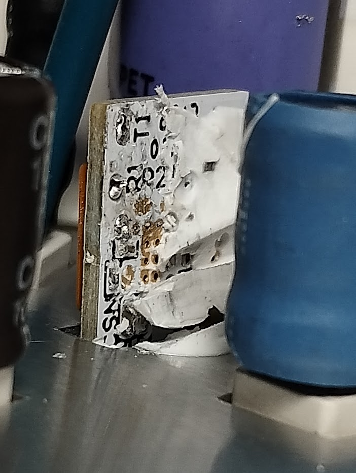

    To program it, it is at least necessary to solder wires on the UART TX and RX pads of the CBLC5 module. To get to the pins it is sometimes necessary to remove the white glue a little bit. The picture below shows the pads T1 and R1 (sorry for the mess, this was already after I desoldered the wires again). There is also a reset pad, but it is not necessary connect if you use the right tool to program.
    Close-up of PCB showing UART pads T1 and R1 with white service adhesive
    If you have clamps it is not necessary to solder wires to power the device. I found the following two locations are easy to clamp and are connected straight to the GND and VCC of the CBLC5 module.
    RGBW LED board with probes and wires connected to UART interface

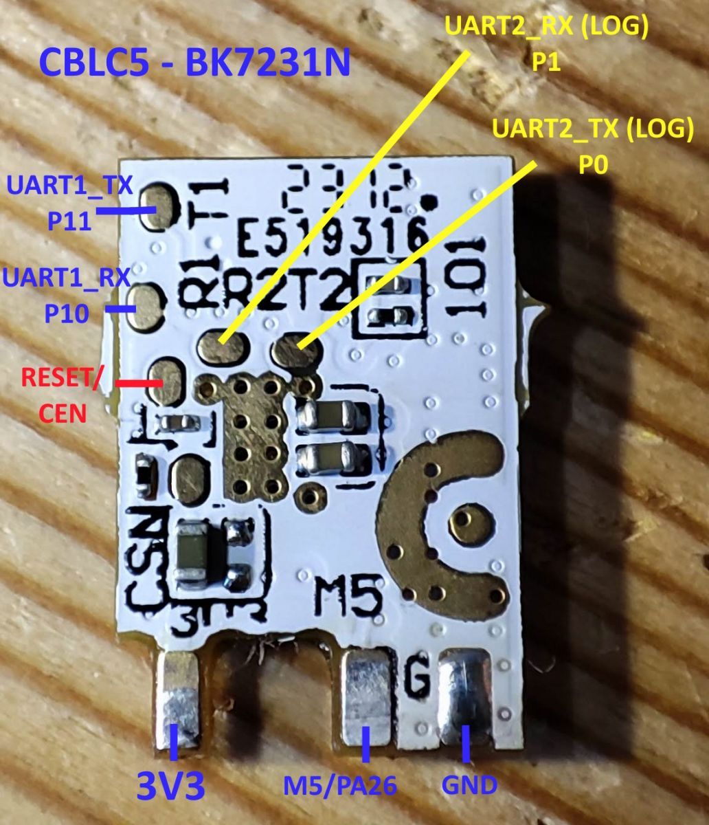

    Here is a pinout of the CBLC5 module I found on the internet:
    CBLC5 module with pin labels for UART, power, and reset on a wooden surface
    Initially I failed to get the programming to work. It turns out that the device really, really needs the correct voltage. Often the 3.3V supply of USB - UART adapters do not deliver enough current. But even when I used a separate LDO to provide the power programming failed because I had too many wires and connections between the LDO and the CBLC5 module, causing a voltage drop which was too large.

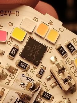

    Here is picture of the LED controller IC
    Close-up of SM2185N chip on LED driver board with labeled RGB and white LEDs

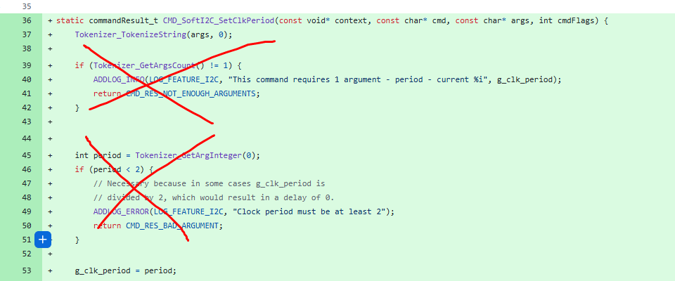

    Ah, I see, interesting idea. I wasn't aware about SM2185N. So, are you sure it's worth to add command for that? Not just globally bump delay up?
    Ok, I can agree for a command, but I require a change. Look, here is how we check arguments:
    Code: C / C++
    So this needs to be changed:
    Screenshot of code editor showing modified C function CMD_SoftI2C_SetClkPeriod
    To be more precise:
    - let our automatic message handle it without argument
    - if set lower than 2, I'd say, just clamp to 2, or just allow 0 , as in "no delay"
    The motivation is simple - you're adding an advanced command that 1% of users will know about, and we are already forced to split binaries into variants because we are running out of flash. I didn't check, but I think that at least 50% of flash increase is from the strings in your patch. And keeping binary small is important for us, it also breaks LFS on BK7231T when flash size grows, and if I remember correctly, it also silently breaks BL602 OTA.
  • #22 21803364
    b_st
    Posts: 11
    Ah, I solved this with a command because I assumed just changing the default clock might break other drivers. But probably this is a bit too cautious. I agree this is indeed a bit of an 'advanced' command, so that might be a good reason to try to avoid this.
  • #23 21803372
    Posts: 14746
    Rate: 12842
    @insmod, what do you think, do we merge this command? I think we can, as long as requested changes are made.
  • #24 21803378
    insmod
    Posts: 1431
    Help: 168
    Rate: 455
    >>21803372
    Sure, wouldn't hurt
  • #25 21803401
    b_st
    Posts: 11
    All right! I made the changes as requested.
  • #26 21804195
    b_st
    Posts: 11
    Thanks for your time and merging the changes. I updated the initial post with the fixes.
  • #27 21804386
    Posts: 14746
    Rate: 12842
    Thank you, do you have any other suggestions for improvements that can be made?
