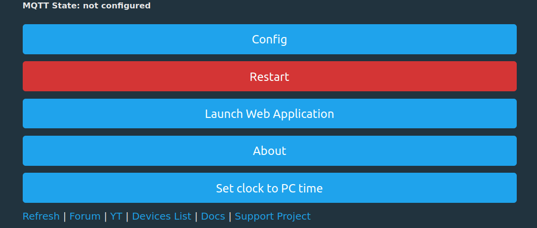

    The possibly simplest method is setting the OpenBeken time to the time of the device you are using to access the GUI (this is allready in OBK code, just not enabled):
    Setting device time to browser time
    If you define "ENABLE_TIME_PMNTP" in obk_config.h your GUI will show an additional button "Set clock to PC time", which will set the time to the time of your PC/Tablet...:
    Control panel with buttons Config, Restart, Launch Web Application, About and Set clock to PC time
    This is done once, and the accuracy depends on your device: My LN882H seems quite good, in half a year the drift was only about 5 minutes - if you set it regulary, you can keep it even better.

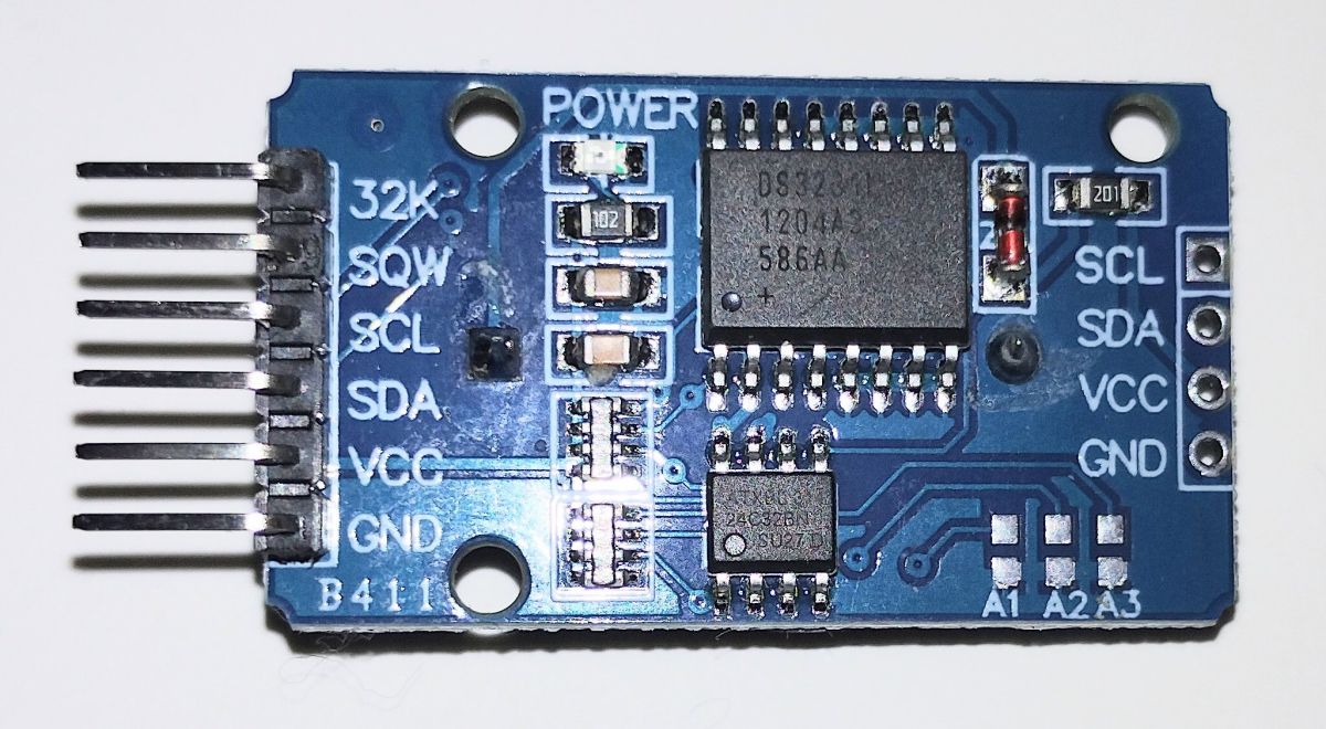

    Also allready present is a driver for the DS3231 RTC - a cheap possibility to add a battery powered RTC chip which can set the time e.g. on startup.
    It's enabled in obk_config.h with "#define ENABLE_DRIVER_DS3231 1"
    Useful in case the device has no access to another time source, e.g. when there's no internet and hence no NTP possible.

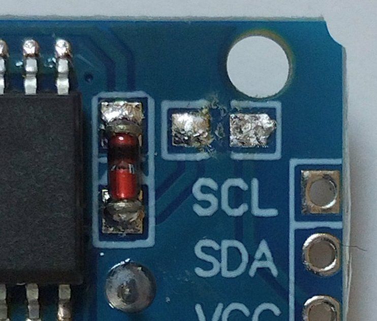

    An important hint if you have one of those cheap battery powered devices like this one: The circuit is designed for a rechargeable battery - if used with e common CR2032 this might blow up your cell (or maybe even worse).
    You can easily test if "VCC" is connected to the battery's "+" over a 200 ohm resistor and a diode. If so, I suggest to simply remove the resistor to protect your battery:
    Close-up of a PCB with SCL, SDA and VCC labels, a red diode, and soldered joints visible.
    If your hardware is clear, you start the driver with

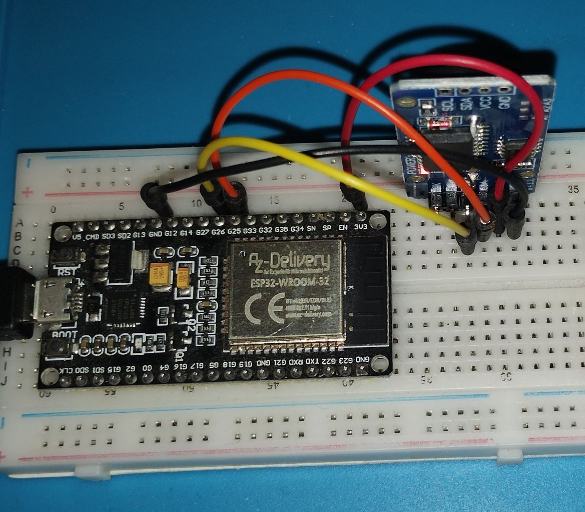

    Here's a picture of an ESP32 with DS3231 on pins 25 (SDA) and 26 (SCL).
    ESP32 board with connected sensor module on breadboard using colored wires
    So I am starting the driver with
    startdriver DS3231 26 25 1
    to set devices clock to RTC time once on startup of driver.

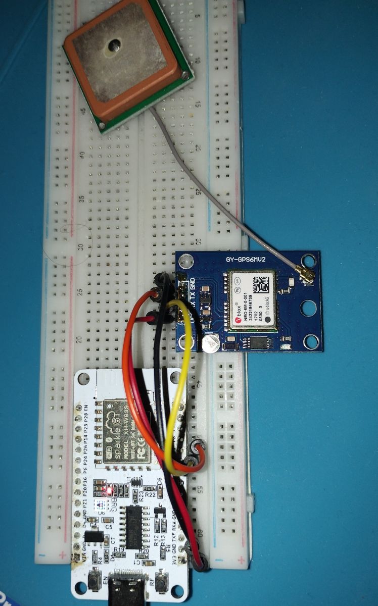

    For the devices with a usable UART, you can use my NEO-6M driver. It will decode the NMEA statements from the device and allow you to set the devices time and even latitude/longitude in case you are using "sunrise/sunset" calculations.
    The modules are quite cheap (~2.5 to 3 € on ali) an you need to connect the NEO-6M RX and TX to the devices TX and RX.
    GPS module with ceramic antenna and 4-pin female connector
    Here an example with the module connected to BK7238 module (needs "flag 26" for me, so NEO6M TX is connected to P1 and NEOs RX to P0).
    GPS module connected to ESP8266 microcontroller on a breadboard

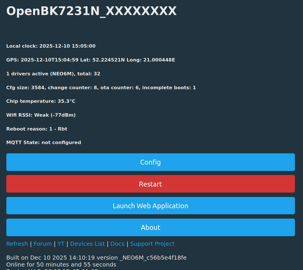

    Not tested too much, but works o.k. here ...
    Device status panel OpenBK7231N with GPS data and WiFi signal strength shown

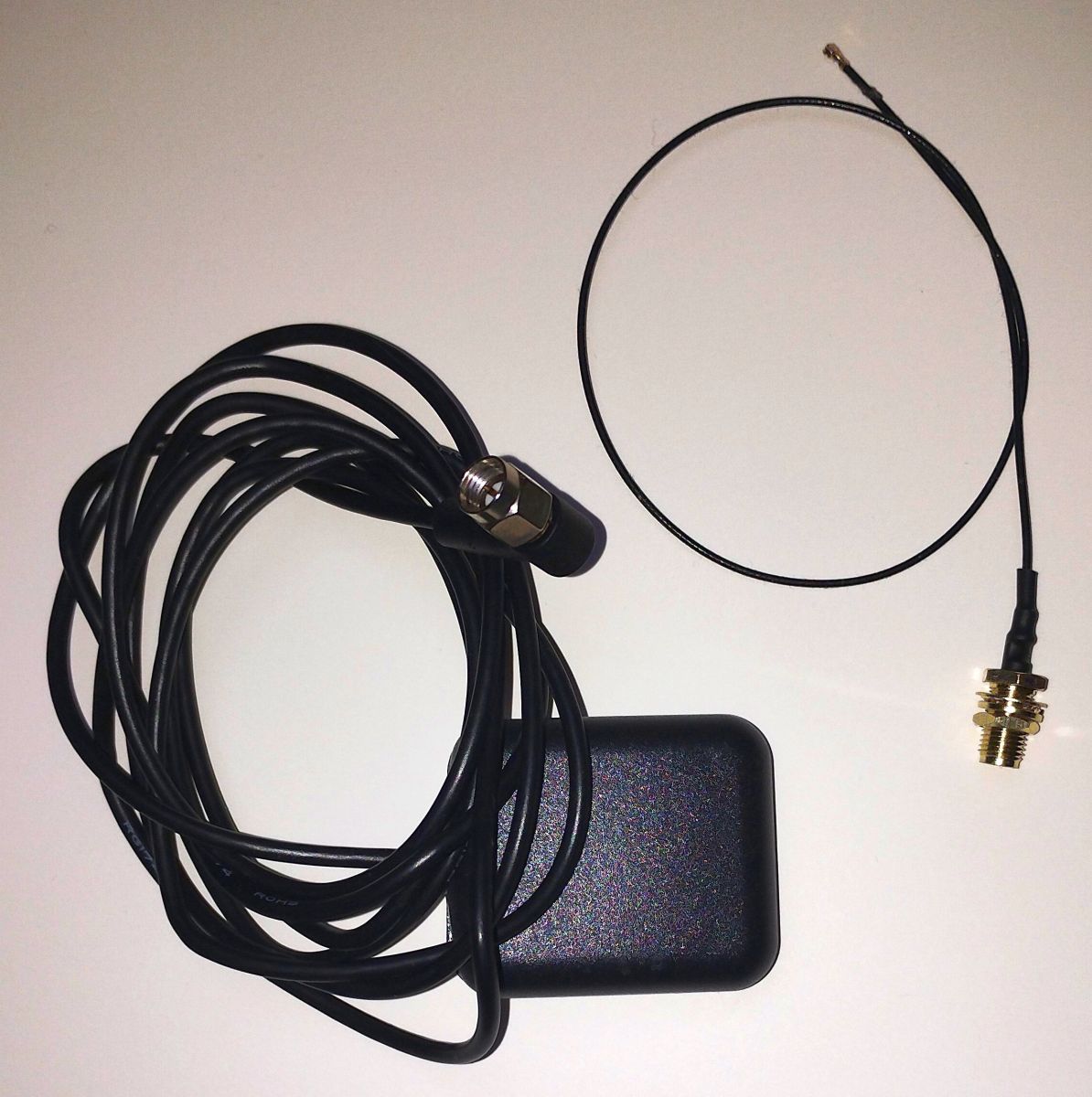

    As my desk is not directly next to a window, reception sometimes is bad. So I bought a pigtail and an antenna for a vehicle with an 2m cable.
    GPS antenna set with black cable, SMA connector, and mounting end fitting
    I didn't measure, but I'd say reception is not as good as if I lay the original antenna there - but it's o.k. to get a GPS signal even 1.5 meters away from the window.

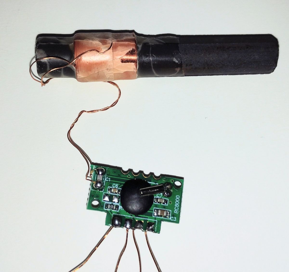

    For small money you will get a small board with an ferrite antenna like this one:
    DCF77 time signal receiver module with ferrite rod antenna and PCB
    It will decode a radio signal broadcasting the actual time in "bits" represented by signal changes. Every second there is a 100ms ("0") or 200ms "1" change which is decoded as high/low on the modules output.
    Since it's often used in battery powered devices, you need to enable reception by pulling the "PON" pin to GND.
    The driver will decode the signal by collecting the bits over one minute and then calculate date, time and DST (summer-/winter-time).
    Reception is not too reliable, even with the parity bit it sometimes receives a wrong time.
    You can therefore test, if the next signal is 60 seconds after the previous to be quite sure, reception is fine.
    The decoding is done via interrupts and tested on LN882H, Beken, BL602 and ESP platforms for now.

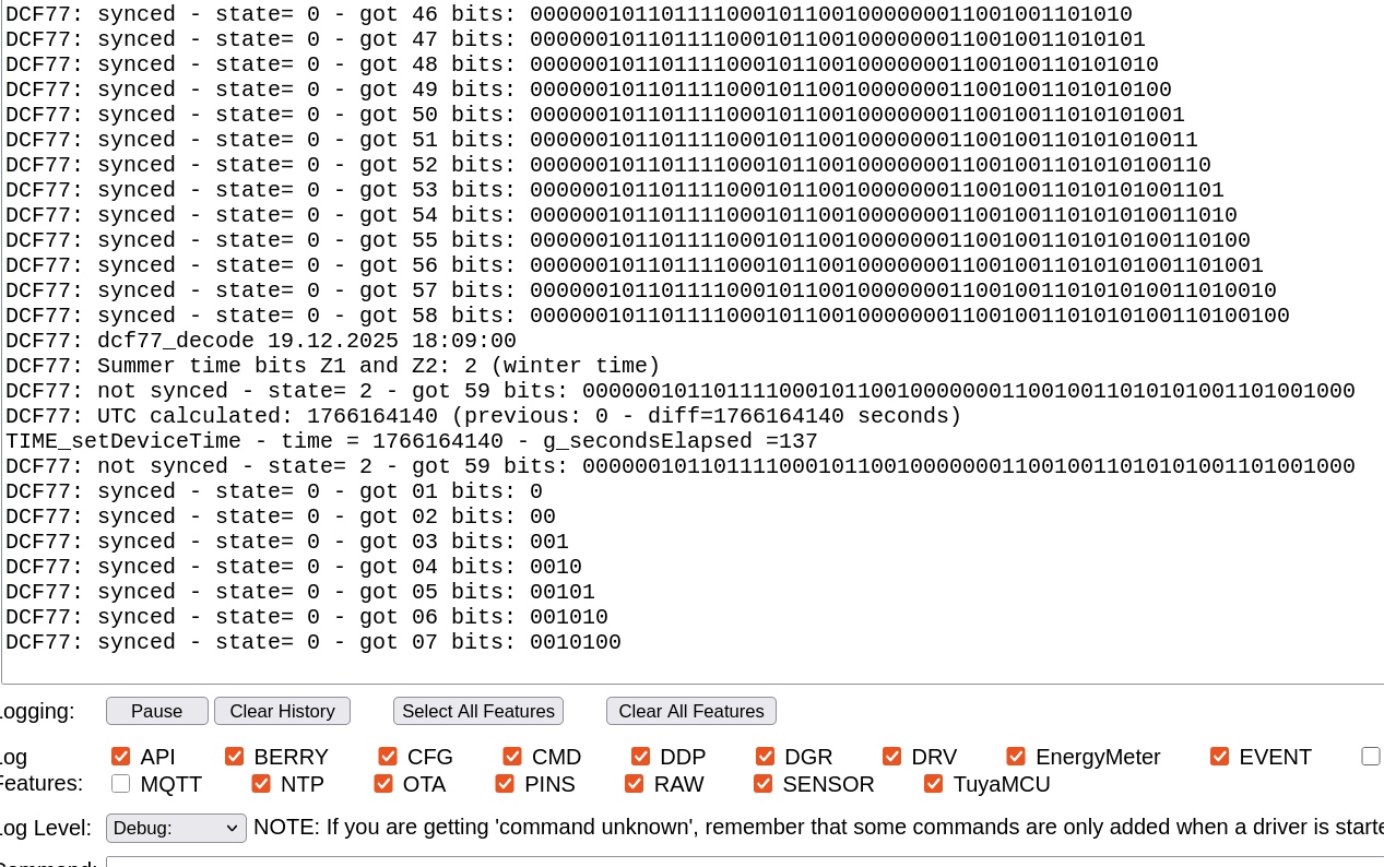

    Here's some debug output from the reception and decoding of the signal:
    Screenshot showing DCF77 time signal decoding in OpenBeken device logs.
    Starting with
    startdriver DCF77
    optional arguments are
    "fall" per default, a rising edge will mark the "bits", if you need a falling edge (e.g. if using a opto-isolator), use this argument
    "httpstat" add some details from driver on main page

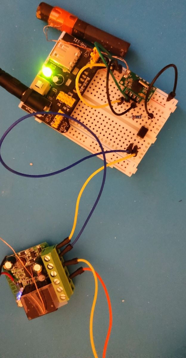

    As stated before, smart switches IO pins are usually live, so I also tried if this works trough an opto-isolator: It does (but inverts the signal in my very simple realization):
    ESP32 and DS3231 modules wired on a breadboard with USB power supply
    This shows my test with a BK7231N switch (here powered by a PoE power supply with 48V) and the receiver input on the "switch" (since opto coupler inverts the signal, I used it with "fall" argument). I'm using a common PC-817 and a 220 ohm resistor for 3.3V for DCF77 device.

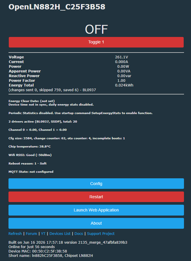

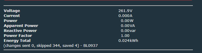

    Posts: 5236
    Help: 449
    Rate: 918
    there's a problem since 1.18.278 when this was merged https://github.com/openshwprojects/OpenBK7231...mmit/96cdd10f4769e7edf2dd34512a2588ec2de301ea
    https://github.com/openshwprojects/OpenBK7231T_App/issues/2129
    1.18.277
    Screenshot of electrical readings showing 261.9 V voltage and 0.024 kWh total energy
    1.18.278
    Screenshot of electrical readings: voltage 522.4 V, current 0.000 A, energy 0.024 kWh, and other metrics
  • #11 21922621
    Posts: 14795
    Rate: 12945
    quick guess: double edge interrupts are now default, so they are called twice as often, so measurements are twice as big?

    Shouldn't we use INTERRUPT_FALLING globally?
  • #14 21922656
    Posts: 5236
    Help: 449
    Rate: 918
    oh. i dont know...

How do I wire and start a DS3231 RTC with OpenBeken?
Connect DS3231 SCL to your chosen SCL pin and SDA to SDA. Then run: startdriver DS3231 . Use opt=1 to set time once on startup; opt=2 to resync every minute. To program the RTC time, use DS3231_SetTime or DS3231_SetEpoch. [Elektroda, max4elektroda, post #21786021]
Is there a quick Linux command to set the DS3231 to current UTC?
Yes. Example: wget -q "http:///cmd_tool?cmd=DS3231_SetEpoch+$(date -u +%s)". This writes the current UTC epoch into the DS3231 via the device’s HTTP command interface. After that, the device can read back the RTC time at boot or on schedule, depending on your driver option. [Elektroda, max4elektroda, post #21786021]

How do I use a NEO‑6M GPS module as a time source?
Connect NEO‑6M TX to the device RX and RX to TX. Start with: startdriver NEO6M setclock setlatlong. The driver sets time when GPS is locked and can update latitude/longitude for sunrise/sunset if enabled. It disables all but $GPRMC to reduce parsing overhead. [Elektroda, max4elektroda, post #21786021]
Can the GPS driver save configuration on the NEO‑6M?
Yes. Use the “savecfg” argument with startdriver to store settings on the module. That lets you persist output message choices and baud rate, reducing runtime commands. The post notes it was not heavily tested but worked as expected. [Elektroda, max4elektroda, post #21786021]
What’s the cost of adding GPS time to my device?
Approximate NEO‑6M module price is €2.5–€3. This budget option provides UTC and position for automation without internet access. “The modules are quite cheap (~2.5 to 3 € on ali).” That makes GPS a practical alternative where NTP is blocked. [Elektroda, max4elektroda, post #21786021]

What is DCF77 and will OpenBeken support it?
DCF77 is a German longwave radio time signal. The author submitted pull requests adding DCF77 as an additional time source, alongside GPS. The thread says “…to be continued with DCF77 driver …,” indicating planned coverage in that PR series. [Elektroda, max4elektroda, post #21786021]
Do I need both TX and RX lines for NEO‑6M?
The OBK driver transmits at startup to limit NMEA output to RMC only. That needs TX from the device to the NEO‑6M. If you configure the module permanently for RMC‑only elsewhere, you may wire only the module’s TX to the device’s RX. [Elektroda, max4elektroda, post #21786021]
How do I start the DS3231 on ESP32 pins 26 (SCL) and 25 (SDA)?
Use: startdriver DS3231 26 25 1. That sets the device clock from the RTC once at driver startup. Adjust the third argument to 2 if you want continuous minute‑by‑minute resync instead. [Elektroda, max4elektroda, post #21786021]
How do I wire NEO‑6M to a BK7238 running OpenBeken?
On the shown setup, the author used “flag 26” so NEO‑6M TX goes to P1 and RX to P0. Ensure the UART mapping matches your board configuration before starting the driver. Then run startdriver NEO6M with the desired options. [Elektroda, max4elektroda, post #21786021]
What commands are available to set DS3231 time?
Use DS3231_SetTime (e.g., DS3231_SetTime 19 50 01 13 8 25). Or use DS3231_SetEpoch (e.g., DS3231_SetEpoch 3269879540) for a single‑value update. [Elektroda, max4elektroda, post #21786021]
