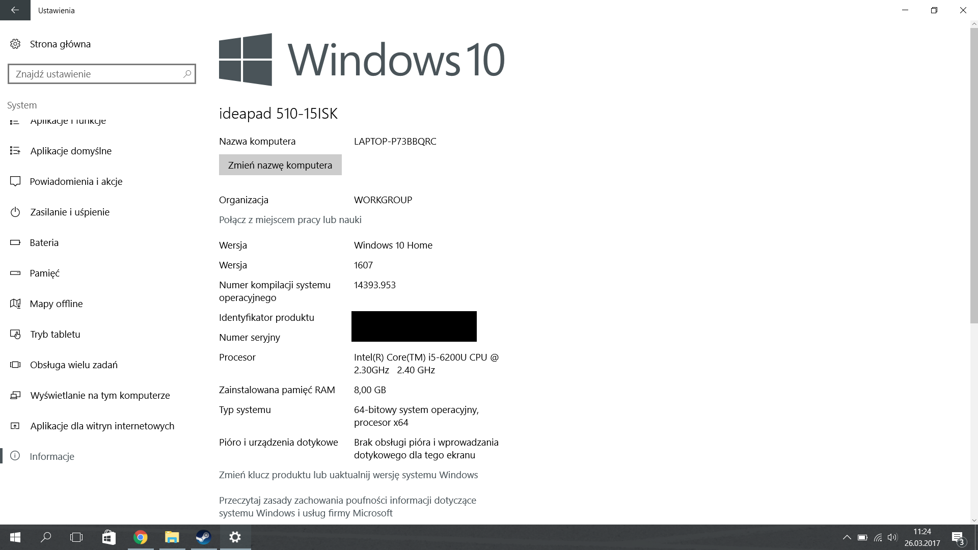

    For completeness enter a name for the laptop to which you connect this SSD + case.
    Please specify what Win., Ver. ?

  • Windows 10 compatibility is missing from enclosure specifications
    #6 16372288
    lisek
    Service technician RTV
    Posts: 39992
    Help: 6352
    Rate: 6883
    The Gauntlet 3 enclosure measures in at only 120mm (L) x 77mm (W) x 16.5mm (H), weighs only 100g.
    Compatible with: Windows(R) XP, Windows Vista(R), Windows, 7, Windows(R) 8, Windows(R) 8.1, Mac OS X, and Linux systems.
    Win 10 not listed ?!
    From what I remember, most of these cases (e.g. Espada FG-HU304B-1AB-BC01 / AgeStar 3UB206 with USB 3.0 / ...)
    supports only: XP 32/64-bit, Vista 32/64-bit, Windows 7 32/64-bit, Windows 8 32/64-bit
  • #7 16372298
    Adax539
    Posts: 6
    The case works under Win10 but with HDD and the problem is with SSD: /
