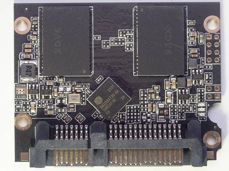

  • #3 17178489
    gsurowiec
    Thanks for the answer.
    The problem is that the disk is visible in the system (device manager), visible in the utility (SMART, info about software version etc.), but I am not able to access the data. Disk manager shows offline status. It cannot be "restored". Tools like EaseUS Data Recovery Wizard are unable to get to it.
    The disk ran for 3 months and suddenly it "died".

  • #7 21446386
    lisek
    Service technician RTV
    Posts: 39992
    Help: 6352
    Rate: 6883
    From the study Link .
    - shows that the Phison PS3111-S11 ctrl with famous FW from SBFM series
    p.s
    In the Burst Elite 240GB series (Patriot Burst Elite [PBE240GS25SSDR]) there were other ctrl SMT2259xa (xt)
    - such as FW V1103A0

    kaleron
    Posts: 7114
    Help: 963
    Rate: 2344
    There were different configurations sitting under this sticker on different controllers and with very different memory chips, so you just have to check what's sitting in this particular unit.
