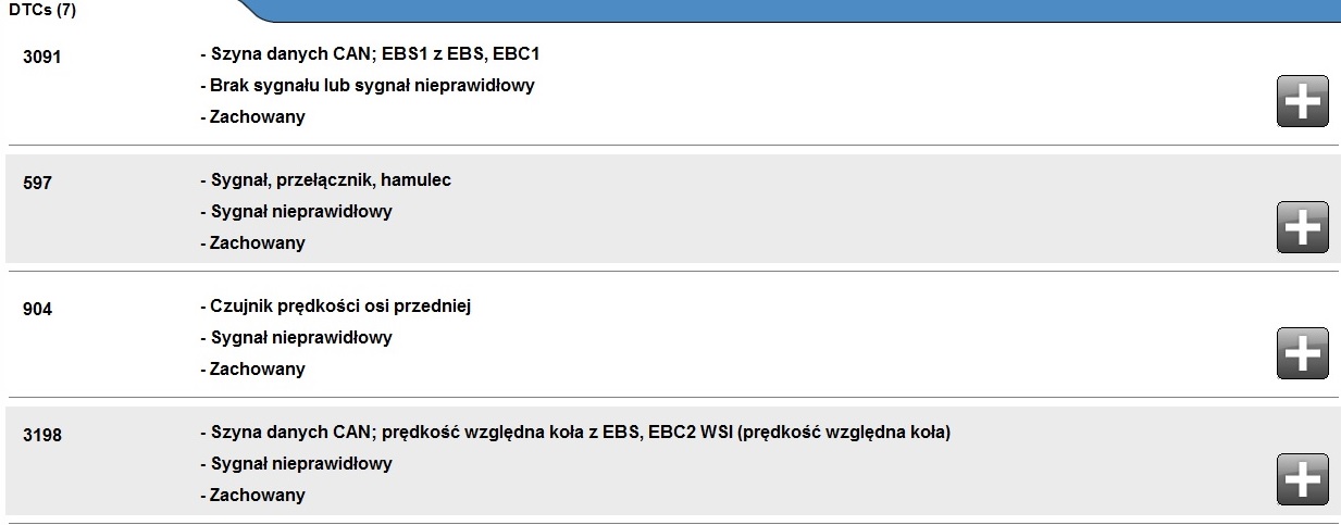

    Hello, as in the title, after turning the ignition on, the letter N flashes and the error: Gearbox warning, no gear can be shifted. Sometimes the condition disappears after a while.
    Previously, there was a problem, but after checking and insulating the cables, it has disappeared, and now it has reappeared (previous in the topic: http: //www.elektroda.pl/rtvforum/topic3290754.html
    Autocom displays errors:
    brakes:
    DAF XF 105 460 AsTronic Gearbox Issue: N Flashing, Gearbox Warning, No Shifthamulc..jpg (67.78 kB)You must be logged in to download this attachment.
    No errors after deletion.

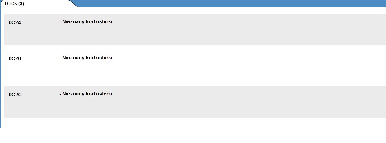

    Transmission:
    DAF XF 105 460 AsTronic Gearbox Issue: N Flashing, Gearbox Warning, No Shiftskrzyn..jpg (75.52 kB)You must be logged in to download this attachment.
    After deletion:
    DAF XF 105 460 AsTronic Gearbox Issue: N Flashing, Gearbox Warning, No Shiftskrzynia p...owaniu.jpg (47.6 kB)You must be logged in to download this attachment.
    More and more problems with my Dafik :(
    Thanks in advance for all the advice on what to do.

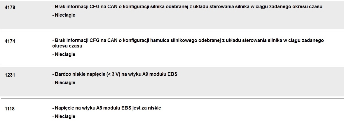

    After the ride, I read the errors, apart from the unknown ones, new ones appeared:
    DAF XF 105 460 AsTronic Gearbox Issue: N Flashing, Gearbox Warning, No ShiftBez tytu..2.jpg (90.6 kB)You must be logged in to download this attachment.
  • #4 16400122
    rafaltom0
    Posts: 47
    Rate: 12
    Board Language: polish
    Gentlemen, there's a new problem.
    When the above mentioned idle does not occur and you can go, the following error starts to appear while driving: Gearbox warning, and the number with the gear engaged flashes. The gearbox is still working normally, it shifts gears, but you cannot switch to manual. After stopping and engaging neutral and gear again, it is quiet for a while, then the situation repeats itself.
    I reread the errors, but apart from the ones above, only one unknown appeared:
    DAF XF 105 460 AsTronic Gearbox Issue: N Flashing, Gearbox Warning, No Shiftskrzyn..jpg (75.98 kB)You must be logged in to download this attachment.
    In addition, new bugs with ABS:
    DAF XF 105 460 AsTronic Gearbox Issue: N Flashing, Gearbox Warning, No Shifthamulc..jpg (80.24 kB)You must be logged in to download this attachment.
    Where to start here? Do I have to find an electrician?
    #5 16400140
    kisiol
    Level 20  
    Posts: 1643
    Help: 36
    Rate: 468
    I would go over the installation again.
  • #6 16404156
    rafaltom0
    Posts: 47
    Rate: 12
    After the car was stopped, there was a frayed cable in the weave to the box.
