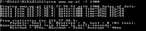

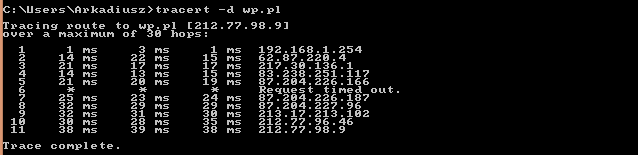

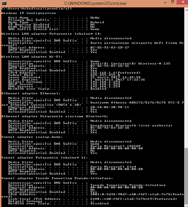

    My laptop had no internet problems 2 years. Suddenly the connection broke from day to day. I thought it was a sign that it's time for format. I restored the system to its initial settings, updated the drivers, installed more important programs.
    It was ok for a week.
    Two days ago the net broke up again, ie: the laptop connects to the router and according to my laptop I have Internet, but when I go to any page it displays that "this site is unreachable".
    My laptop: lenovo g500
    A router is an ordinary basic netia router (you can turn it off at most).
    Antivirus: basic avg
    I would ask for help. And thank you for your interest in my case
    Currently, I only have a telephone with the Internet (which connects to the router without any problems)
    edit:
    I posted screenshots of the commands that were asked on the forums for similar problems
    • Lenovo G500 Laptop Can't Access Websites-Connected to Router, Site Unreachable, Netia, AVG tar.png (7.23 KB) You must be logged in to download this attachment.
    • Lenovo G500 Laptop Can't Access Websites-Connected to Router, Site Unreachable, Netia, AVG pin.png (6.83 KB) You must be logged in to download this attachment.
    • Lenovo G500 Laptop Can't Access Websites-Connected to Router, Site Unreachable, Netia, AVG ipconfig.png (36.96 KB) You must be logged in to download this attachment.

  • #9 16385834
    Tomikami
    Uninstalling avg helped ...
    Only now I have two questions: why my avg suddenly reflected? And what antivirus should you install then? In fact, since I have been in contact with computers, I've always had avg and walked without complaint: /
    Thank you for your help!
