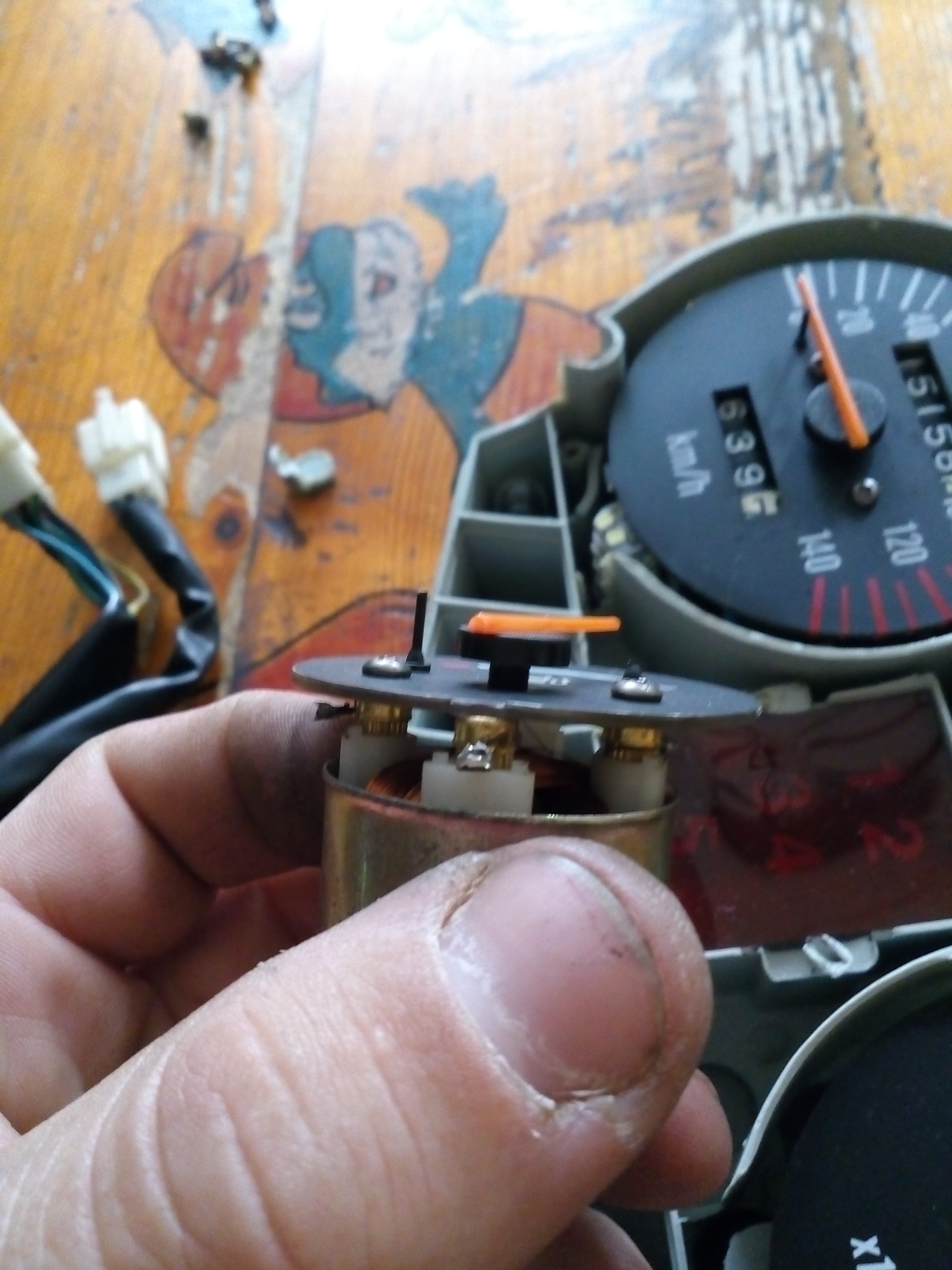

    Hello. I became the owner of Romet. The fuel gauge does not work. Apparently, the resistor was heating up terribly. Unfortunately, the previous owner died. What resistance is there and what power? 2w? 100ohm?
    Added after 36 [seconds]:
    Possibly, could it be something that caused its heating, apart from the damage itself?

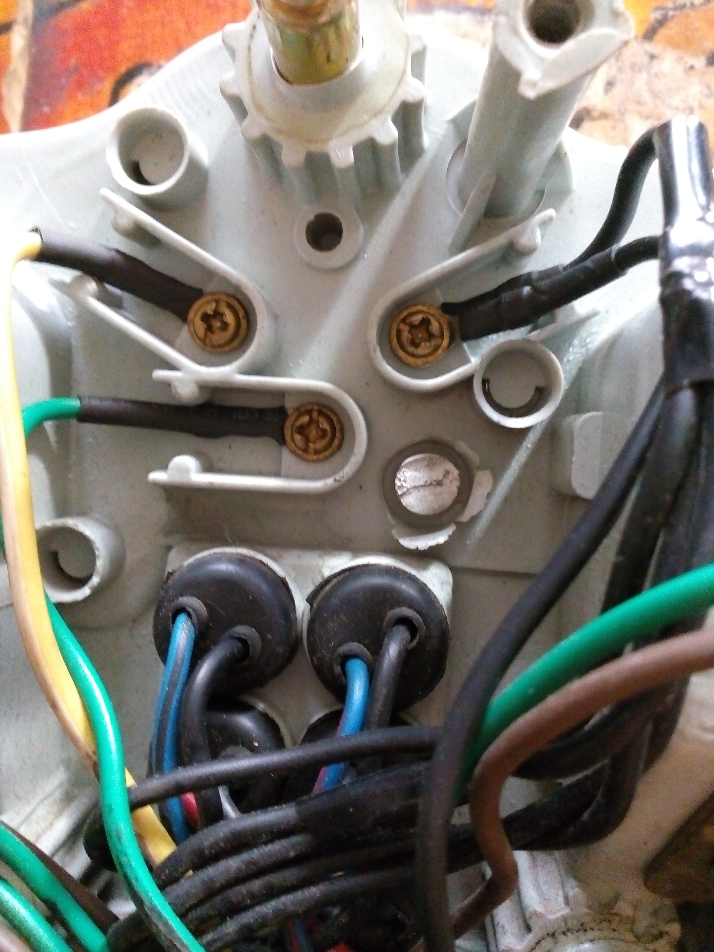

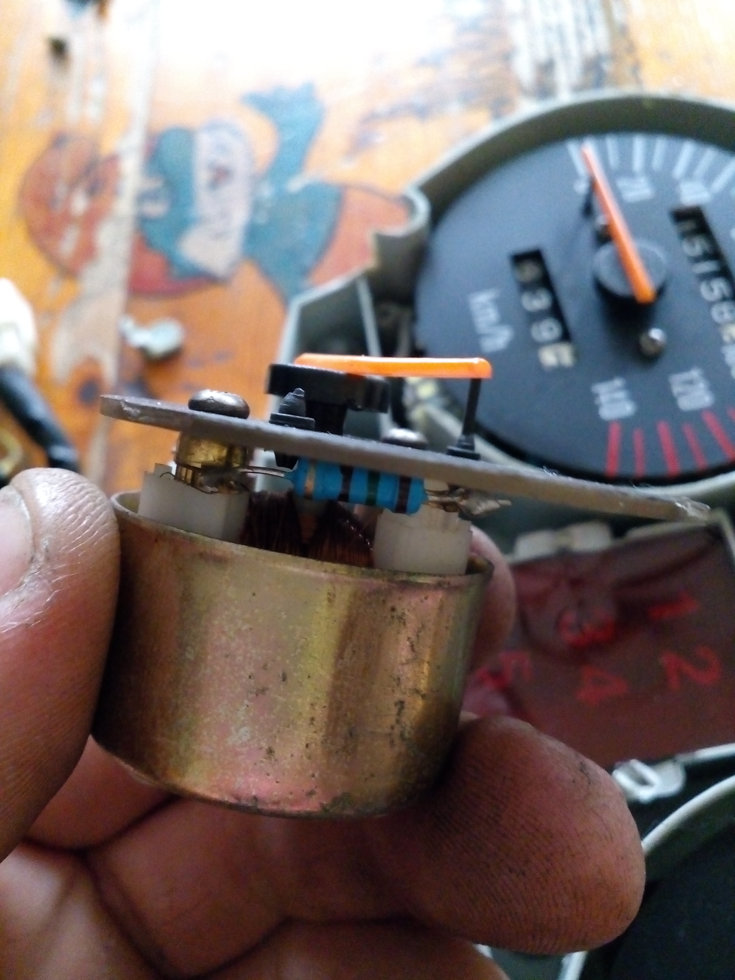

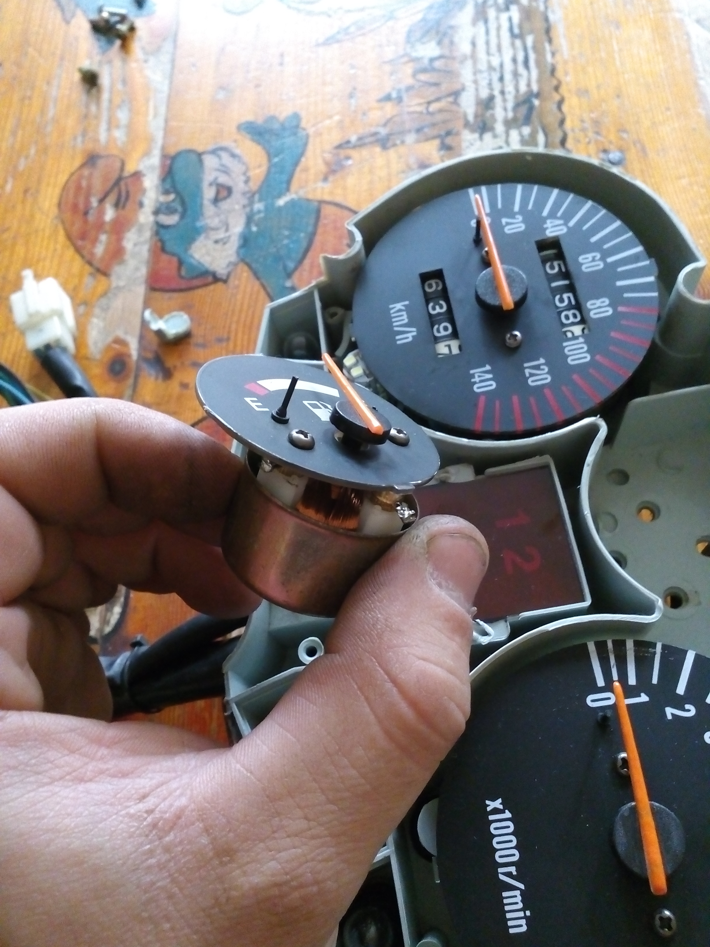

    I took pictures. The resistor that was there and was heating was 75ohm. If I find one or a similar one and twist it, I will measure the tensions. Only if someone has screwed these cables going to the indicator well?

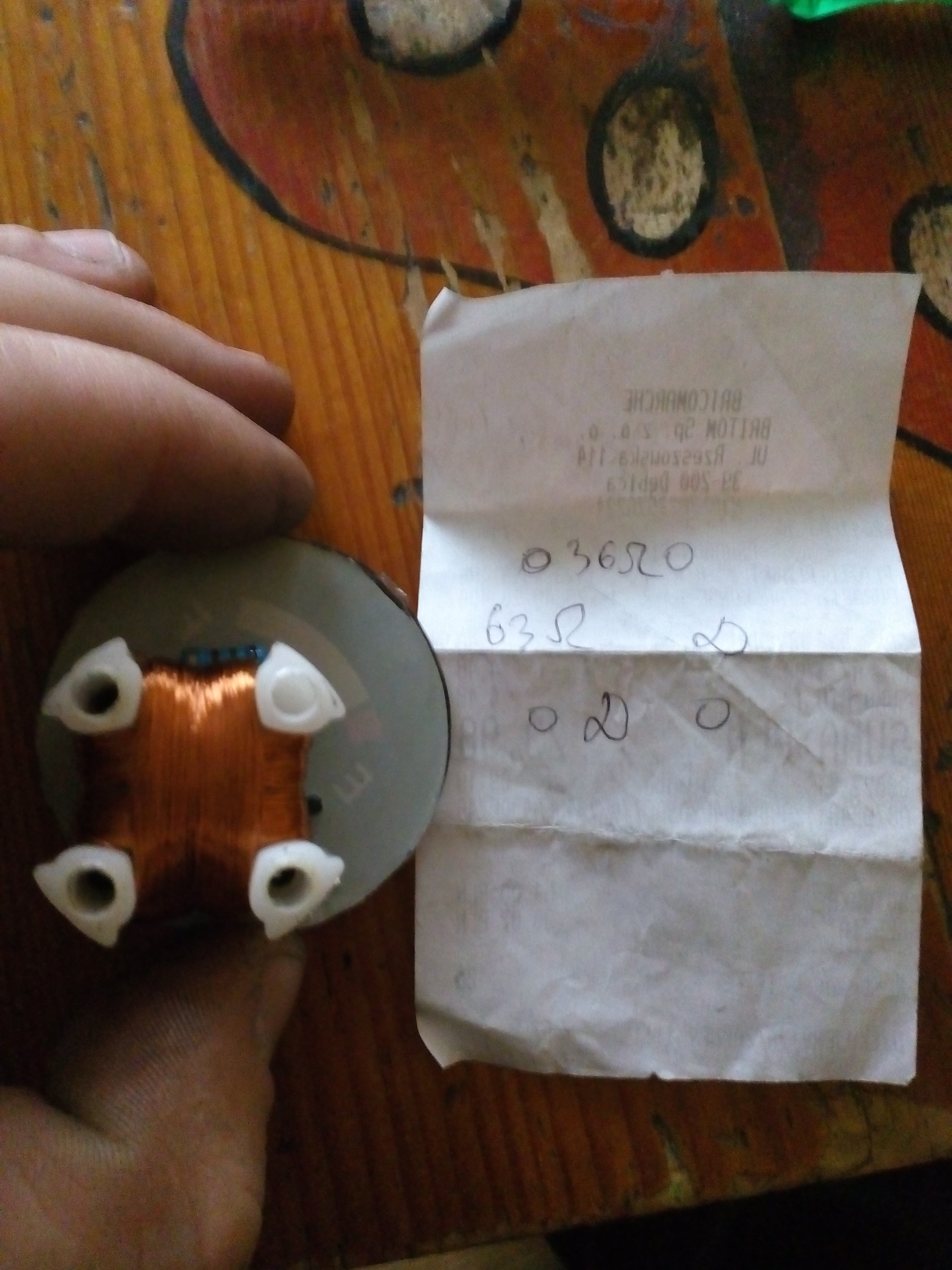

    I put a 27ohm resistor, but it actually warms up. Winding resistance.
    Here are the photos.

    The black cable is + 12V power supply. The second black one probably goes to the controls from gears. Green is mass. On the pipe 0. Yellow is probably an impulse. There is 70 between the mass and the mass of the pipe. The voltage between the yellow and the black is the same as on the power supply.
