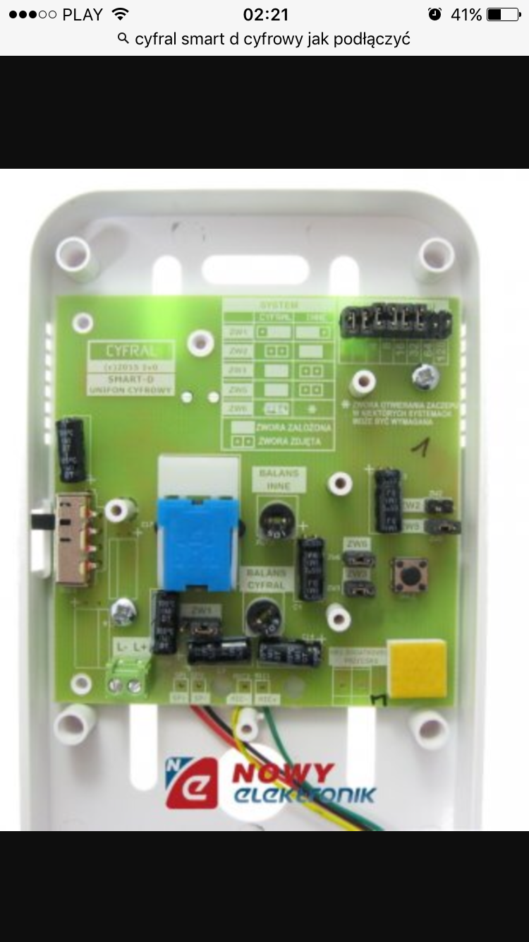

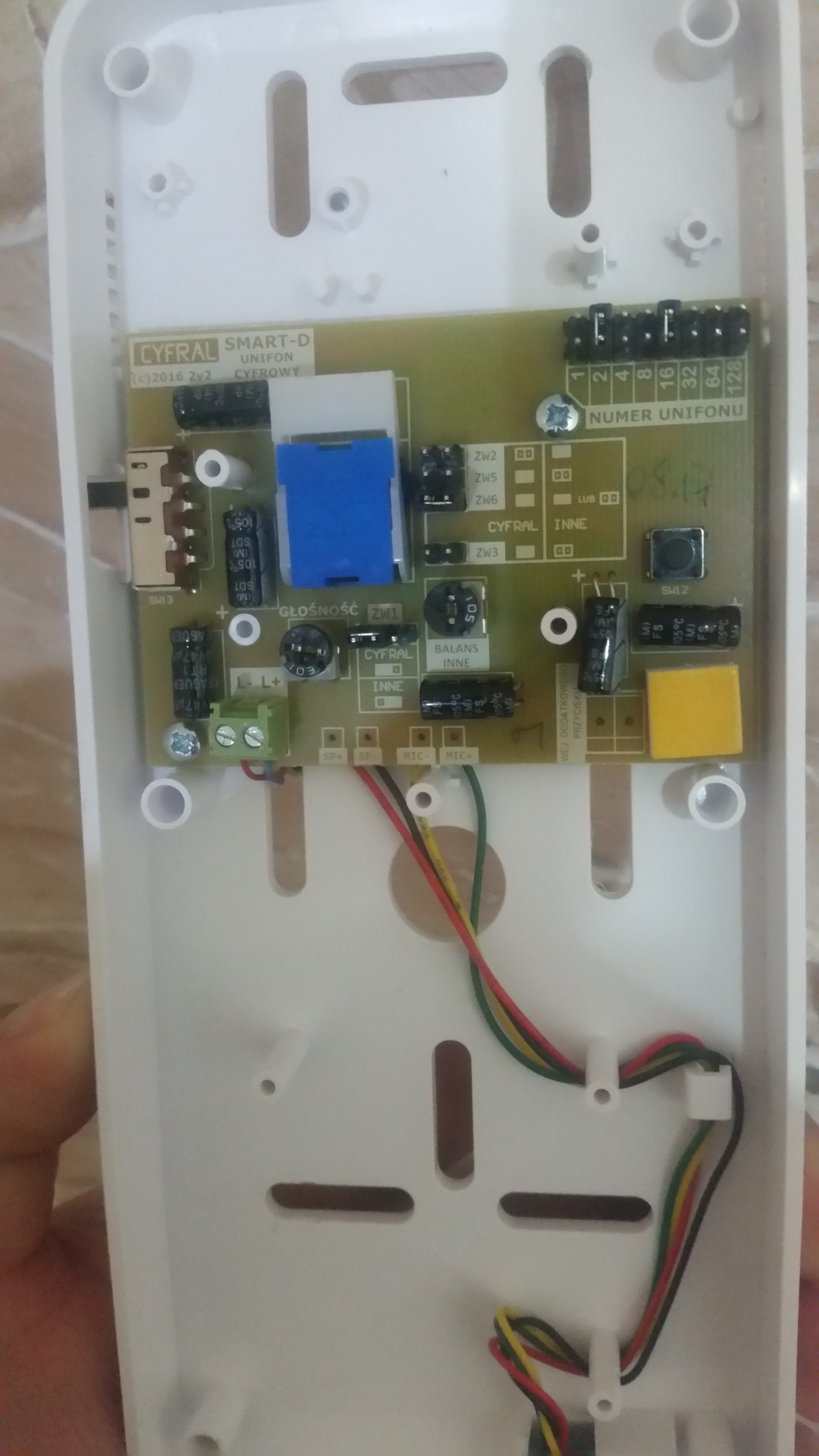

    Hello, a few days ago I bought a new digital doorphone cyfral model smart D already tried a lot of connection methods and the most common problem is silence on both sides while receiving the handset and only accompanied by a very loud squeak in the apartment and the door to the building: / I would be very grateful for help

    There is only one option to connect the cables. One of them (twisted white and blue) is a minus one and the other (white and brown) is a plus. You give respectively a plus on the L + terminal and minus on the L- terminal. I do not know, therefore, what a lot of your other ways were.
    Jumpers determine the number of the flat, or more precisely their sum (14). In other words, it has to be like the previous one.
    Regarding the squeaks, this instruction manual and assembly explains what to do. There is a reason for the "Balance Cyfral" and "Balance others" regulations.

    This is how the connection looks like at the present moment. Now there is no signal for the doorbell on the intercom Connecting Digital Doorphone: DALRAL Smart D - Cyfral Model - Common Issues & Solutions

    Place the ZW1 jumper in the left position and remove the ZW3 and ZW5 jumpers
    greetings
  • #6 16451851
    Hesssu
    Posts: 6
    Thank you very much, it works !!! How do you write in KC, and even though I can use beer, I can repay you

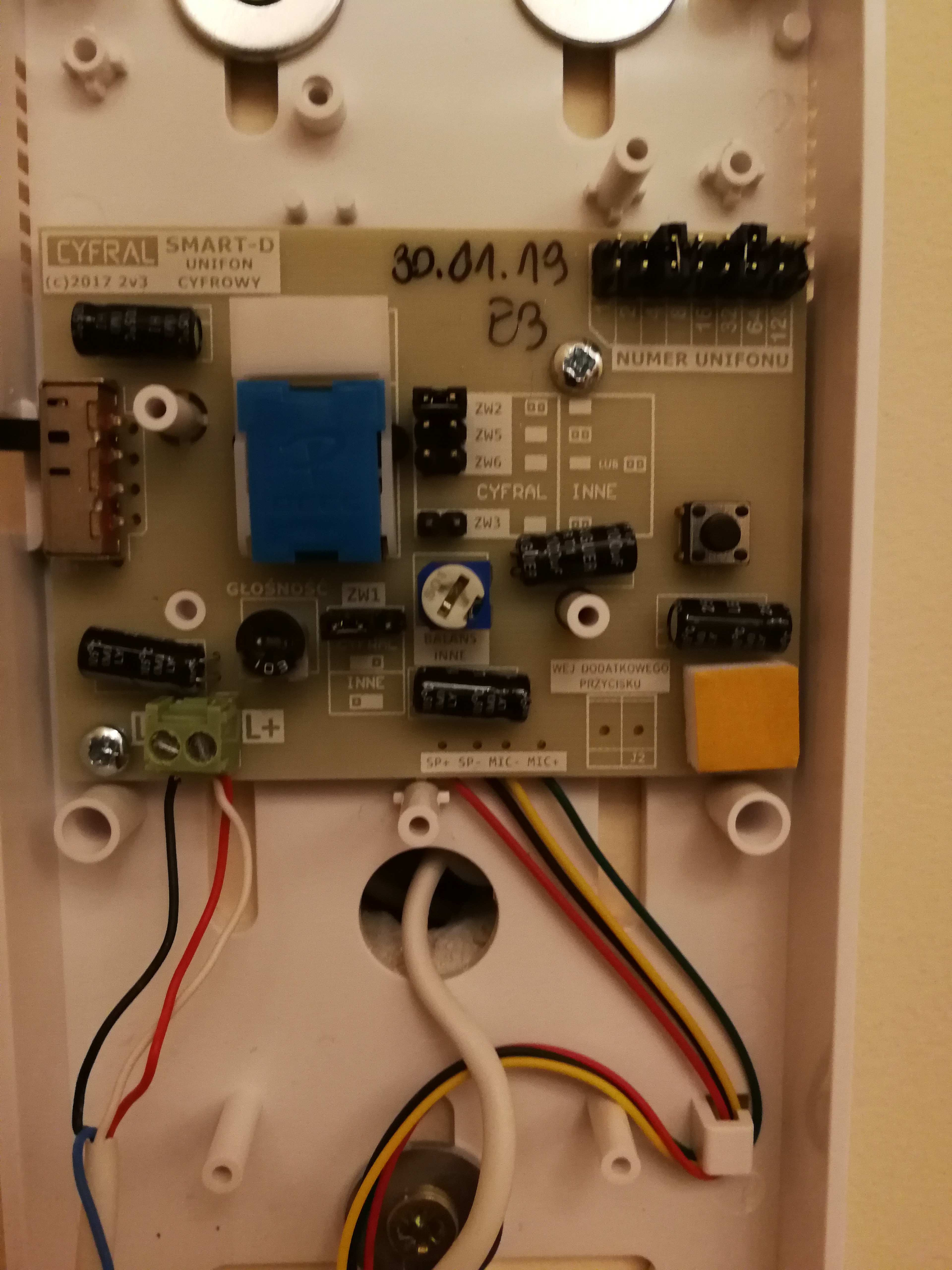

    I connect to the topic I have a problem with connecting the intercom as a colleague under the slican system. yes, I have my intercom in my apartment. can anyone help me?

    I suppose that the red cable from the installation is supposed to be a plus and the blue one in minus. You have the opposite.
    There are other jumpers besides the apartment number, which should be set as described.

    the number of the apartment I have 18. and so I have set. and I have already changed the red with blue. and, unfortunately, nothing further, what about the rest of the jumpers?

    Of course, the apartment number is set correctly. Other jumpers as described. You have described there how to set them. For example, you should move ZW1 to the right, because it is left for Cyfral and right for others. Similarly, you have to deal with the remaining jumper. In the end, there are not too many of them to not cope. I assume there is some tension on these cables.

    thanks to zybex. I set and the intercom rings but unfortunately now I have a problem because in my ear a little burzą try to regulate the balance, but nothing gives and most importantly I can not open the door with a button. does anyone have any idea?

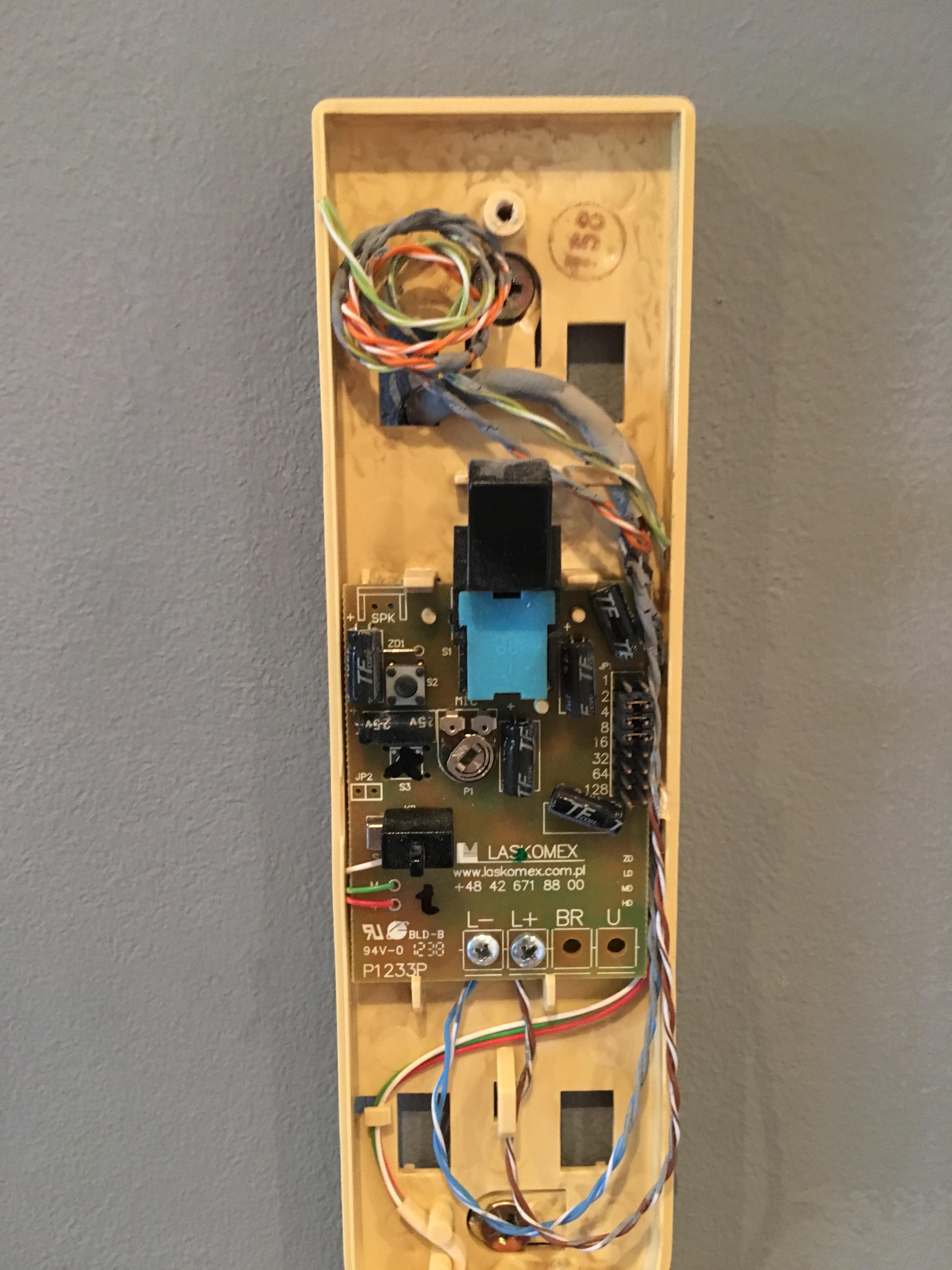

    I warmly welcome. I searched the electrode forum in search of the answer to the question: how to connect a 4-wire cable from the Laskomex D-2502 control unit to the Cyfral Smart-D doorphone? I set the jumpers according to the advice of colleagues from other posts, and my apartment number is 36. Cable colors: red, white, blue, black. [Img] https://obrazki.elektroda.pl/6299742000_1555701179_thumb.jpg [/ Img]

    You need to find 2 wires on which there is constant voltage. Then connect them according to the marking to the terminals. In addition to setting the apartment number, you need to set the remaining jumpers (ZW) as described.

    The voltage is on a white and red cable, and the L + I L- socket is connected to it. Should I connect white and red and connect to L +, black to L-?

    Plus to L + and minus to L-. To check the operation of the uniphone, it is necessary to call it from the cassette.
