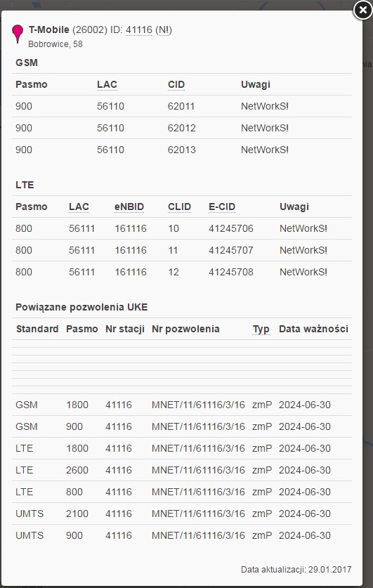

    A friend lives in the town of Barłogi (Lubusz Voivodeship) GPS: 51.944926 15.060110 51?56'41.73 '' N 15?03'36.40 '' E
    Inter Mobilny in t-mobile.
    Equipment:
    Asus rt-ac51u
    Alcatel Link Key IK 40 modem
    and 2 other modems (if I know their models, I will give one of them had an additional antenna)
    Problem:
    Mobile internet T-mobile worked "well" for 1 month, after 1 month it stopped. As mentioned, a friend used a hot spot shared on the phone. I checked my devices at home. I have max 2km to the transmitter. It is true that speed did not catch up but it worked stably. I am 99% convinced that he has a coverage problem. There are a lot of forests around, max 2 lines on the phone, often 1-2 lines.
    The card inserted into the phone is still somehow the Internet but the modem or modem + router practically does not connect.
    I think the best solution would be to sell your current equipment and invest in a modem + external antenna or router + external antenna.
    Question: What is currently "cheap" on the market that would allow us to obtain stable coverage. Could be used equipment.
    ps: There is also an option to leave the router, check the other modem models and buy the antenna. Of course, after checking whether the router supports the modem.

    Hey,
    I think so too, it's important that it's stable, nothing more. I will find out what equipment it has and I will arrange the connector and antenna for the equipment.
    Near her town is even LTE range working on the 800Mhz band from T-mobile. The town of Bobrowice, about 2km away.
    Will this antenna be good? Http://www.cybertech.com.pl/p89,antena-atk-10-13-5dbi-kabel-fme-z.html Is there any cheaper alternative? (May be a drug)

    If the BTS LTE800 T-mobile in Bobrowice works or rather so, then the OK antenna selection, only two pieces placed one element vertically and the other horizontally. Connectors for modems. a friend chose the tragic Alcatel. how does it work with this asus on which FW?

    LTE works in MIMO hence two antennas if you want to get the maximum speeds. A friend must start by purchasing an LTE modem supported by Asus. Probably E3372.
