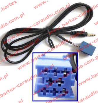

    Hey. I have such a radio. Listen, I would like to connect bluetooth to it, is it possible, and can such an ISO plug with a jack connected to it work?

    According to the given INPUT CD description, you have 19, 20 additional connectors on the pin. The cable must be connected to them and of course they must be connected. Ask if this is how the cable presented in the auction is made.
    Rather you need such a plug:

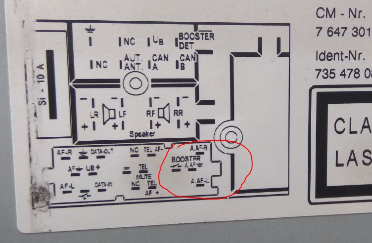

    because you have such a connector on the radio - socket:
    Connecting Bluetooth to Bosch Fiat Fiorino Qubo Car Radio: ISO Plug & Jack Compatibility
    is not it?
    "Connector connected to BLAUPUNKT headunits with ISO-36Pin socket" is presented above.

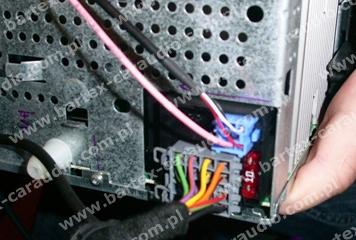

    I bought a mini ISO, a female jack and plug in ... unfortunately to no avail, what am I doing wrong? I connected to 19 and 20 and I massed once 17 and 18 and plays but very quiet something is wrong ...

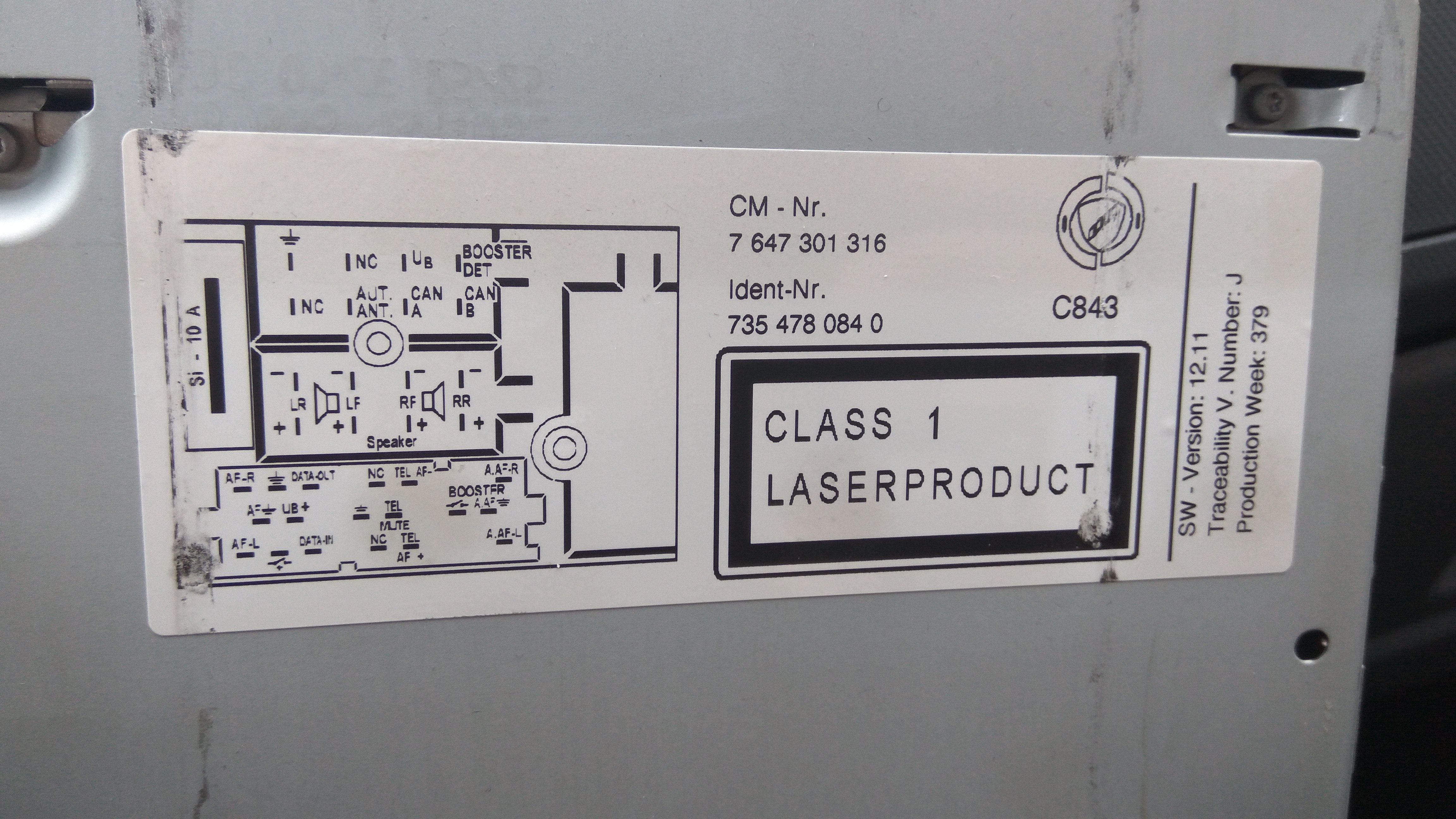

    I wonder if you do not need to connect here, after all there is the inscription booster (amplifier) and when connected in pins 19 and 20 it sounds, but soooo quiet.

    Buddy, don't worry, it is designed to control an additional power amplifier.
    Answer the question, what is your specific source of signal?
    Give the signal from the headphone output of the MP-3 player and slowly increase the signal while observing the radio response.
