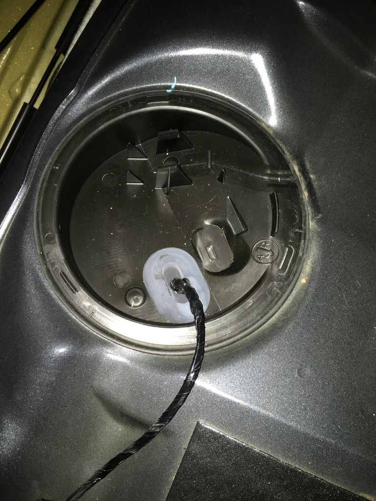

    How to open the second lid above the pump itself?

    Nooo, the point is that under the main flap, after opening, there is a second flap through which the cable goes somewhere lower - probably to the right pump

    We don't understand each other
    I only need to get to the plug on the pump without removing it. Above this plug I have two black lids. The first one comes down with two latches. A second lid with a cable gland appears underneath it. The second lid rests on the metal floor on the gasket. I can't take it off and I mean it. Only beneath it I will find the pump nut and the plug
    Added after 1 [hours] 50 [minutes]:
    Testing Fuel Pump Functionality on Laguna 3, 2.0 dci, 150 HP, 2013 - Step by Step Guide
    I mean this case back
