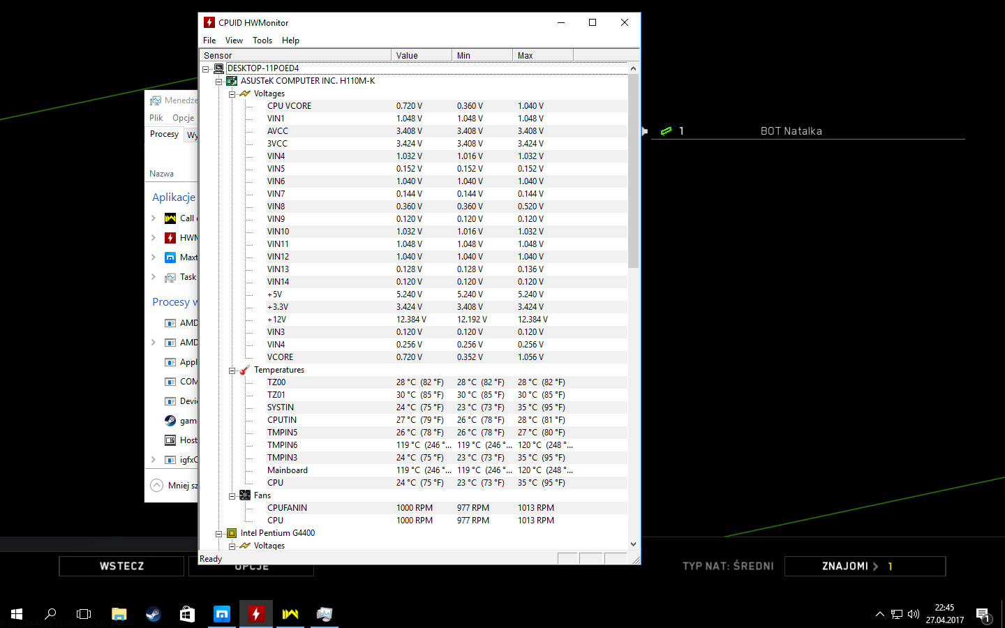

    Kraniec_Internetów wrote:
    When it is cut again, check the component temperatures.
    And it's best to make screenshots with all readings visible and post here.
    Also complete the equipment configuration with information about the make / model of the power supply.

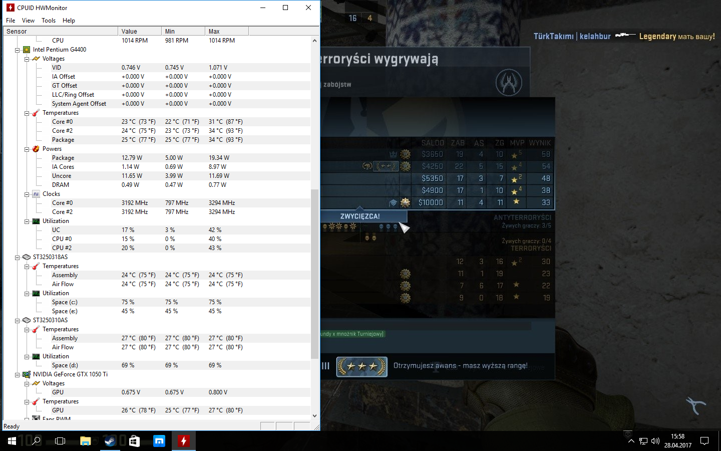

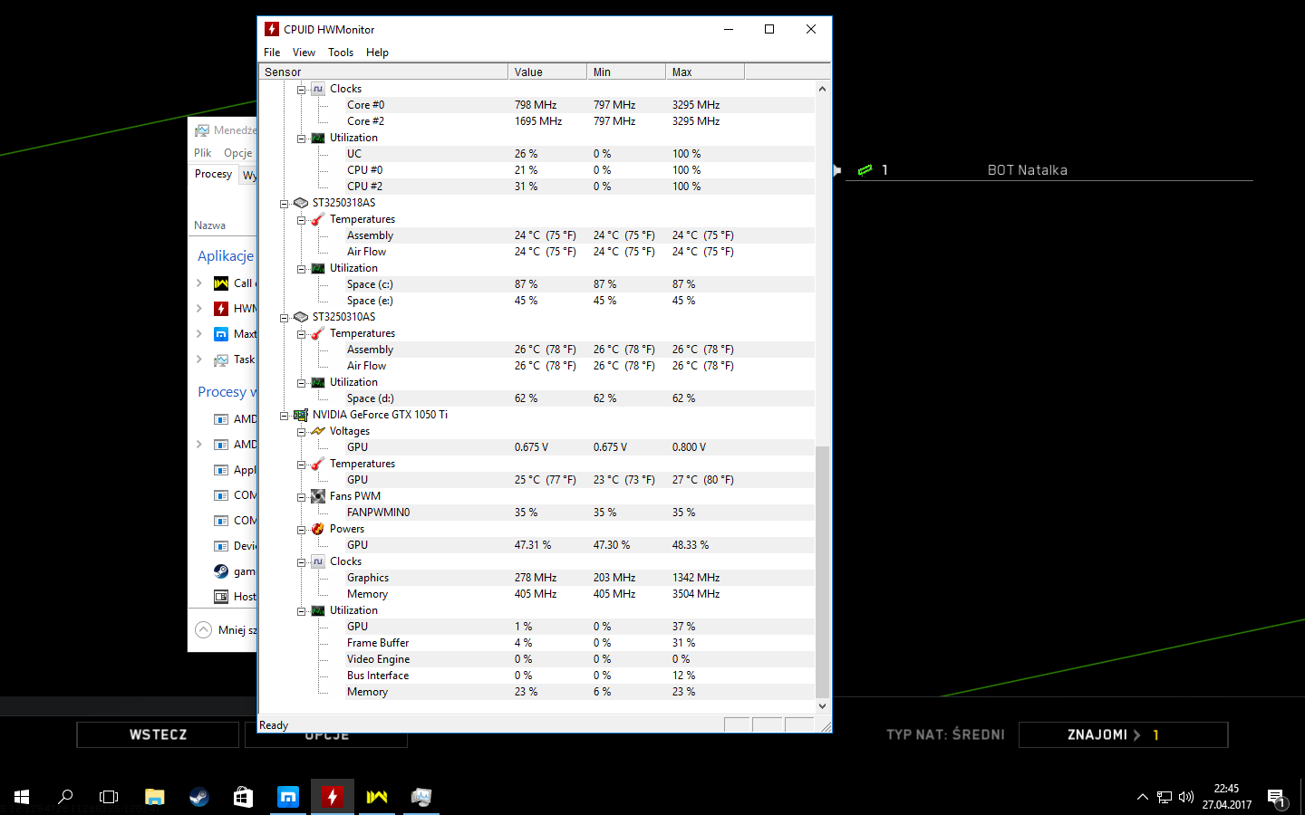

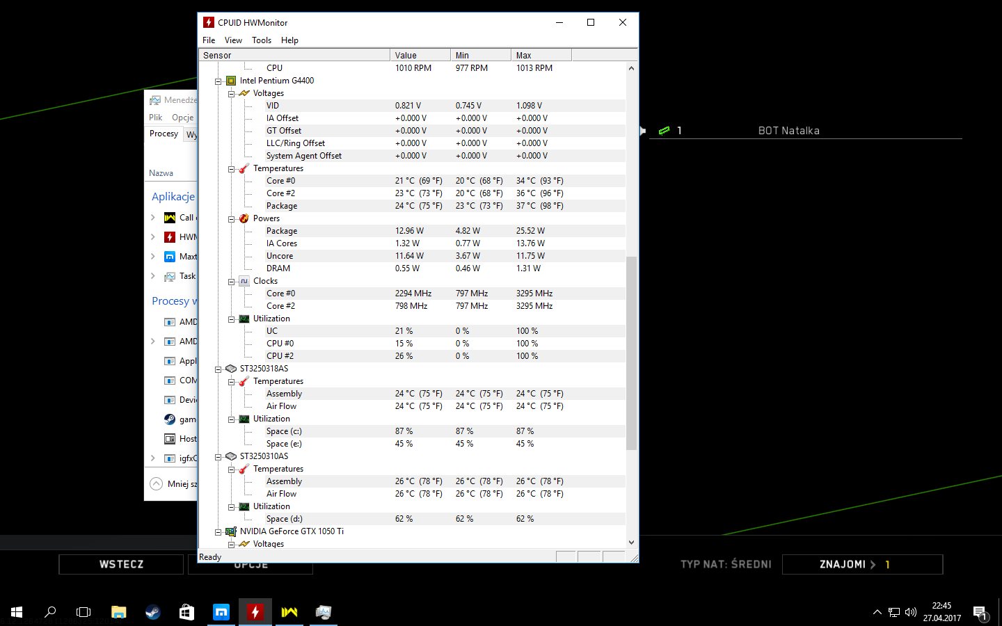

  • #4 16441311
    ciekawywszystkiego
    Posts: 20
    So I attach screenshots. For me it's a joke that it doesn't work .. but what to do.
    Polish brand power supply for allegro for 100 but has 80+ certificates. 550 watts
    • Call Of Duty Infinite Warfare - After switching on, a minute passes and the imag gfdgedf.png (78.12 KB) You must be logged in to download this attachment.
    • Call Of Duty Infinite Warfare - After switching on, a minute passes and the imag dsadadadasdada.png (78.68 KB) You must be logged in to download this attachment.
    • Call Of Duty Infinite Warfare - After switching on, a minute passes and the imag sdasdasdasd.png (80.22 KB) You must be logged in to download this attachment.
  • #5 16441334
    RADU23
    Posts: 20718
    Help: 2428
    Rate: 1732

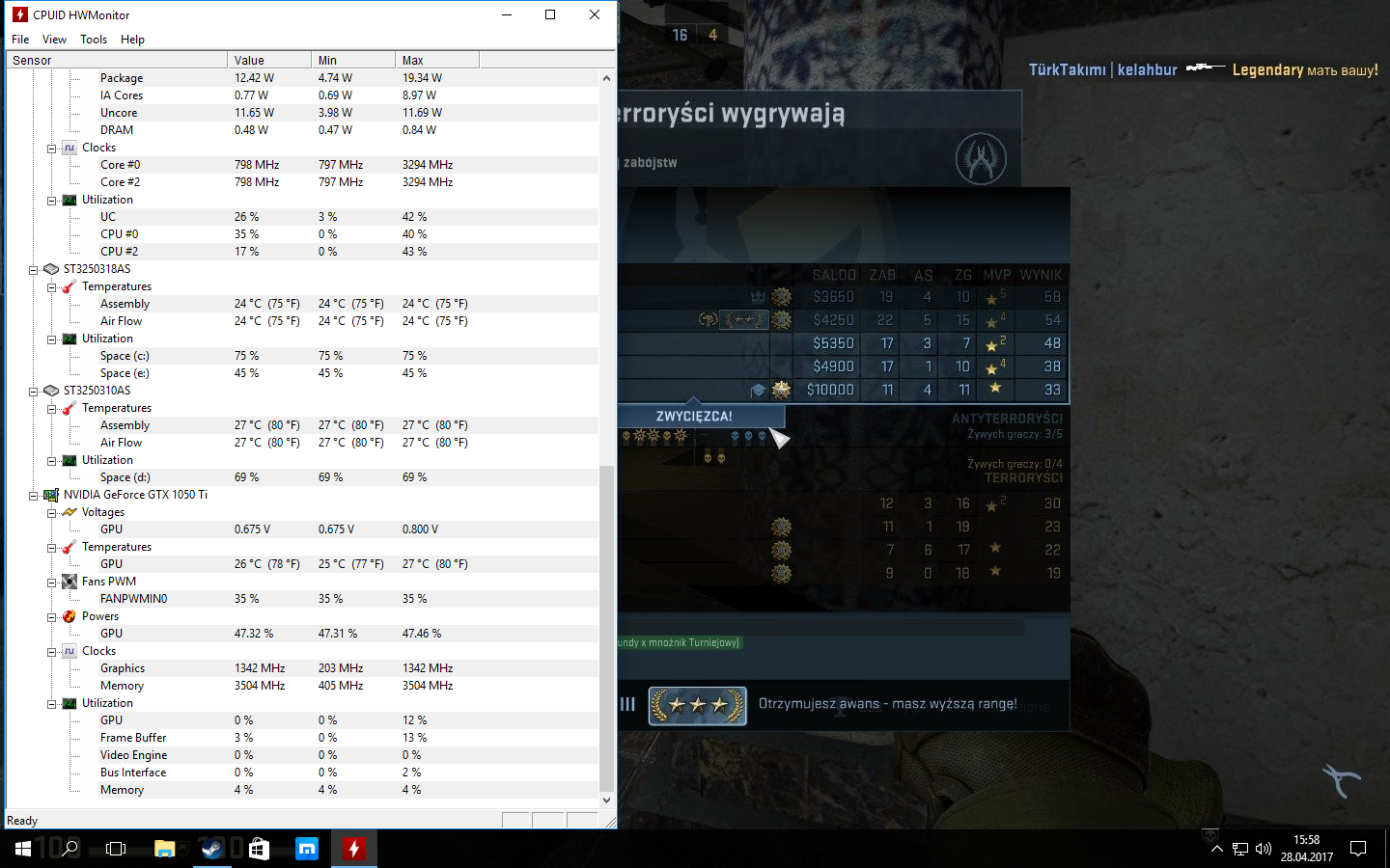

    Turn on HWMonitor in "sensors-only" mode, turn on the game. When it is cut again, check the component temperatures.
    So you were supposed to include temperature readings while the equipment was loading.
    And from the attached photos you can see that the temperatures are from idle.

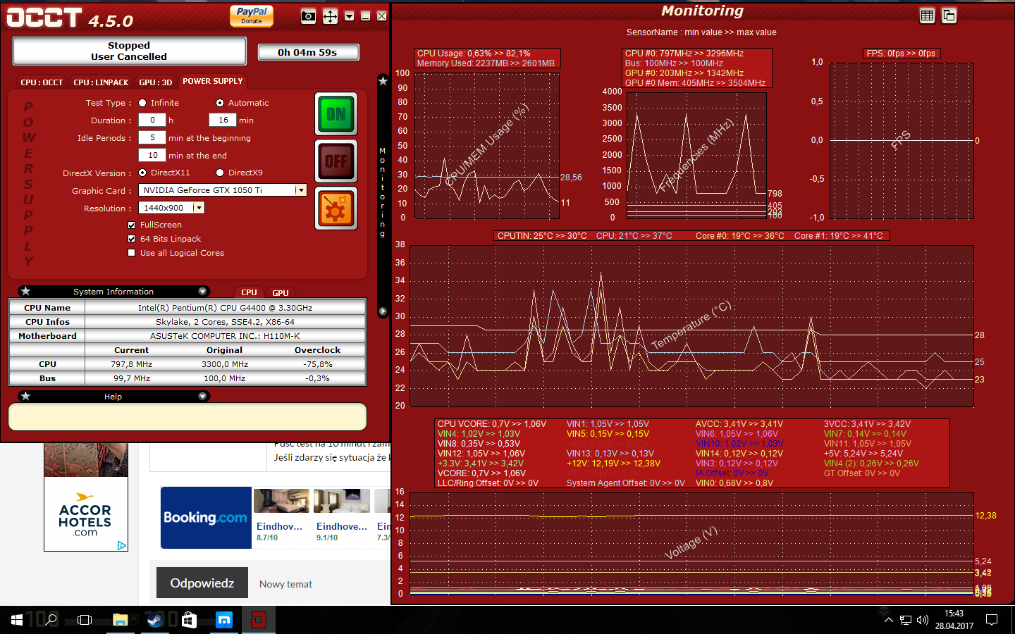

    ciekawywszystkiego wrote:
    And as for that program, I don't know how to turn it on in this mode: /
    Normally.
    You run the HWiNFO program and minimize it.
    You start the game and play. If it is successful, play for 10 minutes, if the game stops, turn off the game, restart HWiNFO and then make screenshots from the "sensors" tab. Post them here.
    RADU23 wrote:
    Measure the voltage with the meter and include the readings (during load) =>
    I can't handle the voltage because I don't have this meter. Maybe I'll try to borrow for days.
    Therefore, you can use the OCCT => program as a last resort
    http://www.ocbase.com/index.php/download
    Run the test for 10 minutes and include the readings from the charts.
    If it happens that the computer freezes / turns off, you can extract logs with readings from the program.

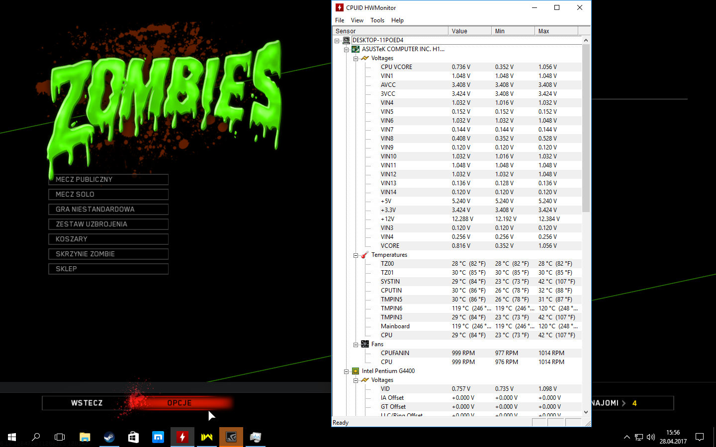

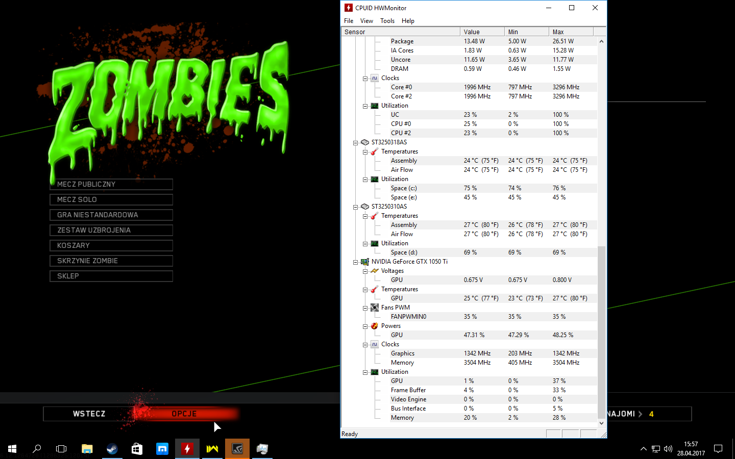

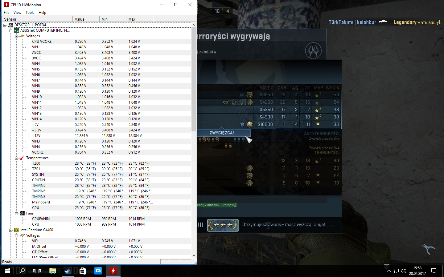

  • #10 16442424
    ciekawywszystkiego
    Posts: 20

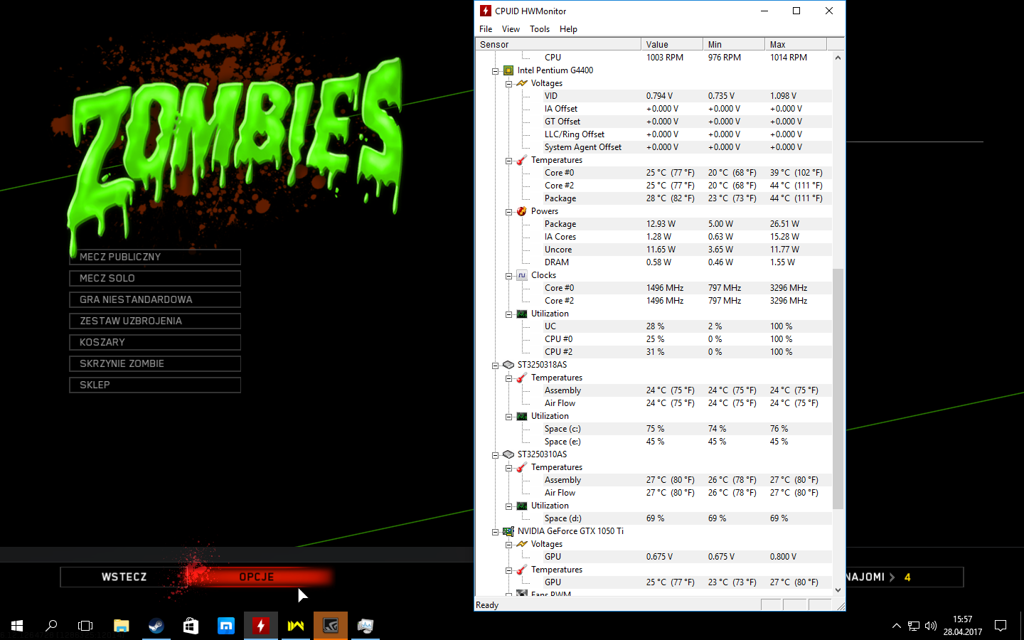

    Hello, first of all I attach a screen from the OCCT program.
    As for this HWiNFO, the game works until it turns on the campaign, mull mode or zombies. As long as I'm in MENU everything is OK, so I can start the program for 3 minutes up.
    Will it not be better if I record a video of what is happening because I have such an opportunity.
    It also adds logs from HWiNFO.
    The program started before the game and when it was started and it was going down.
    Call Of Duty Infinite Warfare - After switching on, a minute passes and the imagscr23.png (302.52 kB)You must be logged in to download this attachment. Call Of Duty Infinite Warfare - After switching on, a minute passes and the imagscr24.png (304.53 kB)You must be logged in to download this attachment. Call Of Duty Infinite Warfare - After switching on, a minute passes and the imagscr25.png (302.58 kB)You must be logged in to download this attachment.
    And here I attach screenshots after switching off the game and program and restarting it (program)
    Call Of Duty Infinite Warfare - After switching on, a minute passes and the imagafterg..png (825.98 kB)You must be logged in to download this attachment. Call Of Duty Infinite Warfare - After switching on, a minute passes and the imagafterg..png (828.86 kB)You must be logged in to download this attachment. Call Of Duty Infinite Warfare - After switching on, a minute passes and the imagafterg..png (827.02 kB)You must be logged in to download this attachment.
    I apologize for how it is written but on average I embrace these programs. Thank you for your commitment !
