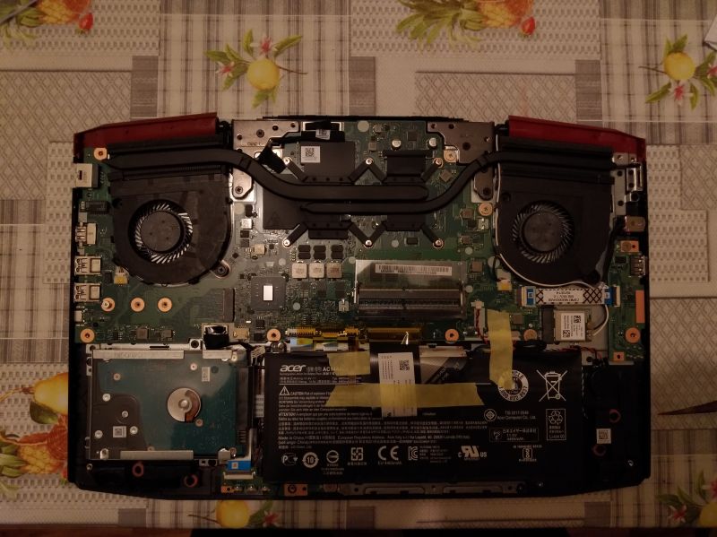

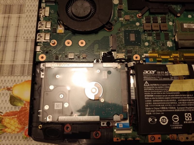

  • #11 16929690
    Sezamkowy96
    Hello everyone, I have a strange question, I have to ask:
    1. Does my laptop support it and whether it is the SSD M.2 disk slot
    2. What interface should I buy for this sata or m.2 or PCIE disk?
    Adding SSD to Acer Aspire VX 15 Laptop: Step-by-Step Guide and Formatting Process
  • #12 16929696
    dt1
    Admin of Computers group
    Posts: 48239
    Help: 7315
    Rate: 8288
    Welcome. Between the left-hand fan and the disc, you have the M.2 socket with the "M" key. SATA drives and NVMe drives can be physically inserted into sockets in this format, so you have to specify in your equipment documentation how they are supported - and buy yourself the right one.
    They do not write much about this in the manual, only the description of BIOS updates for version 1.01 contains information: Resolve Intel PCIE SSD device information abnormal in F12 boot menu, therefore it can be assumed that the VX5-591G laptop should also support NVMe disks, at least from the BIOS version 1.01. In several places on the network you can find information that M.2 SATA disks should also work - but in your place I would contact Acer i She demanded he asked for information about supported disk models (in total, any self-respecting device manufacturer should include this information in the device's specification).

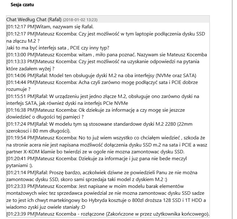

  • #13 16930276
    Sezamkowy96
    I think that this conversation with the supera of acera will help everyone :D
  • #14 16930328
    dt1
    Posts: 48239
    Help: 7315
    Rate: 8288
    So it is confirmed that M.2 SATA and NVMe are supported, it's great that you have uploaded such confirmation from a more official source.
    As for the lack of assembly elements, none other than the screw and the sleeve to which it is screwed in are additionally required. And as you can see the screw for mounting the disk you have, so the assembly will rather not be problems.
