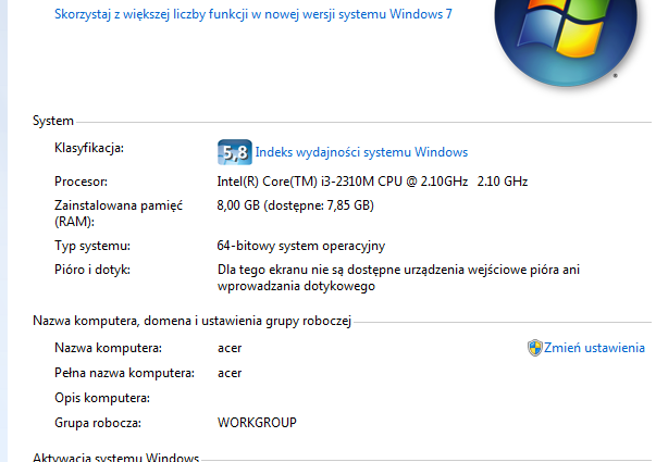

    SSD in place of HDD - Hello. I would like to replace my HDD with SSD.
    Hello and I am asking for advice.
    I will present the matter from the beginning.
    My equipment in the attached photo.
    I want to put an SSD in its place instead of the standard HDD. It will work as a system one. Since I have a lot of cool stuff on the HDD, I want to keep it and have it for use not in a portable USB pocket but in a laptop. I was thinking of an adapter instead of a DVD. Does anyone have such an adapter and it works? I know that this is not the purchasing department, but if someone gave me the link, I would be grateful. Since I live in the UK, I cannot buy in Poland. I cordially greet everyone. Certainly there is someone who will advise you without closing the topic, admonition, entry in the file, etc. I hope that I made a gross spelling mistake. I use an English keyboard and language, so a trick can happen.

    The laptop is the Acer Aspire 5750G. I'm sorry, but it doesn't matter. Pockets should fit all "fat" laptops.
