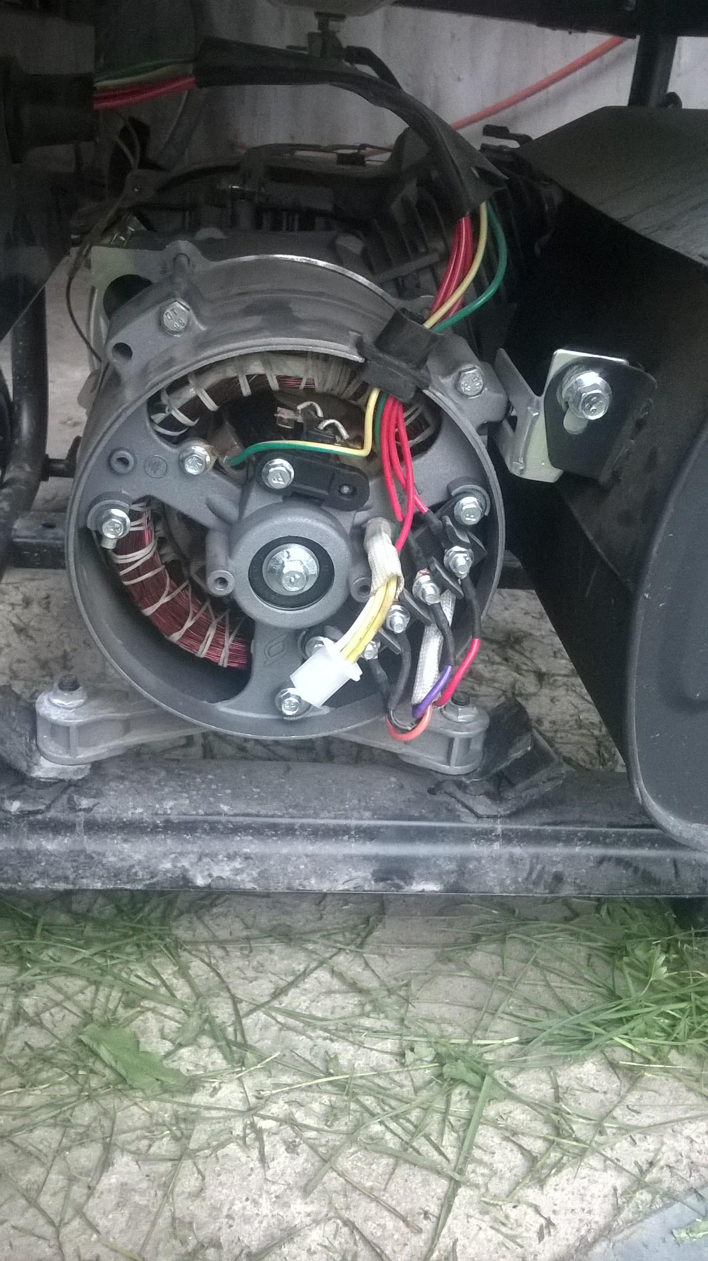

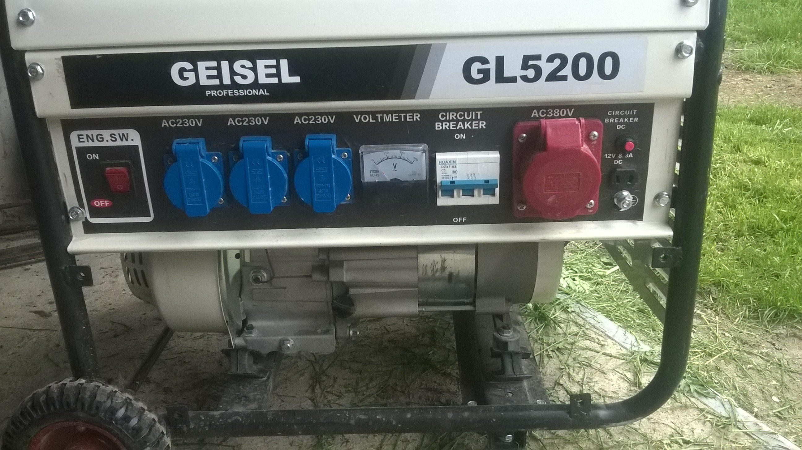

    After below I put some photos of this aggregate.
    As for the questions @ soniak2, the resistance on all 4 outputs (these 4 shafts) is 0 ohm
    New Chinese Power Generator: Voltage Regulator Breaks & Replacement - Causes & Solutions New Chinese Power Generator: Voltage Regulator Breaks & Replacement - Causes & Solutions . New Chinese Power Generator: Voltage Regulator Breaks & Replacement - Causes & Solutions
  • #5 16469719
    soniak2
    Level 21  
    Posts: 600
    Help: 42
    Rate: 139
    0 ohm between each connector on the cube?
    It would be best if you wrote all the combinations on the photo

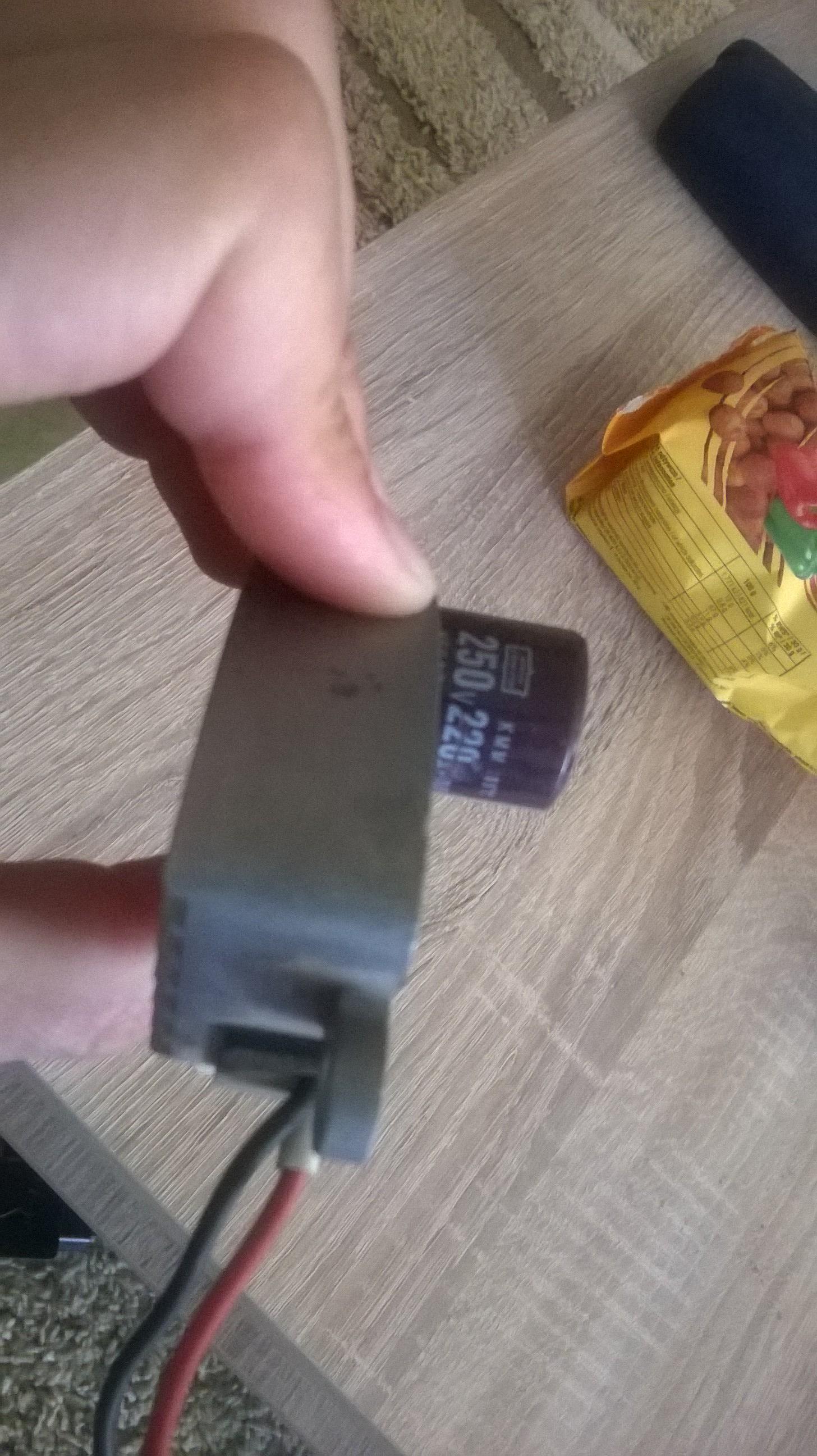

    I'm sorry that I write a post under the post, but the repair of my aggregate is a bit delayed.
    I will add a photo of the voltage regulator. I hope someone will tell me which regulator I should order.
    New Chinese Power Generator: Voltage Regulator Breaks & Replacement - Causes & Solutions New Chinese Power Generator: Voltage Regulator Breaks & Replacement - Causes & Solutions New Chinese Power Generator: Voltage Regulator Breaks & Replacement - Causes & Solutions
  • #10 16530863
    tolo
    Level 35  
    Posts: 3112
    Help: 232
    Rate: 1173
    If it wasn't for this resin, yours could be repaired.
