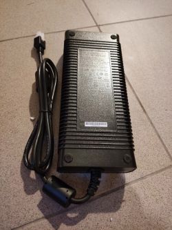

    You give @spec220 some real 250W 12V linear power supply on the hit. Data + photo please. Please show the forum what outstanding constructions I have overlooked in my career. Or please, kindly stop advertising linear power supplies with a transformer as a good solution for power greater than a dozen or so W. Well, unless it's audio-voodoo, but common sense doesn't reach there anyway.
    spec220 wrote:
    CosteC wrote:
    I'm sorry transformer-linear power supply lovers, they're gone, except for a few specific applications.
    Not completely. Here the fact is that the weight and dimensions are large, but believe me, you can build a good linear power supply with quite good efficiency. It is enough to connect transformers with many taps to the binary scale supplying the analog stage, so that it does not have too much voltage margin. Then you will limit the amount of heat loss to a minimum. The fact that such a structure costs a bit, but as someone said "the best doesn't come out of nowhere" :wink:
    Design me a power supply with rope stabilization 5 V 20 A (a mediocre 100 W) so that it works only in the range of 230 V 10% as required by the law and is not destroyed in the range of 230 +/- 15%, also in accordance with the requirements. Efficiency better than 70% under full load - that is grief and sadness in the world of converters. You won't go below 2 kg anyway, despite the fact that such a technical miracle will generate too many harmonics.
