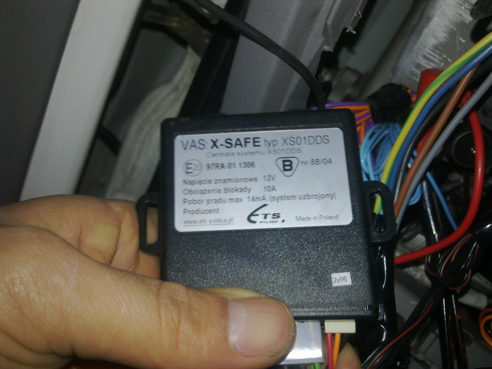

    Hello, I have a problem with the remote control, you can order a new x-safe 01 dds alarm in ETS Polska for PLN 72. You need to write down the numbers from the control panel, they will send instructions for installing the remote control. I have a question how to get to the control panel.

    Disassemble the "plastics" inside the car and look for the switchboard as shown in the photo.
    Each installer mounts the control panel in a different way and in a different place.
    To program anything in this control unit, you need a dedicated programmer.

    Thank you for the hint. the vehicle is a yaris 2006 alarm installed in the service. I called ETS Poland and I will send instructions with the remote control on how to enter the data from the control unit. I can not get to the control unit. How can this alarm be deactivated /

    Below is an excerpt from the instruction manual:
    Emergency disarming of the alarm
    Description of abbreviations: PA - P. button AND authorization
    Emergency mode allows you to disarm the alarm without a remote control.
    Emergency disarming is secured with an individual PIN CODE of the owner. PIN CODE
    consists of four digits. The value of each of them ranges from 1 to 9 and is equal to the number of times pressed PA . Emergency disarming of the system consists in entering the 4 digits of PIN CODE.
    FACTORY PIN CODE: 2,2,2,2
