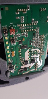

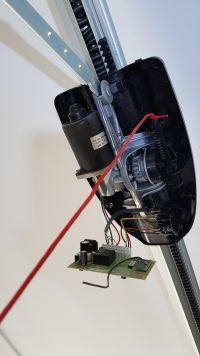

    Marek J you were right, again the drive goes crazy and despite the adjustment with the red potentiometer it does not open every time to the end but only becomes like in the film and photos. How do you adjust the springs?

  • #9 16638467
    RomanoMorawiano
    Posts: 120
    Rate: 32
    Set in half, there is no tendency to fall, lifting, so probably the tension of the springs is ok. I lubricated the springs and rollers again and now works again.
