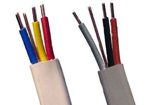

    Hello and welcome. I made the mistake of ordering a 4x1.5 flat cable recently. I needed a classic, for stair and cross switches .. Everything would be ok if I checked the colors before assembly (5 houses), and the opposite happened. So far I've ALWAYS used 5x1.5. I don't know what tempted me to 4x1.5. And the point is, of course, that in this wire there is yellow-green, brown, black and gray. Of course, I won't list them now, because it's a lot of wires. I plan to use gray as a neutral and mark it in blue with some T-shirt in all switches and lamp overhangs. Is this a terrible sin in your opinion? Finally, I also connect the whole thing, so it's not about me .. I mean the situation in the future, if another electrician will modify something, etc.. Tomasz.

    Such wires are often used for lighting.

    Thanks for the answers. I have never used 4x1.5 before and therefore I did not think that such a cable without N could happen to me. So this unfortunate gray can be used interchangeably, right? Are there any rules as to which of these "phases" to use as N?

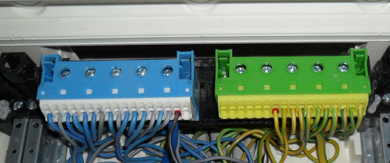

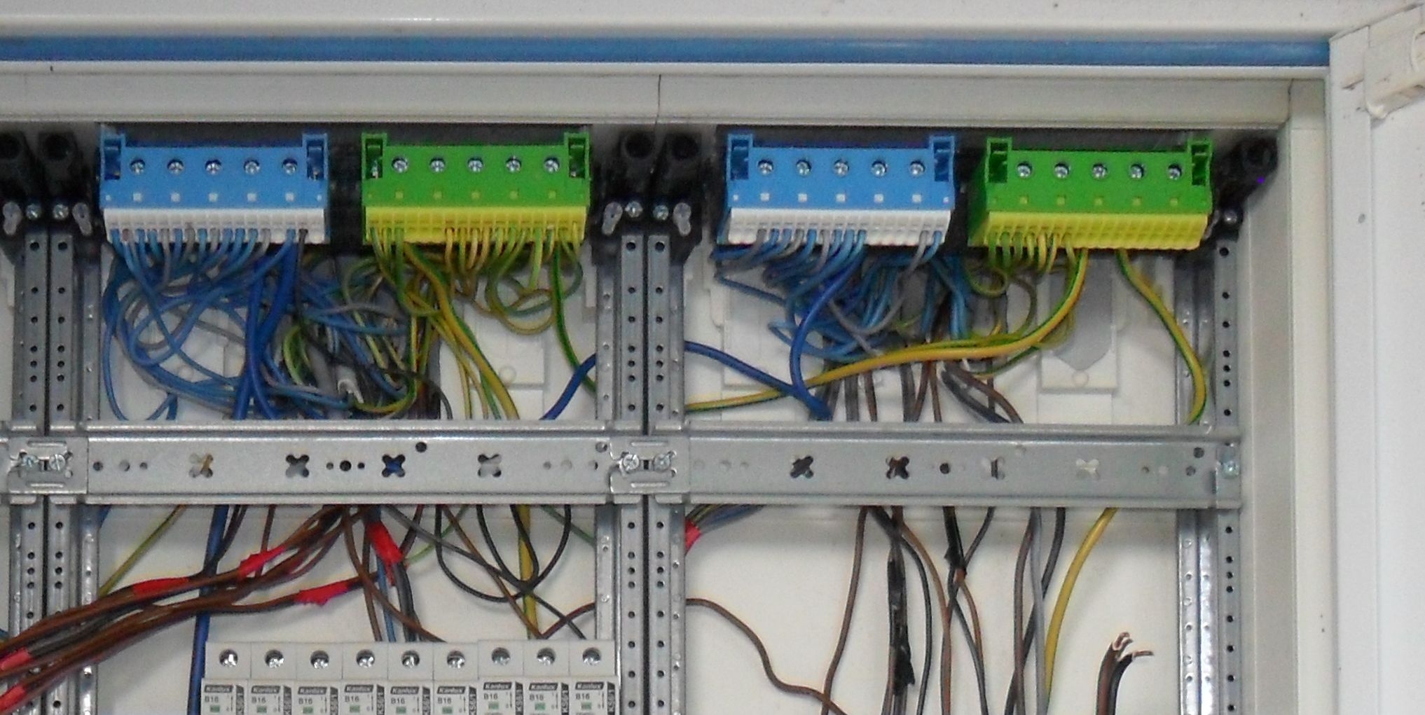

    I found a photo taken during the connection of cables in the switchgear and this is where the gray wire is also used as a neutral. It was done by two licensed electricians and I was just watching.

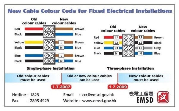

    markus-19 wrote:
    Marking most often took place during the renovation of facilities (as-found condition) where the wires were different red and black, only black, red, blue and yellow. Especially the latter could be dangerous.
    Why could the yellow wire be dangerous?
    Maybe because it is the color of the L2 phase wire?
    Or maybe at least you know what function the black wire played in these installations?

    markus-19 wrote:
    I would agree if one was made the same, and if the color used is used once for power and once for protection, it's bungling and that's it!
    Until 2002, in Great Britain, permanent installations (those arranged permanently) used red, yellow and blue as the phase colors, and black as the neutral.
    The yellow wire has NEVER been used as a protective one, the yellow-green color has always been reserved for such a wire!!!
    At the same time, there was another standard for flexible/flexible wires, i.e. connection wires, the same as currently commonly used, i.e. brown, black and gray as phase wires, and the neutral wire in blue.
    Therefore, for a Polish electrician, such a mix of colors can cause confusion: once for protection, once for power.
    Well, unless the wire from the Vistula River has already stuck its hands there :cry:
