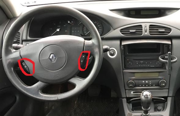

    Hello!!!
    I am asking for help, I have a Renault Laguna II 1.9dci 120HP 2002 car
    Cruise control is installed in the car, all the cubes under the steering wheel as well as from turning on the cruise control are correctly attached. After pressing the button, the green cruise control lamp lights up and nothing else happens, I tried to press the buttons on the steering wheel + - and RO but it gives nothing the cruise control does not turn on at all, so I ask for help, maybe I am doing something wrong, I will add that when I press the switch Cruise control the other way, the orange lamp lights up but nothing happens.
    Thank you and I look forward to your reply
    greetings
    krzychug3

    Did you do it at a standstill or when?

    While driving, I turned on the cruise control and nothing happened, I tried with all the buttons but did not respond at all, I will add that I tried at different speeds from 50 to 120 km / h and nothing

    That's why I asked are different cruise control and different methods of switching. You need to do diagnostics, maybe something will come out.

    Fits the cushion, remove and see if the tape is just from the cruise control option and what is going on there.

    so is the cube from the cruise control I know because I used to undress it once because I changed the wiper switch.
    I forgot to write earlier but the pillow and Service indicator lights up because there is something wrong with the retractor, can it affect the cruise control somehow ?????

    This is the same thing. The air Bag tape is responsible for the pillow and cruise control buttons. The most important thing and you haven't written before .... Connect the computer only computer and not some inventions and come out what and how is wrong.

    thanks, I did not know that it is connected together, I was connected and the guest told me that there is a tape or a retractor for replacement I do not remember exactly.
    thanks again for your help
    please tell me what is the difference between the version with cruise control and without because I was looking for a retractor on the Allegro but all look identical only on one description I write that with cruise control and on the other that without

    The number of wires inside.
    No cruise control has less than cruise control.
    The tape and retractor are one and the same.
    You have cables from the cushion and horn in the tape, in the version with cruise control there are also cables from the cruise control buttons.

    thank you all for your help, the damaged airbag is to blame
