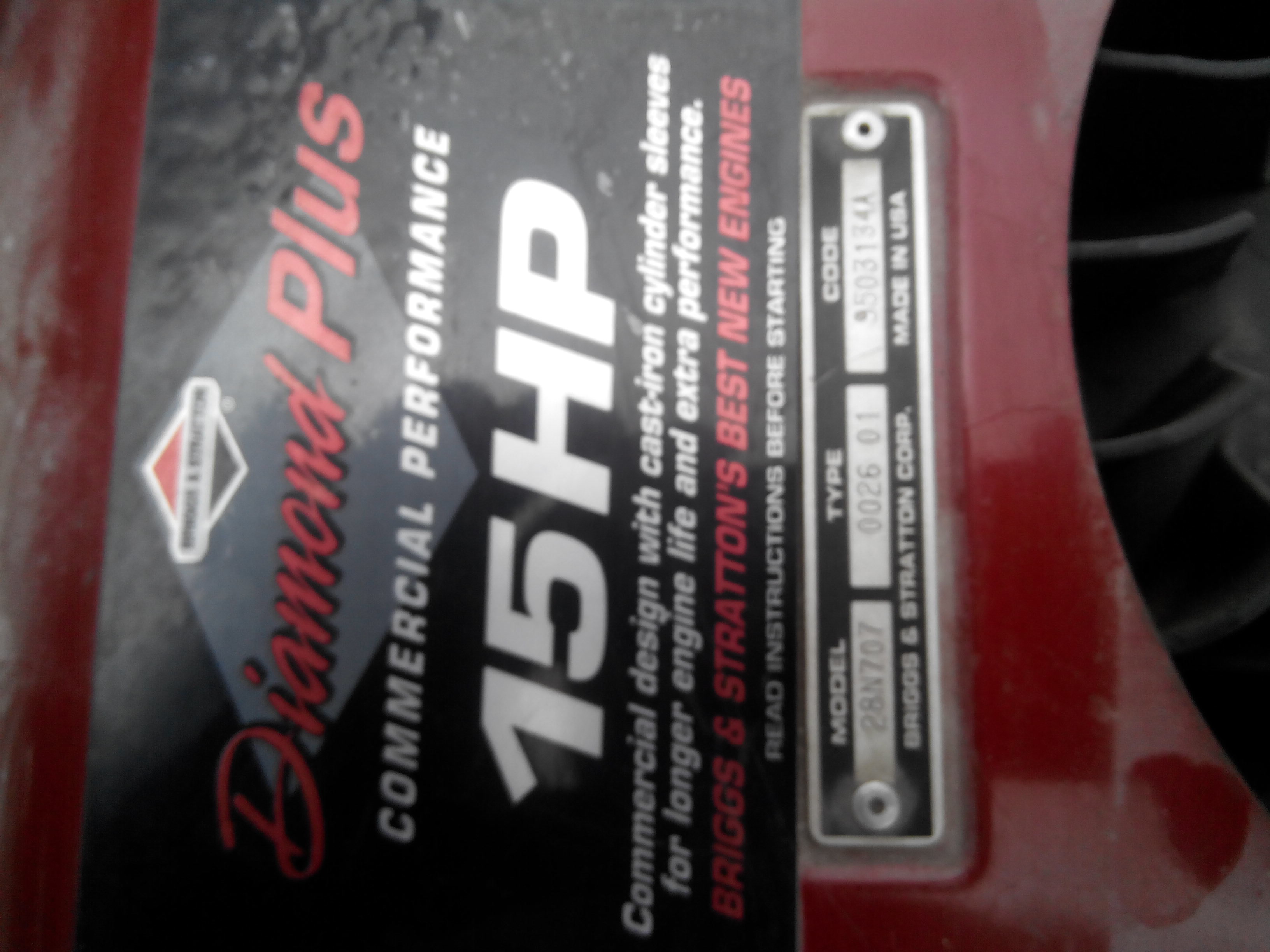

    Hello, I have a problem with the 15 HP lawn mower Bringss engine, namely where the oil is to be full of fuel. I unscrewed the candles, a lot of fuel spilled out, unscrewed the valve cover also a lot of fuel spilled out, what could it be? Please help.
    greetings

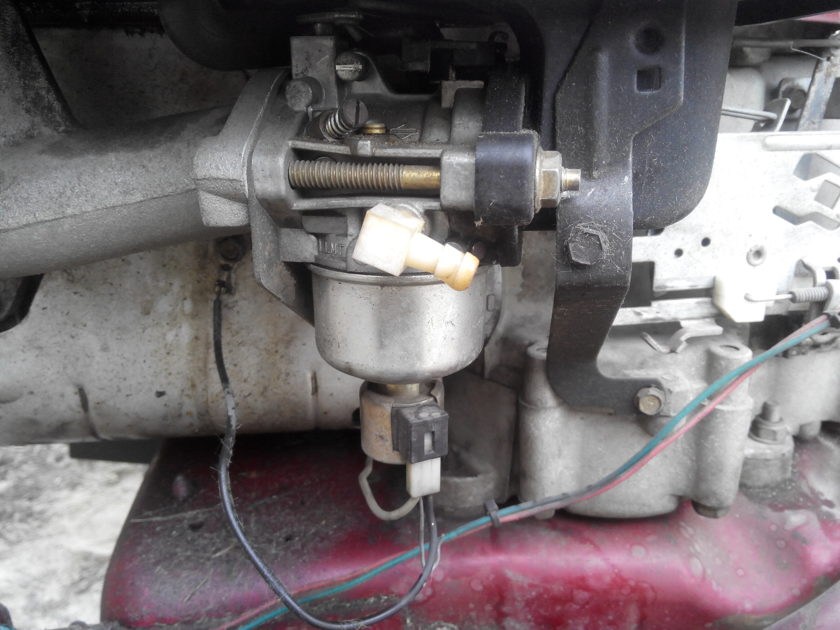

    Is it a solenoid valve under the carburetor? And can it be the reason? How to check if it works properly?
    greetings
    #7 16474461
    21paweł21
    Posts: 131
    Help: 14
    Rate: 37
    You can check this solenoid valve (here you have something about it https://www.elektroda.pl/rtvforum/topic2901296.html) it "closes" the fuel to the main nozzle so if it is not closed and a suspended needle valve or leaky float fuel can go ahead go through the suction valve to the engine.

    Thank you for your help with this carburetor. It turned out that this solenoid valve hung and did not close. I started it and connected it for a short time, it worked properly. I was able to fire it, walked well, maybe it will be OK.

    I would advise you to check the float and the needle valve as well as the fuel level in the float chamber because the malfunction of the solenoid valve should not manifest itself in this way.

    I watched the float, by the eye it was ok, not leaky etc. I just don't know how to check this fuel level in this chamber. And this needle valve you know buddy where it can be? I have only doubts about the screw that is adjustable the distance from the needle of this solenoid, someone was regulating it and has slightly bit it and may it not close there? What do you think?

    The valve is next to the float hinge in the carburetor body. If the float is made of copper, it has a "tongue" and if there is a plastic float, it doesn't regulate the level there.
