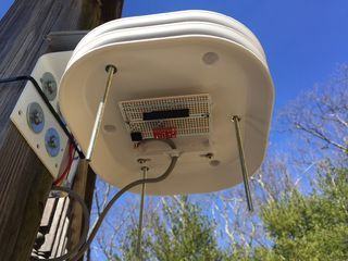

    Then mount the universal plate and BME280 sensor on the Davis Instruments Solar Radiation Shield module. Photovoltaic panels should be mounted on the top side of this module, as shown in the pictures above,
    The author of the project tested various combinations of pressure, temperature and humidity sensors, BME280 proved to be the most reliable and gave measurements consistent with weather data for a given place. This sensor has an integrated thermometer, hygrometer and barometer. The system tests lasted several months, including winter. All this time BME280 did not cause any problems.

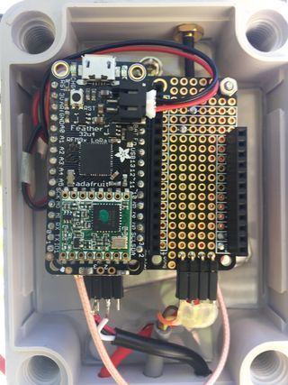

    Installation of the radio transceiver and prototype board
    The uFL socket for the antenna is soldered to the 32u4 RFM95 module https://learn.adafruit.com/adafruit-feather-32u4-radio-with-lora-radio-module/antenna-options" target="_blank" rel="nofollow noopener ugc" class="postlink inline" title="" > according to the instructions .
    The female sockets that are delivered with the FeatherWing Doubler prototype board are assembled on one half of the board, as shown in the picture above. The other half will remain unused. Then solder the connectors on the board,as shown in the picture, to connect the power supply (3.3 V and GND) and I2C signals - SDA and SCL - to the socket for the BME280 module.
    Next, solder on the prototype board another connector, dedicated for DS18B20. Connect the power supply (3.3 V and GND) and the output from digital pin number 5 (this will be our 1-Wire interface) to the connector for this sensor. Pass the sensor cable through the previously prepared hole in the housing and solder the connector to it, which we plug into the socket prepared on the prototype board.
    Finally, we can gently plug the adapter into the antenna socket, the other side of which is screwed into the housing to be able to attach the external antenna.
    The assembly of this module is completed by plugging the prototype board into the Sunny Buddy module and assembling it necessarily using spacers, so that the components of both modules do not touch each other.
    Now we can upload the software to the board. Once done, we can connect the Feather module to the prototype board. Do not connect the cable with JST connector from the "Load" output of the Sunny Buddy module at this stage. Later we will connect this cable to the port where the battery is normally connected to the Feather module.
    After assembly, seal the cable openings in the housing with silicone. Thanks to this, the housing will be tight.
    Shield Solar Radiation
    Let's follow http://www.davisnet.com/product_documents/weather/manuals/07395-093_IM_07714.pdf" target="_blank" rel="nofollow noopener ugc" class="postlink inline" title="" > assembly instructions for this module . Then install this module as shown in the photo above. On https://learn.adafruit.com/adafruit-bme280-hu...pressure-temperature-sensor-breakout/assembly" target="_blank" rel="nofollow noopener ugc" class="postlink inline" title="" > Adafruit website we will find instructions for connecting this module with BME280. Then solder the protector to the prototype board.
    Using the pictures shown above, combine together both modules using a prototype board. Using the cable pieces, connect the outputs from BME280 (VIN, GND, SCK and SDI) to the socket on the prototype board that we just soldered. Then we attach the pins from the FeatherWing Doubler module to it as follows:
    3.3 V - VIN
    GND - GND
    SDA - SDI
    SCL - SCK
    The mounting holes on the Adafruit prototype board have the same spacing as the shield dedicated to monitoring sunlight. Thanks to this, it is possible to easily connect everything with a few screws.
    In the picture above one more row of female pins is visible. They were used during initial experiments with the system, aimed at selecting the best sensor - they are not needed for normal operation of the system.
    Then we cut a piece of plexiglass, as shown in the photo - the cut fragment should be the width of the solar panel, but long enough for it to be screwed together with the panel to the appropriate shield. After installing the module prepared in this way, it will be slightly inclined, thanks to which it will be better to collect sunlight during the day.
    In the plexiglass, we drill holes for mounting the photovoltaic panel and a dedicated shield for it, and we turn everything together, as in the photo above.
