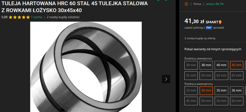

    In case the unit has to work hard, you can possibly remove the bearings from the housings and insert 30x45 bushings there as pan.
    If you don't have time to do the work, you can buy some ready-made ones e.g:
    Steel bearing sleeve with grooves, size 30x45x40 mm. .
    These linear bearing housings can be cut along the axle and the clearance can be adjusted.
    Alternatively, you could replace these linear bearings with four SK 30 or SK 35 linear shaft supports plus some 30x35 pan.

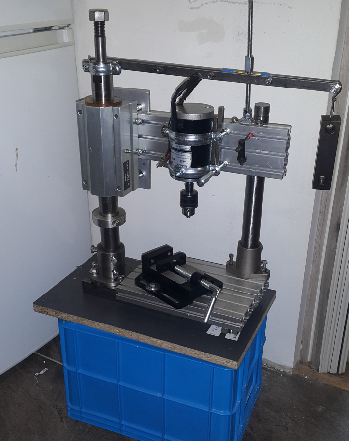

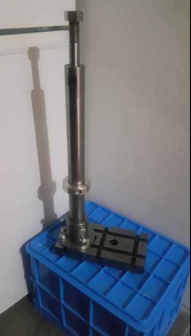

    I preferred to choose gravity over magnetism when building my Koromyslo.
    Metal structure mounted on a plastic crate. .
    I have two heavy steel blocks with which I can press the Koromyslo against the ground.
    This allows me to drill and thread also in non-magnetic sheet metal of unlimited dimensions.
    My design is a cross between a drill and a drill press and is just plain ugly.
    Here in the layout for fine work.
    Homemade drilling and tapping machine mounted on a blue crate. .
    But I can always rotate the arm and drill into the 'ground'.
    I also didn't use a screwdriver because I like to listen to music.
    I can only hear the rustling of the shavings as I work, but I had to buy respectable motors and spindle holders.

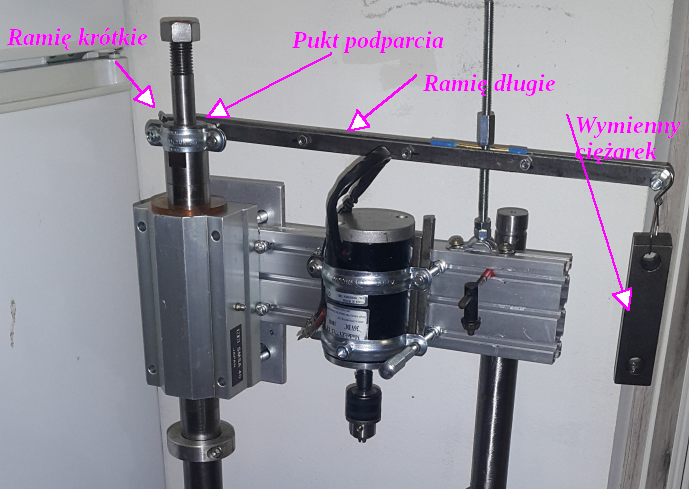

    I see a similarity here - the counterweight I used to fully control the pressure of the drill.
    You can't see it in the photo, but there is a double-sided lever (double-armed), the weight of the linear bearing, crossbeam and spindle is transferred to the main column.
    This works similarly to a coromyser, but mine is unequal-armed.
    A woman in a headscarf and apron carries two metal buckets outside. .
    Counterweight mechanism with a drill and technical annotations. .
    If I hadn't balanced the masses of these components I wouldn't have been able to use thin drills.
    I would also have a problem with threading.
    Balanced is also less perverse.
