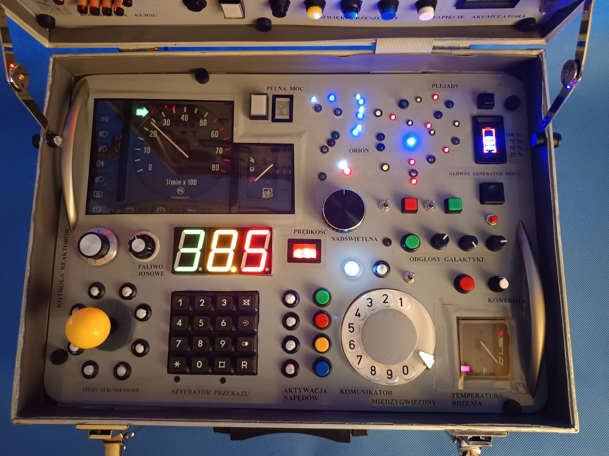

    More than a decade ago on "Elektroda" I saw a cool toy project for a child:
    https://www.elektroda.pl/rtvforum/topic2515884.html
    I thought it was a pity that my children are already too big for such a toy.
    But time flies fast and in the meantime my grandson turned two.
    And I was reminded of that project.
    Most of the reasons for building and construction ideas
    are almost clones of the ideas of colleague reaven22 .
    I just used slightly different components for the build.

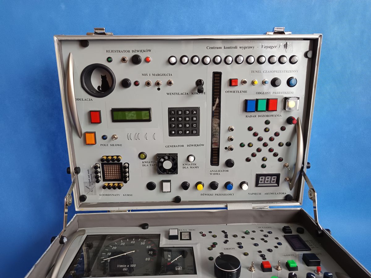

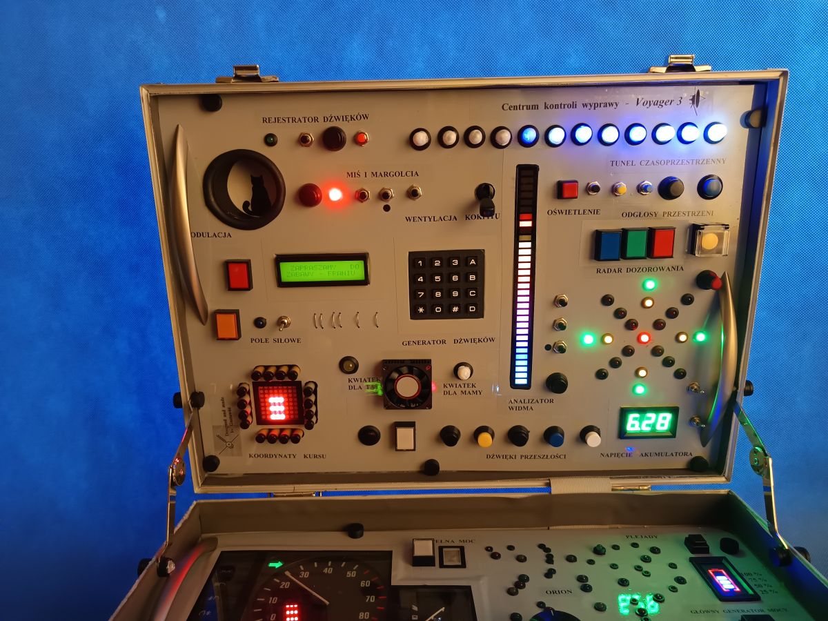

    The project got the name: "Voyager expedition control centre 3"
    and is generally in the spirit of an interstellar expedition,
    although for now it will be used for snapping, twirling, flashing,
    playing and making noise, but in time (as the child grows)
    perhaps it will become some small source of inspiration....

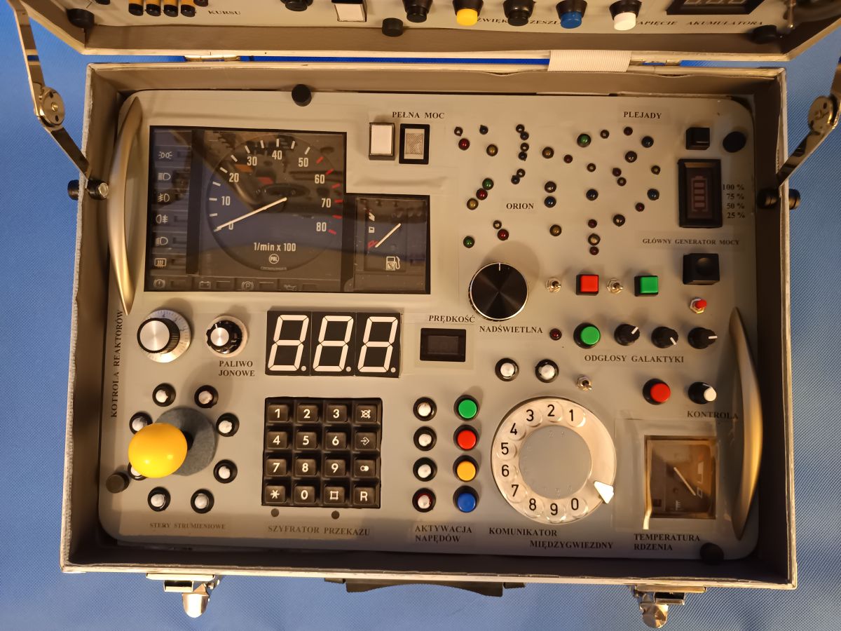

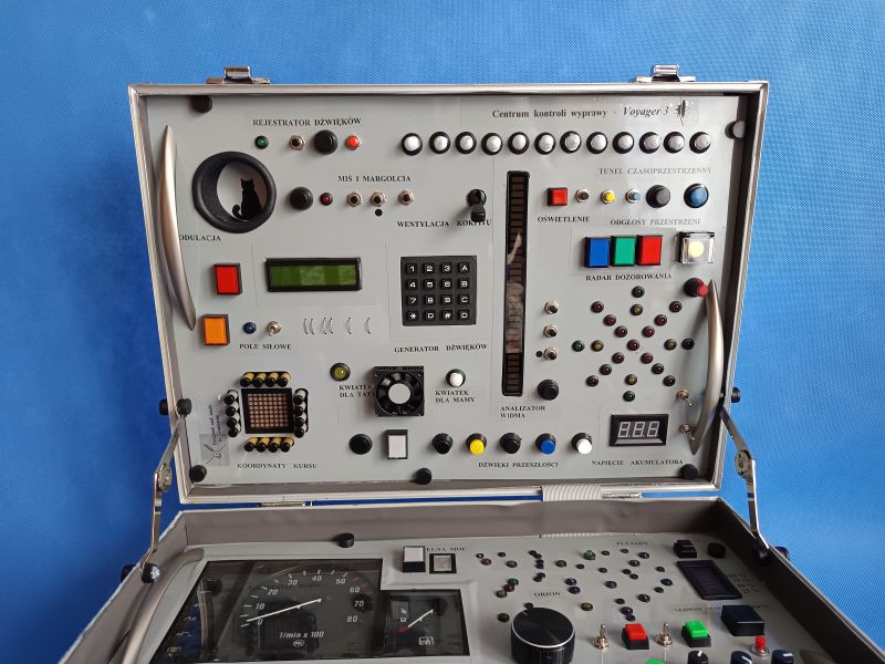

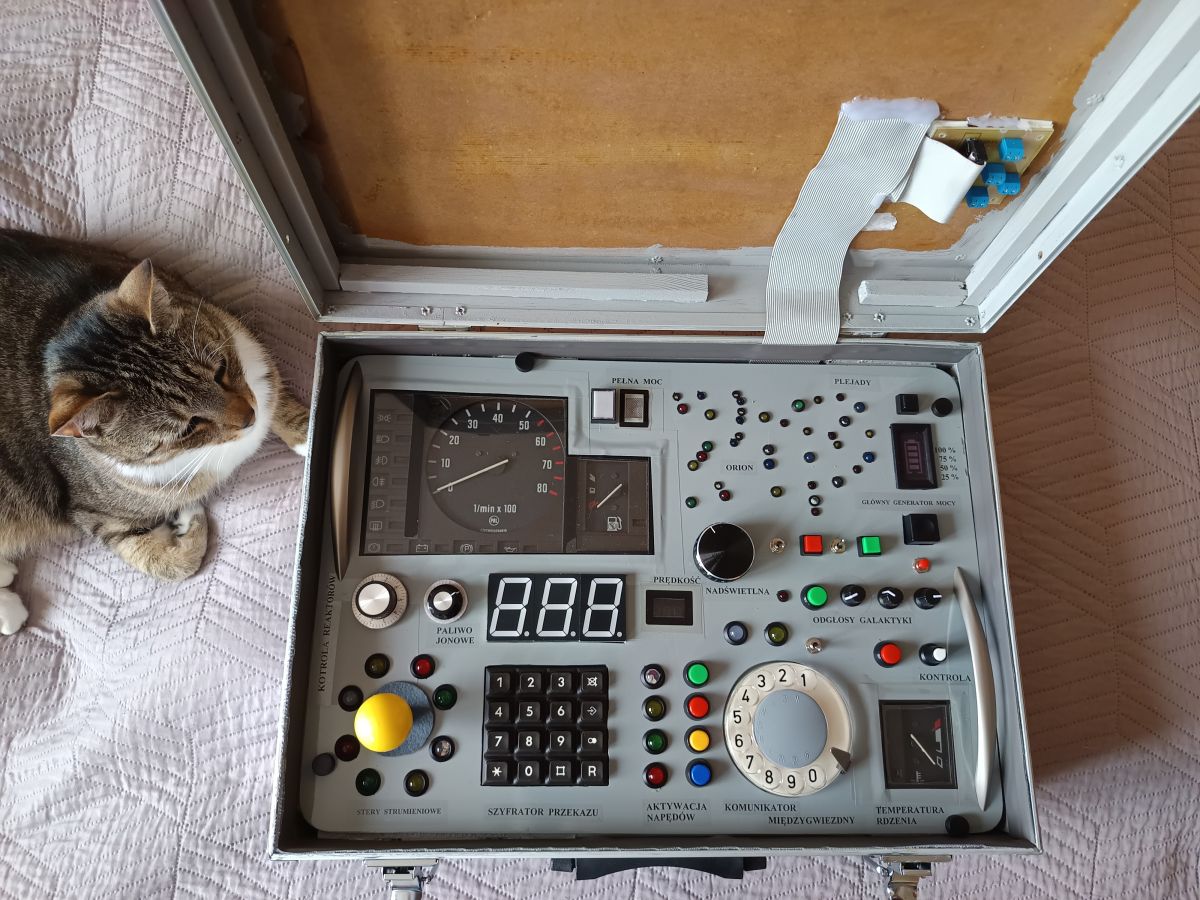

    Elements used .
    Bottom of case:
    Main power generator - 6V battery from UPS, its charge indicator,
    main isostat to switch on and timer to de-energise after about 650 s.
    Reactor control, ion fuel, core temperature, superluminal speed
    - are clock elements from the Skoda Favorit.
    Thruster controls - an eight-position joystick.

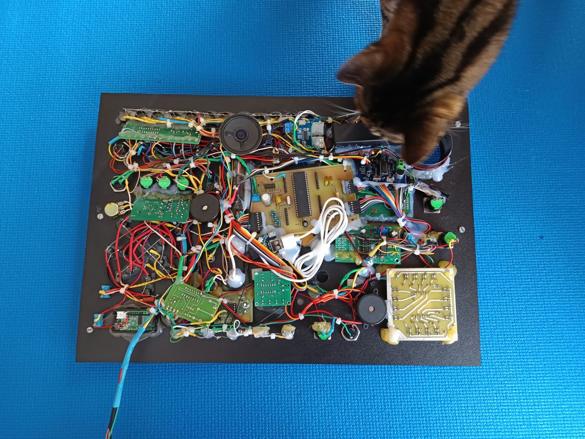

    Message cipher - a keypad from an old phone that operates via a microcontroller
    3 seven segment displays in different colours.
    Interstellar communicator - this time it's a rotating telephone dial and connected LEDs.
    Galaxy sounds - in this role an AVT 3295 kit strange sound generator.
    Orion - AVT 795 running light.
    Pleiades - AVT 729 crazy spinning light.
    Full power, drive activation - coloured LEDs and button-activated buzzers.
    On top of the case: .
    Sound recorder - digital recorder module with ISD 1820 chip.
    Teddy bear and margolcia - song player module (mp3 from micro SD card).
    Space-time tunnel - AVT 3186 Knight Rider.
    Space noises - AVT 789 siren.
    Surveillance radar - AVT 1653 LED star.
    Spectrum analyser - off-the-shelf Chinese module that responds to music and sounds.
    Battery voltage - led battery voltage indicator.
    Sounds of the past - J068N music box bell.
    Flowers for Mum and Dad - AVT 749 random RGB LEDs.
    Sound generator - 4x4 keyboard with 16x2 display and microcontroller
    generating Morse code and music with Bascom SOUND instruction.
    Force field - AVT 740 touchscreen siren generator.
    Course co-ordinates - 8x8 matrix, LED combination manually lit by individual buttons.
    Cockpit ventilation - computer fan activated by a lever from an Old 266.
    Also various buzzers, lights and chimes lit by various buttons.

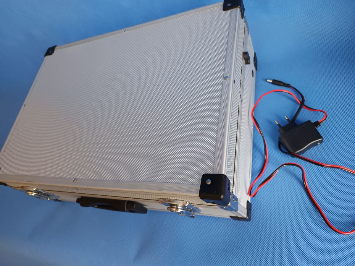

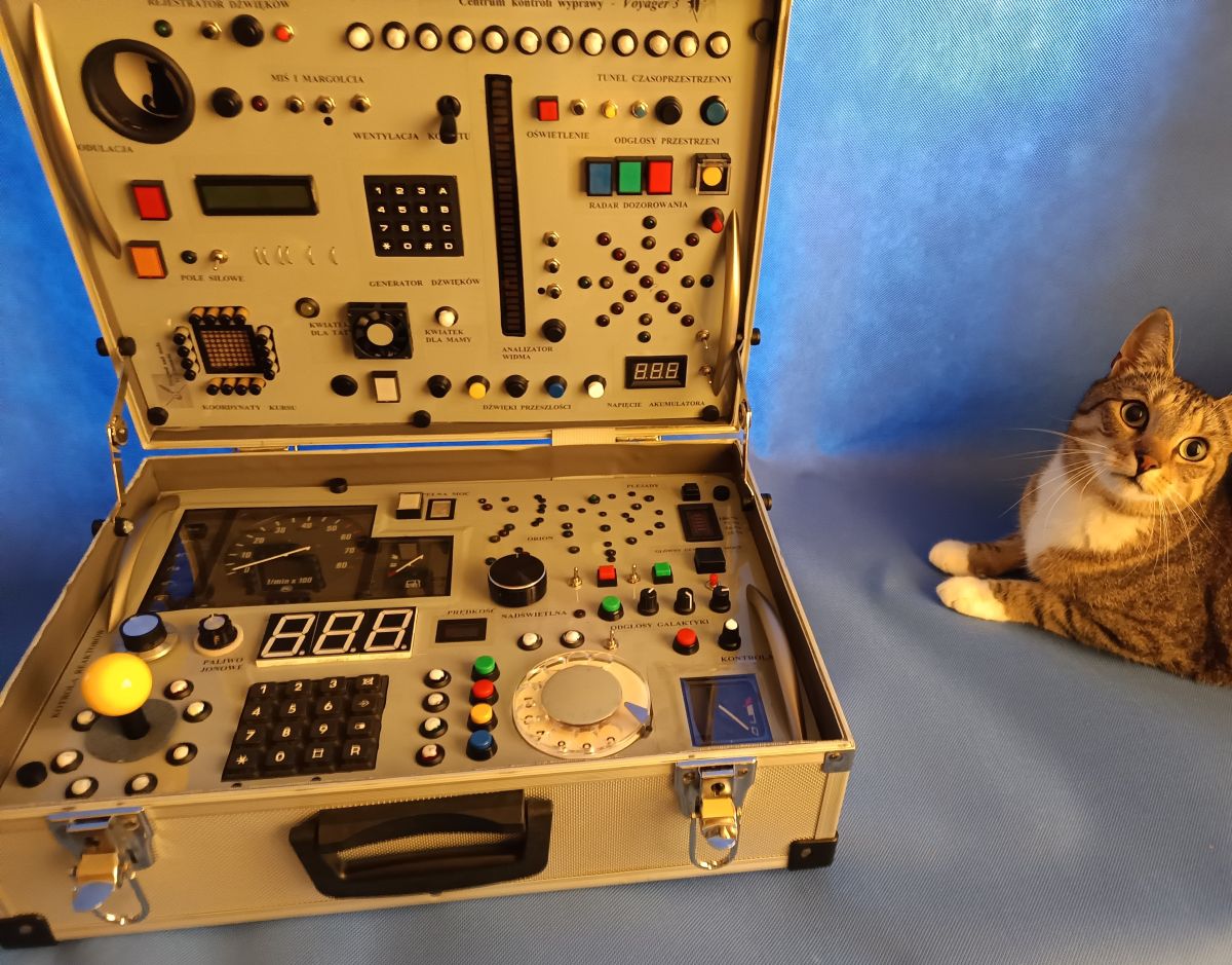

    The whole thing was supposed to fit into a Zepter cutlery case, but it did not.
    The only thing I used from this case was the hinges that prevented the top cover from falling onto the child's hands.
    And I fitted all the components into a larger 'kejsika' purchased from a well-known portal.

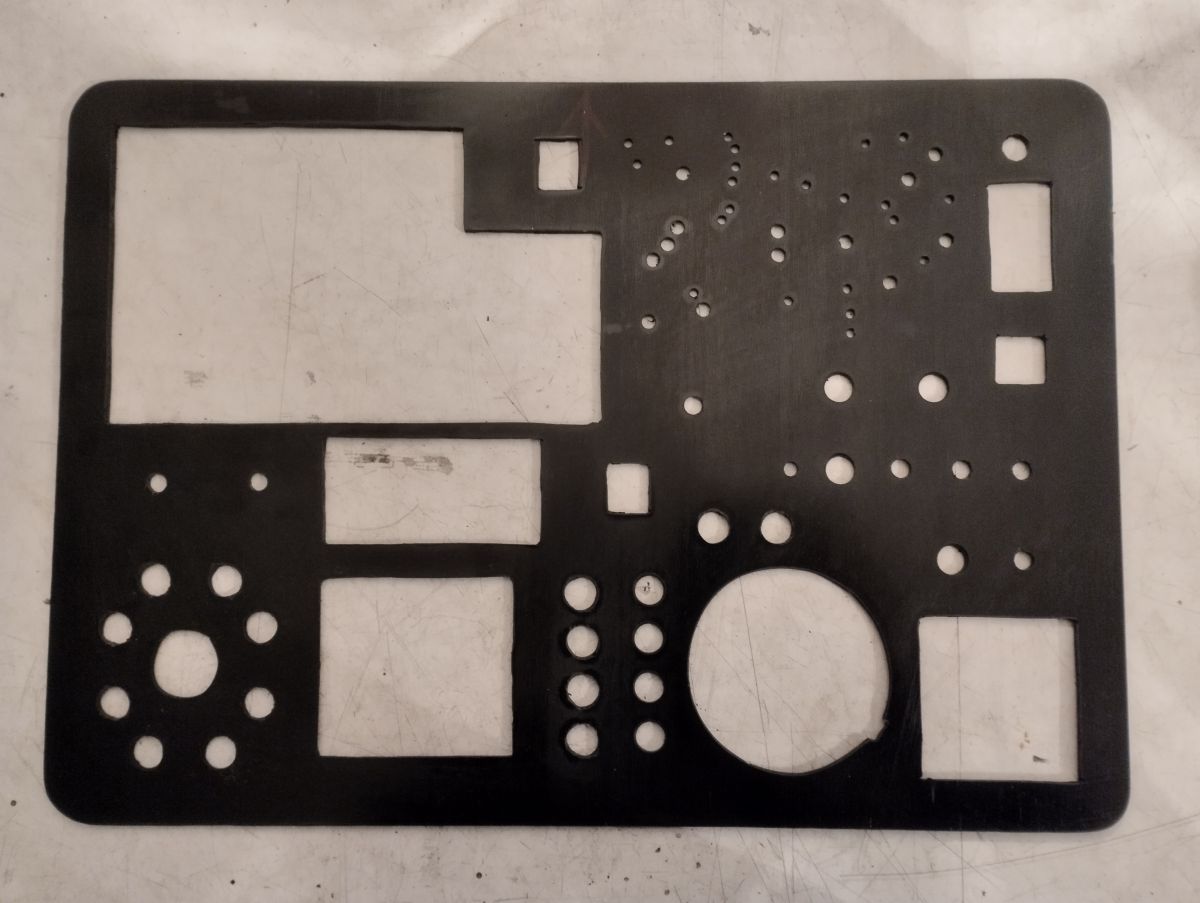

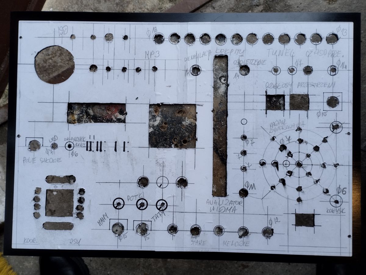

    I placed all the components on 4mm thick ABS plates.
    Painted in a lighter colour, as the black was a bit too gloomy.
    "A kilo" of trivets and "a kilo and a half" of glue also came in handy.

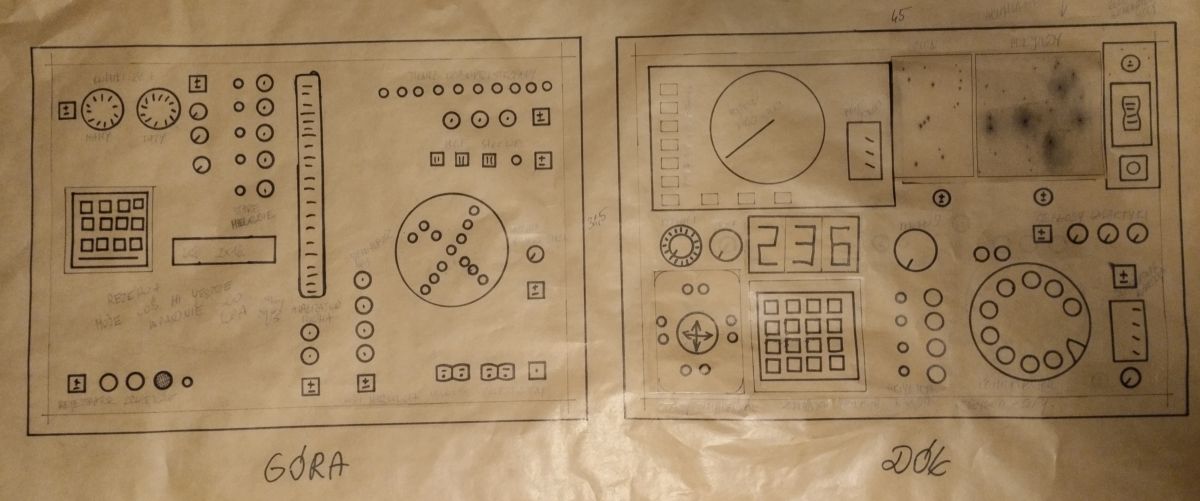

    From paper design to realisation took a while,
    the project itself also changed in the course of implementation, but in the end, on Children's Day, the "box"
    Sketch of two control panels for a toy control center, featuring various buttons, indicators, displays, and dials arranged on two rectangular boards labeled GÓRA (top) and DÓŁ (bottom).
    A black mounting plate with various cut-out holes and rectangular slots, prepared for installing electronic components. .
    Control panel for a toy, with cut-out holes and handwritten labels for various electronic elements. .
    An electronics panel with numerous wires, PCBs, and components; a cat's head is visible in the upper right corner. .
    A suitcase with a homemade electronic control panel inspired by a space station toy, standing on a bed, with a cat lying next to it. .
    Handmade educational toy: a control panel with many buttons, LEDs, displays, and indicators, mounted in a suitcase. .
    Control panel of the Voyager 3 Expedition Control Center toy in a suitcase, featuring various buttons, indicators, a joystick, rotary dial, and displays. .
    Closed silver aluminum case with black corners, next to it a power adapter with wires on a blue background. .
    Control panel of a space-themed toy console with many buttons, LEDs, and electronic displays. .
    A control panel of a toy Voyager 3 expedition control center with many buttons, indicators, and LED lights, installed in a suitcase. .
    Suitcase Voyager 3 Expedition Control Center with a panel full of buttons, switches, indicators and LEDs. .
    A suitcase with a complex child’s control panel toy styled as a mission command center, with a cat sitting next to it. .

    Well you've dug in, because now I'm going to ask you the very hard questions and ask you to spend even more time :P .
    - Do you have instructions for this on how to put it together?
    - Can you normally buy the components from a shop or somewhere and which ones?
    - I can DIY, drill, solder I have some tools. Will I be able to do this, without strictly electronic knowledge?
    - How long did it take you? (more or less)
    - Can you upload a youtube video of it working?
    Or if you don't want to, give me an address where I can come at night in a chimney sweep :)
  • #3 21573730
    JulianChrupek
    Posts: 11
    Rate: 73
    gadek80 .
    The instructions and diagram are not available.
    You can buy all components on a well-known auction site.
    You have all the components listed and you can buy them as you wish.
    I think you can easily put something like this together.
    All you need to do is choose the right supply voltages for the individual modules.
    I additionally etched some boards. The power supply converting the battery voltage to the voltages I needed (+3V, +5V, +12V) and the microcontroller boards.
    It took me about six months, a few evenings a week, because time is always fragile.
    The video I don't have, because I only use YT passively :) .
    But I can always give you more details on priv.

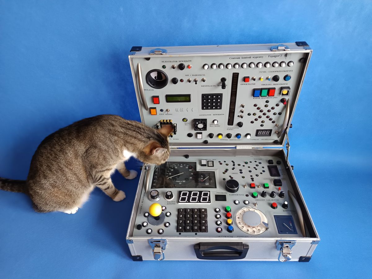

    This is of most interest to the cat...
  • #5 21573860
    JulianChrupek
    Posts: 11
    Rate: 73
    Yes, he was the chief consulting engineer.
    No stage of construction was without his vibrissae :) .

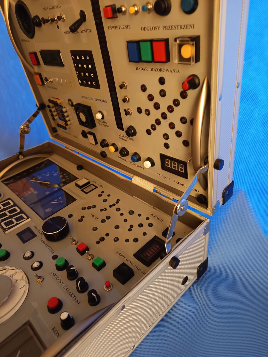

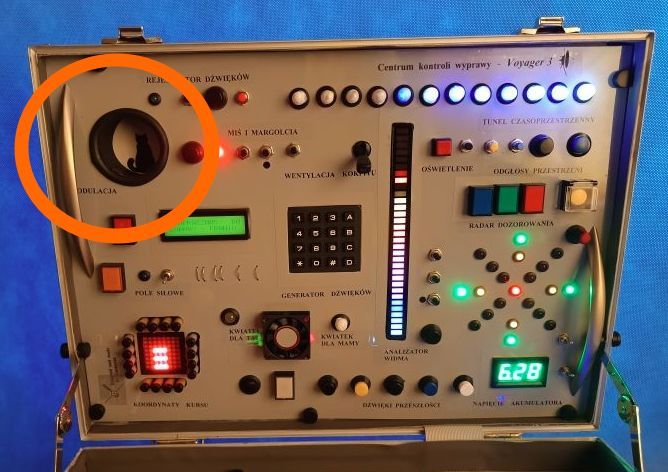

    Please tell us what this is and how it works?
    Control panel with numerous buttons, knobs, displays, and lights in a suitcase; large knob labeled “DOLACJA” in the top left, highlighted with an orange circle. .
  • #11 21574251
    JulianChrupek
    Posts: 11
    Rate: 73
    And this is a very important element :) .
    And seriously, this is the hole required to close the case,
    in which the joystick knob is concealed.
    It is enclosed by a metal mesh masking from the speakers,
    so that small fingers cannot be inserted there.
    By the way, sounds can be heard through the openings in the mesh.
    from the speakers and buzzers. And also the sounds reach
    to the microphones of the recorder and spectrum analyser.
    When the light button is pressed - the cat's silhouette is additionally illuminated :D .

    JulianChrupek wrote:
    398216 Removed (DjMatyAs) it is always a pleasure to read your posts (and with even more pleasure to look at the projects) because one can learn a lot from them, but in the case of this case the hole was created just to fit the manipulator head in there. The sound flows are by the way.
    Two issues.
    The first is the comparison of myself to djMatyas - I have no intention of explaining myself once again, although I was pleasantly flattered by the comparison to such an eminent figure (I came to the forum in part thanks to him).
    The second issue is already (fortunately, because I would not like to litter the topic) more technical;
    Nowhere did I write that the hole as it is was created to radiate sound, I wrote that since it is already there it can ALSO be used as part of an enclosure/acoustic enclosure. And (if that's what you meant) I didn't mean to suggest packing the speaker "from the front", but precisely from the inside - at the end of that tunnel. As long as the inner diameter of the tunnel matched the diameter of the loudspeaker - I'm sure the difference would be noticeable in plus. Of course, while maintaining a tight connection - as I wrote before - so that the sound waves from the front side of the diaphragm do not have a direct connection with those radiating from the rear side (the so-called "acoustic short circuit"), because then it would not make any sense. And the fact that the basic function (the place for the joystick) would remain unchanged is probably only a good thing?
    You mentioned the meagre volume and sound quality from this speaker - I wanted to help and that's it. The only downside is getting rid of the cat.... Or rather the drawing of it posted there.
