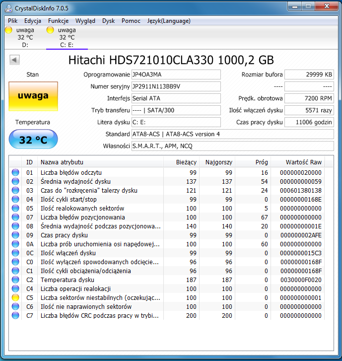

    In approximately 1/4 of the backup progress in Partimage a message popped up:
    "Can not read block 3900940 from image (string of digits).
  • #6 16481685
    linuks
    IT specialist
    Posts: 10981
    Help: 1473
    Rate: 491
    SMART drive hands. It may be a damaged disk and therefore partimage can not read the data.
    greetings

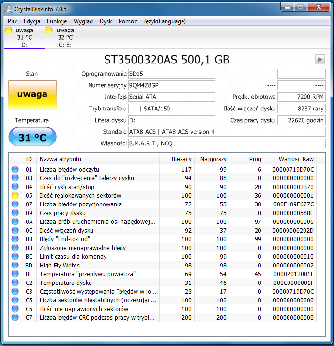

    One unstable sector and just happened on the windows partition. You have to download the data and do the disk repair procedure. If this is a logical error then the disk should return to normal. The second disk also has problems. Give SMART the second one.

    The latter has already been analyzed and I know that keeping data on it is a risk. Nevertheless, it still works.

    This is irreparably damaged. The restored sectors can not be repaired. To exchange. You can start a copy of partimage once. Maybe he can read this unstable sector.
