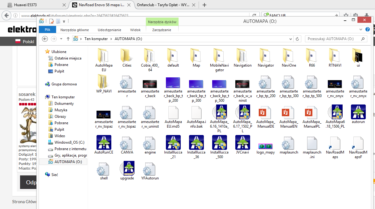

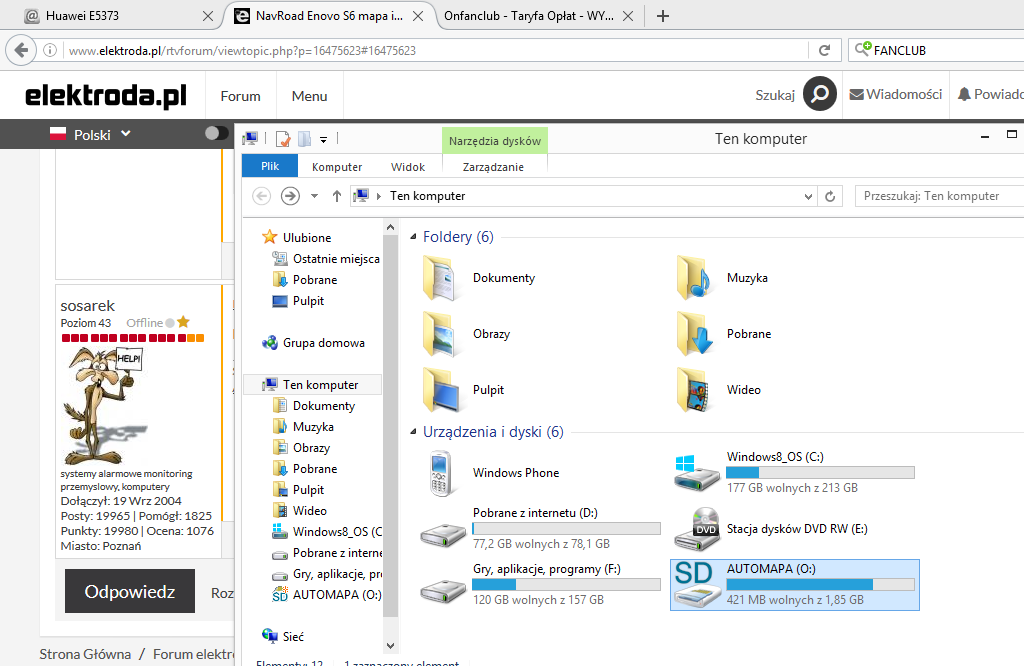

    I have NevRoad Enovo S6 navigation with the SD card on which AutoMapa is located, I decided to record the iGO Primo on a different SD card.
    After inserting the navigation card and pressing the GPS button, the message "Application not installed" pops up and I have to enter the system settings -> explorer -> start -> run and press ok then the map is switched on. I would like the map to start the same way as it was from AutoMapa, so I write to you asking what to do in this situation
    • NavRoad Enovo S6 iGoPrimo map - Map loaded on SD does not start mapa 2.png (163.74 KB) You must be logged in to download this attachment.
    • NavRoad Enovo S6 iGoPrimo map - Map loaded on SD does not start mapa 1.png (168.97 KB) You must be logged in to download this attachment.

    Here are the photos from the SD card from AutoMapa
    • NavRoad Enovo S6 iGoPrimo map - Map loaded on SD does not start am 2.png (132.88 KB) You must be logged in to download this attachment.
    • NavRoad Enovo S6 iGoPrimo map - Map loaded on SD does not start AM 1.png (116.16 KB) You must be logged in to download this attachment.

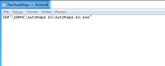

    Open the file navroadmaps.lnk in the notepad - with a shortcut icon and you have exactly the path and file names entered there.

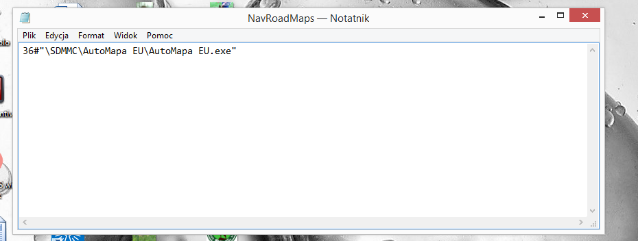

    The basics of Windows are bowing. Open the notebook, then open and point to the file. Alternatively, hold the shift and right-click on the file and select open with and select the notebook.
    Added after 19 [minutes]:
    here you have a file open in the notepad - that's what the directories are called - SDMMC is the name of the memory card.

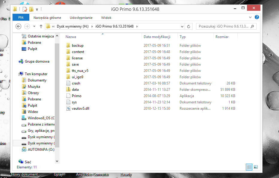

    I opened this file and it's exactly the same as yours, there's nothing more.
    What now???
    • NavRoad Enovo S6 iGoPrimo map - Map loaded on SD does not start Bez tytułu.png (63.72 KB) You must be logged in to download this attachment.

    Upload the screenshot as you currently have on the card. You are doing something wrong.
    Added after 6 [minutes]:
    On the igo card you should also have the navroadmaps.lnk file
  • #14 16478286
    japycz321
    Level 26  
    Posts: 681
    Help: 92
    Rate: 141
    krzychug3 wrote:
    I'm sorry but I do not know it and I do not quite understand how and what to change, can I ask you to write it somehow ??
    the file navroadmaps.lnk and navroadmapsF.lnk contain a path to the file that you want to run after clicking the navigation option. There really is nothing to understand here. The path is to be the same as the location where the file you want to run is located.
    i.e., if you have a map on the memory card in the map folder, and the boot file is called navigator.exe then the file may look like this:
    36 # "\ SDMMC \ map \ nawigacja.exe
    if you do it correctly it must work and that's it.

    enable displaying file extensions and see if you have done something like mapa.exe
    Try to do everything from the beginning, format the memory card, then place the map again, name the folders in the normal way (without 7.3.4.42.34 and other things) set the path correctly in navroadmaps and walk. If not, put here the current screen with a list of files from the folder in which the map is located, it will write you the content of this file. On this first post the executable file looks suspicious.
