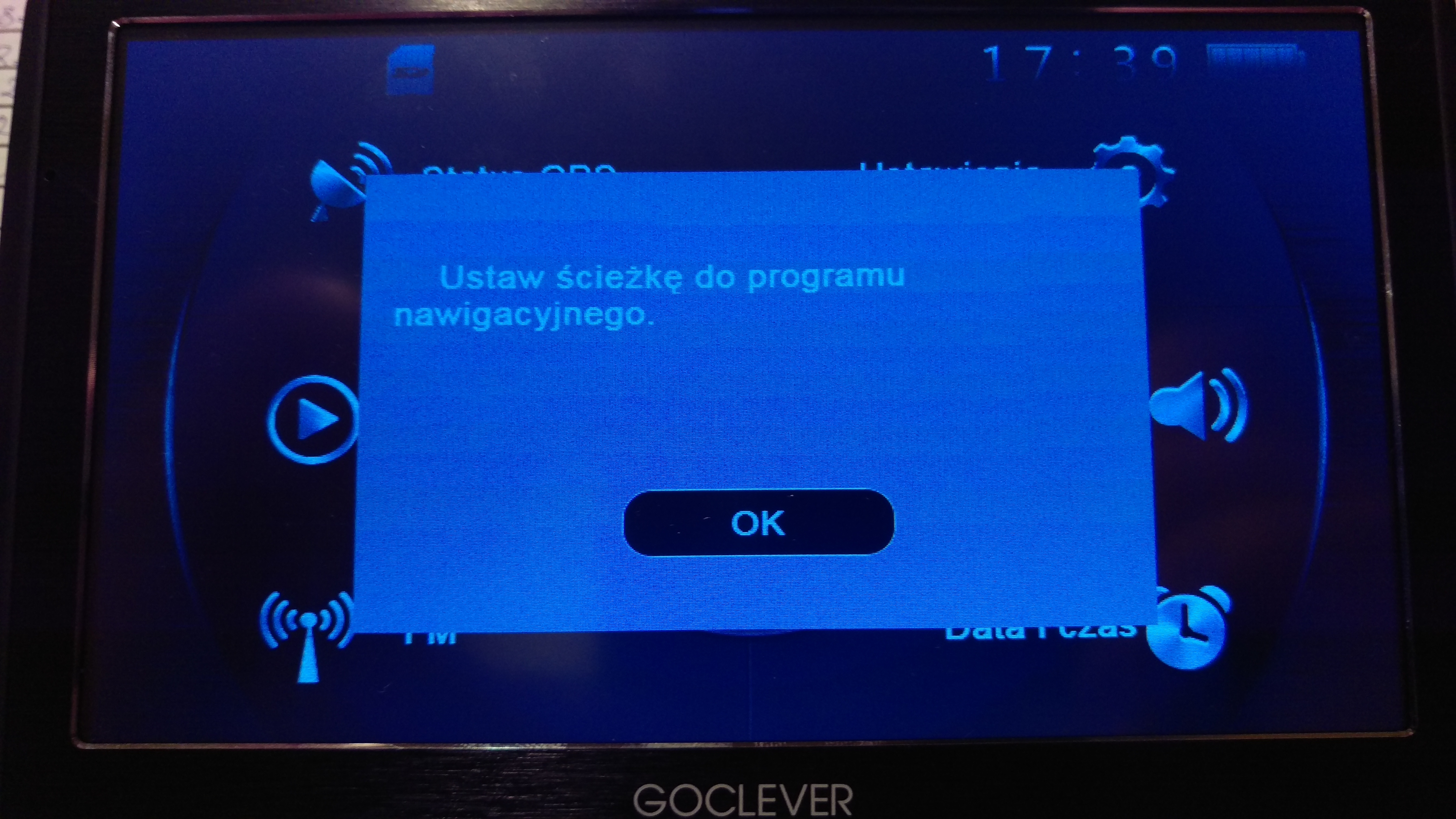

    I recently bought GoClever navio 2 740 (unlocked). Everything fans great, only the problem is that when I insert a micro SD card with auto map and in the navigation settings I choose the map path and go back to the main menu and try to start the navigation, it tells me to choose the map path. And when I enter the settings and there I go to the SD card and the map folder of the cars and click on it it starts without a problem.

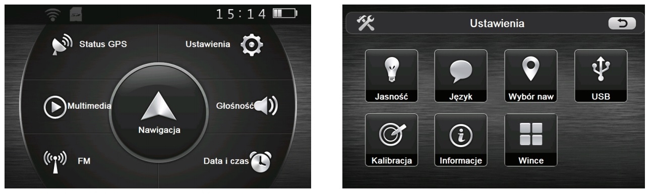

    on the left p. circumcision this is the main menu how to start GPS and on the right is the look as I enter the settings

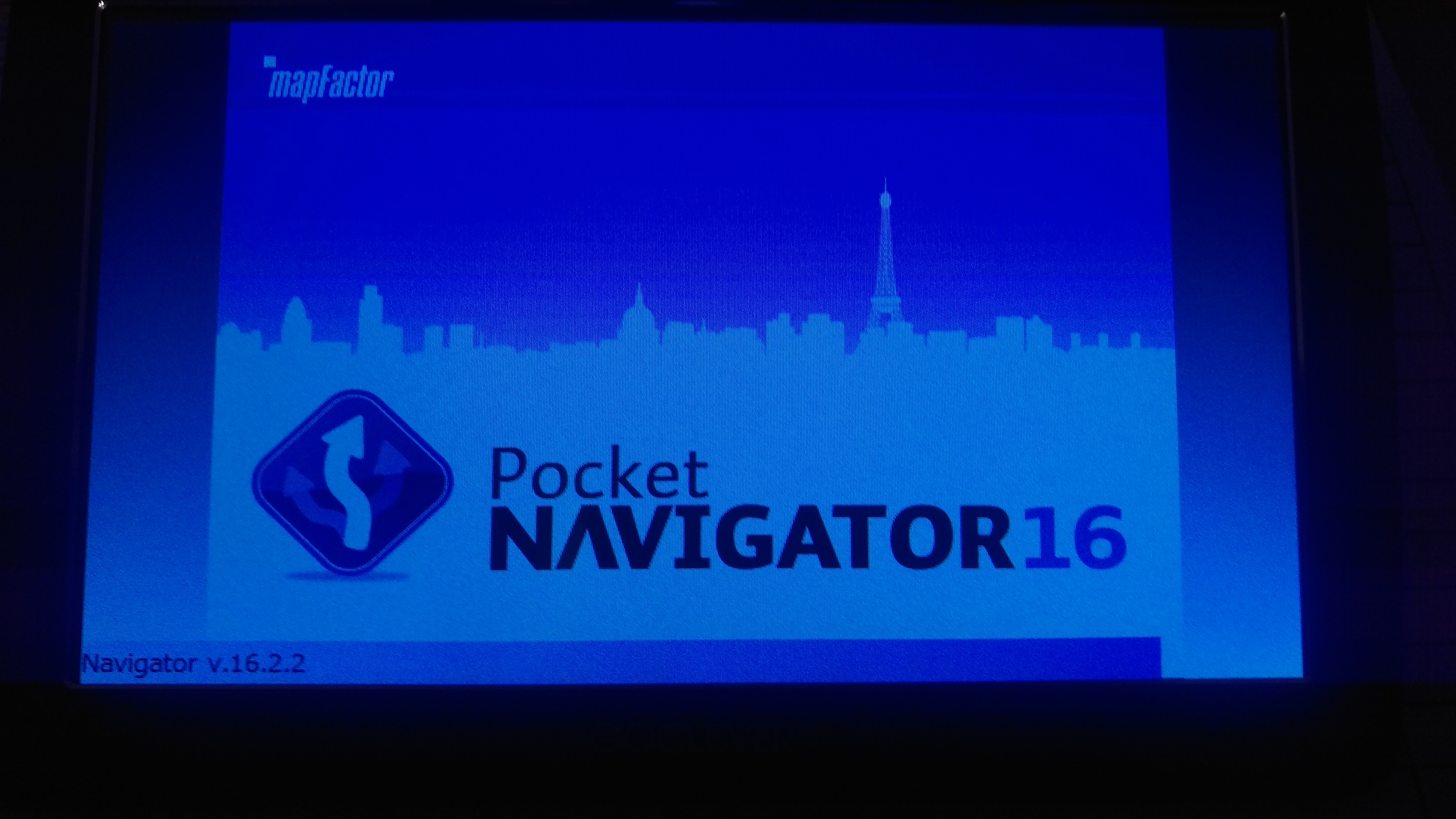

    The case looks like that when I set the path to the auto map it shows me that I should set the path but then I set the path to the original map and it works, and so the card with the auto map was tested on 4 other GPSs and works

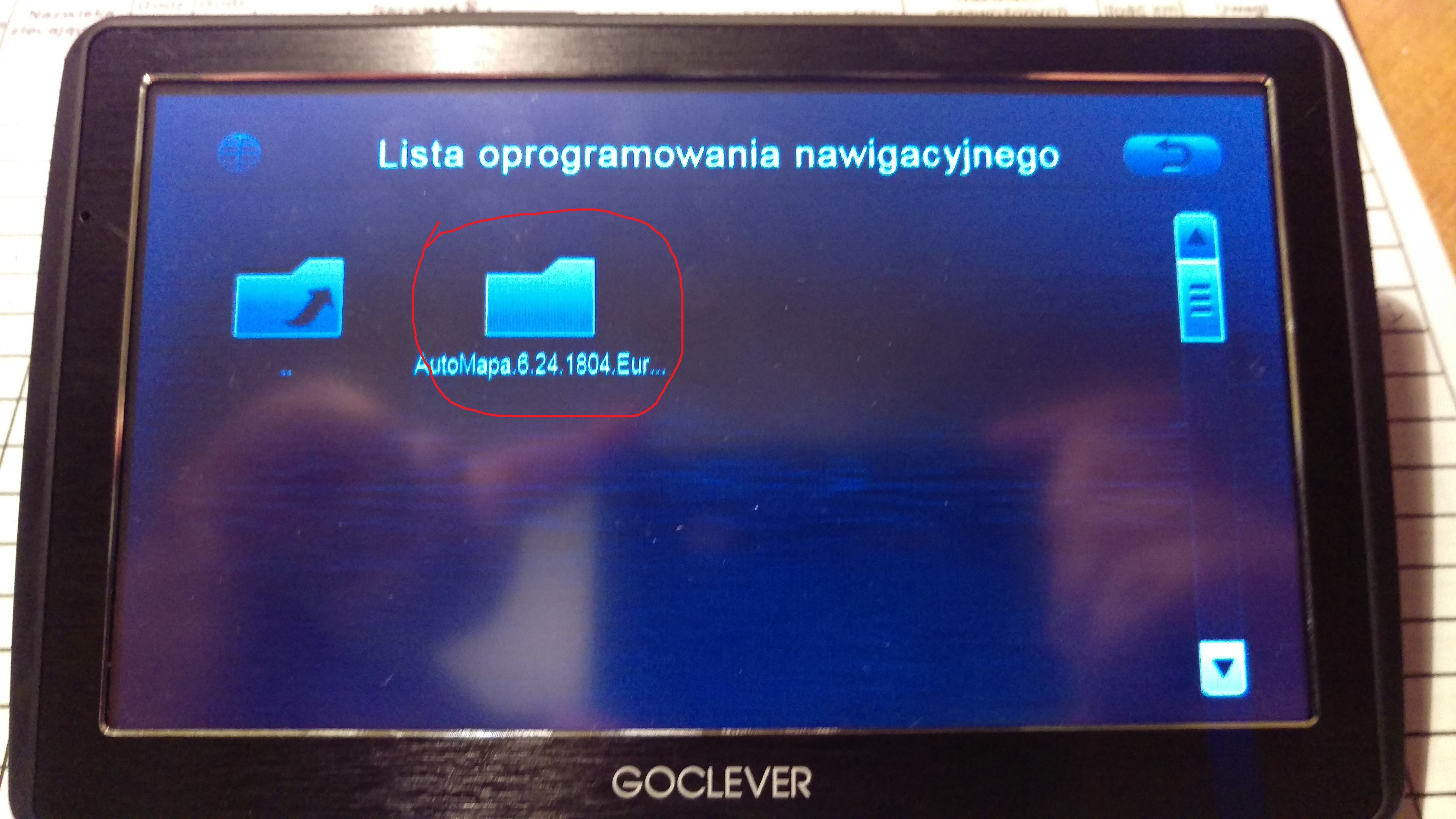

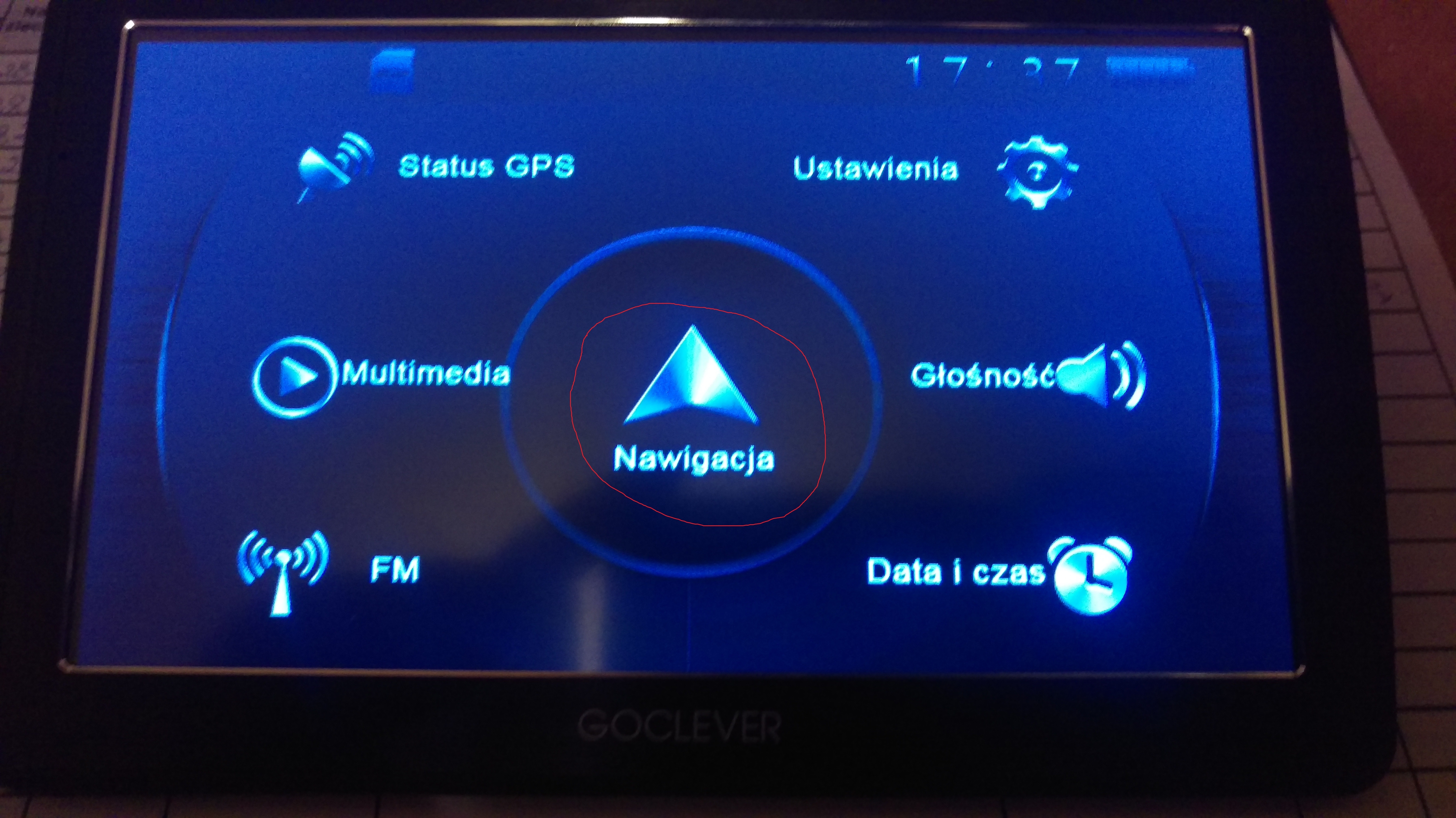

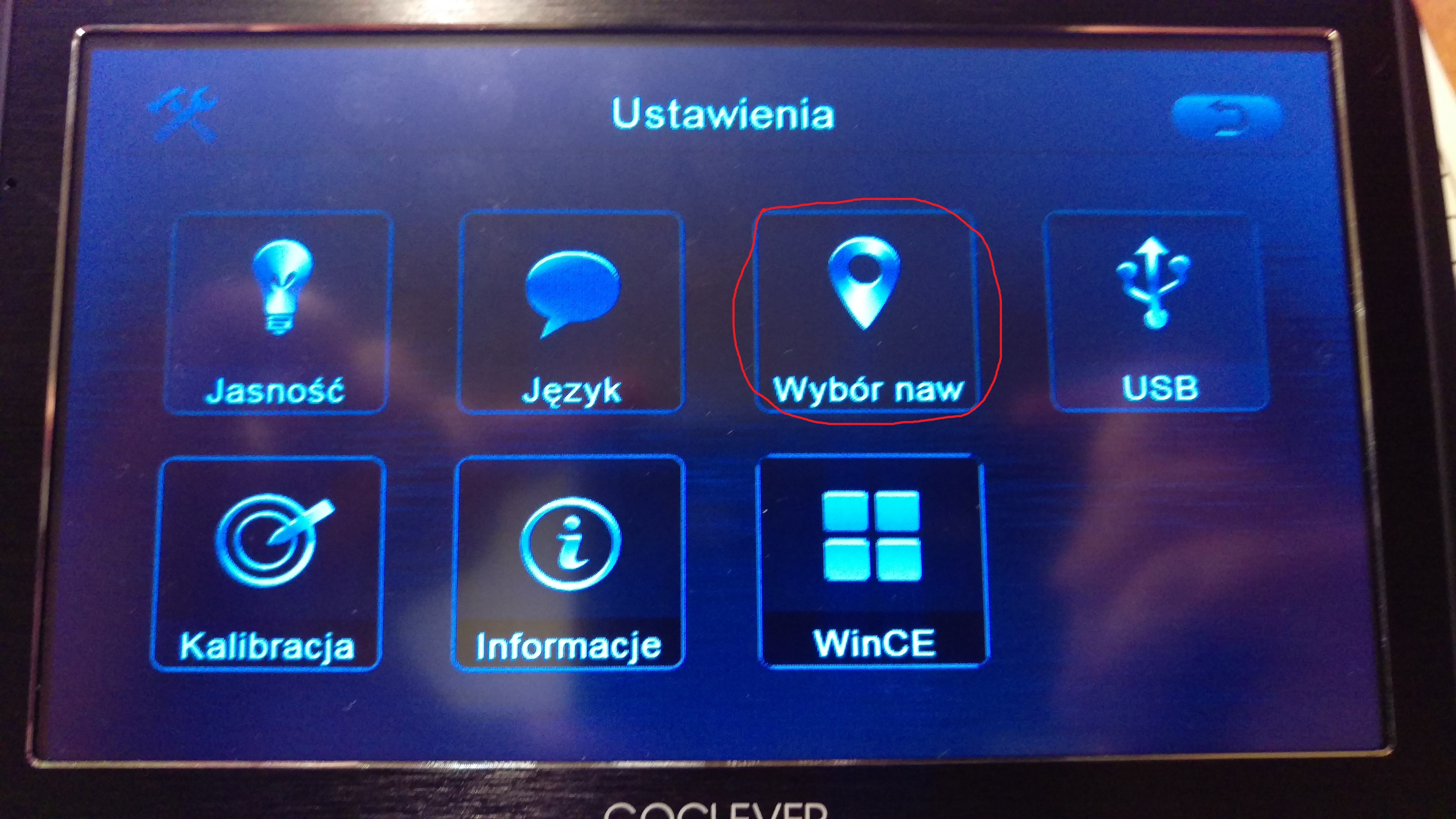

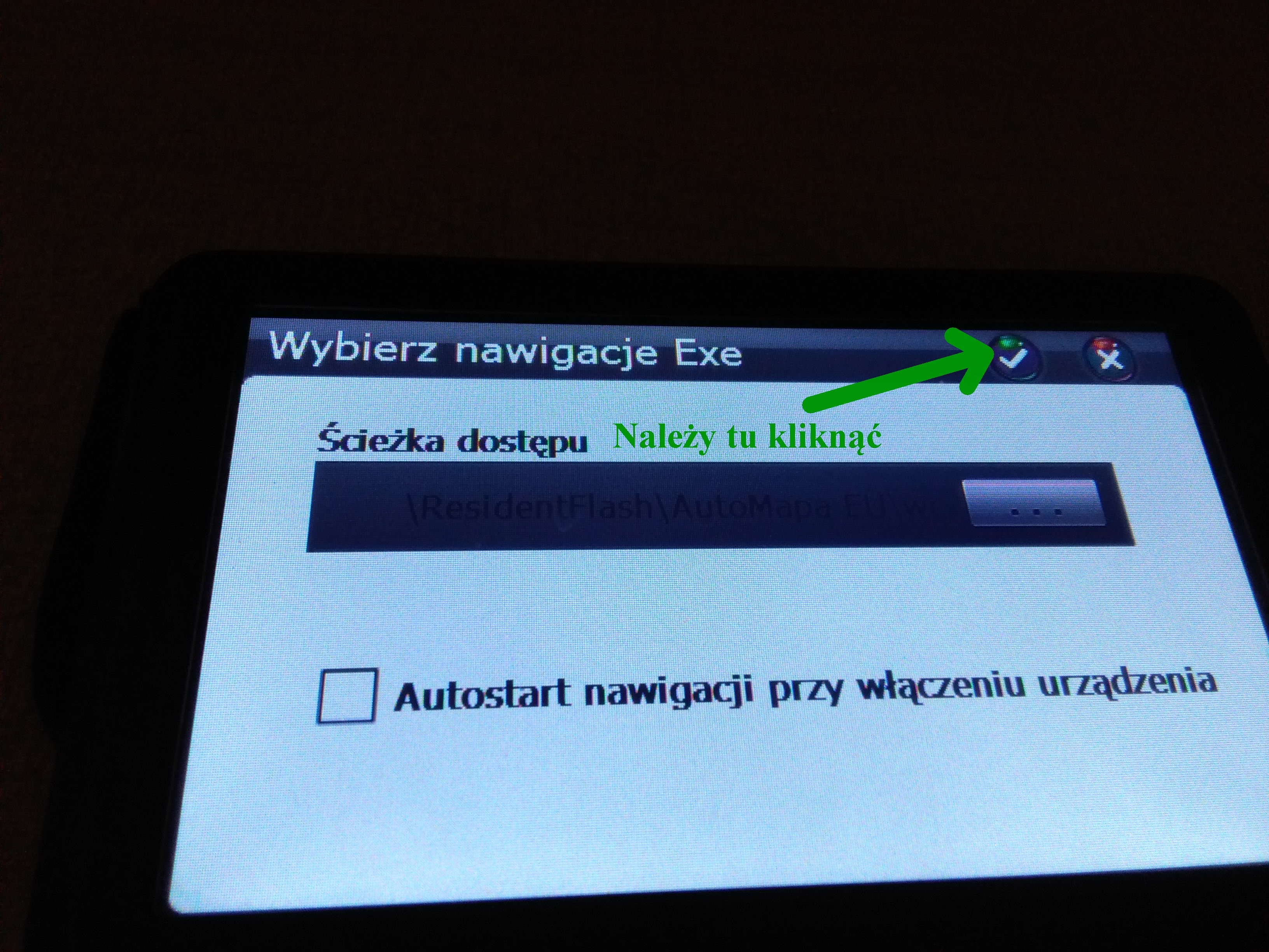

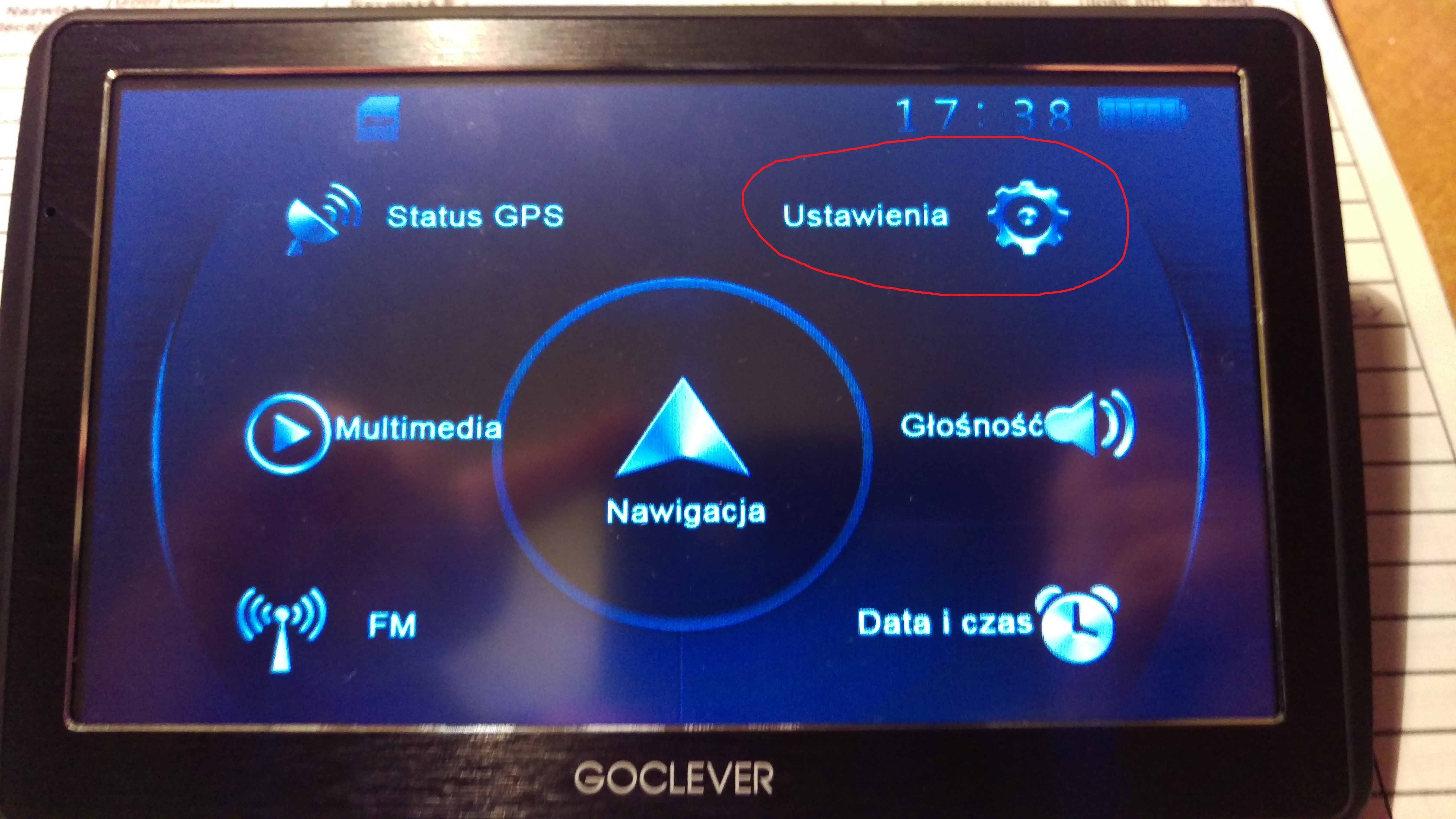

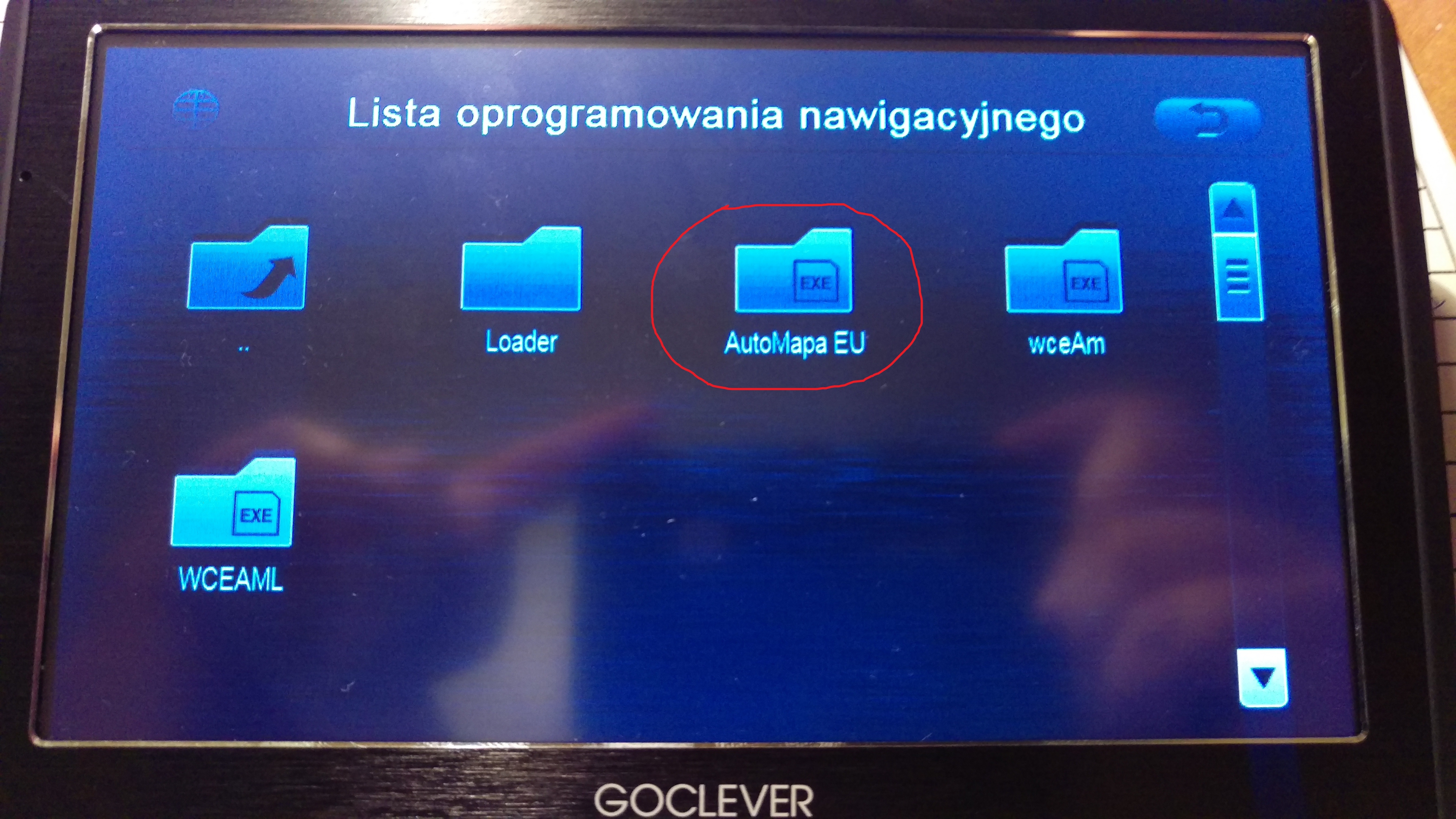

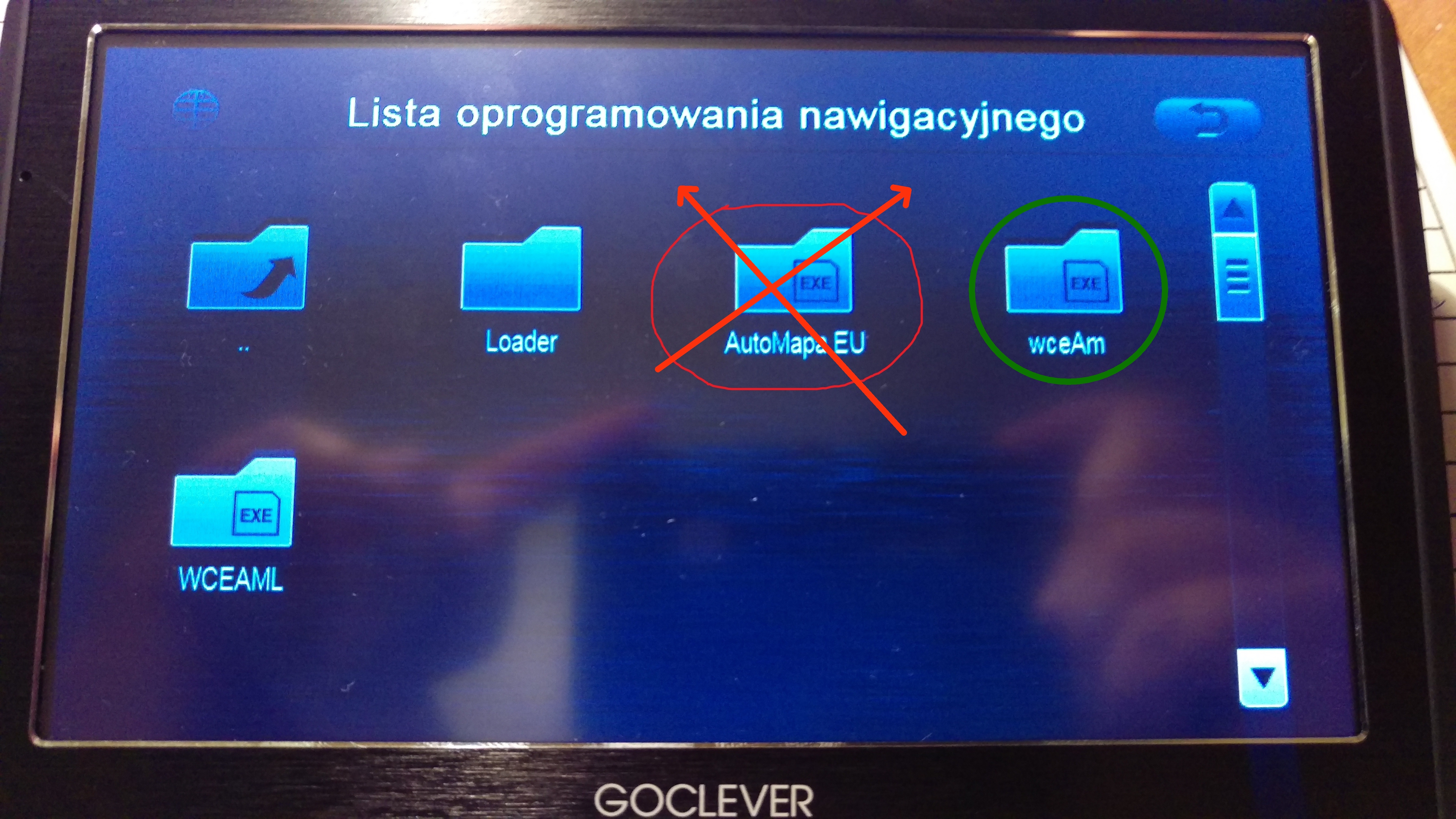

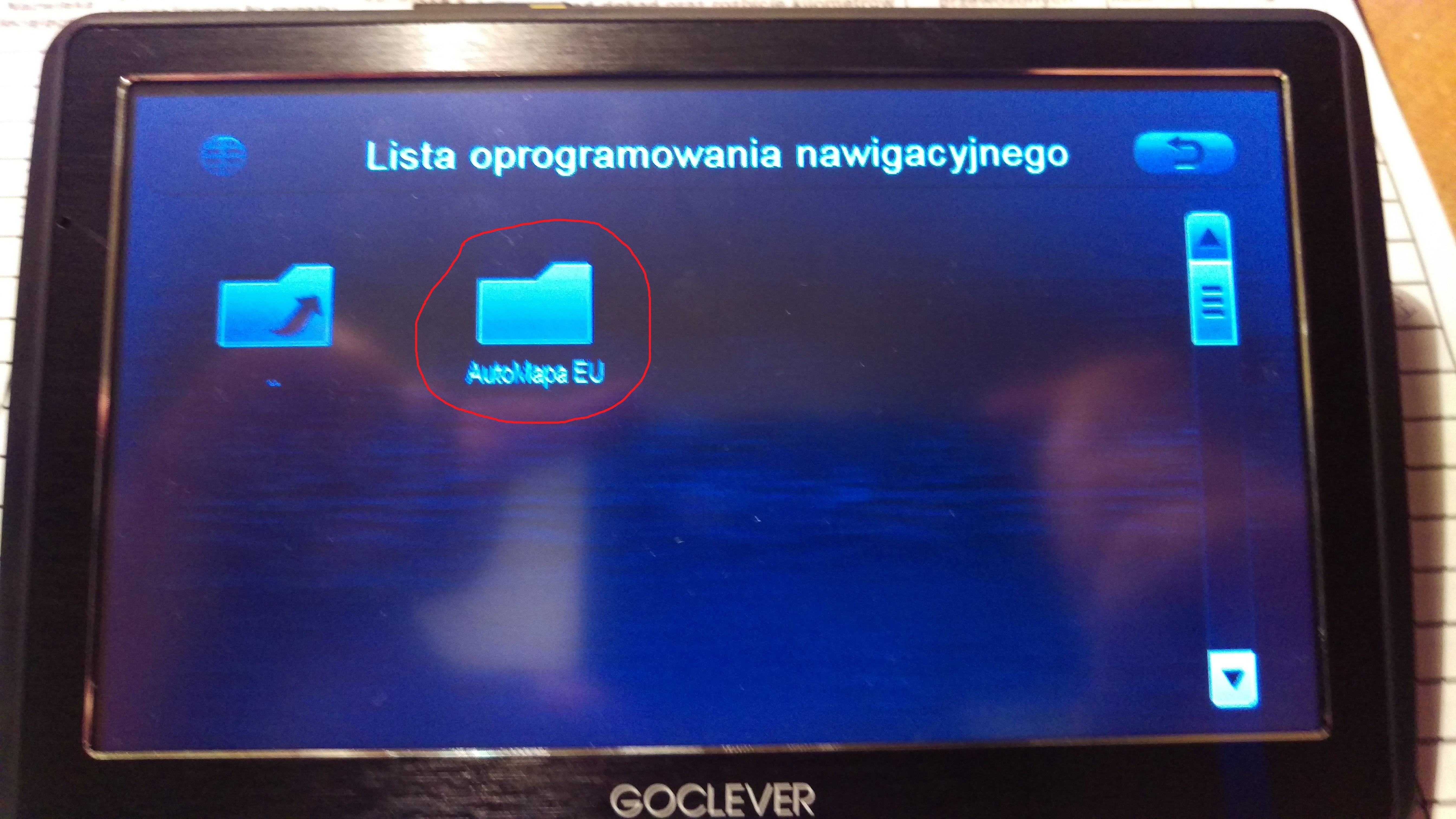

    The pictures show and mark step by year what I do to run the map.
    GoClever Navio 2 740 Unlocked: Car Map SD Card Navigation Issue & Solution - Help Needed GoClever Navio 2 740 Unlocked: Car Map SD Card Navigation Issue & Solution - Help Needed GoClever Navio 2 740 Unlocked: Car Map SD Card Navigation Issue & Solution - Help Needed GoClever Navio 2 740 Unlocked: Car Map SD Card Navigation Issue & Solution - Help Needed GoClever Navio 2 740 Unlocked: Car Map SD Card Navigation Issue & Solution - Help Needed GoClever Navio 2 740 Unlocked: Car Map SD Card Navigation Issue & Solution - Help Needed GoClever Navio 2 740 Unlocked: Car Map SD Card Navigation Issue & Solution - Help Needed GoClever Navio 2 740 Unlocked: Car Map SD Card Navigation Issue & Solution - Help Needed GoClever Navio 2 740 Unlocked: Car Map SD Card Navigation Issue & Solution - Help Needed GoClever Navio 2 740 Unlocked: Car Map SD Card Navigation Issue & Solution - Help Needed GoClever Navio 2 740 Unlocked: Car Map SD Card Navigation Issue & Solution - Help Needed GoClever Navio 2 740 Unlocked: Car Map SD Card Navigation Issue & Solution - Help Needed GoClever Navio 2 740 Unlocked: Car Map SD Card Navigation Issue & Solution - Help Needed

    Try doing this:
    Paste only the AutoMapa EU folder onto the card ("hack" it from the AutoMapa folder. 6.24.1804.Europa.Gotowa.SD ... and I don't know what's still there). Insert ONLY directly into the SAM folder Automapa EU WITH ITS CONTENT . And then choose the path, preferably pointing to the file wceAm.exe. You have to do it (change the folder structure) so that the path is only "in" the window SDMMC \ AutoMapa EU \ wceAm rather than many folder levels.
    You can also the one you indicated in the picture, but it seems to me (maybe it only seems) that the wceAm.exe file starts better (faster). The reason may be too extensive folder structure and the system "does not make" with the path name length (too many characters in the path in the situation you indicate) and therefore the system does not see the file, it simply cannot remember such a long path name.
  • #15 17293978
    karolina90r
    Posts: 8
    I did it so you advised, it actually worked. Strange because the service GPS is worse and they work as I did before and they really have a worse system and are weak. The system could not cope with the name of the AutoMapa.6.24.1804.Europa.Gotowa.SD folder it turned out to be too long, e.g. when I shortened this name to AutoMapa. 6.24.1804. Europe also works.
