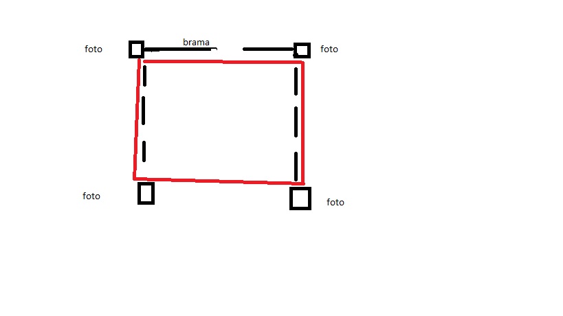

    Hello, in the spring, I am going to install a gate automation and I wonder how to protect the marked field in red, there is 1.75m

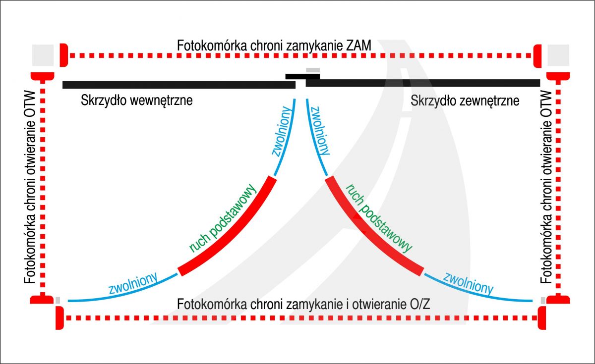

    PROXIMA sj
    Radio controllers specialist
    Posts: 517
    Help: 103
    Rate: 220
    It may come in handy:
    Photocells in Double-Leaf Gate: Mounting & Positioning on 10x10cm Metal Posts with Welded Hinges
    greetings
    PROXIMILIAN
    PROXIMAsj

  • #14 19828067
    enginegarage
    Posts: 275
    Rate: 248
    I understand that 6 photocells are needed then?
  • Four photocells for opening and closing protection
    #15 19828193
    PROXIMA sj
    Posts: 517
    Help: 103
    Rate: 220
    Hmm ...
    More like 4.
    - One to protect the closing, when the car drove a bit through the open gate into the yard from the street, and the gate begins to close,
    - two to protect opening, if there is a possibility of people being crushed by the opening leaves of the gate,
    - and one that protects and opens and closes when the car is standing in the yard and is within range of both the opening and closing gate ...
    greetings
    PROXIMILIAM
    PROXIMAsj
    Polna 23A, Toruń, 87-100 | Company Website: www.proxima.pl
  • Unsecured zone remains in the driveway center
    #16 19830171
    enginegarage
    Posts: 275
    Rate: 248
    ok, let's assume that the wing is 1.75m after opening, the kid leaves the bike in the middle of the driveway where the detectors do not reach
    in this case, this area is not secured Photocells in Double-Leaf Gate: Mounting & Positioning on 10x10cm Metal Posts with Welded Hinges
    in the case of a sliding gate, there is no problem because there I also secured it with 4 photocells in front of and behind, but here I can see a bit more of the unsecured zone. unfortunately I am forced to install a swing gate.
  • #17 19830183
    kotbury
    Gantry automation specialist
    Posts: 9598
    Help: 2100
    Rate: 3631
    Well, it's impossible to put photos in the place where the gate wings fly ;) . But you can give a kit (mostly with 24 V motors) with exactly working amperometric anti-squash.
  • #18 19830928
    PROXIMA sj
    Posts: 517
    Help: 103
    Rate: 220
    And the person controlling the gate should keep an eye on the gate's operating area.
    If your gate leaf does not cross your yard, you can also install several OZ photocells across the yard, below the gate leaf.
