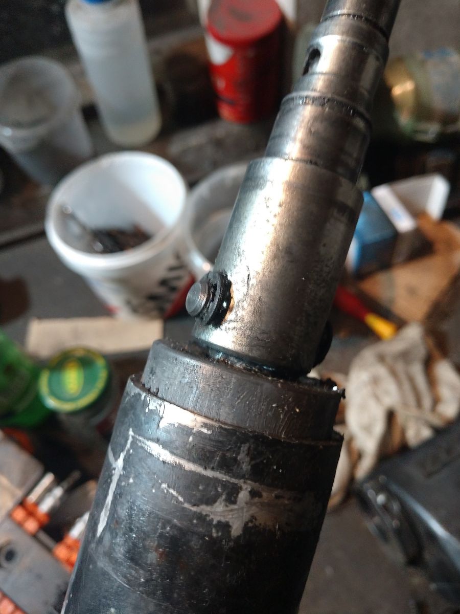

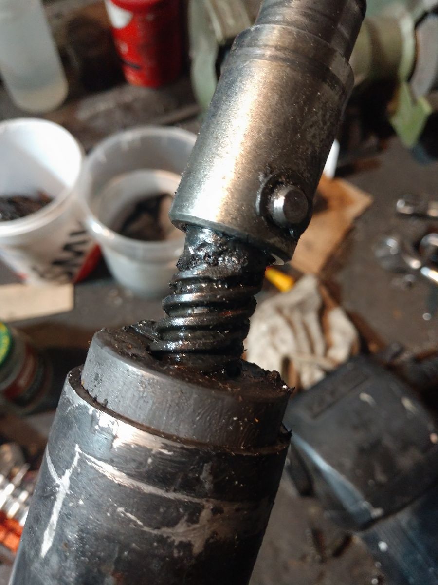

    I would like to use the bumper in the middle as the final position of the closed gate. Worse is the bumpers on the opening because one of them would have to be installed in the place where the path from the gate runs. The solution may be what was written by gadek80, but whether the position of the actuator opening to the maximum will not affect their service life? This is a question for experienced installers. Thank you for all the advice and best regards.
    Washer shim prevents actuator nut jamming
    #14 19556032
    kotbury
    Gantry automation specialist
    Posts: 9607
    Help: 2104
    Rate: 3639
    will not affect their viability?
    There will be, although the thread on the bolt ends a bit early and the plastic piston nut stops on those unfinished threads (and theoretically it can jam), but we used a lot of drives this way and they all show no signs of jamming or wear of the nut. It is possible to "tune" the actuator by placing a thick washer in the gap between the nut and the drive sleeve (see photo) - and then the nut will rest elegantly with its entire forehead against this washer.

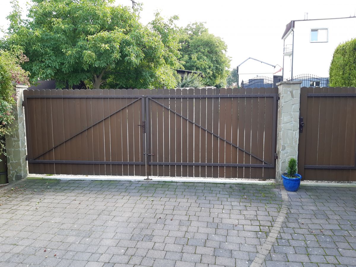

    Of course, my oversight, but in fact the power of auto-suggestion and willingness to find the best solution :) . In the Thalia control panel, it is actually possible to adjust the closing position of the gate with the pressure against the central stop.
    I add a picture of my gate: Best Automatic Device for 225cmx160cm Double-Leaf Gate: Steel Profile & Railing Options .
    I would like to ask my colleagues at what height is it best to mount the actuator? The bottom metal profile is about 30 cm high and it seems a bit too low to me. And most importantly FAAC 414 or BFT PHOBOS BT A40?
    Thank you for all the hints.
    But then the electric limit switches do not work, i.e. the central stop is then necessary.
    In your situation, most of the advantages favor the BFT - lightweight gate, so the low-noise 24V Phobos actuators are better suited. They also have a much more culturally active redundancy and a lot of added value - anti-crush (in 414 only in a paid option and it works a bit cajmer).
    414 are "gniotsa not break" actuators, maintenance-free, for heavy gates, but clunky and with a low work culture - let's say a large gate at a farmer who hangs, how it works to work without looking (they also have a second ecological niche - heavy gates in tenement houses in the old construction industry - the so-called rental ones - they can do it without any problems, they are much cheaper than professional motors for heavy gates, and the culture of work or some extra options the community does not care about - it has to open and close as long as possible, CHEAP, no breakdowns and that's it).
    Theoretically, it is best to mount the actuator exactly in the middle of the leaf height - but if your gate is not twisted and fairly stiff (i.e. when pushing the bottom to the stop of both wings, the top will not break apart), then you can mount it to the bottom crossbar.
