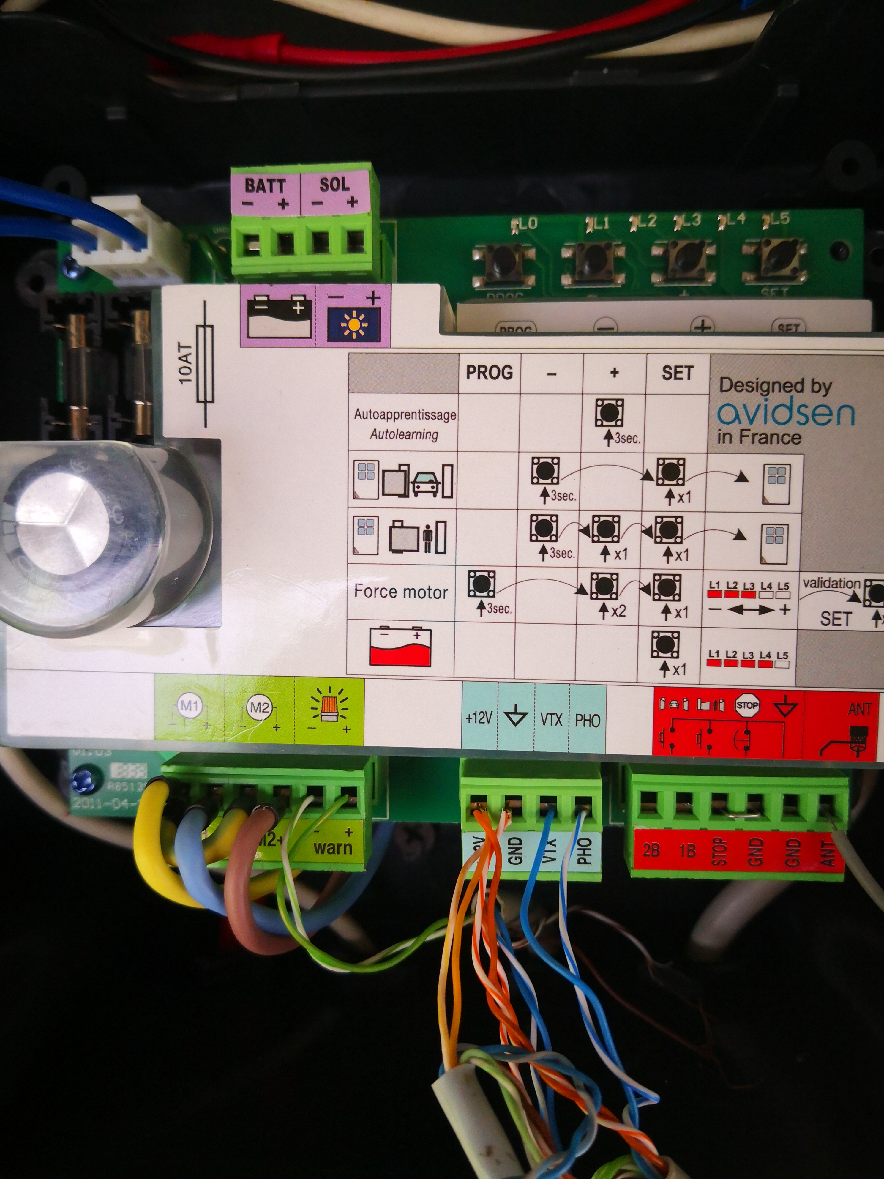

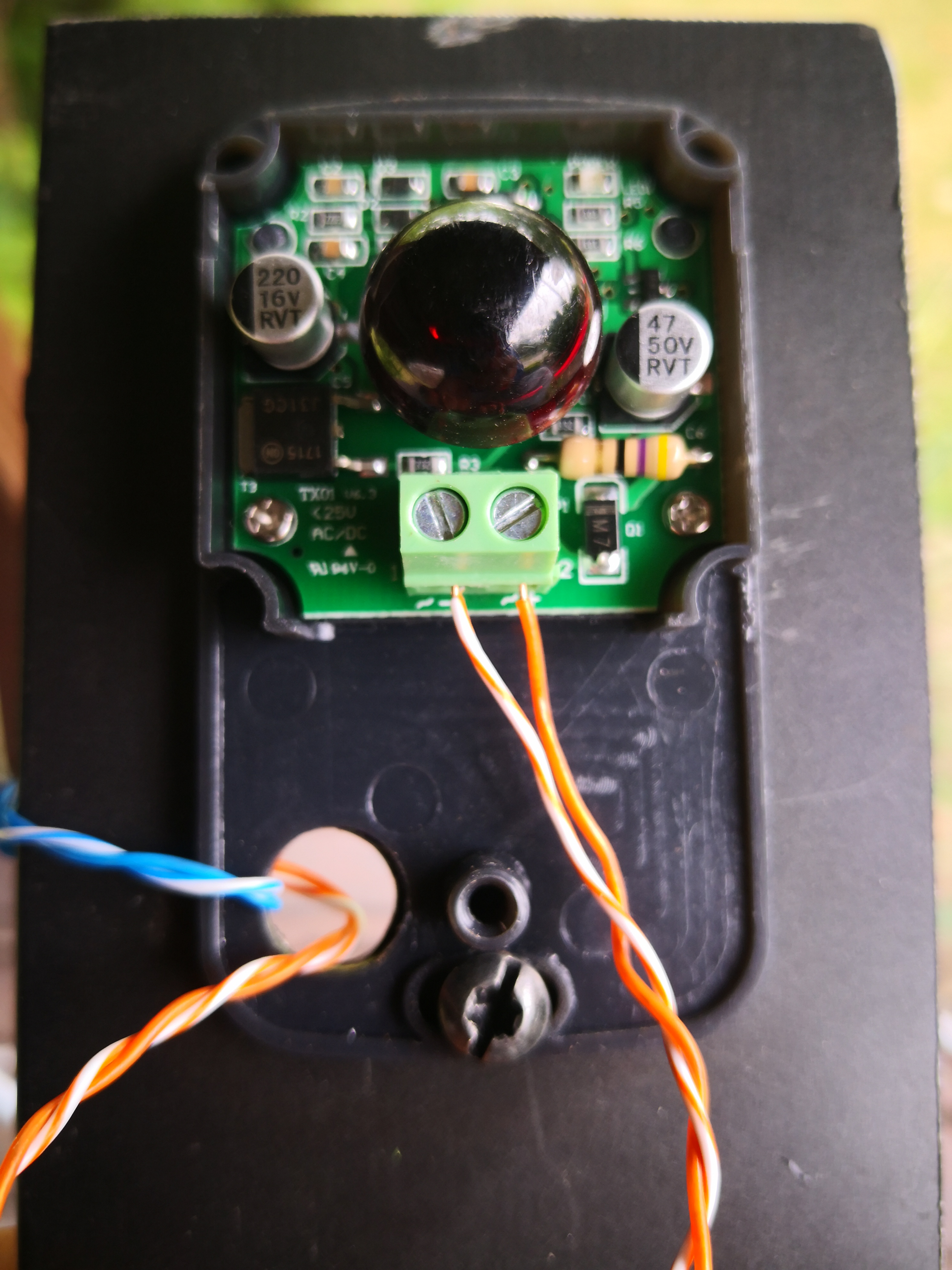

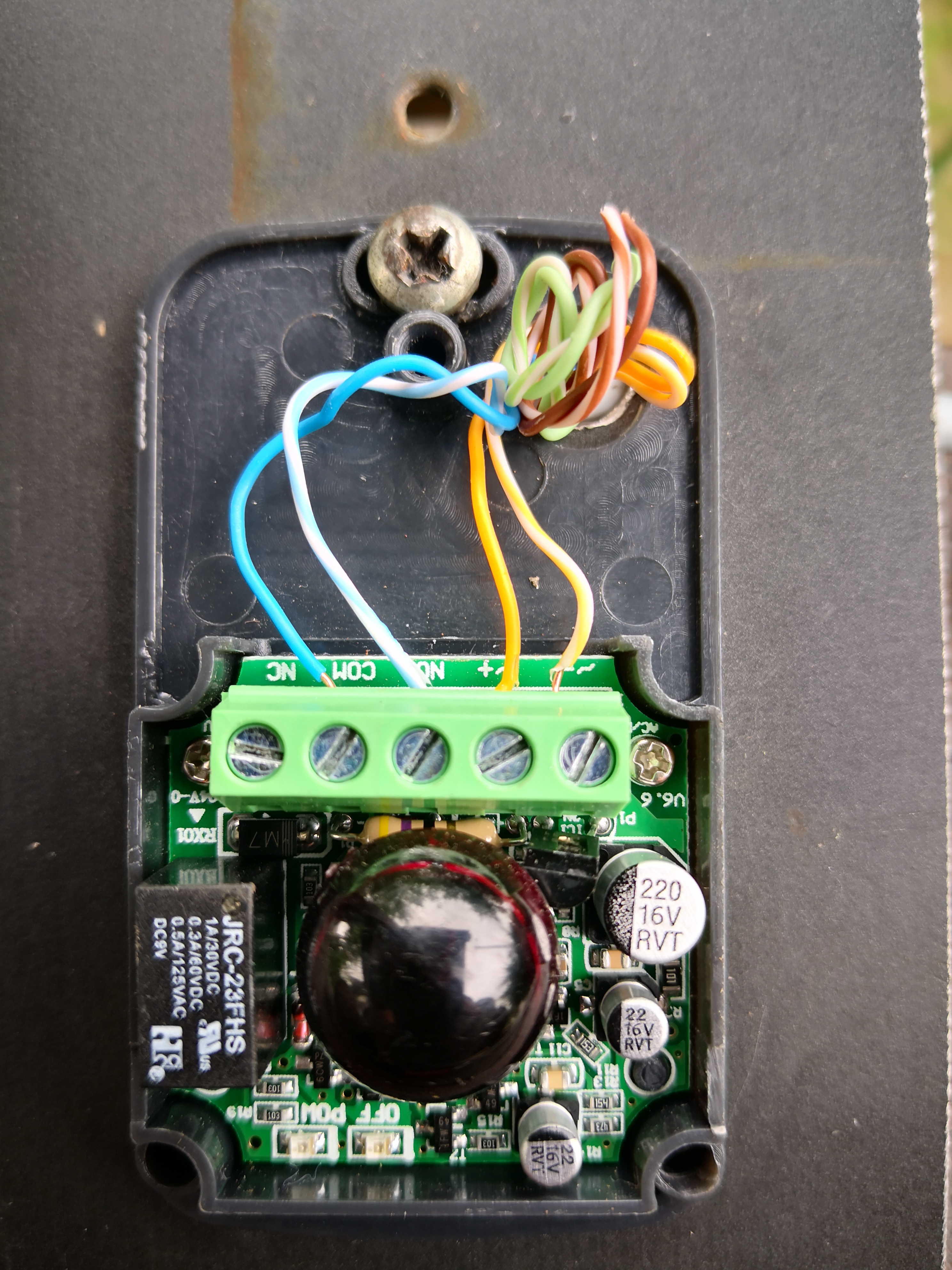

    Hello, I recently got a kit like this to install at my place and I have a problem. I don't know how to connect these two photocells to the control panel.
    If anyone can help me please advise as I have looked on the internet and cannot find.
    Regards.

    It's connected to the centre strip, what remains is the correct mechanical assembly and learning the controller.

    Are they aligned in front of each other?
    As a test, connect VTX to GND and then check.
    Gate learning procedure done?

    The photocells are straight ahead and when I put my hand between them there is an interrupt signal and the off diode lights up, so I guess they can see each other.
    I connected the orange and blue pairs to +12 and gnd and the brown pair to nc and com in the photocell and to vtx and pho in the control unit.
    The first lock learning program is done, the coding of the key to open for the car too, the gate function too. When I press the key to open on the photocell, there is no off light and on the control panel there is one green and 3 red LEDs.
    A bridge from vtx to gnd doesn't help either. Now I don't know if the power supplies of both should be connected to the same contacts.

    darek1385 wrote:
    Bridge from vtx to gnd doesn't help either.
    I may have misspoken, the wire from VTX rewire to GND.
