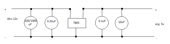

    Sabat666 wrote:
    So on input 0.33uF and on output 0.1uF yes?
    Yes

    Sabat666 wrote:
    L7805CV ........ will be powered by a battery from 12 to 6 / 7v
    6 or even 7 V is not enough for proper stabilization. LM7805 (anyway from all the LM series) must have at least 3V input voltage higher than the stabilization voltage.
    Even with battery power it is also good to add a capacity of approx. 100-1000uF to the stabilizer input. This will increase the stability of the stabilization against abrupt changes in current.

    398216 Usunięty
    Posts: 34170
    Help: 3925
    Rate: 9285
    Regardless of the electrolyte at the input, a small capacity should be added in parallel - in the order of 0.1 to 0.33uF. Often a tantalum capacitor of this value (0.1-0.33uF) is given there. Similarly at the stabilizer output - except for 0.1uF it is good to add a small electrolyte with a capacity of 10uF in parallel.
    5 + 3 = 8 - So in the least favorable case (low battery or accumulator) the voltage cannot be lower than 8V.

    Sabat666 wrote:
    something like that?
    Yes. Exactly - small capacitors (0.33 and 0.1uF) must be (physically) as close as possible to the stabilizer itself.
    Tantalum capacitors have a line marked PLUS - inversely as in electrolytes.
    It is important not to be mistaken - while a normal electrolyte can withstand a short-term change in polarity (especially when the voltage is low), the tantalum is damaged immediately.
