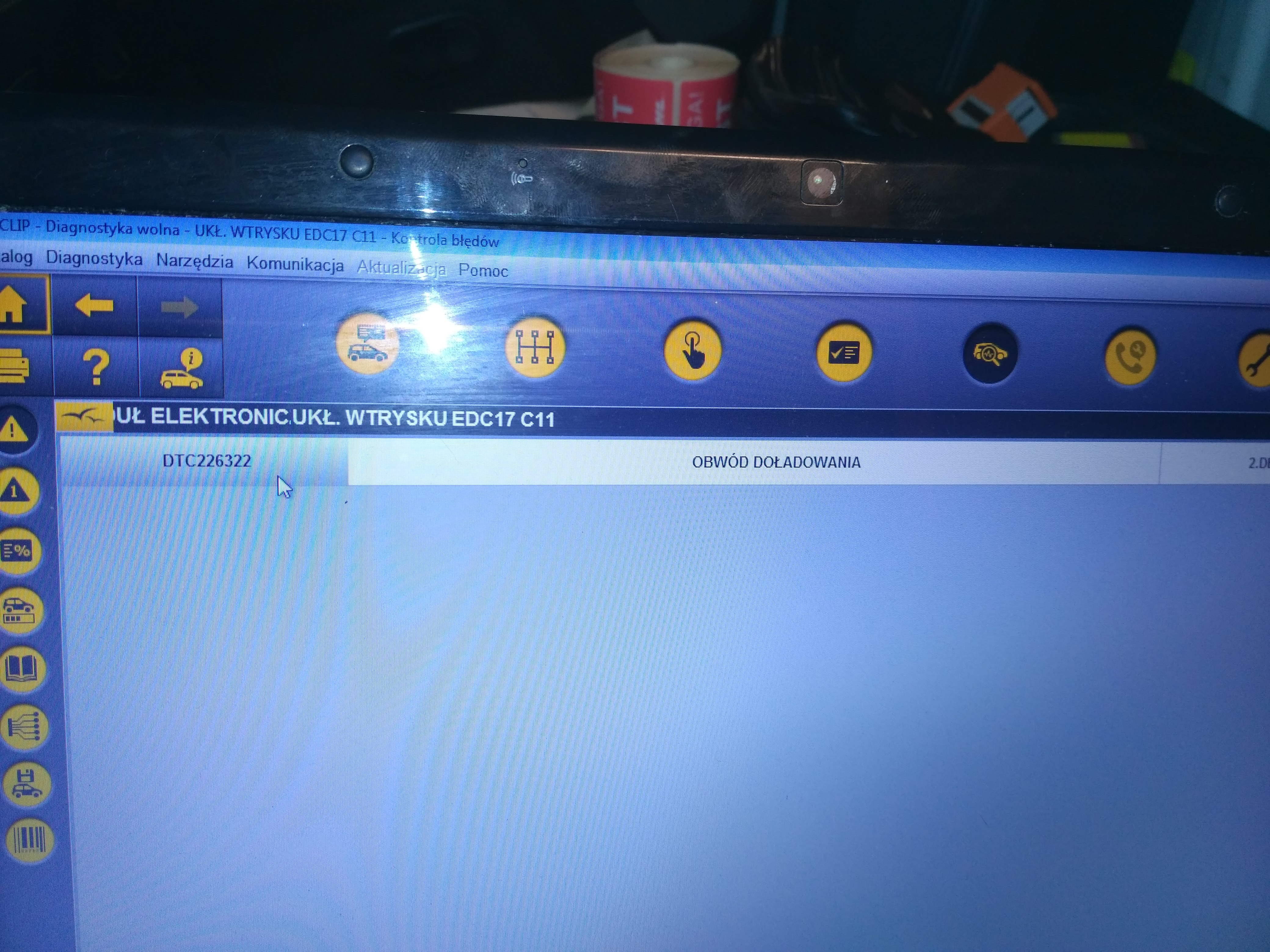

    Hello. Squeezes the hose between the turbocharger, error on the table, injection fault. The engine is without power because the hose is almost completely jammed. Turbocharger Hose Squeezing Issue in Renault Master III 2011 - Engine Power Loss
    You have a blocked intake, show what you get.

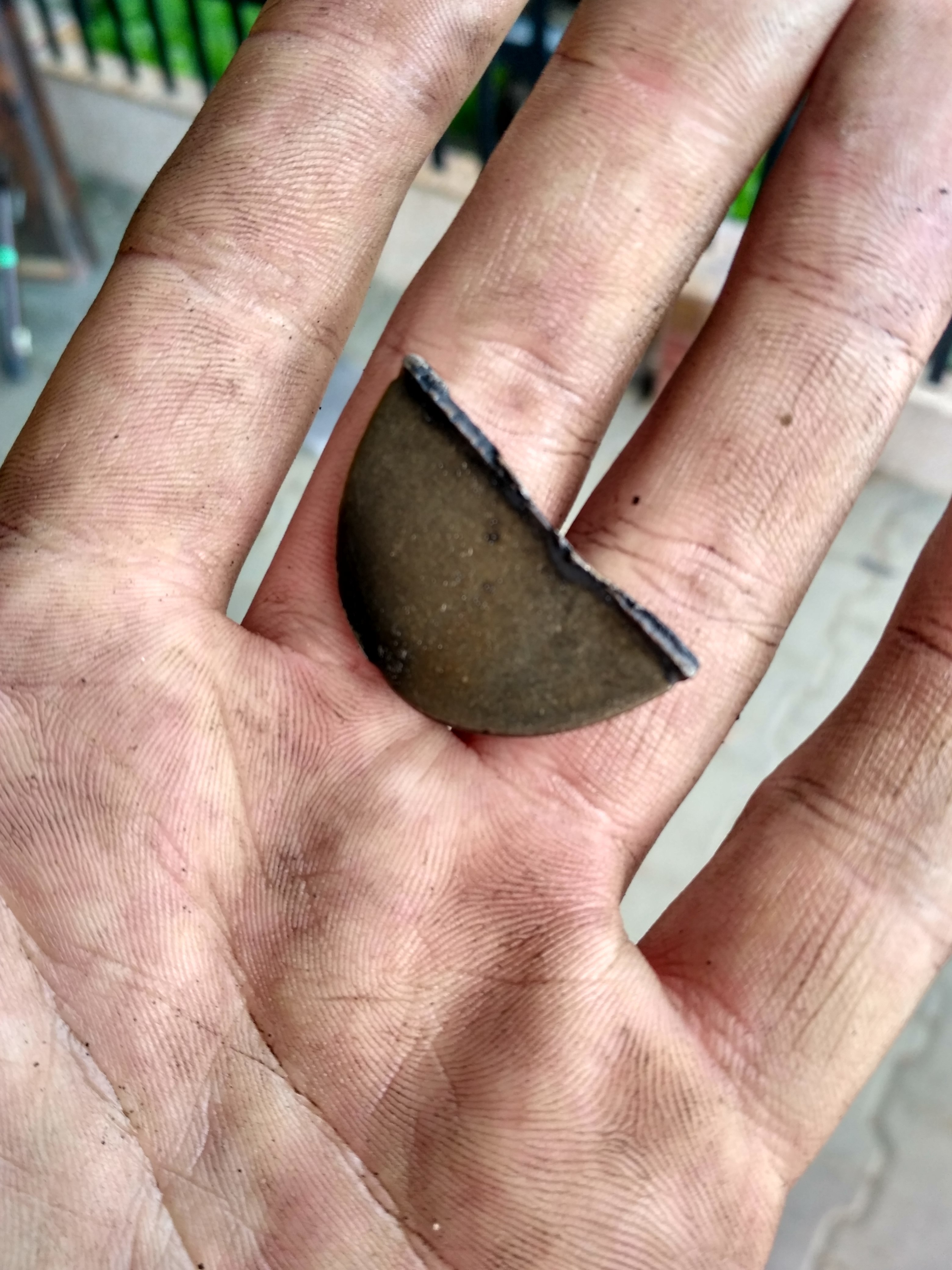

    The air filter is obstructed, and this is not the impeller on the turbocharger and has a weak flow that squeezes the hose.
    Added after 1 [hours] 49 [minutes]:
    Turbo kaput.
    Added after 3 [hours] 46 [minutes]:
    It fell off the turbine during disassembly, what does it look like to you?
    Added after 4 [hours] 4 [minutes]:
    The throttle on the exhaust gas cooler is scattered.

    #7 19809348
    collin4
    Rate: 8
    Renault Master 2011 2.3 dci 125km
    Hello all. I had exactly the same case as described above. The first sign of the defect was a strange ringing in the engine, just in the vicinity of the exhaust gas cooler. The mechanics spread their hands, unable to establish the cause of the strange sound. As a result, it turned out that the above-mentioned sound was a loose throttle, but a loose one because the line that was steering it broke off and was simply chasing itself. As a result, the flap finally broke off and fell into the turbine. After replacing the radiator with a new one, I found a broken flap in the turbine inlet, fortunately it did not fall inside, only closing the inlet. The turbine has not been damaged, I cleaned it, replaced the gaskets, put it back together and the car runs like new. greetings :bye:
