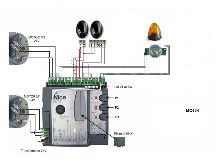

    Please help me with the following electronic problems:
    I have installed Wingo 3524 for 2 wings and I have a problem with:
    1. Photocells (eggs) because they do not work - no reaction, i.e. I connected the following - this is how the seller advised:
    Wingo 3524 Photocells Installation, Remote Programming for Dual Gates, Speed Adjustment
    2. I wanted to program the old 2-button remote for the second sectional gate (nice flor-s) on the second button to have 1 remote for two gates. I did as below in the video with the second button:
    https://www.youtube.com/watch?v=SN_3lqMIizc
    and now I have: 1 button opens both gates, 2 button opens the new Wingo 3524 :(
    3. It opens slowly from the 1st level of programming according to the instruction: I enter the 1st level - I hold P1 and P2 for 3 seconds. I switch to L4 ;) led and approve P1 and P2 3sec. Everything according to the instructions and then the L4 LED is off and is spinning slowly.

    Ad 2. You have incorrectly assigned the old remote control to the new gate. I didn't watch YT, but you probably added a remote control to the new gate using method I (long pressing the button on the receiver).
    Now you have to delete the receiver's memory of the new gate (manual) and add Flora to the new gate using the method II - short double pressing of the button on the receiver and then adding the appropriate (second) remote control button.
    Ad 3. What you are trying to change is the gate.light / heavy setting.
    To turn on the rapid movement, just press P3 when the gate is stopped - it should turn on: the diode next to P3 and turn on the fast movement.
    Ad 1. Connections as if they are good - but the phototest function must be turned off (diode D 4 level 1 part two), that is, the standby is properly turned on (LED is off).

    Ad1 I do not understand, I tried to change but the photocells do not work.
    Level 1, part two (i.e. the P1 and P3 LEDs are on) - the L1 LED is on or off
    to be?
    Unless I have something badly connected .. Is the photocormor with 2 pins to be in port No. 10 (instead of No. 8) or in port 9? And the second photo. at 10?

    Daro1003
    Posts: 2716
    Help: 295
    Rate: 608
    Photos:
    Seal transmitter with two clamps:
    Terminal 1 -> terminal 10 on the control panel + power supply
    Terminal 2 -> terminal 9 on the control panel - power supply
    Receiver (pic with 5 terminals)
    Terminal 4 -> terminal 11 on the control unit
    Terminal 5 -> terminal 13 on the control unit - terminal only for the photocell original, there is a bridge to terminal 11 and must be removed.

    Thank you. For me, it agrees with the above and the photocells do not work. And if I remove the bridge between 13 and 11, nothing works at all - no reaction of the actuators. Is this really the correct connection? : / Greetings to helpful people on the subject.

    Check the voltage on the photocells and the polarity.
    Check cables for continuity.
    If you have plugged in the 4th and 5th photocell clamp in the control panel in 11 and 13 and if you remove the bridge, the actuators do not start, it means that there is no passage. The photocell transmits a signal from terminal 11 to terminal 13 via relays.
    Check the STAND BY / Phototest setting: this is to be set to stand by.

    One more thing, there will be bridges 11-12 and 11-14.
