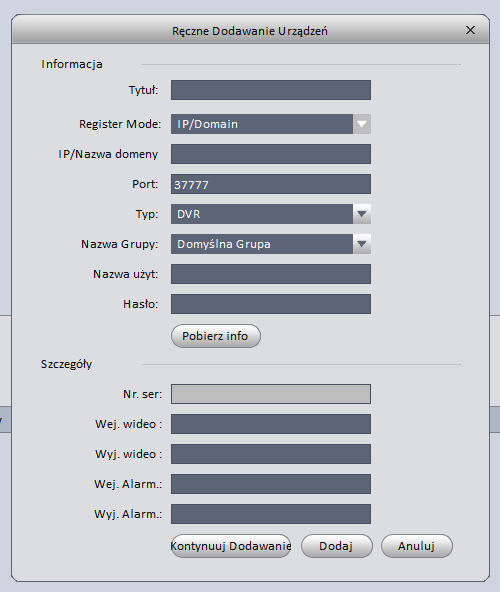

    Good morning,
    Yesterday I connected the model: Dahua DHI-HCVR4108HS-S3 to a laptop via a cable. On the laptop, I configured access via IPv4, patted IP from the recorder and all cameras can be seen clearly.
    In the laptop I have access to the Internet via a USB modem from playa.
    In general, I would like to leave the laptop turned on and connect to it remotely from another computer to have a preview of the cameras - the question is it possible?
    If so, how?
    (I was considering the possibility of remote desktop via e.g. teamviewer, skype, but it seems to me that it would be impractical and the image would probably be heavily cropped)

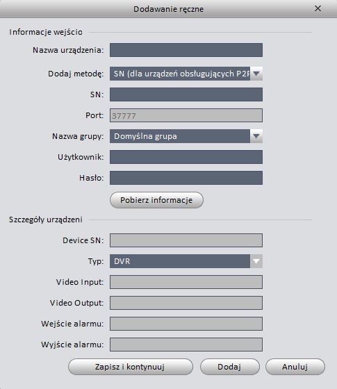

    On another computer, install the SmartPSS program, add a device to it, entering the SN of the recorder, login and password.
  • #6 16747081
    Morino71
    Posts: 7
    Remote Access to Dahua DHI-HCVR4108HS-S3 Recorder via Laptop: Feasibility and Procedure
    Should SN be entered in the IP / Domain name field?
    DVR type?
    You can choose from: IPC, NVS, SVR, NVR, Video wall, NVD, M60, NVR12816, EVS 5000, ISD, IVS_B, IVS_V, IVS_FR, IVS_PC, Smart PC, PC-NVR

    Yeah :) I just don't know how to get to a second computer through the cloud. The program seems to be a simpler solution if you just need to type SN which I found in the options, login and password.

    Hm, weird thing. When I turn on Internet Connection Sharing, the preview in my browser hangs. As soon as I restore to the previous state, everything works elegantly. I've tried 1000 ways. As I gave the sharing and only later turn on the browser does not want to turn on, they had a half hour page and it expires.
    Ok, it works, I changed the IP in the recorder and in the computer and sharing the network worked. However, in the "P2P Settings" option, the status is still offline.

    Cool, I'm not putting down my arms yet. Tomorrow I will test a second USB modem and see if it can go on. If I can't do it, I'll buy a router.
    IT WORKS! :)
    For laymen like me, info:
    The cloud about which colleagues wrote above is in the recorder the change of mode from static to DHCP .
    IP in the recorder downloaded itself from the computer after connecting.
    Well, yes - I write SN through the app and I have a beautiful preview. And now how to do the same but in the SmartPSS program? I was looking for the option to enter the serial number there and did not quit.

    I found the latest one. There is also this option. Thank you very much for all your help! :)
