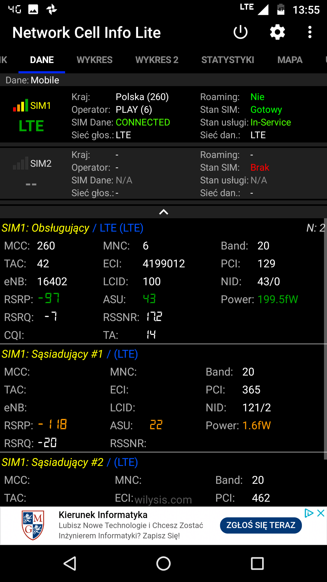

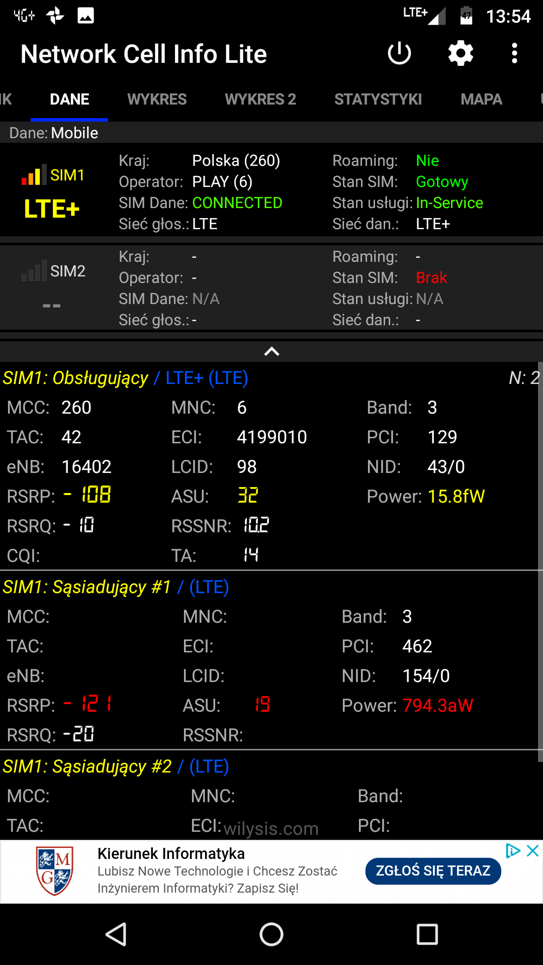

    Hi
    I give screenshots, the one with LTE + outside.
    Depending on the phone's settings, it sometimes improved slightly.
    Ping about 80ms, download about 20Mbit / s.

  • #6 17344446
    matek451
    Posts: 31253
    Help: 4352
    Rate: 5808
    Aggregation LTE1800 + 800 from BTS Gołębiewo, signal on LTE1800 tragic, better on LTE800. Nice SINR and speed in such conditions. In your sector also confirmed LTE2600 from it. It would be worth doing a BTS test on your direction to check if you connect in the LTE2600 + 1800 aggregation and check your speeds.
